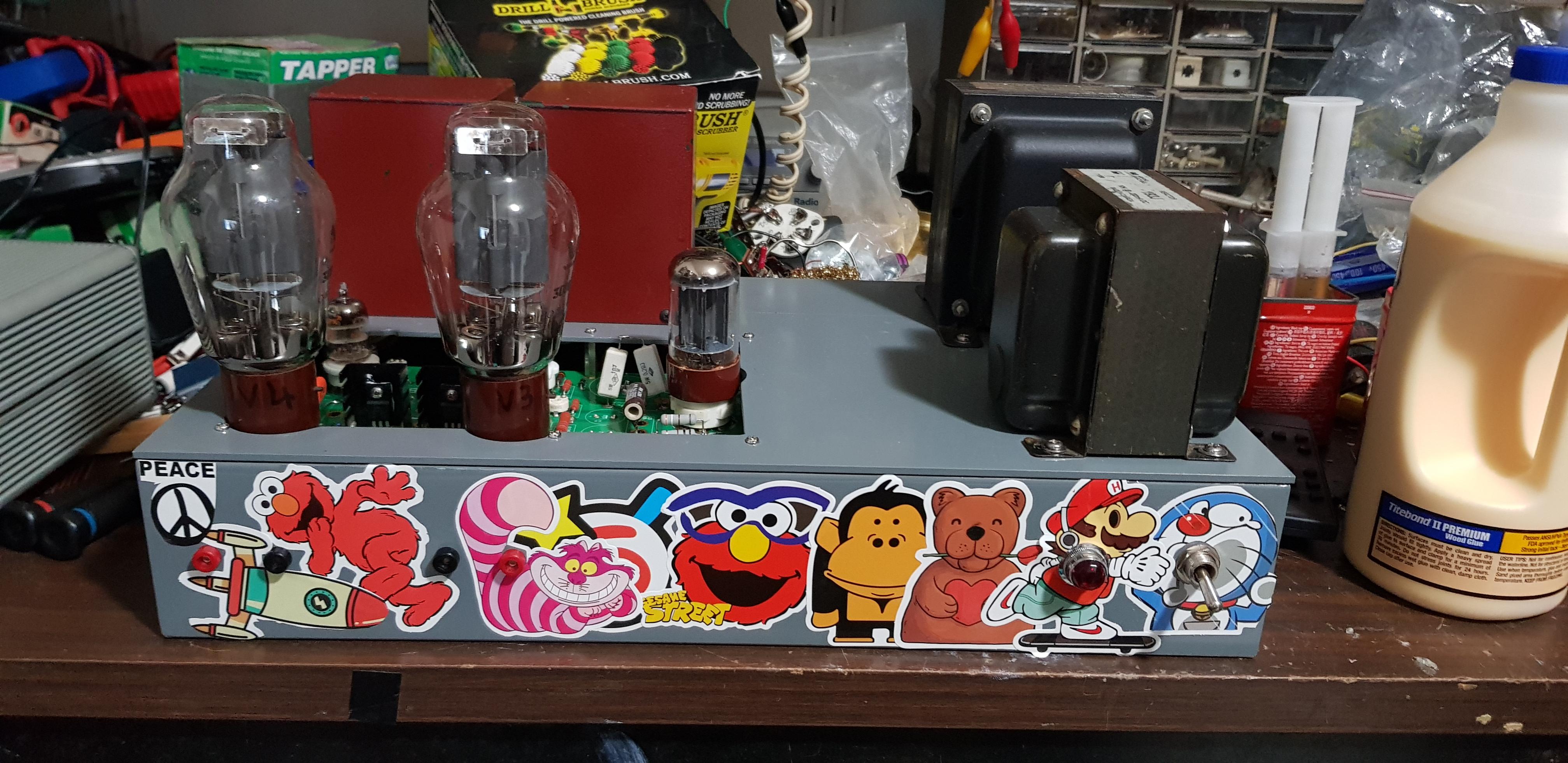

Wiring from TSE-II board to test jacks
I'll be installing some tip jacks in the top plate of my chassis to allow adjustments without opening up the amp. I have my trim pots on the same side as the tube sockets with small holes over them in the top plate.
Please check my plans for wiring these jacks.
For the driver tubes, I'll connect a thin wire to the lead of C9 and C11 on the driver side, with the other jack connected to ground. Two pairs of tip jacks, L and R. I'll use this to adjust the voltage on the driver tubes. 175V...correct? I hope the flying lead from the capacitors doesn't turn into a little antenna looking for him.
For the 300Bs, I'll connect a couple thin wires to each side of R18 and R29. Two pairs of tip jacks, L and R. I'll use this to adjust the current through the 300Bs. Measure the voltage and divide by 10 (R18, R29 = 10 ohm). 60 to 80 mA depending on the final B+...correct?
I'll also have a pair of tip jacks across R30 to measure B+.
The idea is to have several logically place small black top jacks on the top (or maybe back) of the black chassis to allow fiddling about without opening up the amp.

This is exactly how I wired my tip Jacks on the top plates. Plus I wired at the same points to volt meters fir the 300bs and drivers I put in the front of the chassis. . Works very well for me.

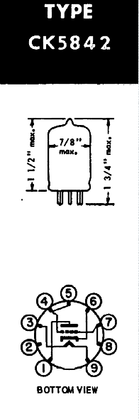

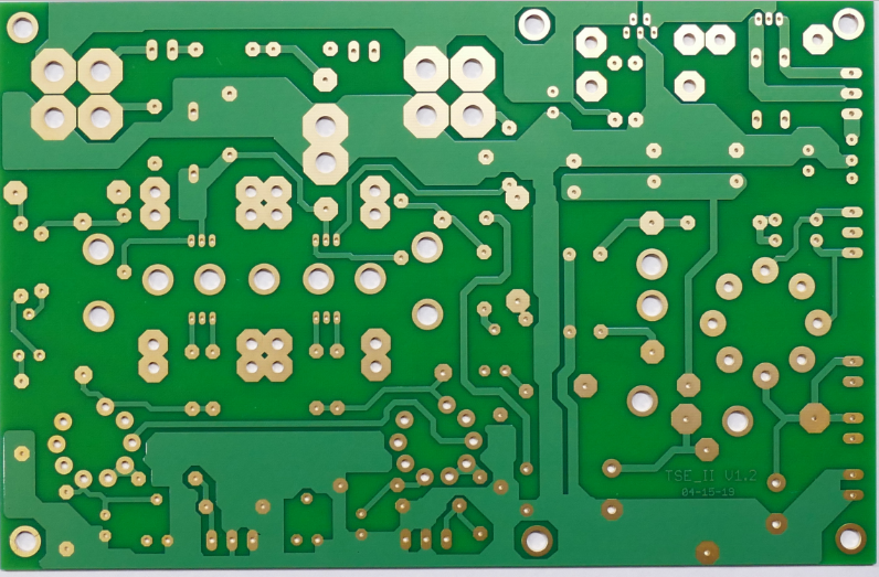

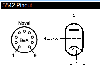

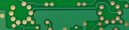

Schematic vs. PCB & tubes
Hello here guy's.
While small-adjusting :) my layout, before pcb are done; dubbel/trippel checking everything i came over one connection which i see on Georges layout which are not on schematic.
I'am sure it dosen't matter, but i will ask anyway.
If one look carefully at V1/V2 there is trace between pin 4&5 on the board, but only on pin 4 on schematic. Looking at the pinout's of the 5842 i see that 4&5 are internal connected in the tube, same goes for pin 7&8. Still learning i donno why 7&8 never are connected on any schematic i look at at the www,
I was hoping someone could explain that?
Rgds: Jesper.

5842 Grids are at pins 4,5,7 & 8.
You can choose to use any one or combination of, or all.
In the past (a different project) I have used 1 pin (whichever I chose) with a CC grid stopper as well as a ferrite bead to prevent oscillation.
I have not seen any oscillation issues with the TSEII.
