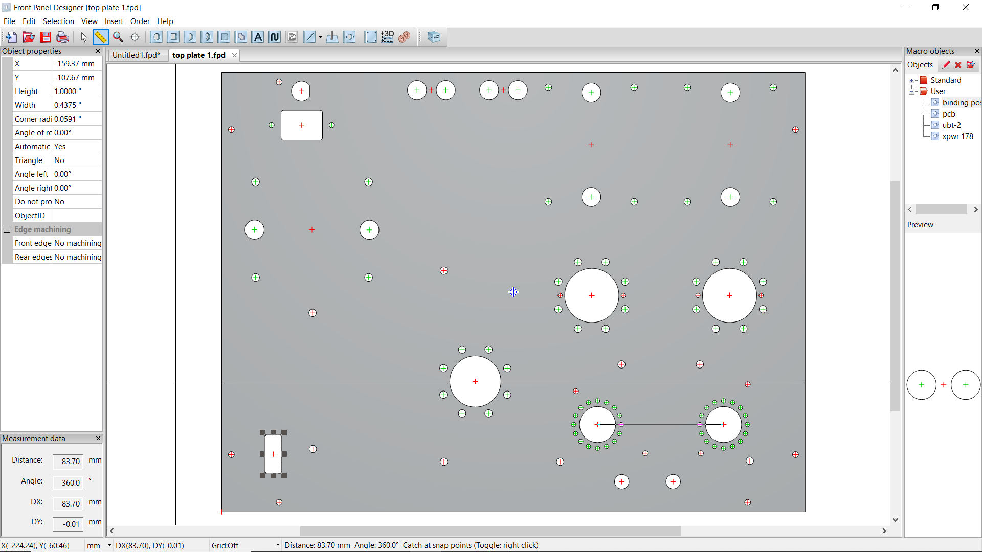

So I finished building my tseii board last night. Thanks George for the quick shipping!
I just had a question for everyone on my layout before I placed my order for the top plate. I attached a photo of the layout Im planning on using and was hoping for some feedback on any potential issues caused by placing everything on the top plate. Power transformer, choke and power switch are on the left side. Power plug and fuse are above PT. My main concerns are the orientation btw the PT and choke and the proximity of the OT to the binding posts. DO either of these things have the potential to cause issues? Thanks

Hi Bryce,
I am not able to see the mounting holes for the choke on the layout you posted. I don't know of any issue with the location of the binding posts relative to the output transformers. A couple things I saw were the output transformers look maybe a little close to the power tubes, and I didn't see access holes for adjusting the potentiometers. Some slots/holes located over the hot areas on the board could help (over devices with heatsinks and large resistors). Lastly, I don't know what the rest of your case looks like, but some of the holes near the back edge (binding posts, fuse ...) could interfere with a rear wall on the case.

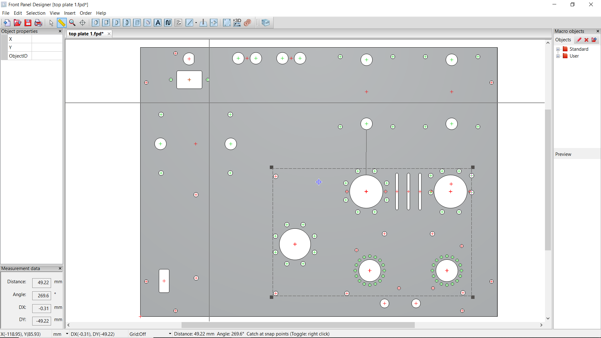

Thanks for the feedback. I made a few changes and posted the current plan.
The choke holes are on the bottom left corner situated vertically. I added some vent holes between the output tubes in order to get some fresh air to R36, which is supposed to get pretty hot. I was able to push the PCB forward a little bit which gives me about 2" between the tubes and the OPT. The access holes are there, just kind of small and hard to make out. The game plan is to assemble everything on this top plate and drop it on top of a wooden frame. I will cut a small ledge into the top inside edge of the wood for the plate to sit on.
Is there any other places on the board where I should put some additional vent holes/slots?

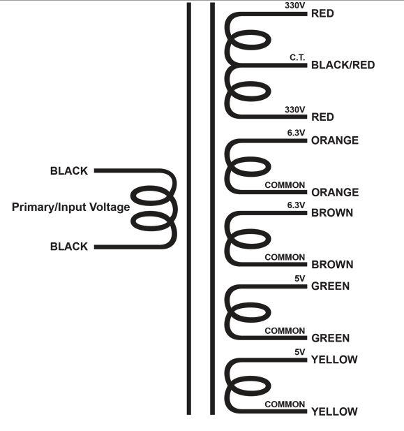

Transformer Wiring Question
I am using an Edcor XPWR247 for my power transformer and it has dual outputs for both the 5V and 6.3V heater taps. I plan to wire these in parallel to create one output of each voltage. I have checked each set to insure that when connected in parallel they will be in phase. Is there anything else to check? Are there any problems with doing this?

The overall layout looks good. The PCB holes look very similar to mine, hopefully you saved some time and used mine as a template.
Some questions/notes:
- Which tubes are you using? 300B dissipate more heat than 45's ....
- Seems like you won't use a volume pot? If yes, make sure there is enough space in the front to put it.
- The 2 holes in front seem like they are for RCA sockets? They may be a bit close if not soldering directly to the board.
- 90deg between OPT and PT look good. I did find that it helps reduce noise when they are on the same axis and not off-axis as in your layout. This probably also depends on the particular PT you're using.
- Consider an IEC switch with built-in fuse, it will save space on top.
- When using a wooden base, I generally like putting everything on top as you did. In this case though, it should be easy enough to drill 4 round holes in the rear panel right behind the OPT's for the binding posts. I think that would reduce some wire clutter when everything is hooked up.
Best of luck! I am also finishing up a second TSE now and am at the chassis phase

I'm pretty much a novice so take this with a grain of salt.
With the secondaries hooked in parallel, they will be rated at:
6.3V @ 8A and 5V @ 8A.
A 300B build needs no more than 4A (each 300B takes 1.25A) for the 6.3V tap and and 3A for the 5V tap.
I believe hooking in parallel will result in more heat being dissipated by the regulators.
I think I would just cover the ends of the extra taps wrap aside.

Thanks for taking a look and offering some feedback.
I did steal the PCB layout from your posting. Thanks for making it available! Saved me lots of time not having to do it myself.
I am going to be running 300b and no volume pot. Im currently feeding my amps from the pre-outs on my avr so Im able to use it for volume control. The rcas are at the front of chassis and are indeed pretty close to both the edge of the board and the edge of the chassis. I couldn't think of anywhere better to put them and space got tight after pushing the board as far forward as possible to make space btw the tubes and OPT. The fused IEC is a great idea. Ill probably order one right now and make the adjustments to the plate.

Bringing the windings parallel just makes the xformer capable of delivering more current, the regulators don't care.
Rest is correct :)

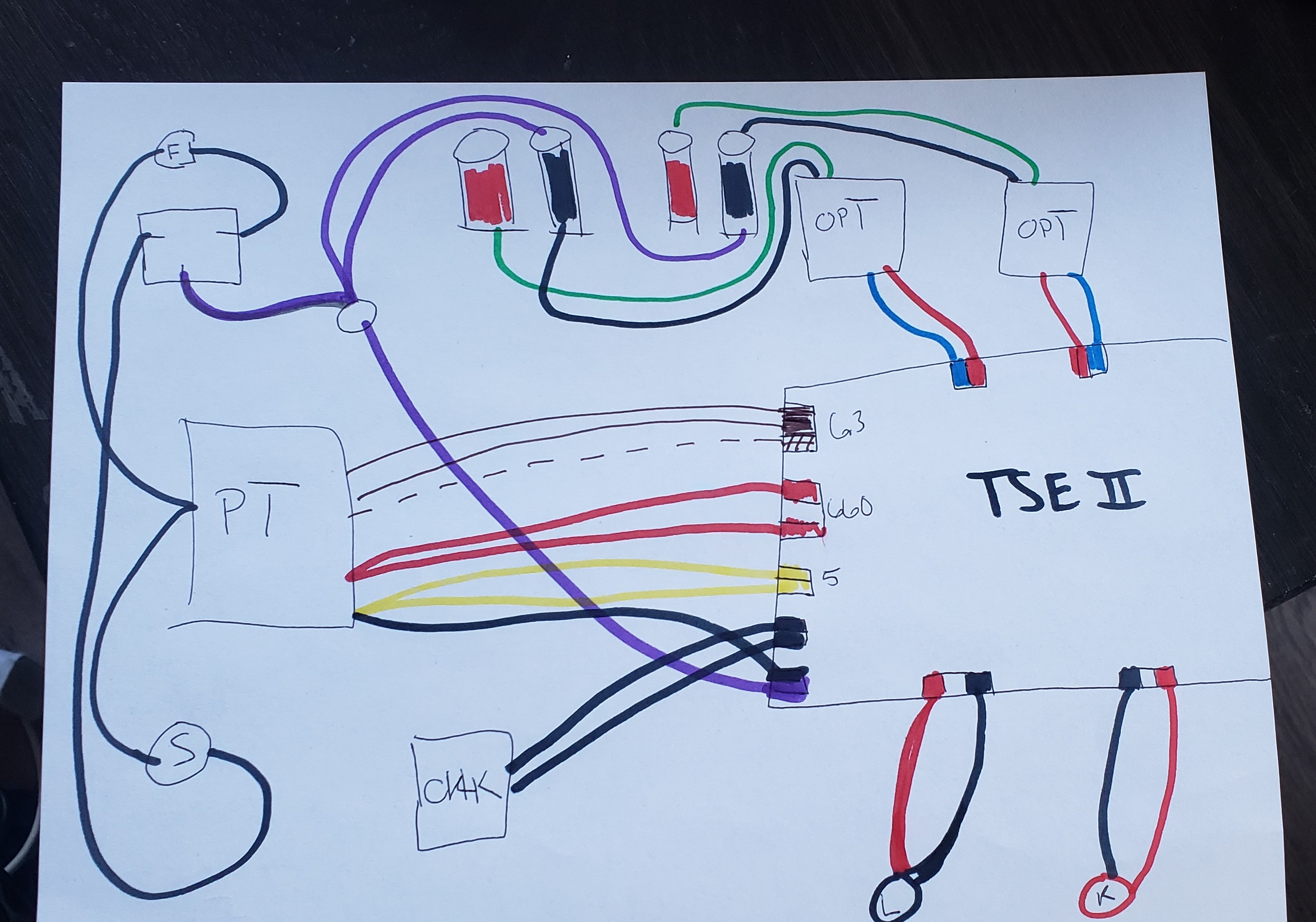

tse ii wiring plan
so this is my current wiring diagram. Transformer wire colors should be correct for UBT-2 OPT and xpwr-178 power transformer. Anyone see any issues with the plan? Please ignore my less than stellar drawing skills.

The fuse and the switch should both be on the hot lead. The fuse should be as close to the hot inlet as possible, an IEC inlet with built in fuse is nice for this.
