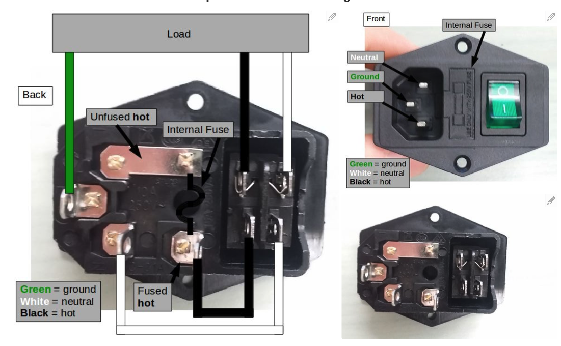

so wire should go.... iec-fuse-switch-pt-iec ?
The illustration below shows the connection sequence for the incoming line power. The line (or hot) side has voltage potential relative to ground so you want to fuse it as soon as it enters the amp to minimize chances for shorting the unfused portion of the line voltage supply. I stole the image from this website Wire Up a Fused AC Male Power Socket: 4 Steps (with Pictures) but I can't vouch for any of their instructions.
The IEC socket in the image also has a built in fuse and switch, but the switch could be located anywhere.

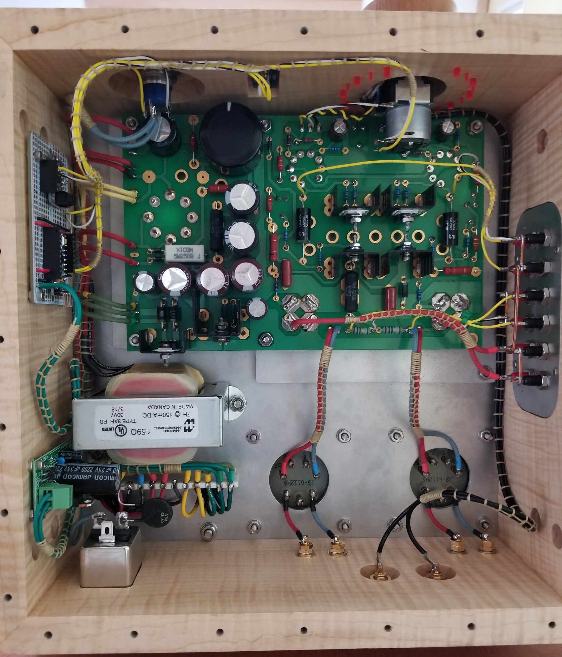

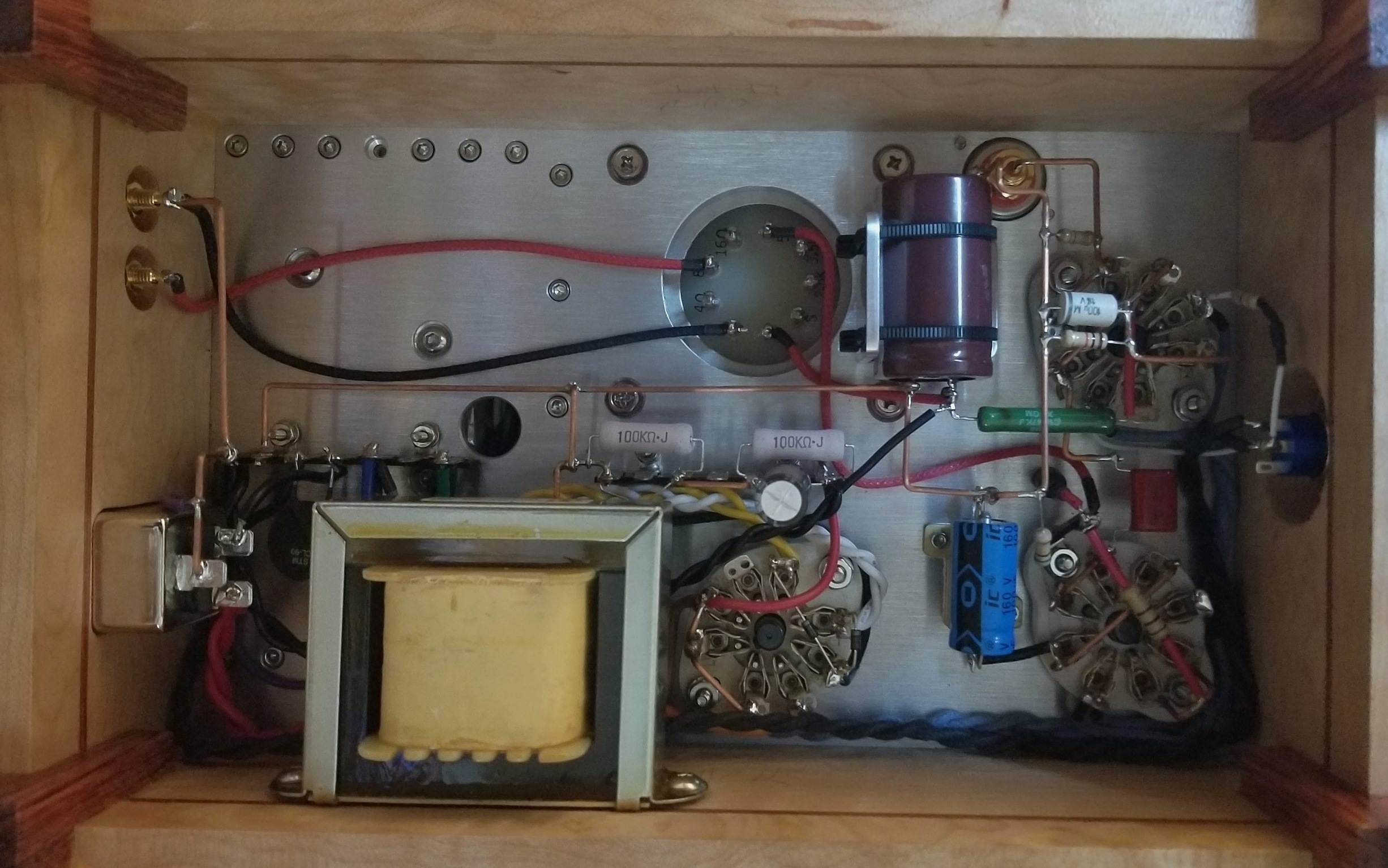

The illustration provided by csample is helpful, but I humbly suggest an IEC inlet like this one for three reasons:
  1. Since - like your power cord itself - there are only three lugs (Hot, Neutral and Ground), installation is practically a "no-brainer". All you have to do is connect three wires (see below) and you're done. Oh, and you can place the switch anywhere you want, within reason of course.
  2. Both the hot and neutral lugs are fused. Just be sure to order a bunch of 5 x 20 mm fuses of the correct rating. I usually order 10 - just in case. They're cheap.
  3. There's a built-in filter to reduce any spurious power line noise.
At around $16 US a pop they're certainly not what I'd call inexpensive, but I consider them to be an absolute bargain all things considered. The only janky thing is having to cut out an appropriate hole in the chassis, but if you're considering building a tube amp that's the least of your concerns.
The photos illustrate two separate installations using the same make and model linked above. The one on the left shows one of a pair of monoblocks I built some two years back. The right photo is of the TSEII I completed this past summer prior to bonding the ground lug to the chassis (this was completed shortly after this was taken). The ceramic strip makes the installation look more complicated than it actually is:
  • HOT => Inrush Current Limiter (the black thing) => switch => Xformer primary 1
  • NEUTRAL => Xformer primary 2
  • GND => Chassis
I hope this helps, and that I'm not flogging a dead horse. These things are easy to overthink, and I have to keep telling myself, "simplicity is key". :whip:

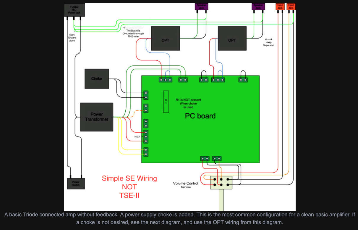

Some more TSE-II wiring questions
Like Bryce, I am also in the wiring phase on my TSE-II and had a question on the wiring diagram shared in post 598.
I don't understand the reason to bring the negative speaker output terminals to the star ground. I see that Tubelab does this on the Simple SE, but I don't see it in TSE-II build photos like Mr_Zenith's. Should this be done for the TSE-II?
Also, would it be beneficial to switch both the incoming line and neutral leads? I see the Simple SE schematic shows this (however SSE wiring diagram does not), and so does the power supply schematic for the Nelson Pass Burning Amp series. If both George and Nelson do it, there must be a good reason to do so. Can anyone explain?
Lastly, does the TSE-II need the inputs brought to the star ground like the Simple SE? (diagram below).
*** The diagram is from the Tubelab Simple SE Assembly Manual for Reference***
The cold side of each speaker should be connected to ground in case a short develops in the OPT. Such a short is rare but can put B+ on the speaker wiring.
Switching the neutral side of the line voltage is required in some countries. I personally don't switch the neutral, but I have a big box full of SPST appliance power switches.
The input connections to the board are routed to the negative side of the power supply caps on the board itself. This is the true star ground point. No other ground connections are needed or wanted.

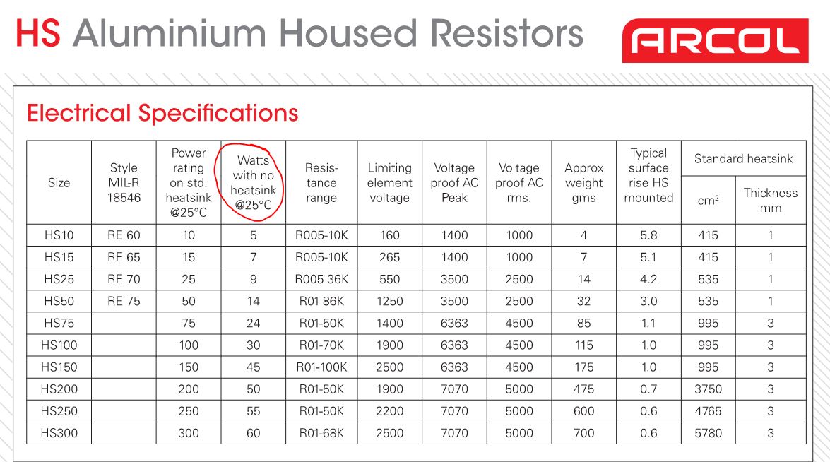

I'am in for the D6 diode... I have outboard R36 power resistor and going with the 300b tubes, so i have to use the 150v zener, making the heat goes more into the R36 as stated below right?
R36 is a resistor, it has bypass caps on both ends, you can mount it on wires in the next zip code and it won't matter. If you are going to mount R36 off board, use the 150 volt zener for D6 to put more heat into R36, and less into the mosfets. Make R36 a 10 watt part. That removes the biggest heat source from the board. Use one of those gold anodized chassis mount resistors and you put the heat into the chassis, not the board.
"R36 is a resistor, it has bypass caps on both ends, you can mount it on wires in the next zip code and it won't matter. If you are going to mount R36 off board, use the 150 volt zener for D6 to put more heat into R36, and less into the mosfets. Make R36 a 10 watt part. That removes the biggest heat source from the board. Use one of those gold anodized chassis mount resistors and you put the heat into the chassis, not the board. "
Jesper.
Hi Jesper, your quote was posted by George, so I would trust it. I am going this route on my 300B TSE-II. You probably already know this, but I was surprised to learn that the rated power values for chassis mounted resistors applies only when mounted to a heatsink. They are derated when mounted without adequate ability to transfer heat to their mounting surface. The screen shot below is from the Ohmite/Arcol catalog for their aluminum housed chassis mounted resistors.
Thanks, just needed to be sure that i had my notes right. About the heatsink i was aware, the same aplies to most other parts like mosfets, ldo's etc...

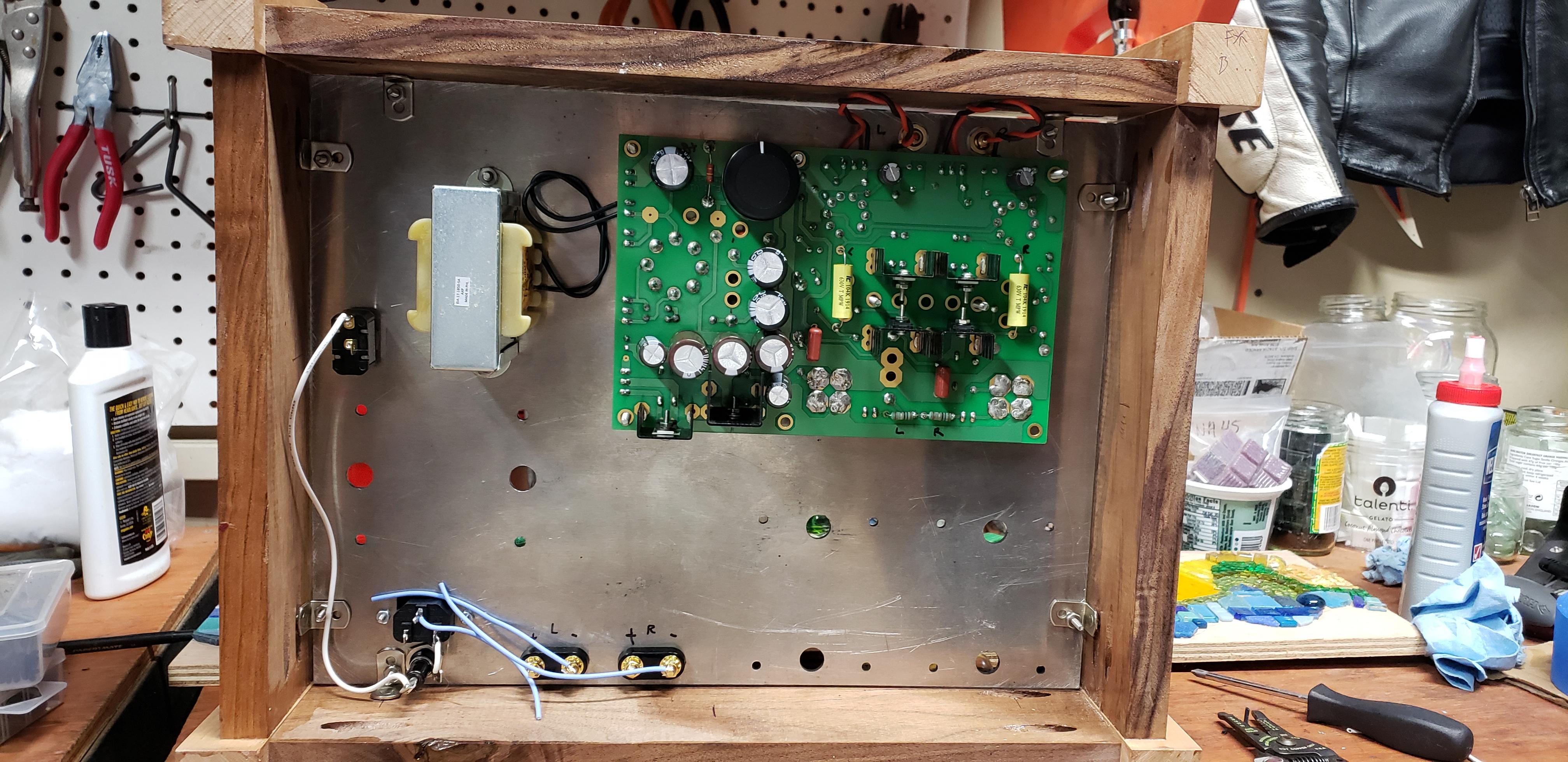

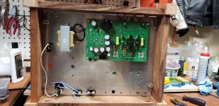

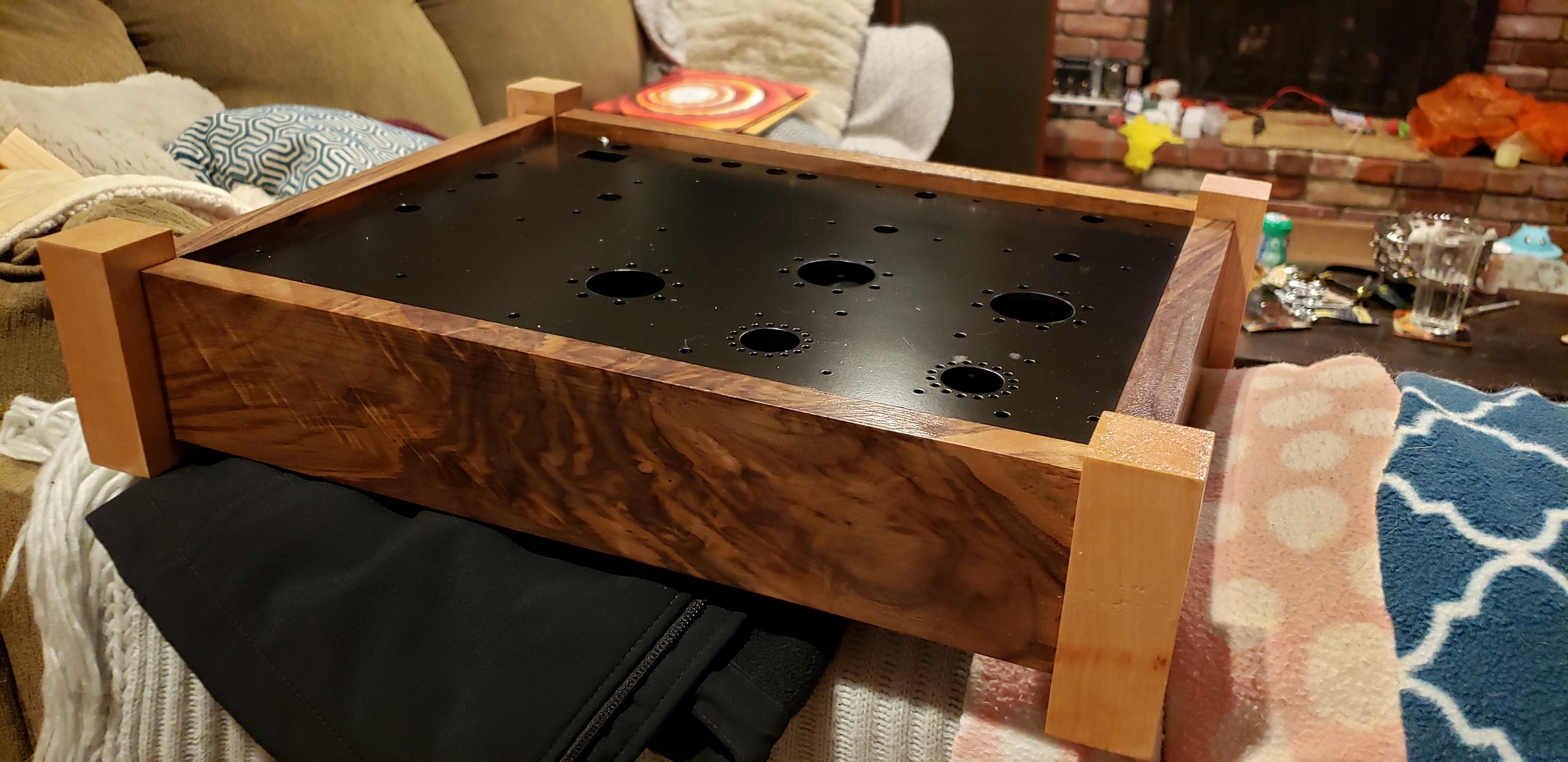

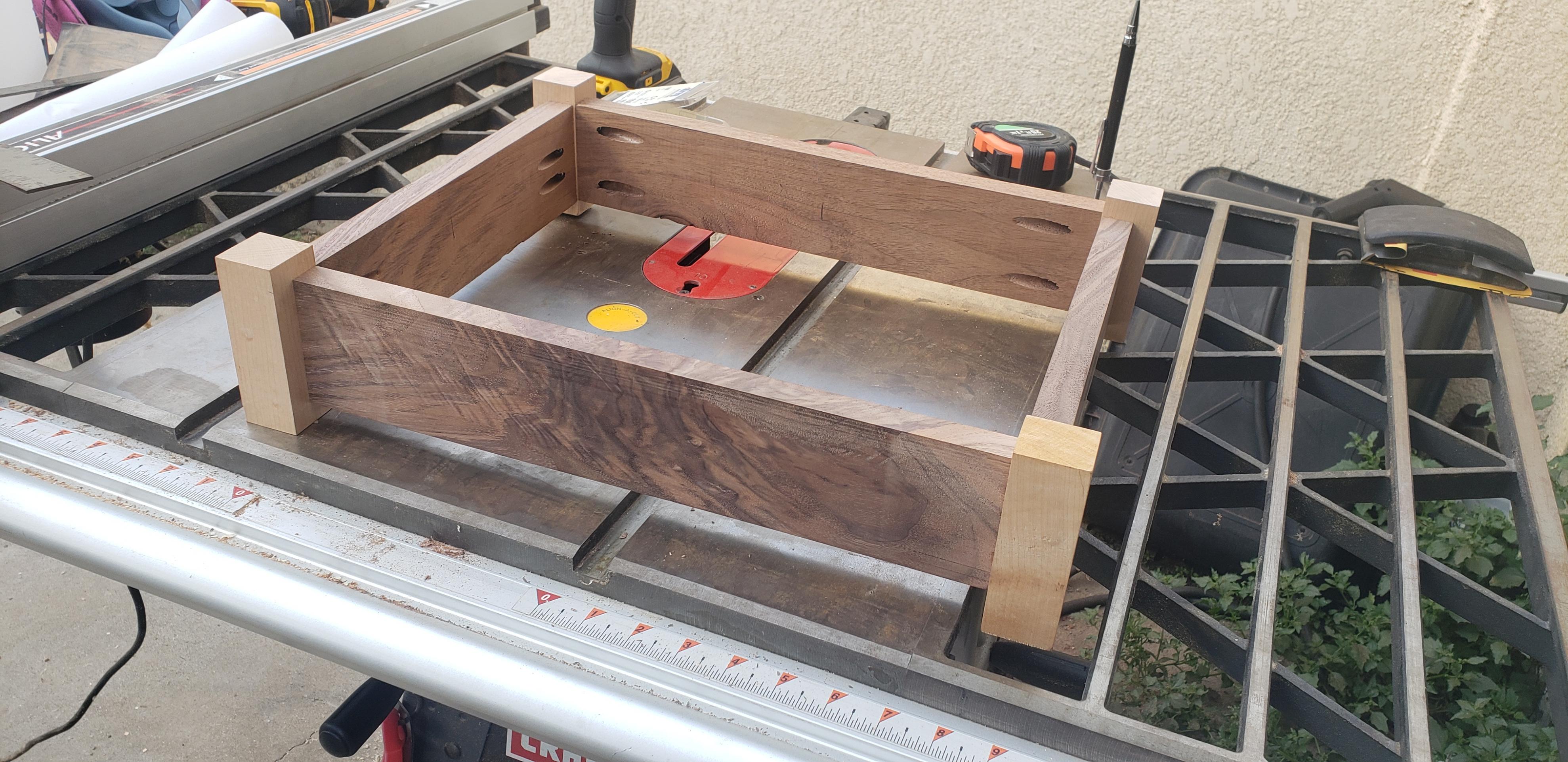

Making progress
I built my enclosure over the past few days and started final assembly. Just waiting on transformers and it will be done. It has been fun mixing multiple hobbies into a single project. Hoping the checkout process goes smoothly.
