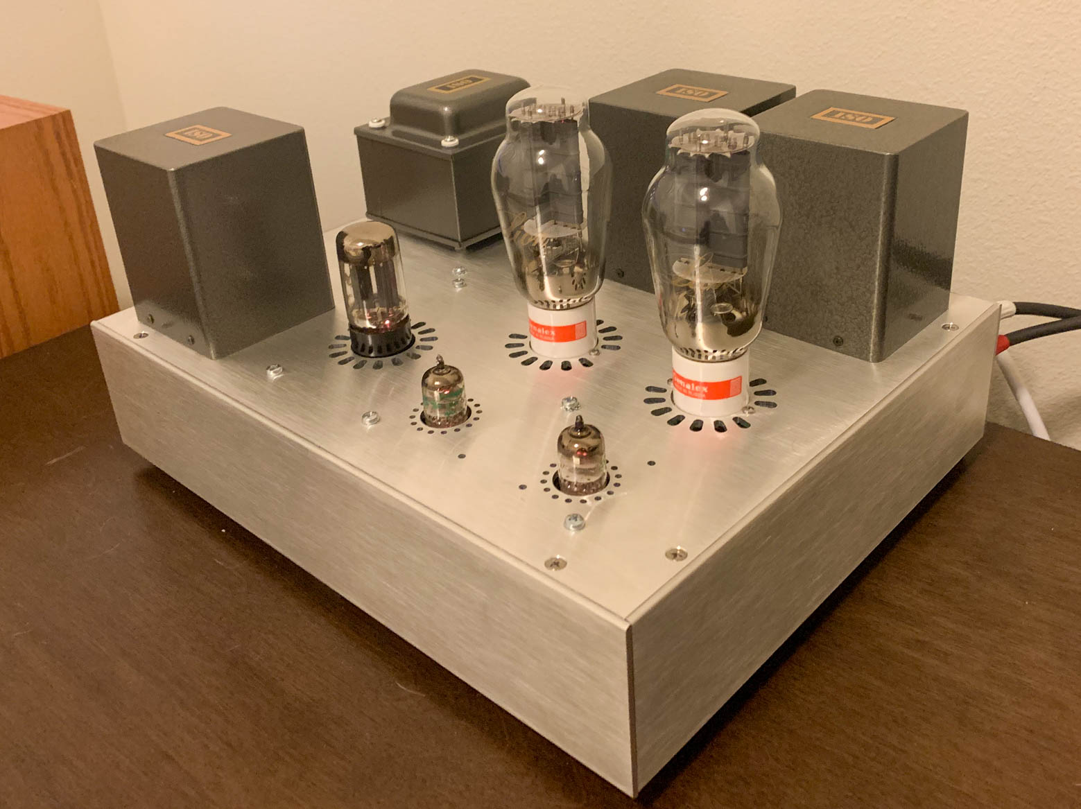

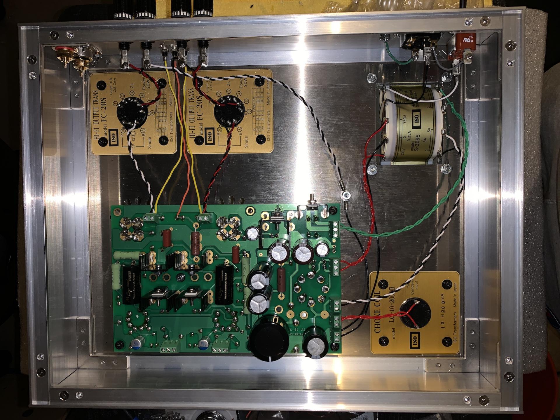

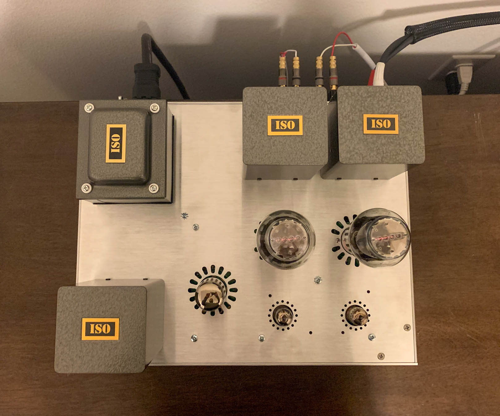

I'm wrapping up my second TSE and would like a sanity check on the grounding / safety of my work.
- Chassis is raw aluminum (not anodized)
- IEC inlet ground pin connected to chassis.
- Input RCA's are isolated from chassis and connected directly to the PCB (not pictured)
- PCB is connected to the chassis through the star ground terminal
- Both binding posts (-) are connected to the same screw
- The ISO opt and choke enclosures are fully painted, but on the other hand are screwed from underneath into the chassis. Do people scrape off paint on the bottom of these potted transformers?
All wiring is 19ga (kimber tcss)

Thanks!
So far sounds very good but I have only listened briefly and there are many moving parts in my system.
I'm using it with a Schiit Saga for remote volume control which is new to me (temporarily, until I build something in its place).
I still need to put the 80uF cap on the PS and run some FR and THD measurements with ARTA for sanity check that everything is working as expected.

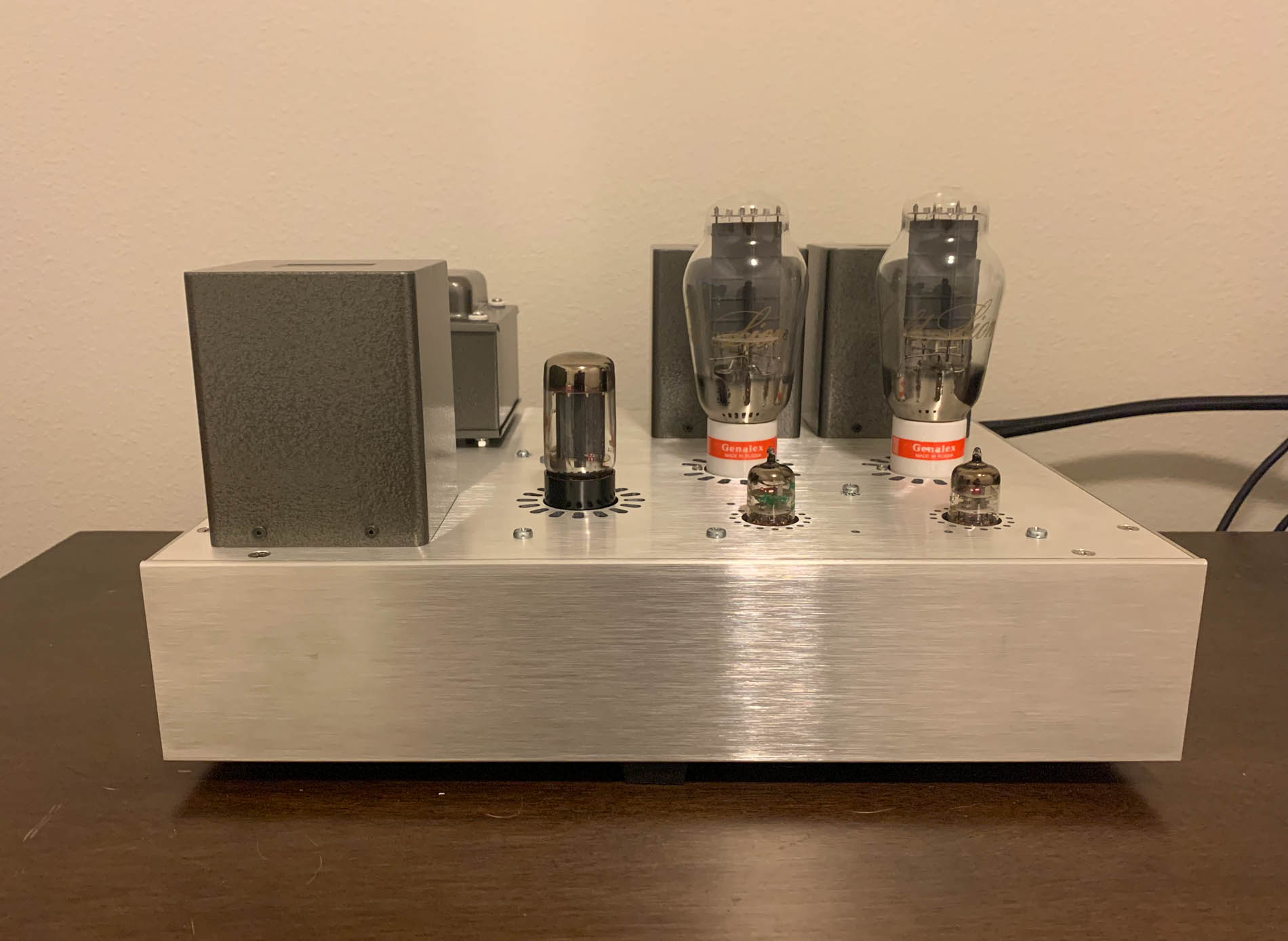

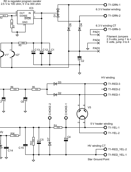

Hello all here 🙂
So my TSEII is working, and when i do some listening on my bench, i was wondering if any delay circuit would be any good?
There are lot's of articles around out there, and i therefore have some quistions regarding this.
In schematic i see the two heater windings (6.3 & 5.0) connected to T1-GRN-1/2 & T1-YEL-1/2.
If power is applied two those first and after say 60sec. the HV is applied to T1-RED-3/1 then the heaters would be heated up before B+ will come up.
Does anyone here use this on theyr'e TSE's ? - is it a good idea ?
One thing more, if this is good i suppose that the HV centertab should be connected all the time and not delayed ?
Rgds; Jesper.

Hi Jesper,
the delay is already implemented, it is the GZ34 tube rectifier, which causes the HV-supply to increase slowly.
HV-supply too high?
If you find out, that your HV-suppy is too high, besides lowering the value of C4, you could also try another rectifier which causes a higher voltage drop. I'm using the 5U4GB, which can be found NOS (even in Germany) at moderate prices.
The use of the 5U4GB has two disadvantages:
The filament draws 3 A (make sure your transformer can deliver this current!).
Because this rectifier is directly heated, the HV-startup delay is significantly reduced.
My current setup:
Transformer: Hammond 370HX; C4 = 22 µF (PP motor run cap); 5U4G, choke 10 H (0,2 A); C5 = 150 µF ....results in 270 V (HV); operating point of the JJ 2A3-40 is set to 55 mA.
Hi Jesper,
please connect a DVM across R30 set to V-DC and switch on your amplifier,
find out what happens!
Yep... B+ is slowly rising
But my thoughts was that more time could be even better, but ofcause the slowrise is nearly as good as using a variac on it i see, thanks for clearing it out for me 😛
So i stick with a softstart build i am gonna make now.
Jesper.
Since the TSE and TSE-II implement a bipolar supply with unequal current draw, lifting the CT or delaying it could have unpredictable results depending on tube warmup time. This could be seen as a positive voltage on the negative supply and not a good idea.
Yep... B+ is slowly rising...But my thoughts was that more time could be even better
The warm up time of a 45 or 300B is still faster than a 5U4 since there is more thermal mass in the 5U4's filament. There are possibly some 2A3's out there that are slow, but this is not generally a problem.
Slowly turning up the input voltage on a Variac allows all supplies to come up at roughly the same time. The TSE and TSE-II use a tube rectifier for B+ and a solid state rectifier for B- to insure that excess negative bias is there BEFORE the output tubes are warm so that they are cutoff during the first few seconds of conduction. The B- stays pretty far negative until the B+ comes up and starts pulling the grid bias more positive.
