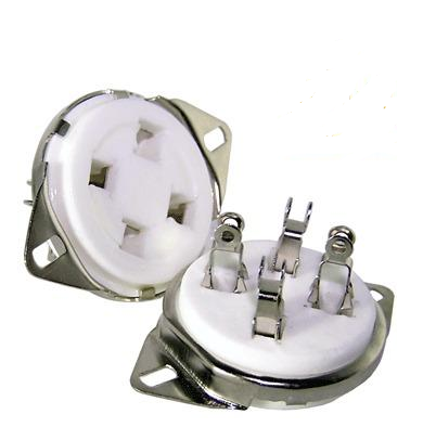

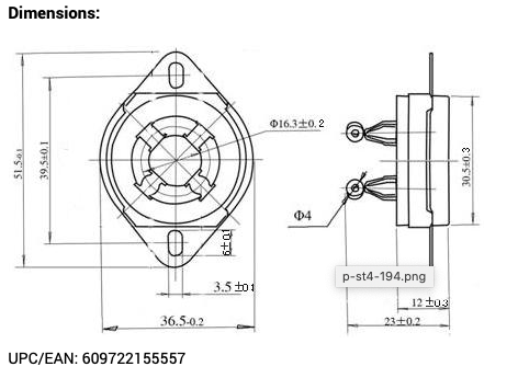

4 pin sockets
What have you guys used for 4 pin sockets? I haven't found any that are pc mount. Any suggestions?
coopercustoms,
There is good info given by George on how to install the the 4 pin sockets on PCB towards the end of this web page:
Tube Sockets | Tubelab
Theses sockets might work too, but have no experience with them:
2PCS EIZZ Quality Ceramic 4pin Gold Plated U4A Tube Socket Audio Amplifier For 300B 2A3 811 572B 5U4G 6B4G 274A 866 PX4-in Amplifier from Consumer Electronics on AliExpress

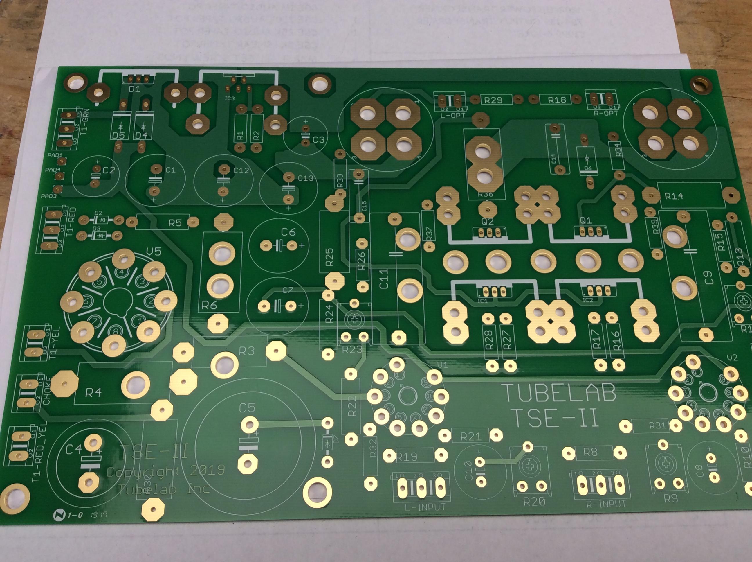

My suggestion would be to not use PC mount. But get normal ones. Fit the normal ones to the chassis plate and wire it to to the pcb with wires. I just hate the idea (despite many that have never had a problem with it) to push and pull something soldered to a pcb.What have you guys used for 4 pin sockets? I haven't found any that are pc mount. Any suggestions?
I used the "normal ones", bent the pins and soldered to the PCB as in George's tutorial and screwed the tabs to the top plate. There is no stress on the PCB this way
coopercustoms,
Same thing as these:

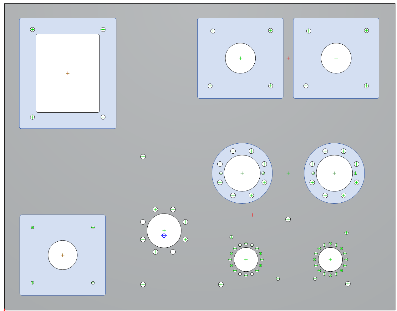

Does anyone have a Front Panel Express file for the TSE-II they'd be willing to share? I'm struggling to build one of my own using the program.
Here is one that should help you get started.
You'll have to adjust the holes for the transformers, and the PCB standoffs if you dont want to use the ones I did.
This one also has holes for mounting the 4-pin tube sockets to the chassis.

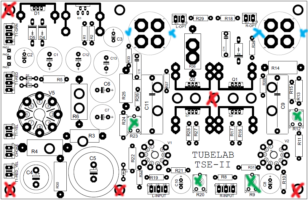

This is super helpful -- thanks! What PCB standoffs did you use?
I used these M4, 16mm length as they matched the height of the 4-pin socket tabs.
The attached picture corresponds to the holes around the PCB in the FPD layout. The red marks are where I used standoffs, green are the holes for the pot adjustment, and blue is where I secured the 4-pin socket tabs.
If your 4-pin socket dont have mounts for screws, then I would also use the 2 standoffs right above them
