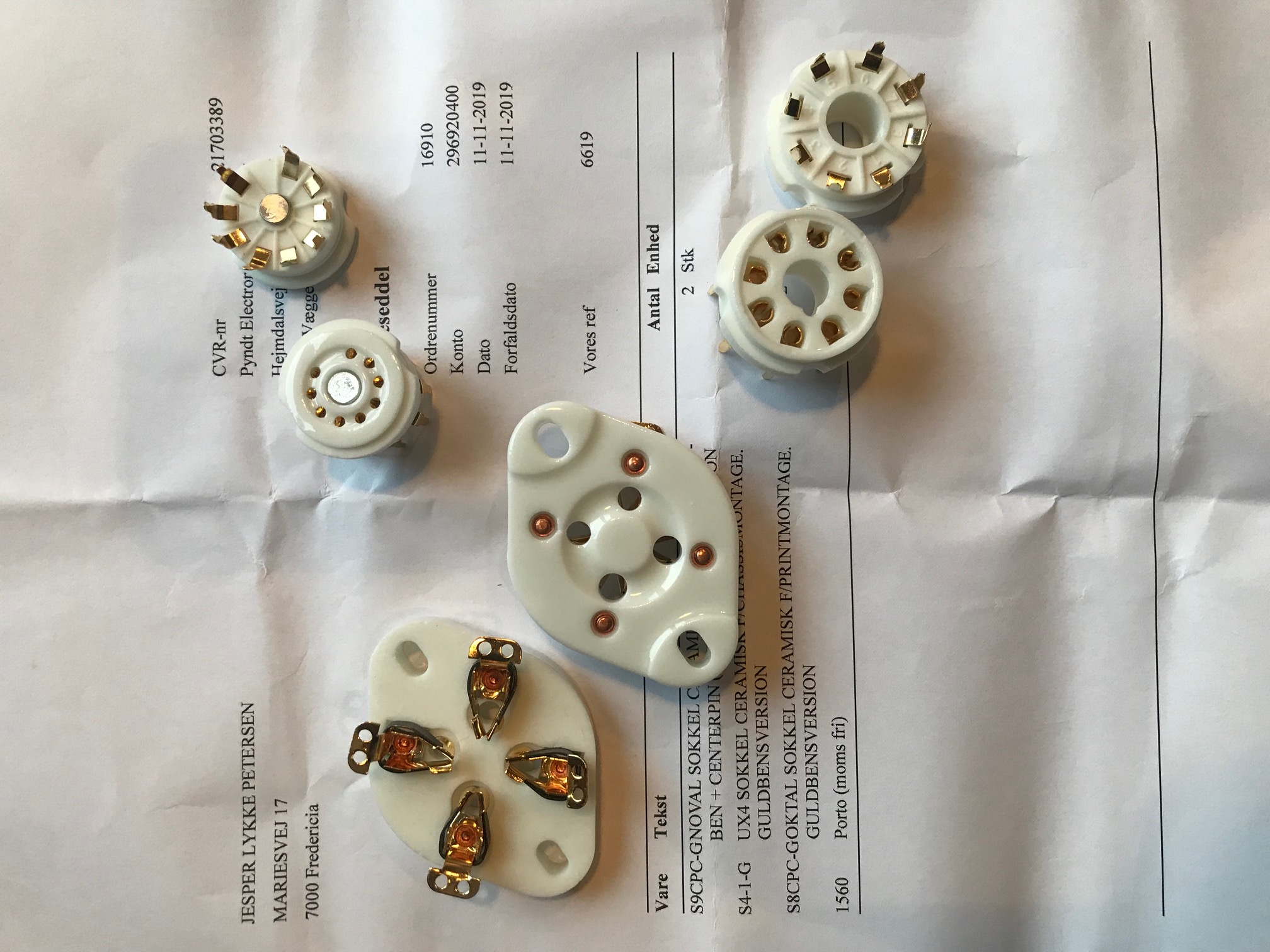

So while gathering information i found that stuff about the different tubes is kindoff hard to get, as most stuff on web is SS related (well where i was looking anyway).
So what i think i know now is that for a build to suit my needs, i have to use 300b for output tubes, giving me approx. 7-8 watts of power. - So this is fine i think, but what about rectifier (octal) and "input" (9pin mini) tubes, is there some recommandations for them? - I think i am now, regarding my knowledge into tubes, that i could need some kind of recommandation to study further with, if i am understandable?
I attached picture of newly purchased sockets!
Anyway, have a nice day out there, and thanks in advance.
Rgds; Jesper.

Regarding your sockets, I'm not sure those 4-pin will fit the standard PCB, but you did mention in the previous post that you would make your own so you'll probably make them fit accordingly.

Yes i do my own layout; not because i don't want to buy TL's nice one (well not until if i fail), but because i really like doing pcb's from scratch.
The layout i do, will fit my 4pin sockets nicely.

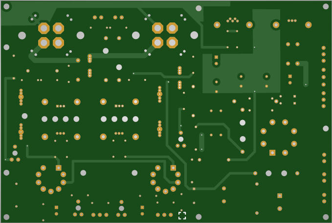

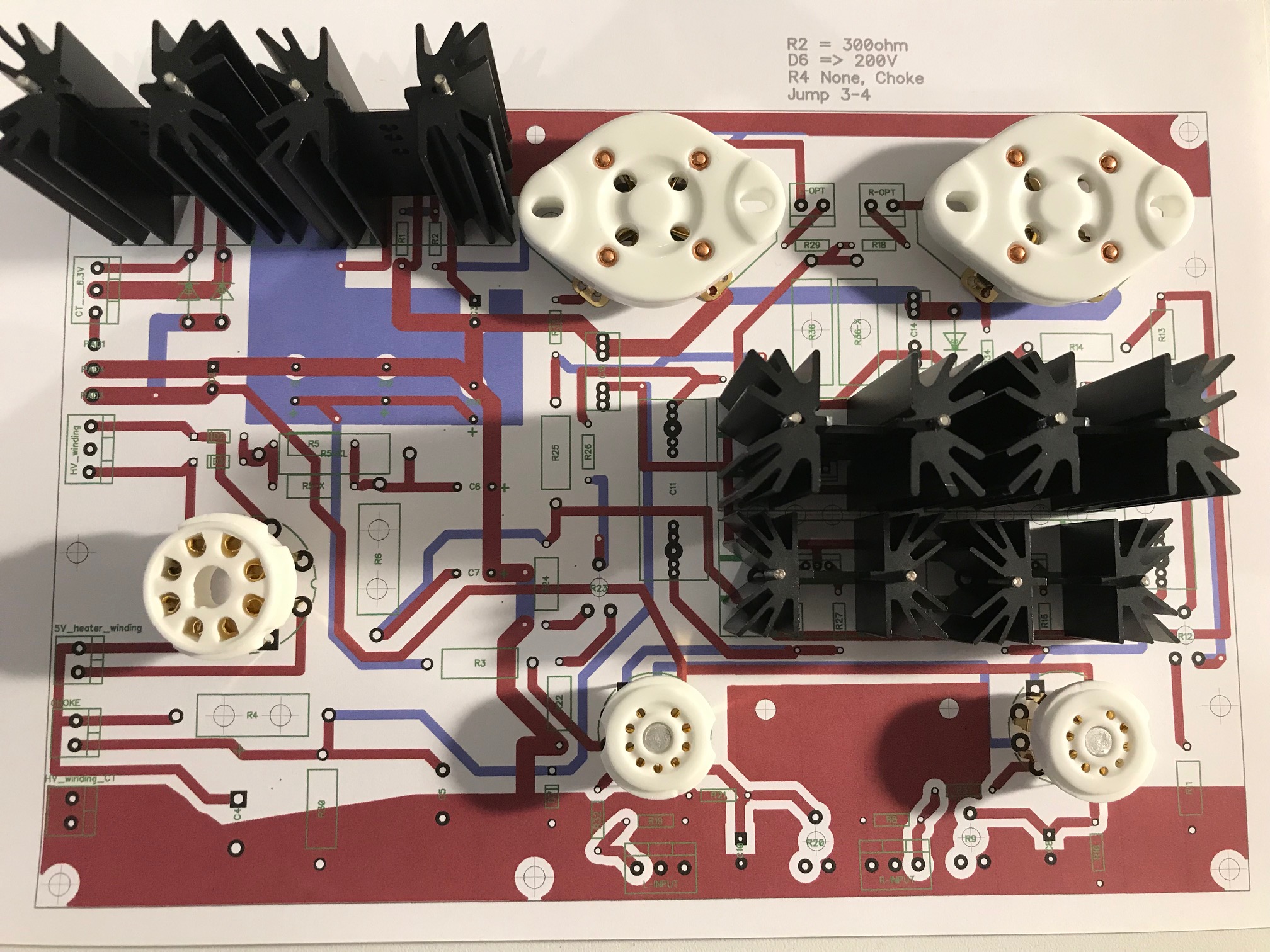

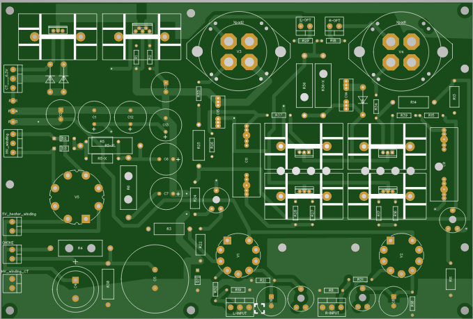

Layout & parts
Morning here 🙂
I think i am done with the layout part, and just ordred some raw dual pcb for it.
Parts & heatsinks will be on "back" of pcb, tubes at "TOP" side pcb.
I added big heatsinks for the hot parts also.
I am as i wrote before going with the 300b tubes setup, so i did make space for bigger or offboard R36, same applied to R5. - I will use choke instead of R4. D6 will be the 200v version. Are there more things i forgot? / considerations? (just asking, maybe i forgot obviously things?)
My build will take some time, as both cost and time are factors for me ofcause. I will as soon i finish my pcb order the Mouser parts through.

Hi lykkedk
I like the large heatsinks on your board. I am new to tube amps so I can't provide other feed back though. I am a bit curious what impedance you want for your output transformers. The Edcor was an 8K and the Toroidy 3K. How many ohms are your speakers and which tap on the Toroidy do you plan to run them on?
