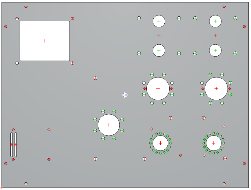

The dimensions are 15.5 x 11.75.
You can get literally any size you want form Landfall.
I ordered the "raw" aluminum because I wanted to get it powder coated originally.
I couldn't find a place to do it reasonably cheap so I ended up giving it a brushed look using 100grit sandpaper.
I may finish it off with wooden panels on the side.. still undecided on that.
If I were to do it over, I'd add maybe 0.5in-1in to the depth to allow more spacing between the power tube and OPT.
Because I experienced some hum in the mock up, I went wider than originally planned to allow for as much space as possible between the OPT's and PT.
I can share an FPD for the top plate if anyone wants. It could be helpful even if you just want the PCB holes.

Hah, you give me too much credit !! I purchased the chassis from Landfall Systems, including the top panel. I must say that this has probably been the BEST experience I have ever had with a vendor and can highly recommend using them.
Their prices are pretty good too.
Initially, I only wanted to order a custom sized aluminum base from them, and then a top plate from Front Panel Express or get a blank plate and drill on my own.
They charged only $25 extra (to the cost of the top plate) for CNC it, all I had to provide was the .FPD file and they did the rest.
One other reason I didnt really want to drill my own was because of the square holes for the Power transformer and power inlet
If you are able to. I am always a little envious of some of the finished builds here, metalwork and woodwork are not my strong points - I can do truly impossible things with saws and drills, and not in a good way - so every little bit helps.
FPD attached. (also attached an image so you get an idea what it is without having to open the zip)
Keep in mind this layout was for the ISO power transformer and EP OPT's.
The PCB layout should be good as-is, unless you use different UX4 sockets that don't have holes for mounting to the top plate.
The PCB area includes the 4 holes for bias adjustment, and selected holes for mounting the PCB with standoffs.

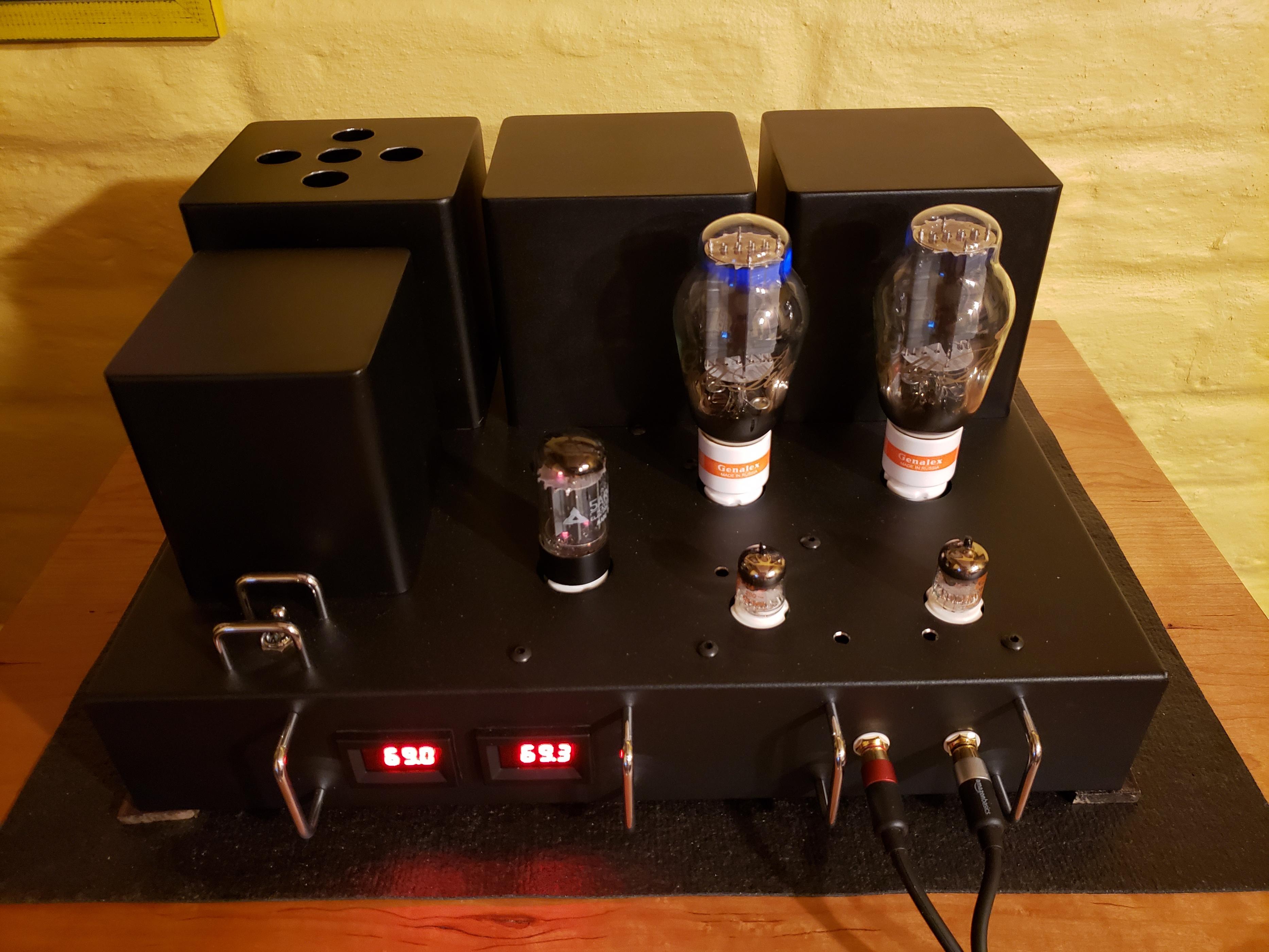

My Finished TSEII
So I started with an SSE, built a second one using KT120s and they both sound great. Recently finished a TSEII and it sounds amazing. Have tried vintage RCA, Mullard and various NOS Military tubes and Golden Lion 300Bs. Outputs are Hammond SE 5000K impedance (the massive ones) and power transformer is Hammond 276X (and also an Edcor of similar specs). Power transformer gets plenty hot over about two hours (hence the vent holes in cover). The chassis is Hammond with some Chinese Ebay covers. Ammeters are a luxury but make life fun. B+ is running about 380 and most of the resistors are Vishay mil-spec and havent seen signs of R5 failing. Do have some really big heat sinks on ICs and a small 12V fan. Thanks George and everyone who posted to this thread to make it possible.
