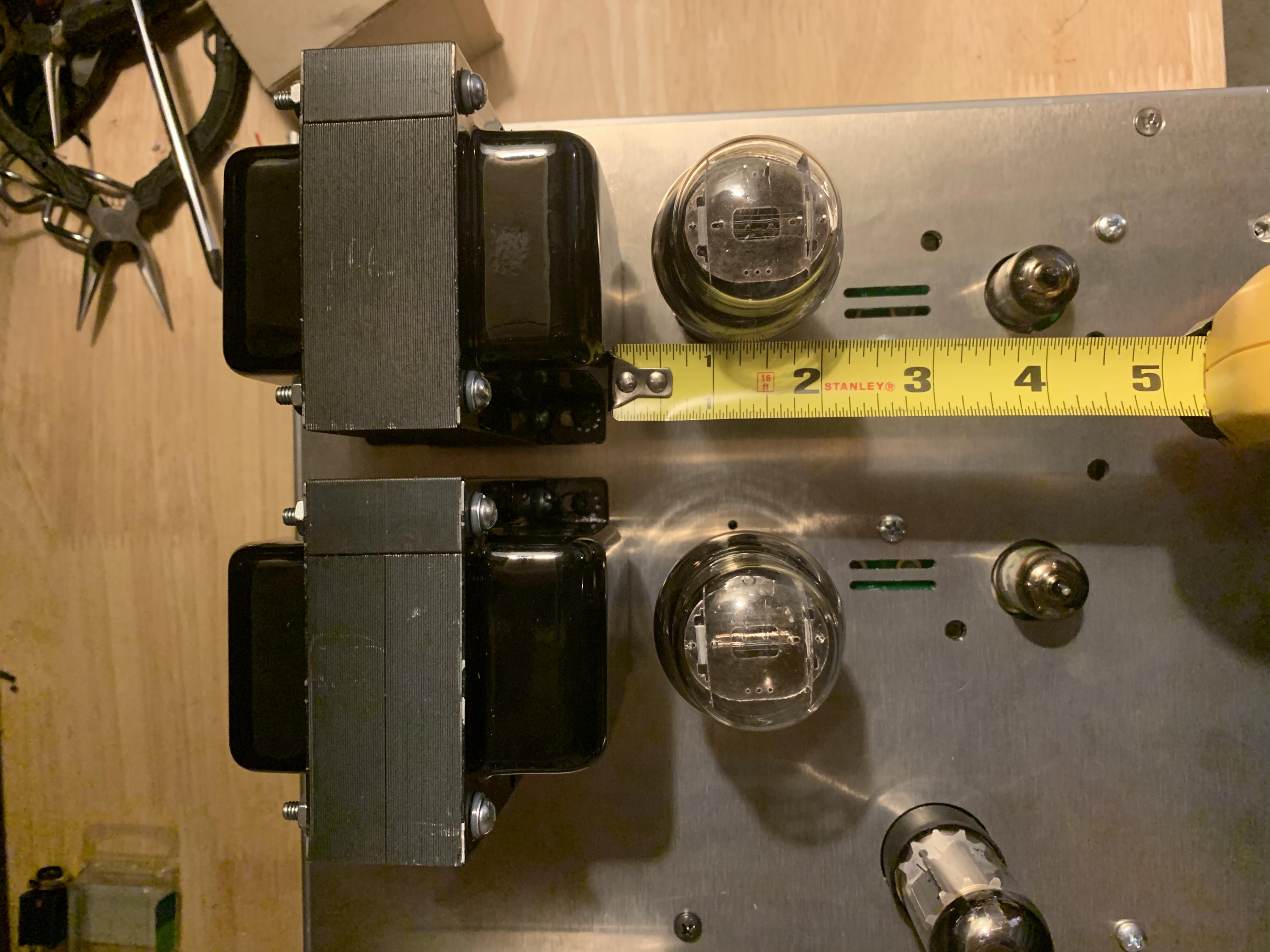

That does look a bit close, but I'd just run it and see at this point. Probably not a huge problem with 45s as the combined heat from the filaments and plate dissipation is maybe at 15 W for each tube (someone chime in if I'm wrong). I'd be much more concerned if you were running 2A3s or 300Bs.

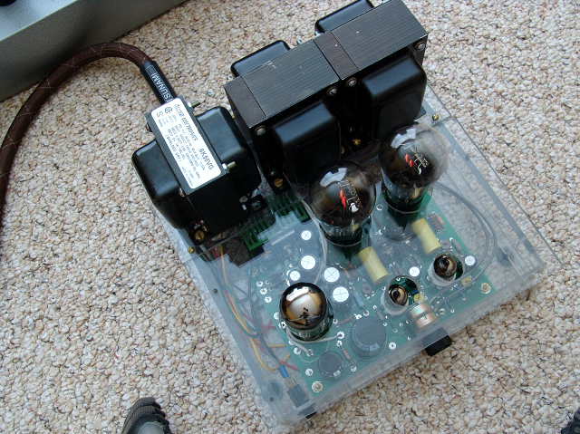

Here is an early picture of the very first TSE ever made. At this time (2003) it still had the prototype PC board in it. Shortly after this picture was taken I rotated the power transformer 90 degrees to kill some hum created by magnetic coupling.

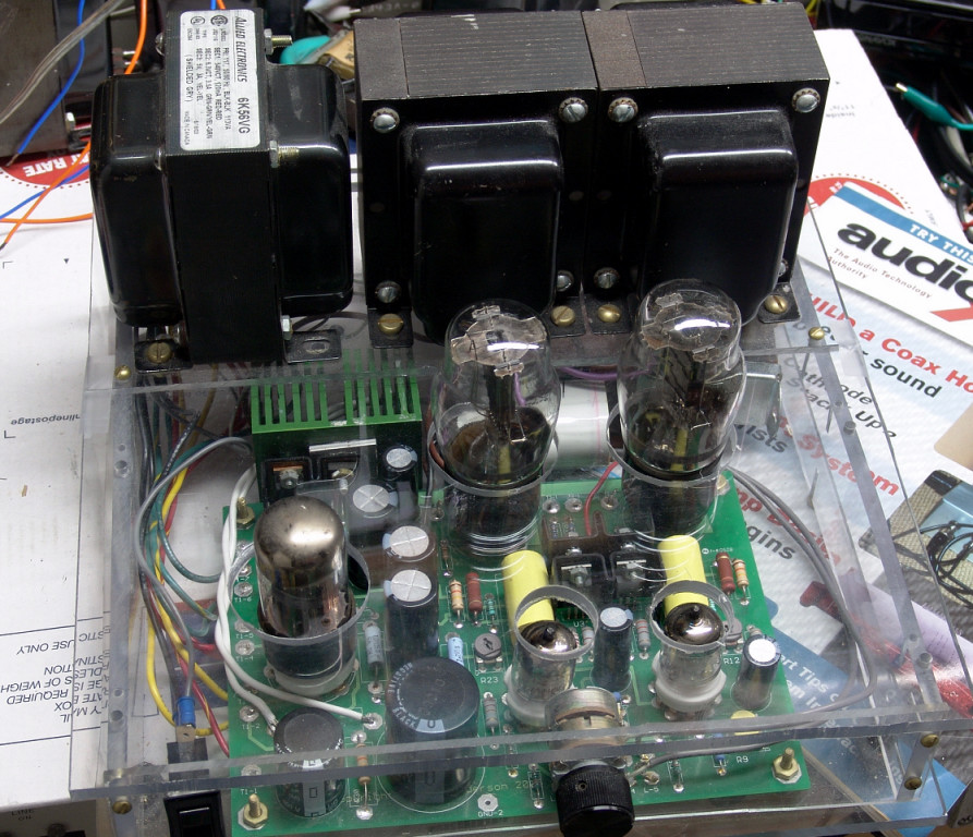

I swapped out the PC board once the first production batch was made, and added a heat sink to the regulator so that I could run 300B tubes......the 300B's nearly touch each other and the output transformers.
In 2006 our house was trashed by a hurricane and this amp got rather wet. It had been placed on a shelf and the case had filled about halfway with nasty water. I cleaned it up and it played on just fine without any new parts, but the power transformer would fail several months later. It looked fine on the outside, but as quite rusty and green on the inside. I swapped it out, and all was well.

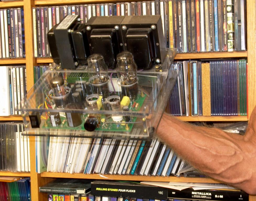

In 2008 I took the amp to visit some very expensive Lowther based horn speakers with 106 dB sensitivity. Here some hum was evident, so I added a choke and supplemental cap to the power supply. They can be seen in the hand held picture, the white cap can be seen behind the output tubes, and the choke is under the right OPT.
Clearly this amp is a perfect example of too much stuff crammed into too small of a cabinet, yet it just works...very well.
It is now 2019 and the old amp still works just fine. It has run some 90 year old NX-483 tubes for the last 10 years. They are like a 45 with a 5 volt heater....seen in the last picture.
If your amp works well, and the OPT's do not get too hot to touch after hours of playing, I would not worry about it.

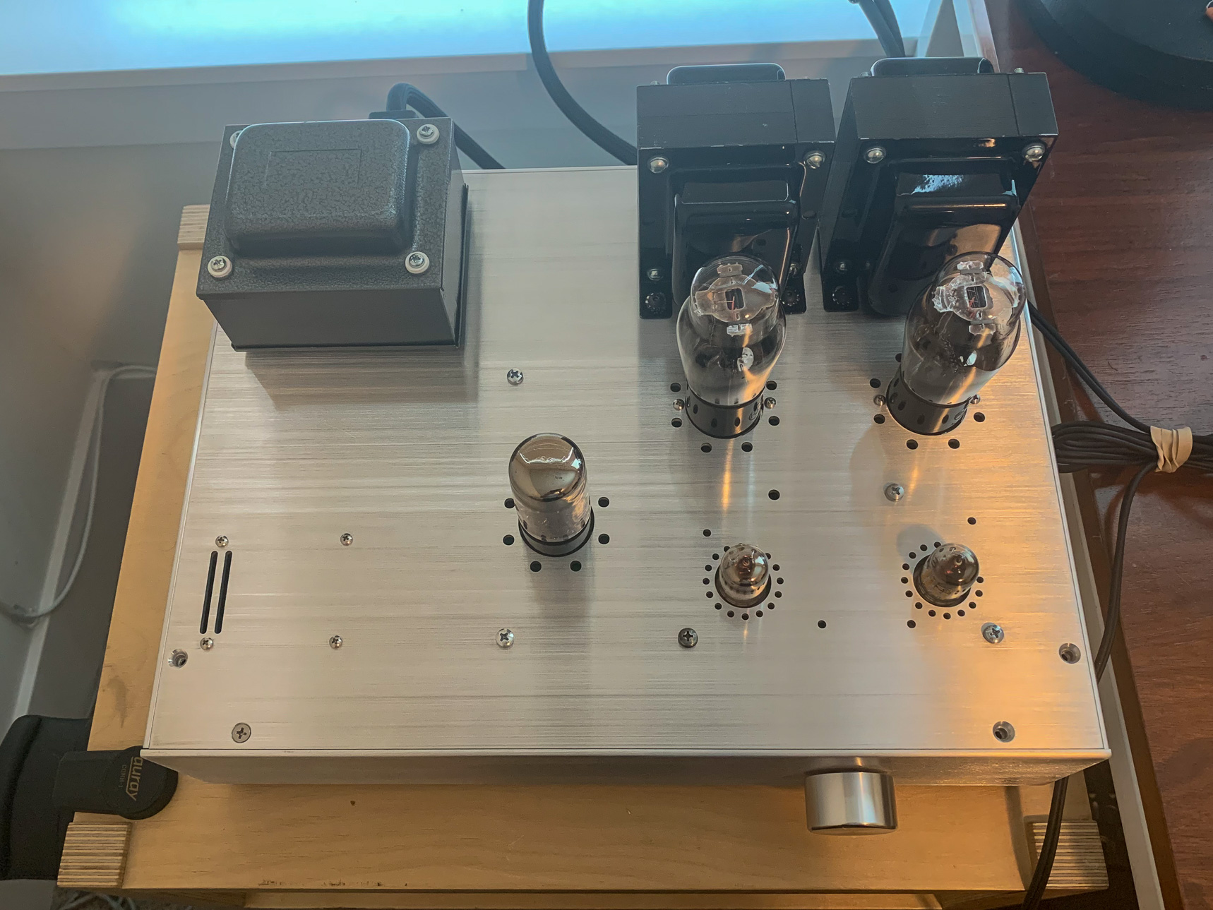

Thanks both as always. The OPT's did not get too hot but nonetheless I re-did the top plate. I moved the OPT's a bit back and the PCB forward and gained another 0.5in there.

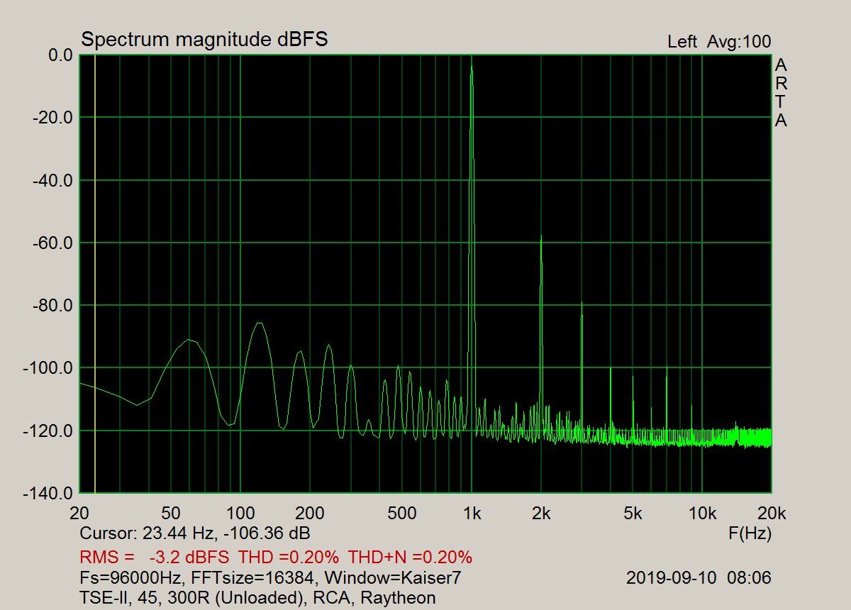

Headphones are temporarily connected to a terminal strip while I run a measurements with and without load resistors for matching 300R headphones.
The current results are actually that unloaded had the best distortion without much (if any) loss in FR. I wrote a more detailed response in a dedicated thread I started regarding that.
I also ran the same FFT with Raytheon (Windmill Getter) 5842 and WE417A.
The WE measured with marginally better distortion, but I have found are more microphonic.
Beautiful job on the top plate. How did you get the vent hole around the tubes so evenly spaced?
Hah, you give me too much credit !! I purchased the chassis from Landfall Systems, including the top panel. I must say that this has probably been the BEST experience I have ever had with a vendor and can highly recommend using them.
Their prices are pretty good too.
Initially, I only wanted to order a custom sized aluminum base from them, and then a top plate from Front Panel Express or get a blank plate and drill on my own.
They charged only $25 extra (to the cost of the top plate) for CNC it, all I had to provide was the .FPD file and they did the rest.
One other reason I didnt really want to drill my own was because of the square holes for the Power transformer and power inlet

That's good to know, I plan on building the SE2 this winter and $25 for the CNC work is a steal. I've built the other TL amps and drilling the holes (neatly) was the most tedous part of the whole thing.
