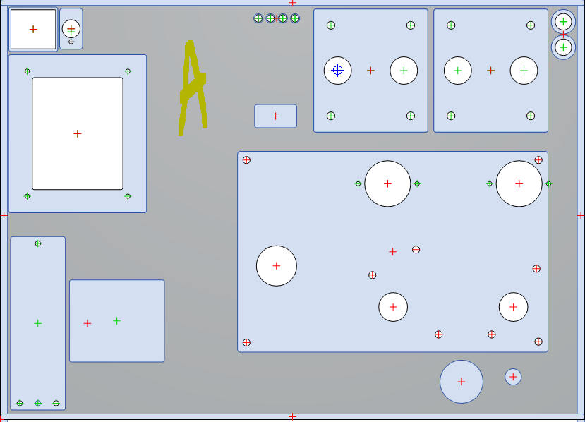

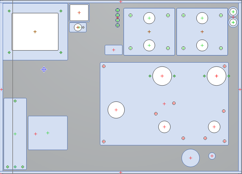

I have 2 options for layout and would appreciate feedback.
-Dimensions are 16"x11.5"
-This is for a headphone amplifier. Volume and headphone jack are in the front right.

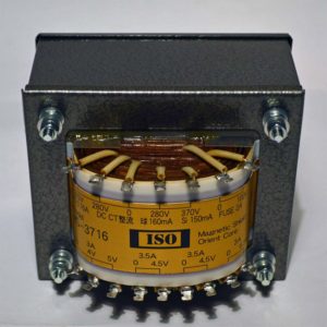

-Power transformer is similar to the one pictured.
-Bottom leftis tomchr's 21st Maida Regulator which has proven to be effective in eliminating hum with my setup.
-Top plate will sit on top (not permanently screwed) on wooden base so prefer all parts on top plate.
Generally, I prefer the non-A option. Centers of all transformers are aligned on-top and (unless I'm mistaken), the center axis of the PT is not "pointing" at the tubes or OPT's. The only thing I dislike about this is the position of the IEC inlet.
Option A solves puts the IEC inlet in a better position, but I'm not sure if the rotation of the PT is now an issue. Although, in this layout the PT is even further away from the OPT's.
Thoughts?

Where are the input jacks?
If I had it to do over again, I would definitely put everything in the top panel like you're planning.
I'd also probably put the headphone jack by the output tx's. I know that means you need a longer headphone cable, but all my cables are long enough so it would work fine.
I have no idea about tx orientations. I used the non A orientation fwiw.

The input jacks on in the top right.
I was planning on routing the input wiring along the exterior edge of the panel.
I like the aesthetics of the jack in the front.
For the OPT, I was planning on connecting them to a terminal strip (euro style or "classic" solder terminal), and from there another wire to the jack.
Why do you prefer it by the OPT? I think that specific wiring isn't overly sensitive to position.

I'd put the output jacks by the opt because that's what it connects to, so shorter wires.
For the same reason, I'd put the input jacks in the front, by the volume pot.
But this may make you need longer headphone wires and interconnects to the source or preamp, so as a system might not matter.
I also do things non standard at times, and I know the headphone jack in back and inputs in front is backwards from most commercial products but I don't really care about that.
You want the top plate secured to the rest of the chassis. Just allowing gravity to do the job will end in disaster, tears, and broken toes when you go to move the amp and forget that the top isn't tied down.

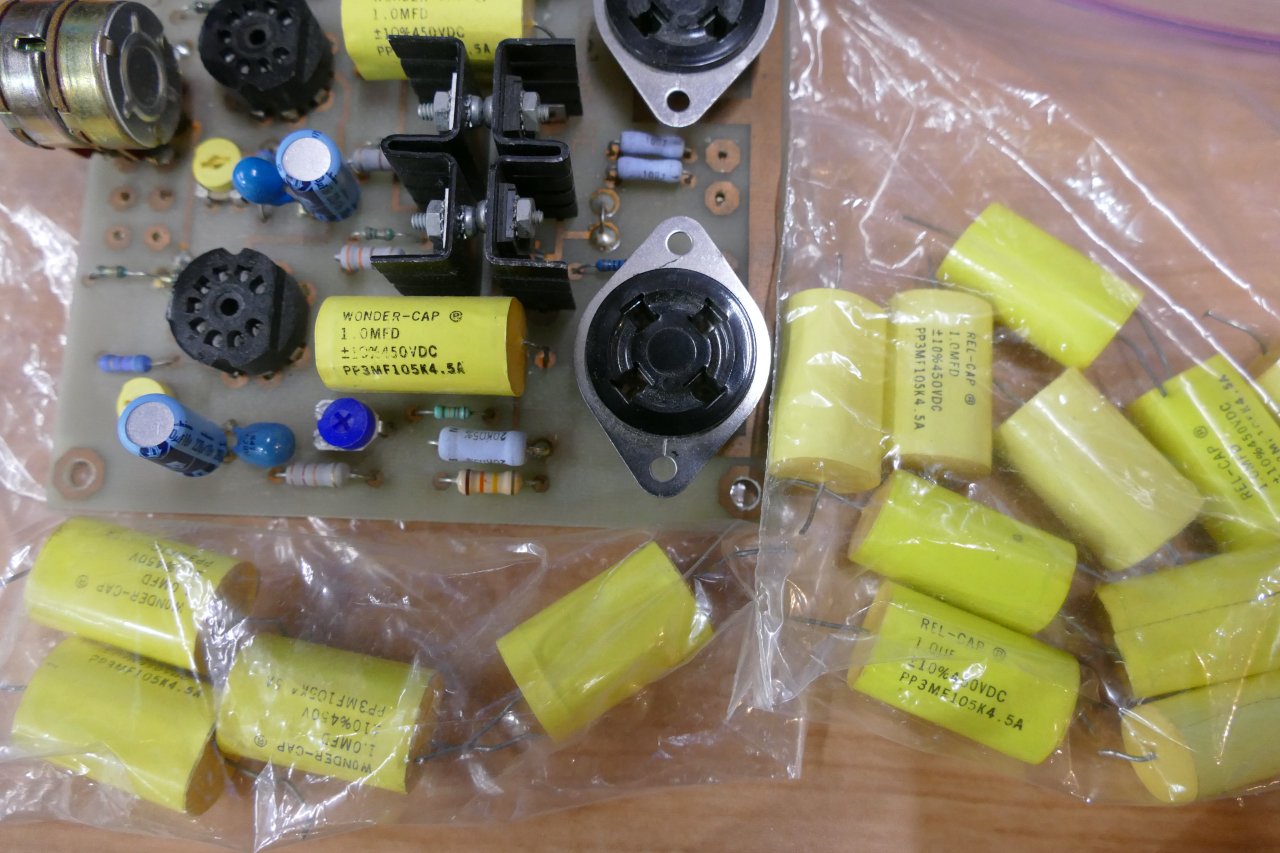

I had a box full of 1uF "Wonder Caps" (remember that fad from the late 80's)......I've never heard of them as I was in my 20's then and far too busy being young and stupid. Apparently they're still available,
In the 60's I built tube stuff because parts were free, just rip what you need out of some dead consumer electronics, or buy some cheap military surplus gear and gut it. In 1973 I started a 41 year career at Motorola where silicon was free just by filling out a sample request form, so I built solid state stuff into the late 80's and early 90's.
I started building tube stuff in the early 80's but it was mostly guitar amps. HiFi tube amps came in the late 80's when the audio BBS's (pre WWW internet bulletin boards) were ruled by "guru's" and "shaman's." The engineer in me cried BS, but when I saw a big bag of these caps "removed from power supplies" on Ebay for cheap, I bought them. Most were Rel-Caps, and a few were Wonder Caps. I believe that they are the same, just the marketing and price were different. They were supposed to contain three identical caps inside in parallel for reliability, but I never cut one open.......still have most of them!
I stuck them in both of the original DIY TSE breadboards. One of those breadboards still resides in my 845SE amp where it functions as the driver. The other was in my Lexan TSE. I swapped it for a production quality board when I rebuilt the amp after it got flooded with dirty water during a hurricane in 2006.
That board and my collection of Expenso-Caps are pictured here.

I doubt that you will have any issue since you are running a rather low power level in an amplifier that does not use any feedback.
The issue arises when your source can put a lot of very low frequency information into the amp AND the power level is high enough that this can cause saturation in the OPT. The coupling caps are often sized such that frequencies below what the OPT can handle are rolled off. You could test the THD at lower and lower frequencies and at power levels your amp will actually see to verify that this isn't happening, but if you don't hear distortion on bass notes when listening, the actual numbers don't matter.
amp about 10 years back that sounded "funny". When I removed the speaker grilles I could see one of the woofer cones was pumping in and out at about 1/2 Hz. The oscillation disappeared when the 1 uF coupling caps (the schematic I was following called for them) were replaced with 0.22 caps.
The other issue occurs when you stuff big coupling caps into an amp that runs GNFB, or any feedback wrapped around a transformer. Here the cap should roll off the low frequencies below the point where the OPT starts shifting the phase of the low frequencies. If not the negative feedback can be phase shifted into positive feedback making the amp oscillate at a low frequency.
This can be destructive in a high powered amp......I learned this the hard way with these same caps, some 1990 vintage Chinese KT88's and a guitar amp quality OPT specced only to 80 Hz. It IS possible for a poorly constructed tube to shatter from a violent lightning storm inside.
