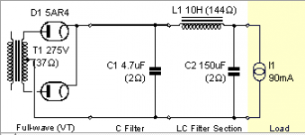

The 3.3 uF cap should be fine as long as it doesn't increase the ripple appreciably. The 10H choke should help in that regard.
I'm facing a similar dilemma running 2A3s. My B+ voltage measures ~320 using a Hammond 270HX, 159S choke (4H, 65 ohms - it's what I had on hand) and the stock 47 uF 1st filter cap. This isn't a real issue with the Chinese 2A3s I'm using as test subjects, but is a bit high for NOS 2A3S and 45s.

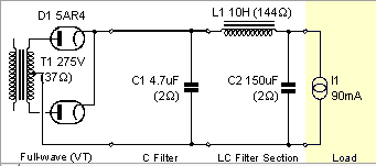

Thanks evanc and Mr_Zenith.
Yes, I'm using 45's.
How is my voltage higher than yours, if I've already reduced C4 and using a higher resistance choke? (Is it because the 2A3 draw more power?)
If I plug in 3.3uF, the estimation is 115mV ripple vs 85mV with the 4.7uF.
Although, PSUD also estimated that B+ would be 310 and not 330... I must have some parameters wrong.
Quite likely. Increasing the current drawn by the output tubes will measurably lower the B+ voltage. I've been running the sino 2A3s at 50 mA, but I've also run 45s at 30 mA. My B+ was definitely higher with the 45s due to the lower overall current draw. I can't recall the exact voltages though.

A 330 Ω resistor in series with the inductor would do the trick as well. I'd use a 10 W or 25 W chassis-mounted type as it'll burn about 3 W.

I had a 300Ω 10W Wirewound intended for dummy load and tried that out.
After biasing 45's to 27mA B+ measured 305V, which means the 45's are getting a bit less than 300V which is great.
For educational purposes, does it matter if the resistor is before or after the inductor? I have it right now going into the Choke connector closer to T1_YEL_RED which to my understanding means its coming after the inductor.

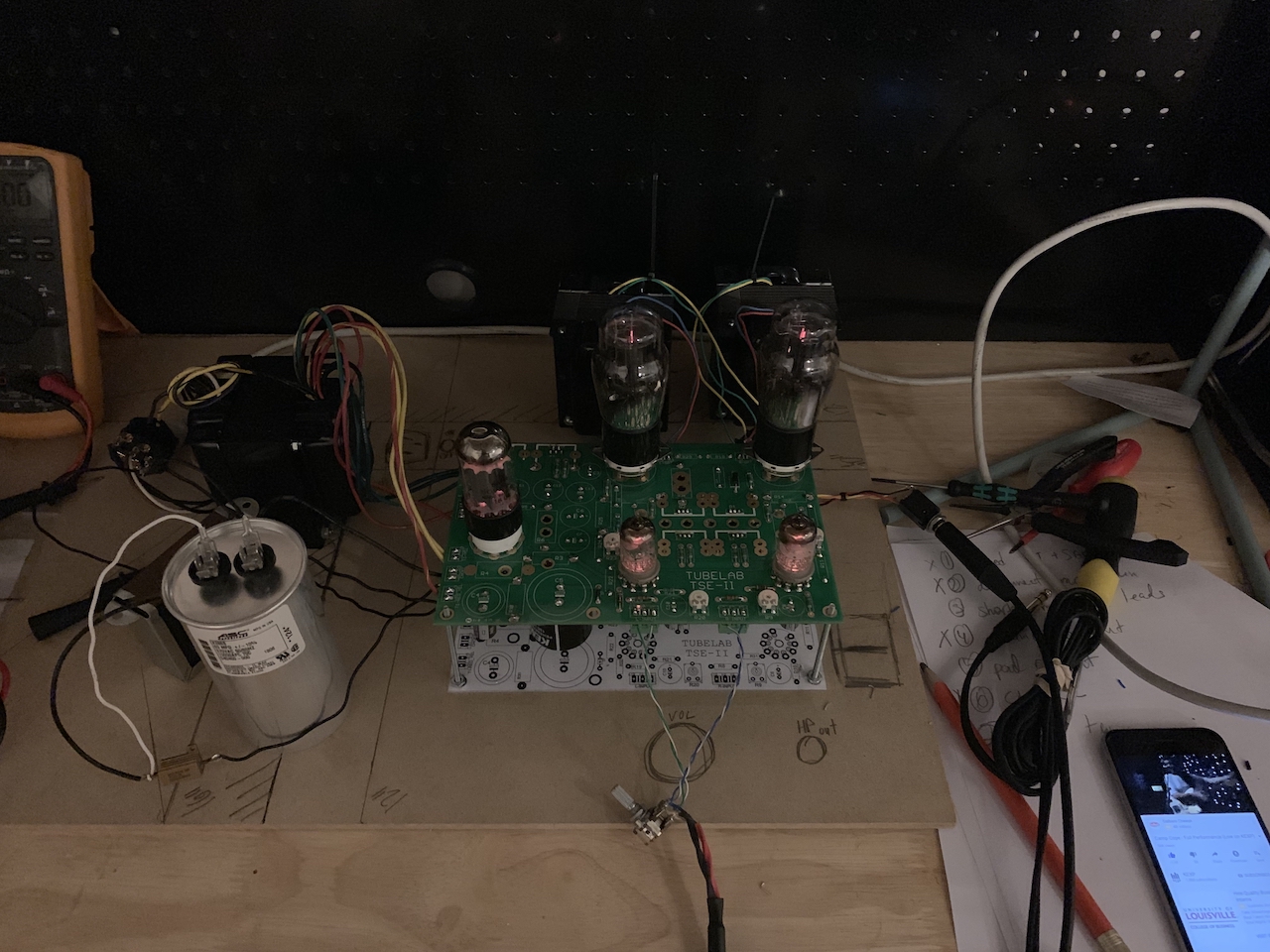

The mocked up TSE-II is playing pretty sweet music through my HD650.
There are a few open issues I will be exploring, sharing here in case this information is useful:
1) There is some small amount of hum when no music is playing. Initially, I measured around 8mV AC on the OPT. As an experiment, I changed the PS to CLCRC, using the 60uF motor RUN as the second cap, and adding a 300R resistor. Simulation showed this should bring ripple down, and indeed I was measuring 1mV AC after that. This reduced the hum but it was still audible. (I tried this with shorted inputs to eliminate any pot/input related issues) I think this is due to the headphone application- 5K:32 OPT's and sensitive high impedance cans. I highly suspect that this would silent with speakers and 5K:8 OPT's. Next, I will experiment with either CLCLC (as randytsuch tried) or a HV B+ regulator.
2) Loading resistors. Without any resistors, there is plenty of volume on the 300ohm HD650 with pot midway. Although, this puts a reflected load of 46K on the 45's.. Based on previous discussions, there was not a clear answer on whether this is a problem or not. The experiment shows the power is sufficient.. but does this cause frequency roll-off or distortion? I cannot know without proper testing tools. Anyhow, I experimented with a 100R resistor in parallel. Volume range is about the same (hard to tell in mockup), but I _think_ the sound was improved.. better clarity overall. I'll have to continue experimenting in my real setup with a proper source.
3) Power transformer buzz. I'm using the Hammond 370EX. People mentioned they did not get buzz from the 300 series. The buzz I hear is audible only when putting the ear very close, less than half a foot. Is this expected, or are the Edcor / Custom PT completely silent ? The 370EX has 144mA, maybe it is over-utilized ? I read somewhere that you want only about 70% of the PT loaded to avoid noise.

Need some help resolving a noise issue I'm having with the TSE.
After first build, there was an audible hum through my headphones. The headphones are 103db/1V and with the 5K:32 opt's, it seems like the default CLC filter does not eliminate hum entirely.
I've experimented with the 21st Century Maida Regulator in place of the CLC filtering (this should eliminate ripple almost entirely), and while the hum seems to be gone, there is a noise that I can't figure out the source of. It sounds a bit different than the hum I had earlier, but can't quite characterize it.
My current suspicion is either an issue with the layout while mocked and/or grounding.
Are there any measurements I can make with a DMM (Fluke 87-V) to try and find the root case? I measured AC at the headphone out and it measures 0.3mV, but I question the accuracy of that measurement.
I'm also setting up Pete Millet's audio interface to start measuring with ARTA/AudioTester... are there any tests I can run that would help find the issue?

... I've experimented with the 21st Century Maida Regulator in place of the CLC filtering (this should eliminate ripple almost entirely), and while the hum seems to be gone, there is a noise that I can't figure out the source of. It sounds a bit different than the hum I had earlier, but can't quite characterize it. ...
The 5842/417A is a high gain VHF tube, and can oscillate under some circumstances. Oscillation can "sound" a lot of different ways depending on the frequency / mode of oscillation. Sometimes there is no "sound", just erratic or unexpected operation.
You could try pulling the 5842's and see if whatever you are hearing in your headphones, changes, or disappears.
Pulling the front end tubes probably won't make any change in what you are hearing, but you might as well eliminate it as a possible cause before proceeding further.
