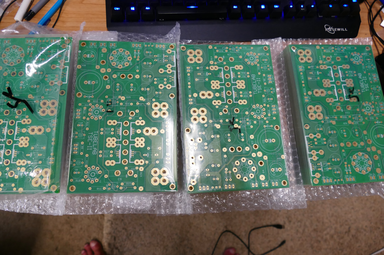

I am currently out of TSE-II boards......Best guess is ship out to me on Friday.
Theyr'e here.....LOTS of them.
Now it's my turn to build some amps.....

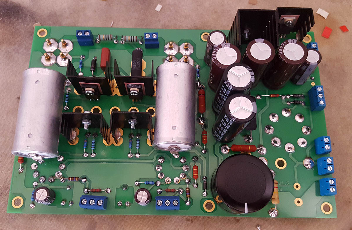

My board is completed and almost ready for final connections 🙂

There is lots of information relating to the earlier version of the board here: Assembly Manual | Tubelab
I believe the part numbers are the same as on the original version of the TSE board.

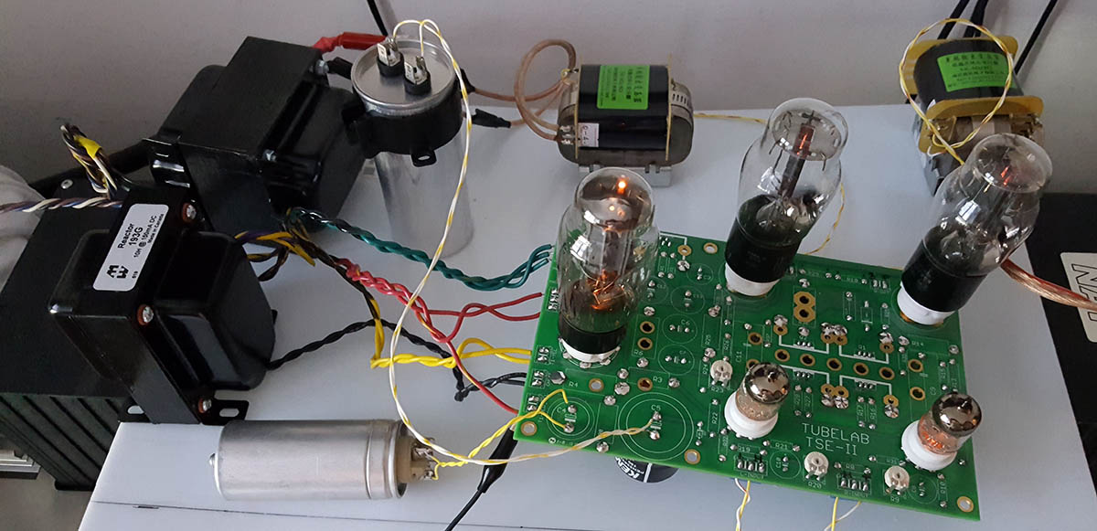

I've been gathering the wiring information for the TSE from this and other threads. I have it all in a table if that is useful for anyone until the official guide is out.
George, for confirmation, it seems like there are quite a few wires that should be connected to T1-RED_YEL.
Is it a valid solution to have a single screw on the chassis, that the following are connected to:
1) T1-RED_YEL
2) AC Inlet (E)
3) Speaker/HP cold
4) PT grey EMI shield (I don't have this on my 370EX but it exists on other 300 series PT's)
5) Motor run cap (instead of directly to the T1-RED_YEL terminal)
Finally, the PT and OPT's sit directly on the chassis/top panel, but don't necessarily have continuity due to paint. Due people typical sand off the paint from the bottom of the bells?

I would say yes and yes. A single star ground point on the chassis is a good idea as well as scraping some paint from the spot where you bolt down the PY and OT. Maybe use a star washer for good measure
Don't know about others, but I used a wire brush attachment for my drill. I used it to remove paint so I could run a ground wire to the tx housings. If the housing is visible, then I removed the paint from the bottom of the feet, so you can't see the bare metal spots when tx is installed.
Otherwise paint is an insulator, and I can't see how you would get a good ground.

I only have the motor run cap (it was parallel connected to c5 directly before), T1-RED_YEL and AC Inlet (E) connected to the board.
The shield for the input wires connects directly to the AC Inlet earth, via a chassis star earth, and so do the OPT speaker output negatives. This saves some space.
