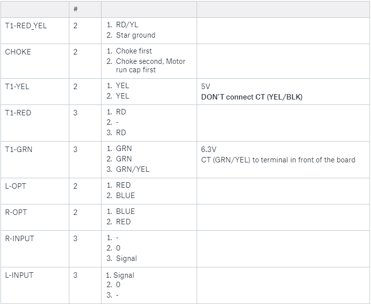

Please share the table you made, and thanks.
I haven't completed the amp yet so please validate if you're planning on using it as a reference...

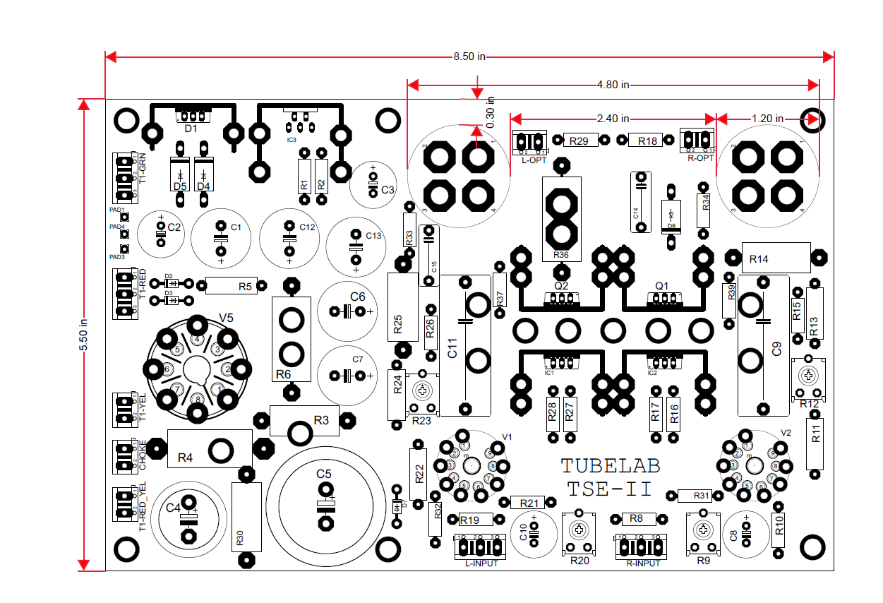

The numbers (1., 2., etc) refer to the O1, O2, O3 numbers on the PCB.
Oh, and a pretty cool feature in Adobe Acrobat is the measurement tool... attached is an example of what you can do:

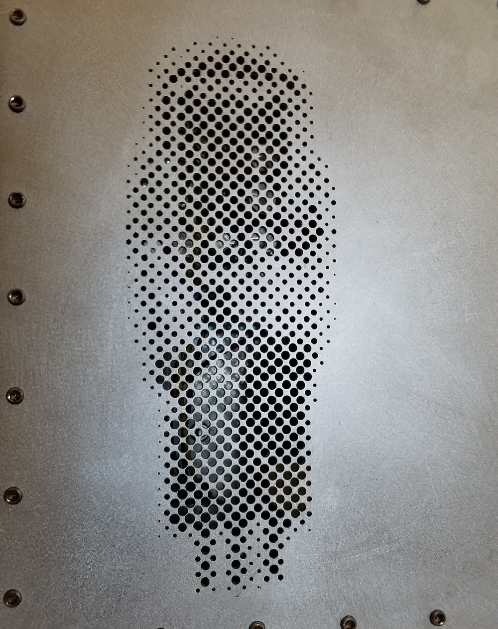

I like that idea, Tom. Sure a lot easier than layout.When I put together my DG300B, I found a good way to drill a pattern of many holes: Perf plate! I used a piece of perforated aluminum sheet as a drill guide. I marked two holes in the pattern, drilled those, and held the perf plate in place with a pair of brass pins. Drill rod would work too. Naturally, this requires the holes in the perf plate to be the same (or smaller, I suppose) diameter as the desired ventilation holes in the chassis.

Great minds think alike. I used this method to match-drill the holes for the bias adjustment pots and mounting screws (I'm building mine with a sub-plate). Once those holes were drilled on the sub-plate, I used it as a pattern to transfer them to the the main top plate using a drill press.When I put together my DG300B, I found a good way to drill a pattern of many holes: Perf plate! I used a piece of perforated aluminum sheet as a drill guide. I marked two holes in the pattern, drilled those, and held the perf plate in place with a pair of brass pins.
True. The pdf pattern is extremely accurate provided it's printed at the correct scale. However, I still found it necessary to do quite a bit of layout by measuring stuff directly from the finished board. For instance, the bias and CCS pots I used have their adjustment slots in a slightly different location than those shown on the pdf. For these measurements I used the depth gauge on a pair of cheap digital calipers.Sure a lot easier than layout.
You'll also have to do layout work if you want to drill holes in a specific pattern. In my case I wanted to drill a complex pattern of ventilation holes around each power tube, (like you'd see in cross-drilled brake rotors, but with four different hole sizes). I created a CAD template, which simplified this process considerably by allowing me accurately place my prick punch on the exact center of each hole.

It also made it possible to get all the holes aligned nicely. I forget how many holes I drilled in each top plate, but it was into the hundreds. It's nearly impossible to mark and drill a hole pattern by hand so that all the holes line up. And due to the pattern recognition feature in our brains, it doesn't take much misalignment for a hole to appear grossly off centre. The perf plate made all that a breeze.

And how! Yesterday morning I had this crazy idea to do something completely different with the ventilation holes on my TSEII bottom plate. So I half-toned a picture of a 2A3 tube, printed several copies and got to work. Eight hours later I was rewarded with the results seen in the picture below.And due to the pattern recognition feature in our brains, it doesn't take much misalignment for a hole to appear grossly off centre.
This was done entirely by hand with relatively simple tools: Prick punch, center punch, drill press, about 20 different drill sizes, and an Opti-Visor.
I'm not sure I'll do this again.
That's a whole lotta drilling!! I can see why you wouldn't want to do it again. I think I'd just use perf plate and fill the unwanted with putty🙂And how! Yesterday morning I had this crazy idea to do something completely different with the ventilation holes on my TSEII bottom plate. So I half-toned a picture of a 2A3 tube, printed several copies and got to work. Eight hours later I was rewarded with the results seen in the picture below.

You should figure out how to incorporate that into your top panel, that is super cool!
Fantastic! Brilliant idea and very well executed!Yesterday morning I had this crazy idea to do something completely different with the ventilation holes on my TSEII bottom plate

Thanks, everybody! I thought seriously about putting it on the top plate, but the area there is somewhat limited. I'd have had to use some seriously tiny drills, with the increased risks of bit breakage and hole misplacement. I like to think of it as an "Easter egg", one of those surprises that isn't apparent until one looks a little closer.
