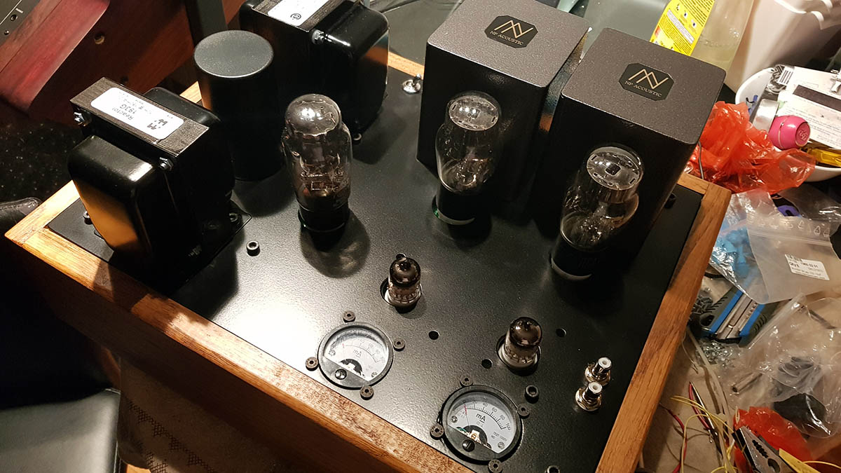

I have had had a 45 tubed TSE running with a PQ5EV3 (3.5A instead of 5A) for while now without any problems, including being accidentally left on overnight a few times. It has some extra heat sinking, but doesn't seem to run too hot - 2A3 tubes would probably kill it though.
Thanks Grumpish. However my TSE runns with 300b. I don’t know if this pq5ev3 can handle these tubes. Any way I bought a pair pq5ev3 for little money.
I see an ebay vendor sales pq3ev5 that I think are chinese,. May be these are not reliable.

Yea, that looks good too. Although B+ will high for 45's with the standard power supply parts (even bringing the first cap down to 4.7u)
On a similar note, can someone help me make sense of the attached guide by Hammond.
For B+, the HV secondary is in the "Full Wave Capacitor Input Load" arrangement, correct?
If so, the doc states:
Vpeak DC = 0.71 x Sec V AC
Vavg DC = 0.45 x Sec V AC
I DC = I AC
Taking the 370(EX, FX, HX etc), with 550VCT, this would put
Vpeak = 390 VDC
Vavg = 247 VDC
It doesn't correlate with the voltages I observe on the first 47uF filter caps, which are closer to 330-350VDC when everything is biased.
What I am I missing?
Additionally, how should Vavg in this calc be used? Should we plug in the target B+ we are looking for and choose the transformer based on that ?

Lower b+
I have a silly question. I have a power tx I salvaged that has 760 ct. Is it possible to use a different rectifier and lower c4 enough to get b+ low enough for 45's?
I have been looking at some other 45 designs (for the sake of learning) and stumbled across the Bugle 45 (which is probably well known to others)
http://www.wavelengthaudio.com/bugle.pdf
Anyhow, he uses a 700-720 CT power transformer with choke loaded input but a very small cap in the front, 0.68uf.
The specific part about the power supply is the last paragraph on the second page.
Putting 760V with C4=0.68 and C5=220u, constant load of 100mA in PSUD puts B+ at 315V so probably worth a try.
You probably also want a beefy choke in this case (based on what I've read, not personal experience).
One additional option with C4=2.2-4.7u is to add an additional RC stage with a resistance value that will bring down B+ to where you want it
