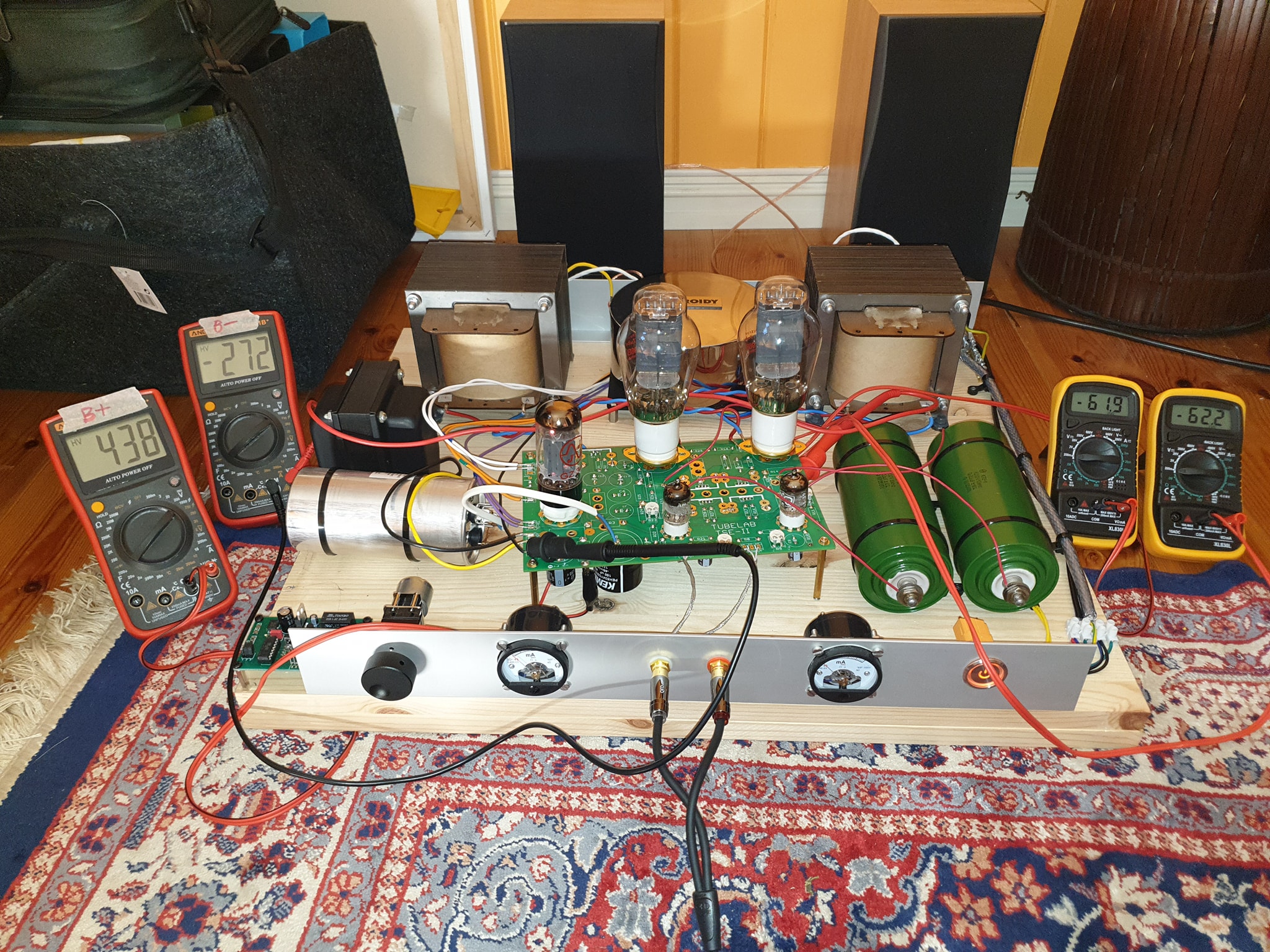

I have finished my amp now and it worked first time! And it sounds very, very good.
The B+ is a little too high and I want it to be 400v absolute max (I'm using 5k OPTs). Can we still decrease the voltage by increasing the C4 value, even though this is 10x the value of the TSE I C4. I see from the specs that the max capacitance is 60uF, so I guess it should be OK. Or would there be a better way to lower the B+ voltage.
You would decrease C4 to decrease B+.
Can use PSUD to simulate, or by trial and error.
What's C4 value, and B+?
Randy
Yes, reducing the value of C4 will lower B+. The recommended value of 47 uF is what I use in my board. Different power transformers may require a different value. You can also lower B+ by using a 5U4 type rectifier instead of the 5AR4.
