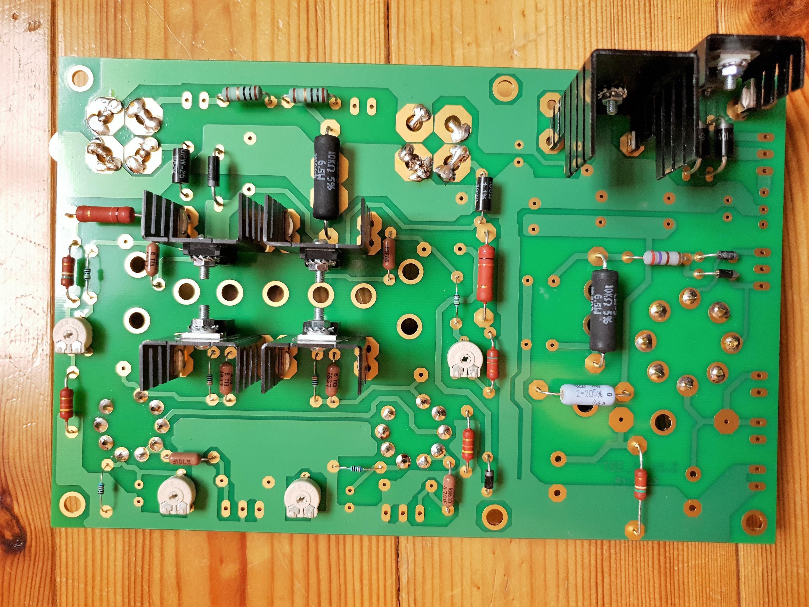

Thanks, if you want another inconsistancy, at least, I found another. On the board you have IC1 to 3 but in the BOM, you have U1 to 3. I think IC3 is U1 and IC1 U3, with IC2 = U2.Thanks for the find, BOM is being fixed and will be uploaded shortly to post #244
Hopefully this is correct, as that is what I have soldered them as 🙂
Thanks. I see and work with these boards daily. I have worked with the TSE design for over 15 years. Little details like these get overlooked by me since I don't even look at the parts list to put the same parts in the same holes that I have done for years.
In the process of fixing this, I found a similar inconsistancy with the tube sockets....both are fixed. I am posting the revised BOM in post #1 to make it easy to find. ALL new BOM updates and important build info will go into post #1. The BOM in post #244 will disappear.
If anyone finds anything else questionable please post it here. It's easier to fix it now than to unravel the trail of confusion later. I have been building tube stuff for over 50 years. Something that is obvious to me is often not obvious to others.
Here is my build so far. Wasn't quite sure which way round the ICs should go, and something I need to and will learn, but in this case I copied Georges build from his pictures earlier, so hopefully they are OK or I have a bit of extra work to do. Have only had to use the solder sucker once so far, after a mistake when I was tired late last night, but all fixed now 🙂 Heat sink soldering was a bit challenging, since they are, well, head sinks, so not the best soldering.
I compared your picture to my working board and I don't see anything obviously wrong. I will give it another look when I can disconnect my board and bring it to the computer screen.
I don't always solder the heat sinks at all. If the board is going into an enclosure and it's not going to get banged around, they aren't going to move. My two boards are constantly being moved, poked and prodded. I soldered one pin.....and it's not such a good job either.

I finished stuffing my tse II board this morning (except for d7). Once that comes in I can try to power up. I am assuming the basic steps from the tse assembly manual for checkout and biasing are pretty much the same -- please give a quick warning if there are any gotchas. On my SSE, I had installed an Inrush Current Limiting Thermistor -- is one recommended for tse II as well?
Optional parts to add to the bom:
Everything went together pretty well -- similar to the SSE but more of it...
All the ic's except for d1, had two mounting locations for the heat sinks so you can mount on either side of the board and still have the heat sink contacting the chip on the right side. I had a hard time figuring out how to make it work with d1 and it looked to me like everyone had it installed backwards in their pictures until I found the comment on post 251 that d1 is reversible! I'd recommend adding that to bom notes item 4!

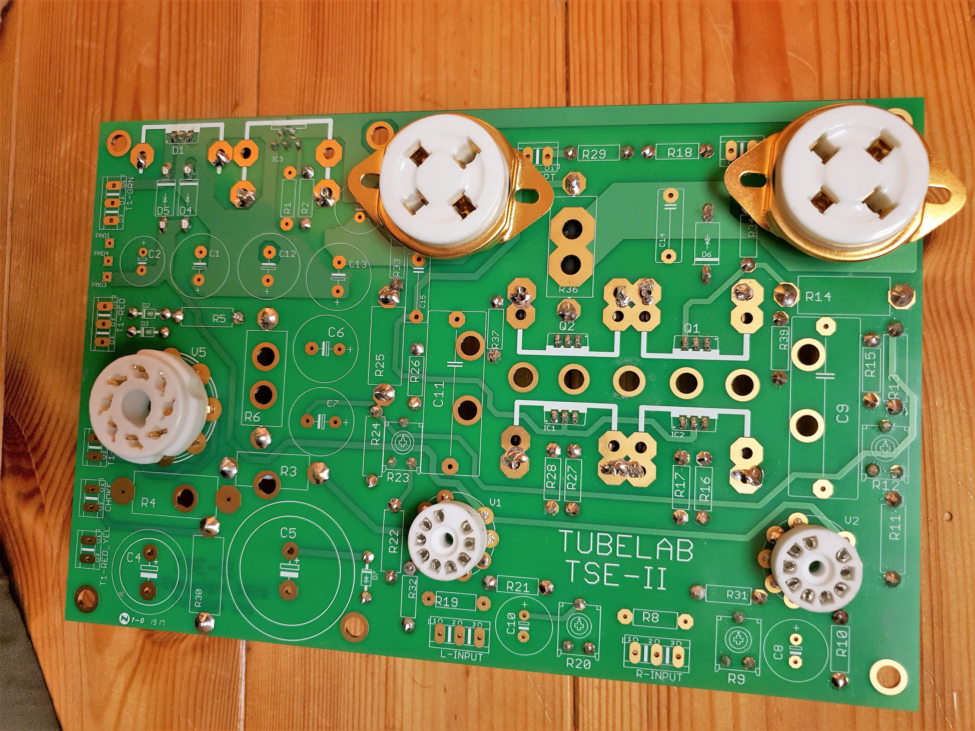

OK, I have a question about the tubes being used in this design.
I checked the BOM and see there are five according to it showing V1-V5. Since I keep seeing the “300B” being mentioned I checked the Western Electric 300B pinout and it is a 4 pin design. So that covers V3 and V4, but can someone please clue me in on the other three tubes? Thanks.

I haven't built mine yet, but based on the instructions on the site,
the 9-pin would be the input tube, 5842/417A, and the 8-pin would be the rectifier, 5AR4
