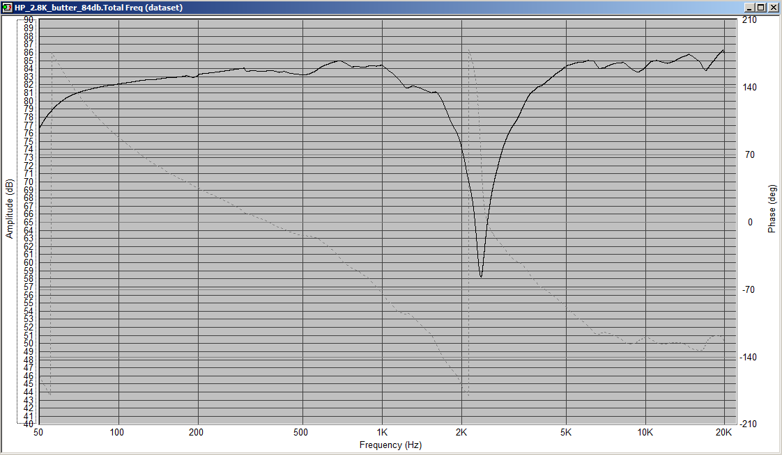

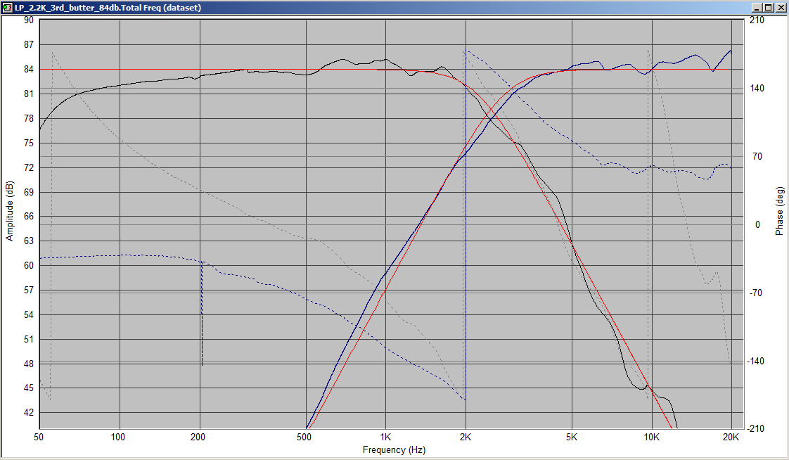

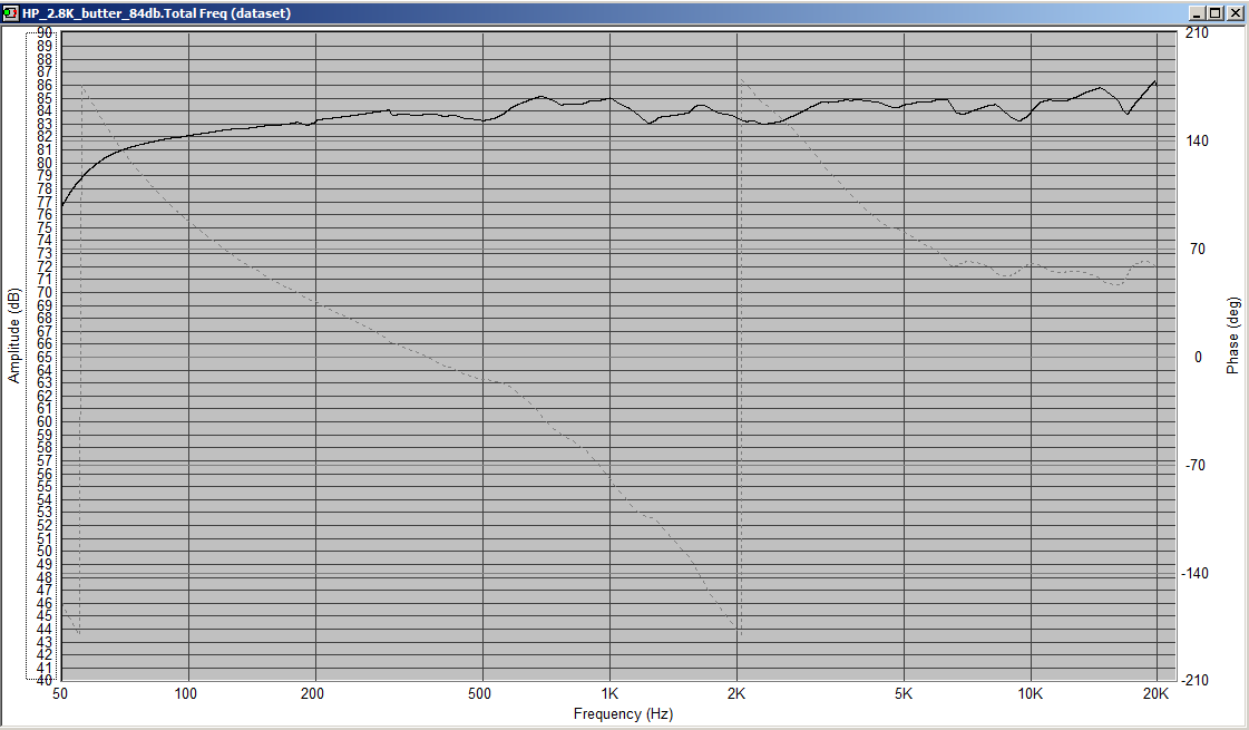

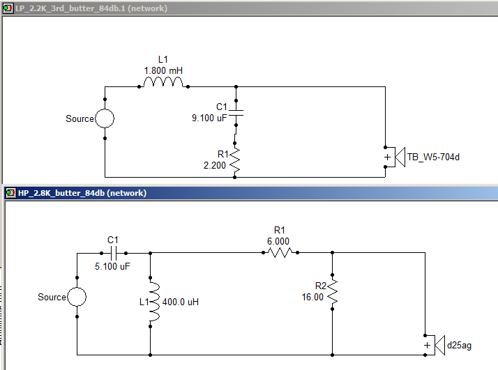

I had a play last night and came up with the following. Note that this has been done in speaker workshop with woofer 35mm behind baffle and zero offset on the tweeter. SW doesn't allow for putting in baffle geometry so may give somewhat different results in boxsim with the actual positions of drivers.
1.8mH I used a janzten p-core as reference, DCR 0.135 ohms.
400mH I used a jantzen air core 20ga DCR 0.43 ohms (note you need this dcr to help the phase to line up a bit better).
Target for the LP was 3rd order butterworth 2.2K at 84db
Target for the HP was 3rd order butterworth 2.8K at 84db
Initally I had the speaker curves matching the target curves quite well, but after tweaking (manually) for better reverse null these came off a bit on the knees of the curves. Still +/- 1db between around 160Hz and 12Khz is not bad!
Try the below with your frd and zma files in box sim and see how it looks.
There's room for improvement, but I think this would probably work ok, and has the advantage that it is a simple network. Note that I have not really looked at distortion profile of the tweeter, I'm assuming with it's low resonant frequency it should handle the relatively low crossover point.
Tony.

Hi Jeremy, a little different but not wildly (which is good). I just realised that I think you have 2mm offset (same direction as woofer) on the tweeter too. I put that into speaker workshop and the phase shifts over a bit more like what you show above, although in SW the phase matching is then quite good from about 2.2K through about 3K and the reverse null is much deeper (down to about 46db)...

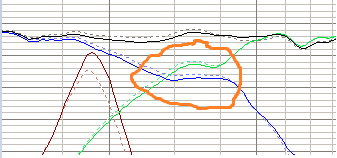

How does the frequency response look? Also what about off axis (I think boxsim can simulate that correct?)
The main part I didn't like about your previous graph was the circled part. each driver flattens out for a while before continuing on down. The slope should be more or less constant, whilst the shown response of each driver may sum flat on axis I have my doubts about how it would sound. I would also like to see a reverse null of the response of that version. I suspect it would not be symmetrical. off axis may also be a bit ugly...
Anyway hopefully what I've posted gives you some food for thought 🙂

Resistance in series with the shunt capacitor and in series with the shunt coil can be used to vary the phase (but will also change the response), changes in values of coils and caps will also have an effect, as will adding or subtracting an order in the filter (though this is generally a much bigger change).
