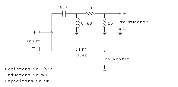

Here's a 3kHz XO design with your Vifa D25AG metal tweeter by Marshall Leach. How simple is that?
Vifa 2-Way Loudspeaker System
OK, he's using the classic 6.5" Vifa P17WG polycone, which needs very little filtering beyond a bass coil.
You need to be around 2mH with, say, 5.6uF shunt on the bass. Or you do it better Troels-style on the bass with a smaller 1mH coil, 10uF cap and a LCR notch around 1.5 kHz to get it well-behaved.
Can't seem to get good phase with Marshall Leach's design for the tweeter without changing cap and inductor values.
So if I'm understanding you (Steve) correctly, what's wrong with my previous design is that there are to many components?
If it'll work I'm willing to pay extra for more components than have to wait longer for a better design. With less time spent designing crossovers I can spend more time reading books on crossover design and understand better what you guys are telling me 😛 .
Thanks for all the help, Jeremy

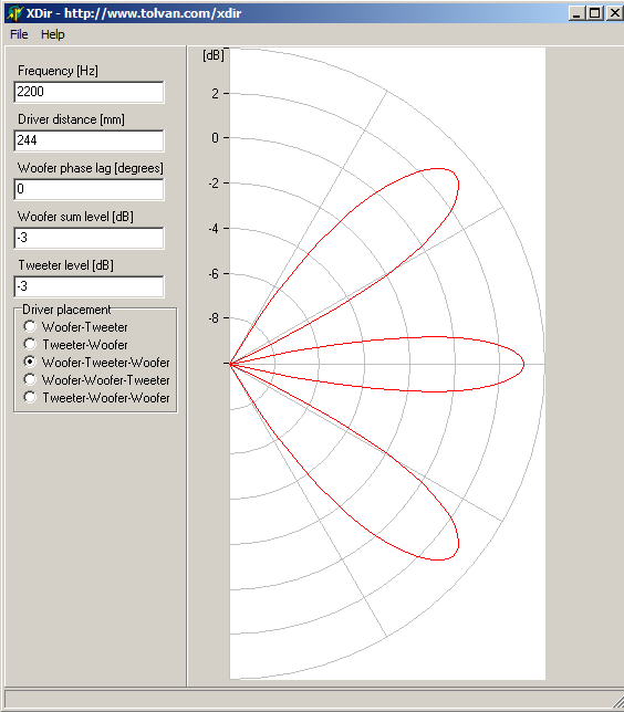

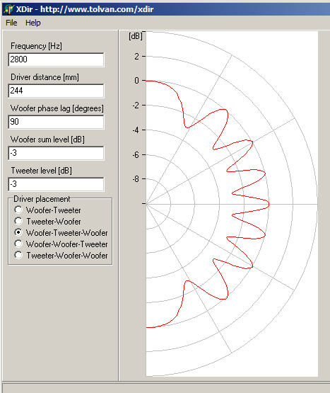

With respect to the lobes below is a post (from a series I've been [very slowly] working on). Not ready for public release as yet 🙂 Have a play with Xdir it's a nice utility.

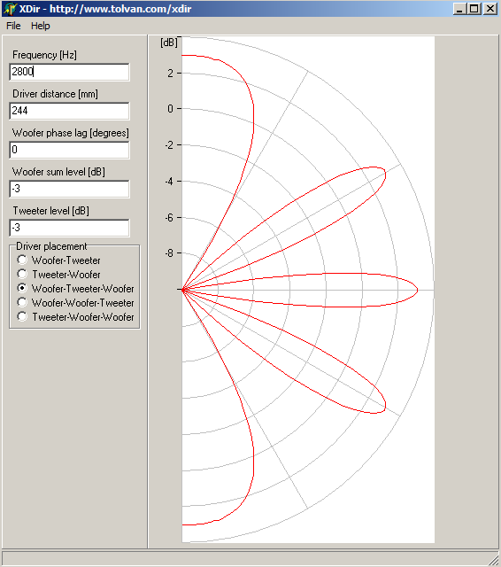

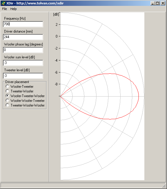

wintermute said:
I recently became aware of another tool for simulating vertical polar response. The tool is Xdir Tolvan Data
The simulation is simple but gives a very good idea as to the effects of different placement of speakers on the baffle, how centre to centre spacing affects the polar response, and how phase tracking also affects the polar response.
Below are some images that show the simulated polar response of my own MTM. The first is as it was actually implemented.

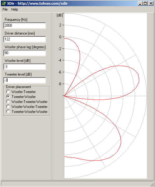

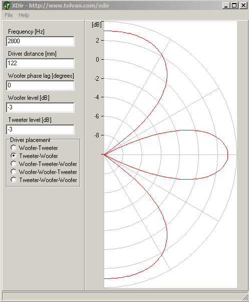

You should be able to see from the parameters in the input to the sim the differences. The 5th plot with 90 deg difference between the drivers is interesting!

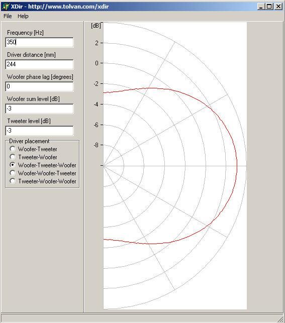

The 6th plot shows an TM implementation to give an idea of the difference between an MTM and TM implementation as far as vertical polar response goes, if "traditional" higher crossover points are being implemented.
Note that when I modeled these I had -3db summing, but my actuall implementation is 4th order bessel accoustic with -6db summing. In reality this only makes a magnitude difference on the graph.
The 7th plot shows the TM with 90 deg phase shift, this demonstrates the often mentioned "tilt"

Hey Guys,
I don't really understand why I should be attenuating the tweeter 2-3 db bellow the woofers SPL at 100-200hz. Could you please explain this.
I done some testing with a zobel circuit on the woofer and it was pushing the phase the wrong way(no matter how I changed the values). Also I can't change the notch's component values as it is attenuating the woofer breakup.
With my current box design the centre of the woofer is 136mm away from the centre of the tweeter or 5mm distance between woofer and tweeter frames.
I attenuated the tweeter, changed the woofer filter inductor and cap to 2mh and 5.6uf then played around with xdir.
At xo point
At 8KHz (largest phase difference before woofer drops bellow 40db)
Excuse my Ignorance 😛
Thanks, Jeremy
