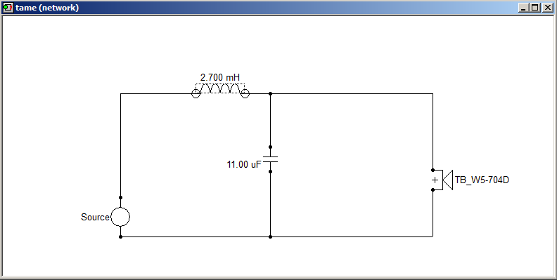

Hey Guys
Finally got around to designing the crossover. Didn't really know what I was doing but I eventually got a crossover design. Just wondering if it is any good and if there is anything I need to add to it. At first I was manually inputting data from an online crossover calculator and after I let boxsim optimize it . I also put a zobel circuit in it not even knowing what it does...
Anyway here are some pics:
Thanks for the help
Jeremy
Thanks for the help
Jeremy

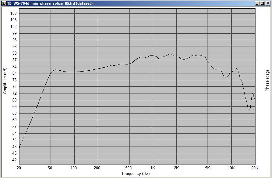

Hey Tony, I tried to flatten out the rise from 100 Hz by attenuating the tweeter a bit more and adding a larger inductor but I ended up with a hump from around 100 to 500 Hz that I couldn't seem to get rid of. I have done some research and have got a flatter response from 100 to 500 Hz by using a notch filter. How does the rest of the graph look now?
I am not too keen on using a notch filter as it adds a lot to the cost of the crossover (20 USD per 5mH inductor) so any other advice would be much appreciated.
Thanks, Jeremy
Thanks, Jeremy
Hmmm that's a seriously big notch!! 😉 since a notch is a tuned circuit you should be able to use other value components to do the same job (though perhaps with higher Q) (hopefully I'm not talking out of my rear here 😉 )
Take a look at this post http://www.diyaudio.com/forums/multi-way/277192-hivi-morel-2-way-temporary-xo-help.html#post4394651 funnily enough another (different) HiVi driver. The notch I did for that looks to have been in the same range and is using much smaller values, although it is for two in parallel, so probably roughly half the impedance... Too late for me to try and think whether that should make the values smaller or larger! 😉
edit: the general FR is looking a lot better. You may not even need that much BSC (the tradeoff is lower efficiency). How big is the hump without the notch?
Tony.

I went back and checked that, and the notch was around 1.2Khz, have a try with 2mH 50uF and 6 ohms and see what that does. I think that for a series connected shunt notch the impedance of the load is not so important...
Tony.

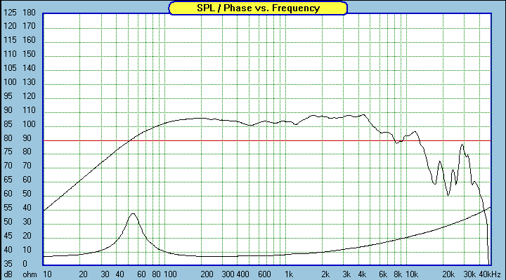

Jeremy, What are your baffle dimentions? Did you use Zaph's SPL measurement for your TB spl data? The TB actually has a dip in the 500Hz range so I'm a bit surprised you are getting a hump specifically in this range.
I'm suspicious that your spiced in low frequency data is being spliced at two low a level (I'm not sure how this works in boxsim) resulting in a step down. Something doesn't look quite right.
Below is Zaph's measured data, if you spiced in your low frequency sim at around 200Hz I don't think you should see the step down that you are (between 200 and 100 Hz). Zaph's measurement is not in an ideal box (in fact they are not in a box at all) and you probably should not use it below about 200Hz IMO.
Tony.
Tony.

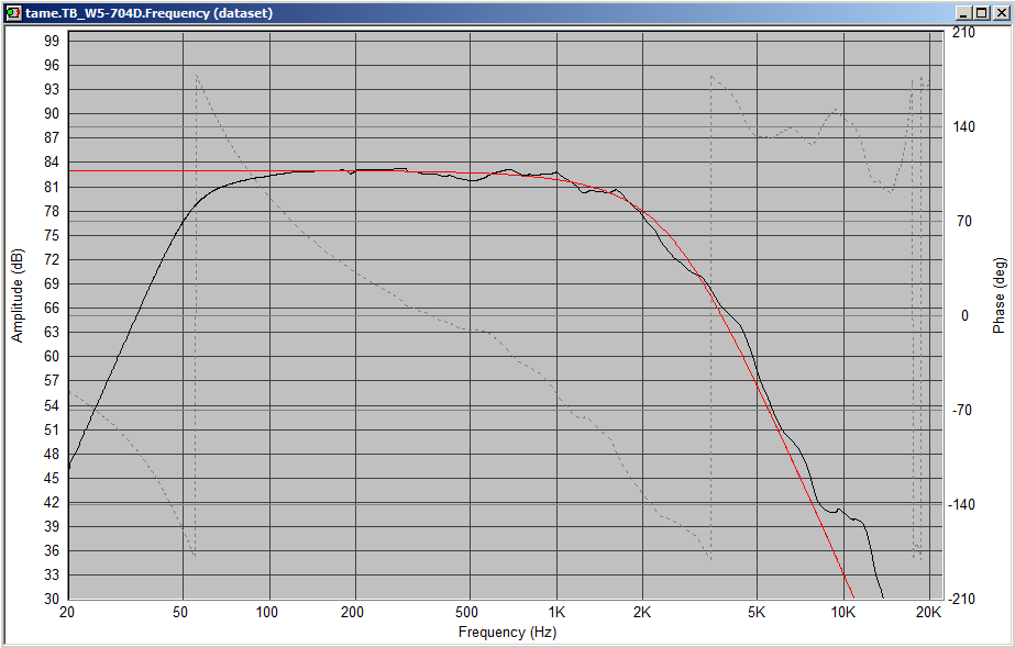

Hi Jeremy, I did a little playing tonight with notch, but went back to basics. Something like this is simple and may work well. It does roughly 1/2 BSC rather than full which if you are not too far from the walls will probably be fine.
Something to think about anyway. It's 4th order bessel acoustic target (83db) at 2.4Khz.
Depends of course whether it will blend in with the tweeter of course (phase wise) but shows that the driver/box can be tamed without doing anything tricky 🙂 Note the low frequency was simmed in an 11L vented tuned to 54 (I think) Hz.
Tony.
Tony.
