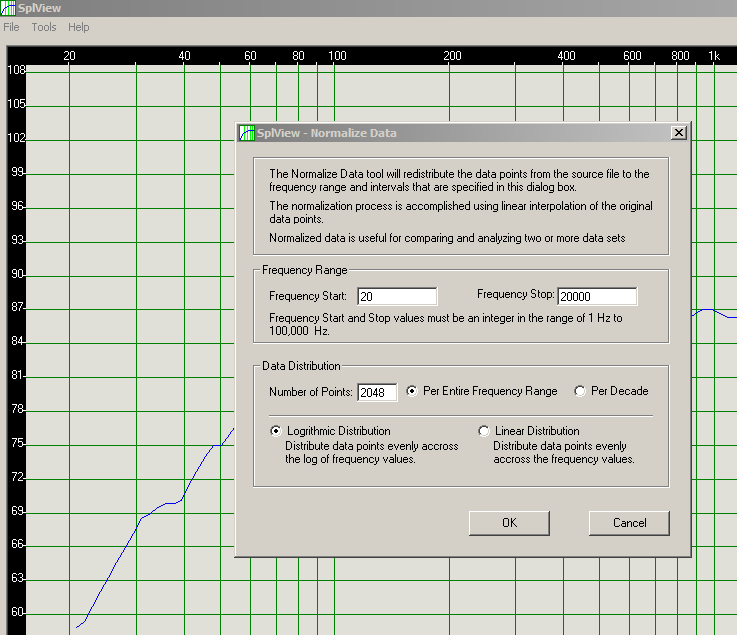

Ah yes, you also need the spltools then. SPL Tools the splviewer allows you to "normalize" the response. It will extrapolate down to 20Hz and up to 20Khz if your measurement doesn't extend that far. The lower range is more important for extracting the phase.
It unfortunately doesn't let you normalize impedance files, if the worst comes to the worst you can add in some rows in excell for the zma to pad it out. Just take a look at another zma for a similar tweeter to see what the data points are.
I don't use the default settings attached is a screen shot of what I use.
Tony.
Tony.

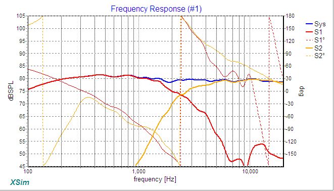

After many hours of trial and error I have finally designed something decent. (I think)
Crossed at around 2.9 KHz
Is the phase matched good enough?
I've had the judge phase (In results thingy) bellow 0.1 before but that was at a much lower frequency.
Thanks, Jeremy
Thanks, Jeremy
Looking at how the green line goes above the sum, the phase between drivers is off. I don't know boxsim, so I don't know if it is possible to have such a graph, but you should look at the phase of the two drivers with the crossover, something like the picture attached.
Anyway I would tame the bump of the woofer (3-5KHz), this can be accomplished by a CR circuit in parallel to the main coil. For an example have a look here: Studio-101
Another point of attention: optimizers are a good thing, but you need to have a look of the values of the components: I think you'll have a hard time to find all the values needed, especially a 1nF audio grade cap.
Ralf
Ralf
Hi Jeremy I think what you had before was closer to what Ralf is saying. It looks like in an attempt to get phase matching your driver acoustic slopes have suffered.
I'd be more inclined to get slopes matching a good 4th order acoustic rolloff with non-optimal phase matching than I would to have good phase matching at the crossover point but lumpy FR in either driver in the crossover region.
Tony.
Tony.
The response on axis would be the main concern when fixing phase. The benefit of precise phase matching tends to be limited by the imperfections of a practical crossover. A phase difference could even be used to advantage with this.

Woops forgot to attach the phase graph 😛
