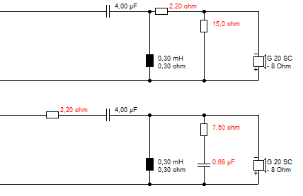

Steve, yes I tried taking out the caps altogether and it worked just the same, only problem was that the impedance dropped to around 1/2 what it would be without the notch since it was just (effectively) a frequency dependent resistor in parallel with the woofer 🙂 That was the main reason I dropped back to basics, and was actually a little surprised at just how well it went! It's not perfect but it's certainly a good starting point!
The 2.4Khz was just where it seemed to work well, I started at 2.2K and worked my way up. 2.2K because that was pretty much where Jeremy was aiming originally.

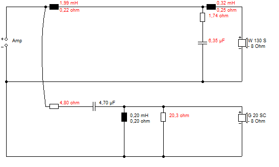

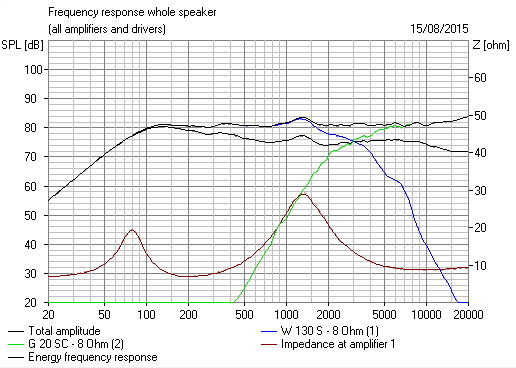

I have finally designed a crossover that does not have overly large components and is decently flat.
How does this look to you guys?

Your filter is crossing over too low. We can do a 3.5kHz XO here on second order IMO. I really don't think 5R and 0.2mH is useful here. Lose it. It's an old trick to give the shunt capacitor on the bass some resistance where bass inductance Le plays a part. It aligns phase and slopes nicely.
Give Boxsim the below circuit to optimise for your drivers, and watch phase alignment too, which matters for the drivers to sound integrated. My own sim is for a similar paper driver in closed box, so don't expect the result to be exactly the same.
FWIW, Boxsim usually calculates the bass up on stands in the middle of the room. Diffraction at baffle. In practise wall effects will boost the bass, so don't mind a slight upwards slope on the bass.

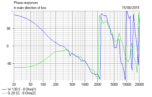

There's something seriously wrong with the phase for the bass here given the tidy slopes. Possibly the acoustic centre (aka point of sound origin, SEO) is set wrong. It should be about 30mm behind the baffle IMO for a 5". Tweeters are usually about 15mm behind the baffle. You should always look at impedance too, lest it dips below 4 ohms which the amp won't like. That 13.8R series resistor is one way of doing things with a tweeter, and can sound good, but not the only way.

It took me a matter of minutes to design this crossover (modelled of Steves)
It is now crossed at around 3KHz in a 16 (should this still be smaller) litre box tuned to 50Hz. I am assuming the slope from 50 to 200 Hz will get filled in by wall effects as Steve has suggested.
What do you guys think?
Also, should I be using air cores for the 1.8 mH inductor or is a solid core fine?

This is looking about right. Phase is still wrong though. Have a look and a play with SEO. It should all fall into place then. Also then try some shunt resistance with the bass capacitor. Air cores are more expensive than bass ferrites, but theoretically sound better. IDK. LOL.

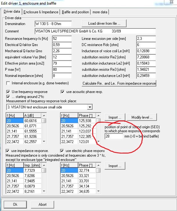

How would I change the acoustic centre thing you were talking about in boxsim?

As you move a speaker's acoustic centre back, the phase slope goes down steeper.
So we ought to be getting something like the below that I quoted earlier. The drivers then reinforce each other nicely for a -6dB phase aligned crossover, aka Linkwitz-Riley. It gives a detailed and integrated sound if you sit in the sweet spot horizontally. It's hard to tell that you have two drivers if you get it right.
Moving the acoustic centre back doesn't seem to do anything to the phase graph.
Does this mean there's something wrong with the crossover?

Hmm, that IS strange. 😕
Sounds like you have imported FRD and ZMA files into Boxsim. But there's more to it than that. Depends on how the measurements were taken, for one thing. Like baffle size. And also on some other parameters than pure FR and impedance and phase.

You MIGHT just set up another project with a Visaton W130S, and try and figure out what is going wrong here. TBH, I don't know what the issue is. But, TBH, I don't think you are far off the final filter.
