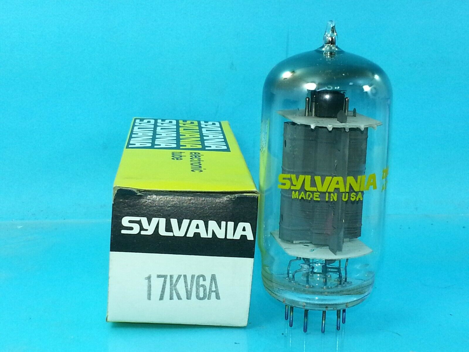

Having slept on the pentode Cag1 problem, I now have a trivially simple measurement that gives spot on results with a 2 lead C meter.
Going back to the 17KV6A regulator Beam Pentode.
Tying g2 and g3 together. measure the C from g2g3 to the plate and again to g1. (using touch/no touch difference method)
g2g3-p 7.4 pF
g2g3-g1 12.7 pF
and from before: p-g1 with other electrodes floating 4.3 pF
Now take the lower of g2g3-p (7.4pF) and g2g3-g1 (12.7pF), so 7.4 pF
Divide that by 2 and subtract from p-g1 so 4.3 - 3.7 = 0.6 pF
Which agrees EXACTLY with the datasheet 0.6 pF
The reason this works is:
to get ground potential (half way between the meter + and - excitations), requires equal cap from g2g3 to both p and g1. The extra (12.7 -7.4) cap at g2g3-g1 is just causing screening current to ground in operation. So we are left with 7.4 pF from g2g3 to p and 7.4 pF from g2g3 to g1 to get ground balance at g2g3. These two 7.4 pF caps are in series between p and g1, so net shielding cap is half that, or 3.7 pF. So measured p-g1 of 4.3 pF minus the shielding effect cap of 3.7 pF leaves 0.6 pF effective Cag1.
The screening grids are absorbing the plate field effects that normally would go thru the 3.7 pF coupling.
