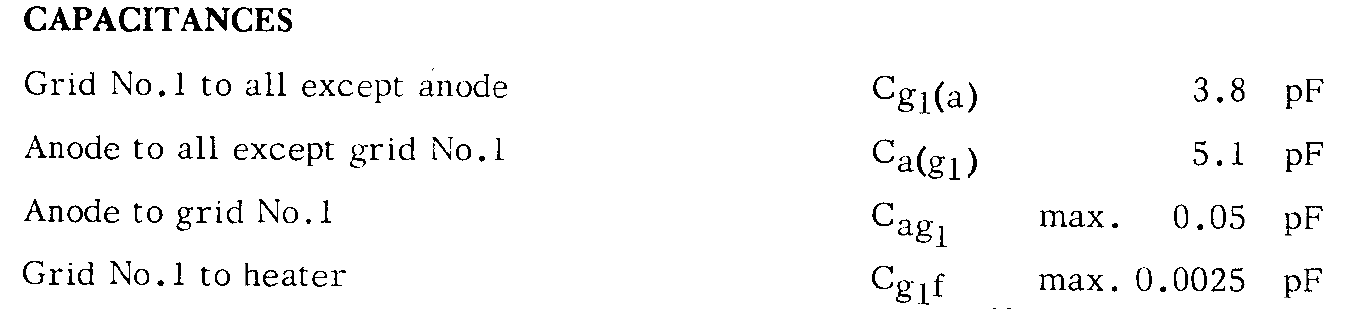

EF86 claims 0.025pFd. 6AU6 claims 0.003pFd. Check your favorite small (RF/IF) pentode.0.365pF anode to grid. I wonder how they measure that!
Put it across, for example, an AM radio IF tank. Typ 100pFd. Shift to 100.365pFd, get about a 600Hz shift of resonance. That may be audible on AM signal, certainly with a stable BFO, and it will go pear-shape with a SSB signal (with a reference carrier).0.365pF anode to grid. I wonder how they measure that!

PRR, to be sure I'm not missing anything here, when you say 0.025pFd you mean regular picofarads, right? Like 0.025pF?EF86 claims 0.025pFd. 6AU6 claims 0.003pFd.
Jan
Philips EF86 datasheet gives 0.05pF.Like 0.025pF?
