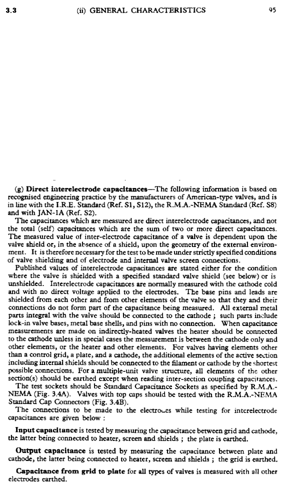

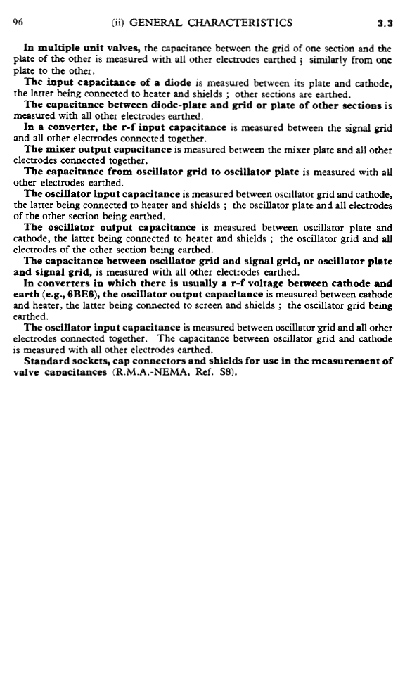

What do you connect to capacitance meter when you measure Cag of a pentode?
Or we could look in the book. From RDH4th:

The problem with the RDH4 schemes is:
Where is ground with a two lead L meter?
Probably at a center tap between the active leads.
That's not very helpful for a pentode.
I went to VA4's author and he advises:
" I wouldn’t attempt to measure pentode Cag directly (although Blumlein would have used a ratio bridge to do so). Just making the connections adds stray capacitances, so although the suggestion would work in theory, I think it would be very difficult to apply in practice because you’re subtracting one large number from another in the hope of determining a small number accurately. It’s much easier to measure Cag by configuring the pentode as an amplifier, measure its low frequency gain from a low source resistance, then add a 100k series resistor and plot high frequency response. All measurements taken from the anode. The Miller effect multiplies Cag to make it measurable by forming a low-pass filter at the input, so (knowing the f-3dB point) you can calculate the input capacitance, subtract Cgk and calculate Cag. I’d probably set up a spreadsheet to fit to the CR filter response to obtain f-3dB accurately. What you would need to be careful about would be end cap capacitance across your series resistor. It’s somewhere around 0.1pF for MRS25, but you could probably reduce it by connecting a string of resistors in series. Even the Miller capacitance method is going to need considerable care in practice. Low capacitance measurements are tricky. I felt I had done really well in measuring 8fF to an uncertainty of +/-60%!
