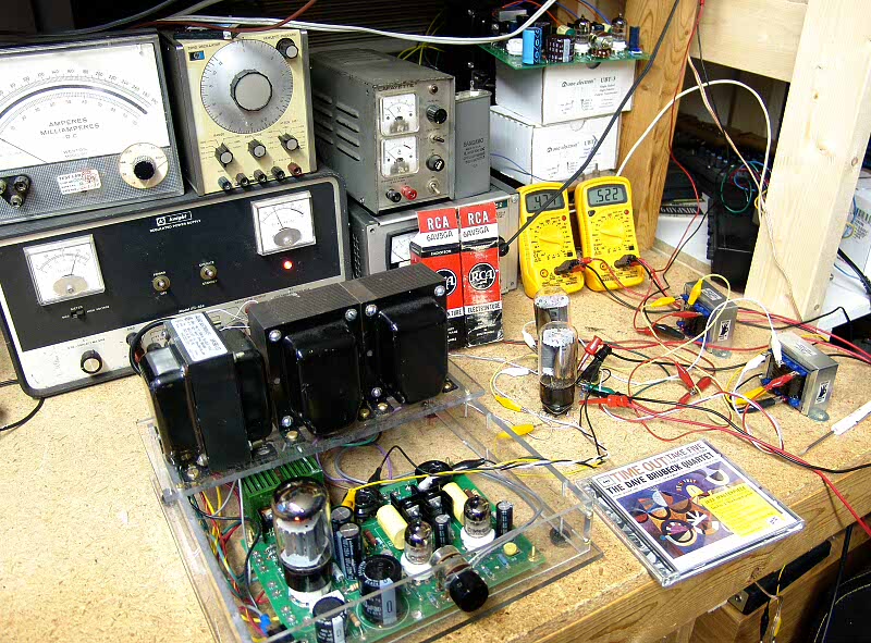

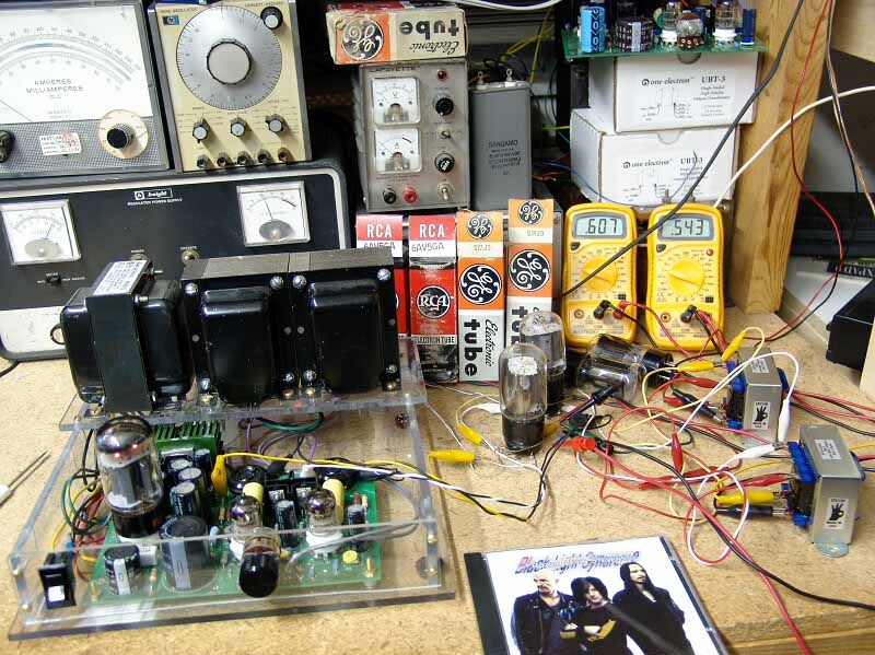

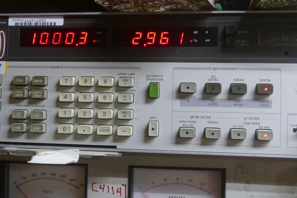

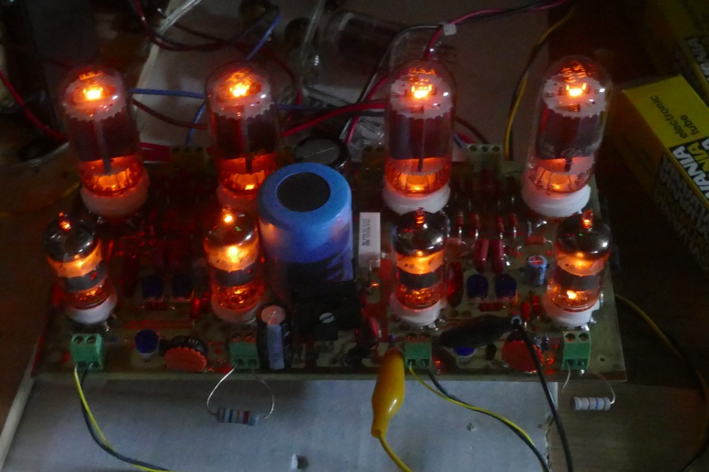

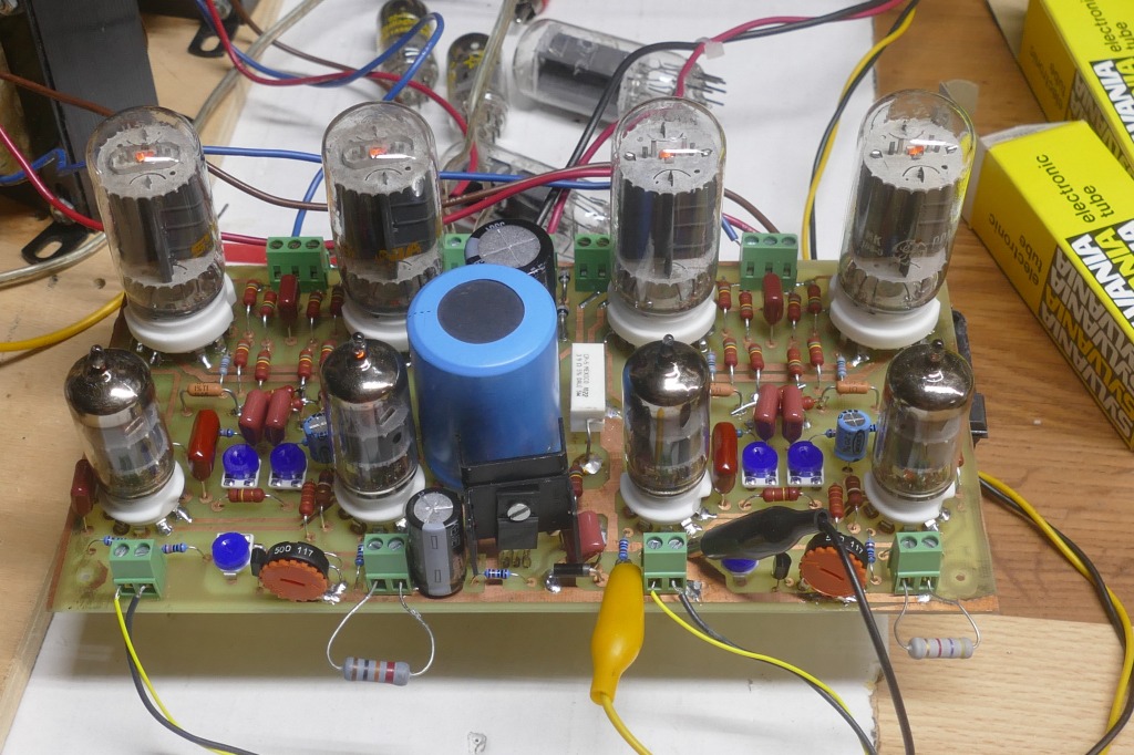

Here, I simply took my 300B TSE board and wired 6AV5's into it using clip leads. I used cheap OPT's at first as to not risk the Electra Print's in the amp. Tried some 6FW5's too.
My guess is that GE themselves wanted some smallish tubes for their constantly shrinking "PortaColor" TV sets. This reached the limit in small CRT tube TV's at about 12 inches with the 'HE7 and 'HK7 damper / output tube Compactrons. Those little TV's got HOT. Hot enough to warp and discolor the beige plastic. RCA also made 6GF5's, but they are slightly taller and don't take as much abuse as the GE's. I think I have three different size 6GF5 tubes in my collection. The smallest are Zenith branded GE's.
This little board makes 80 WPC at 3% THD without melting.

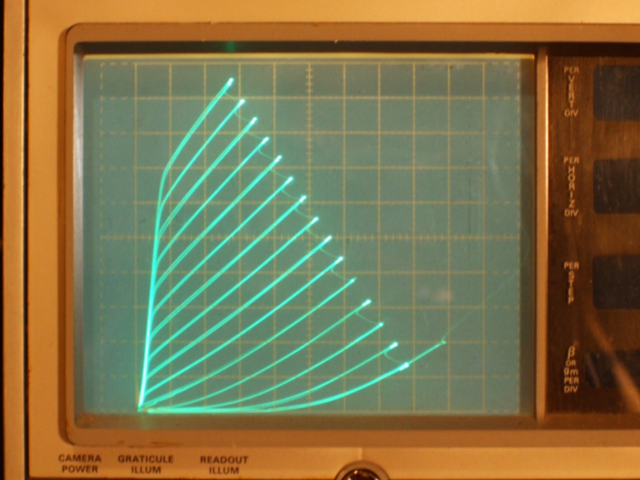

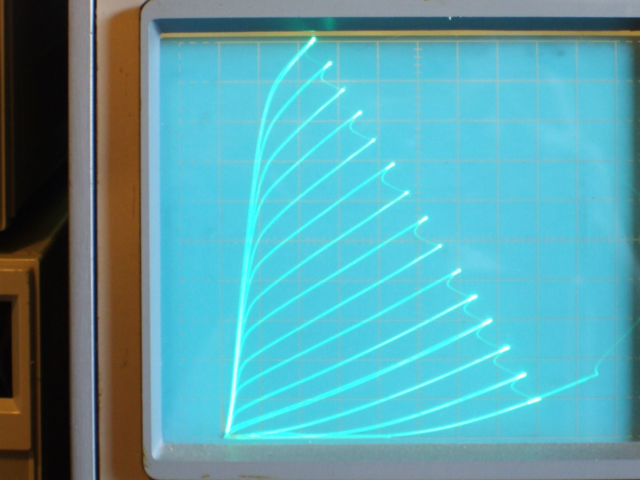

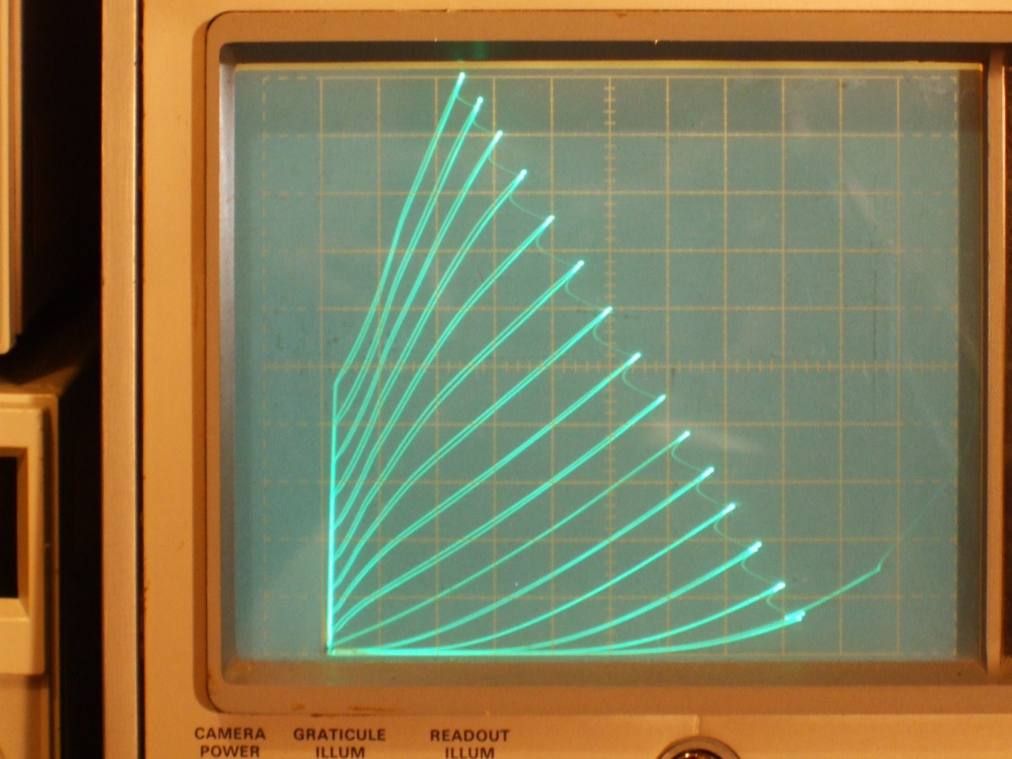

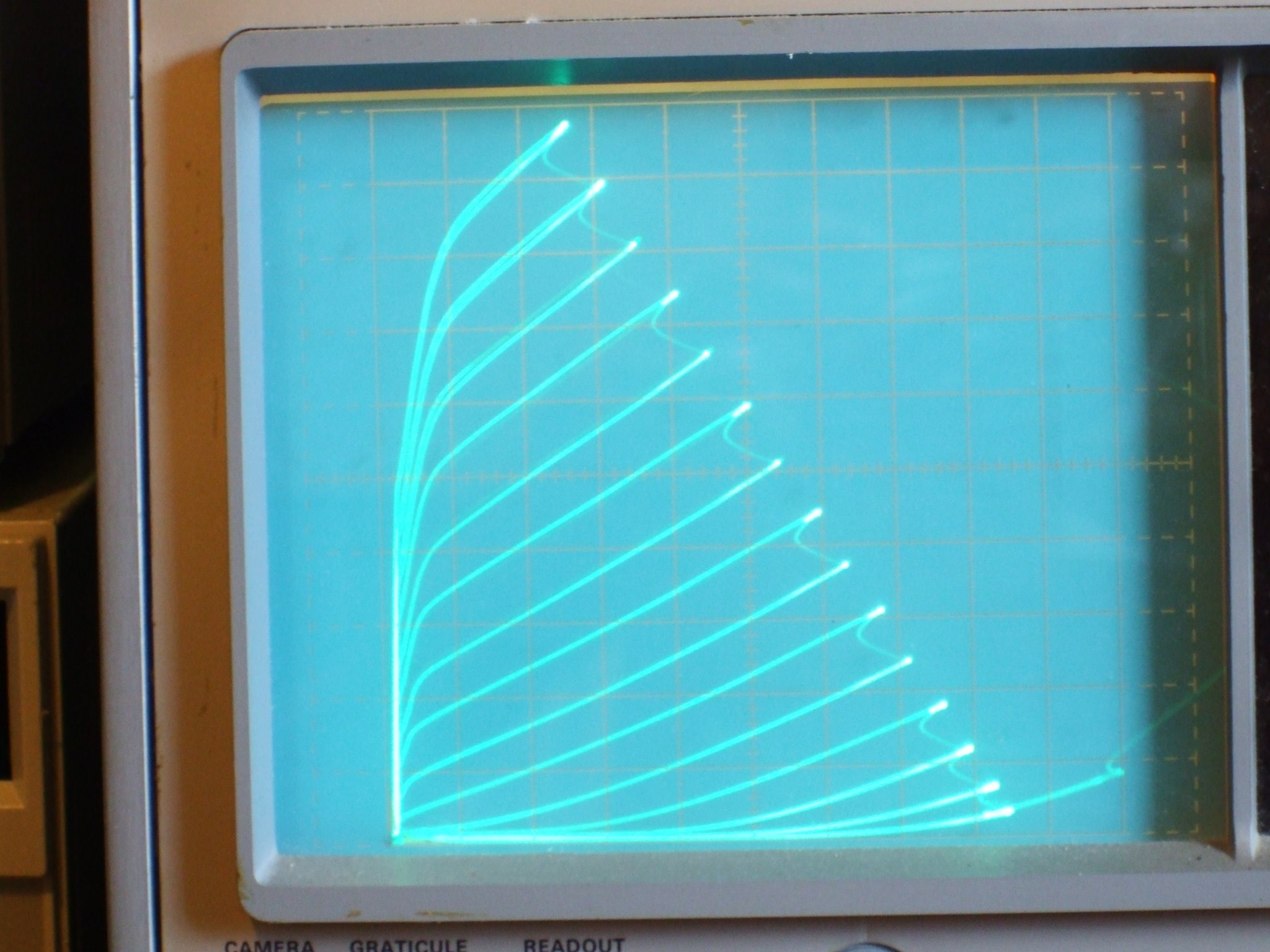

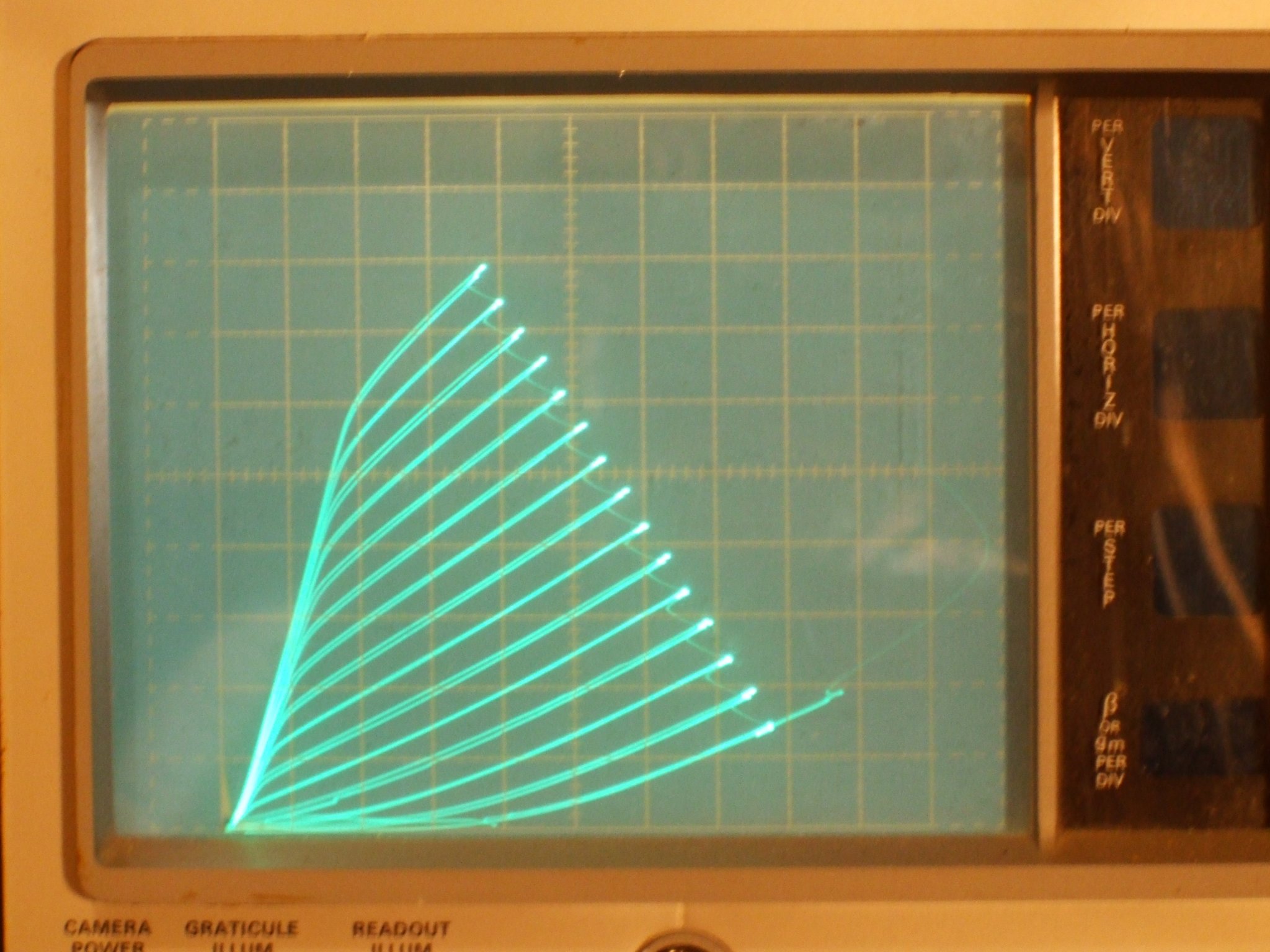

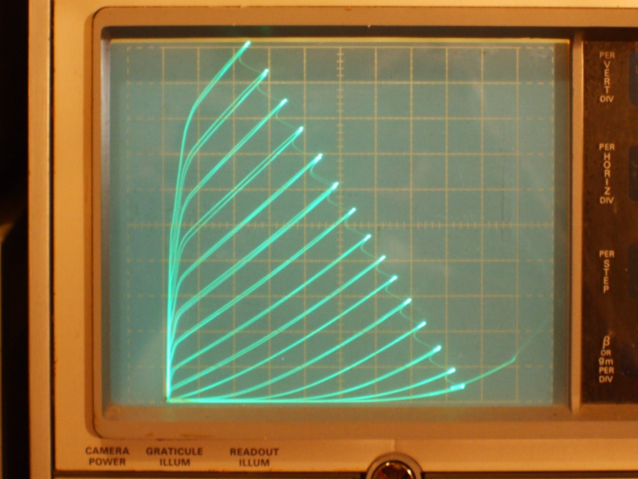

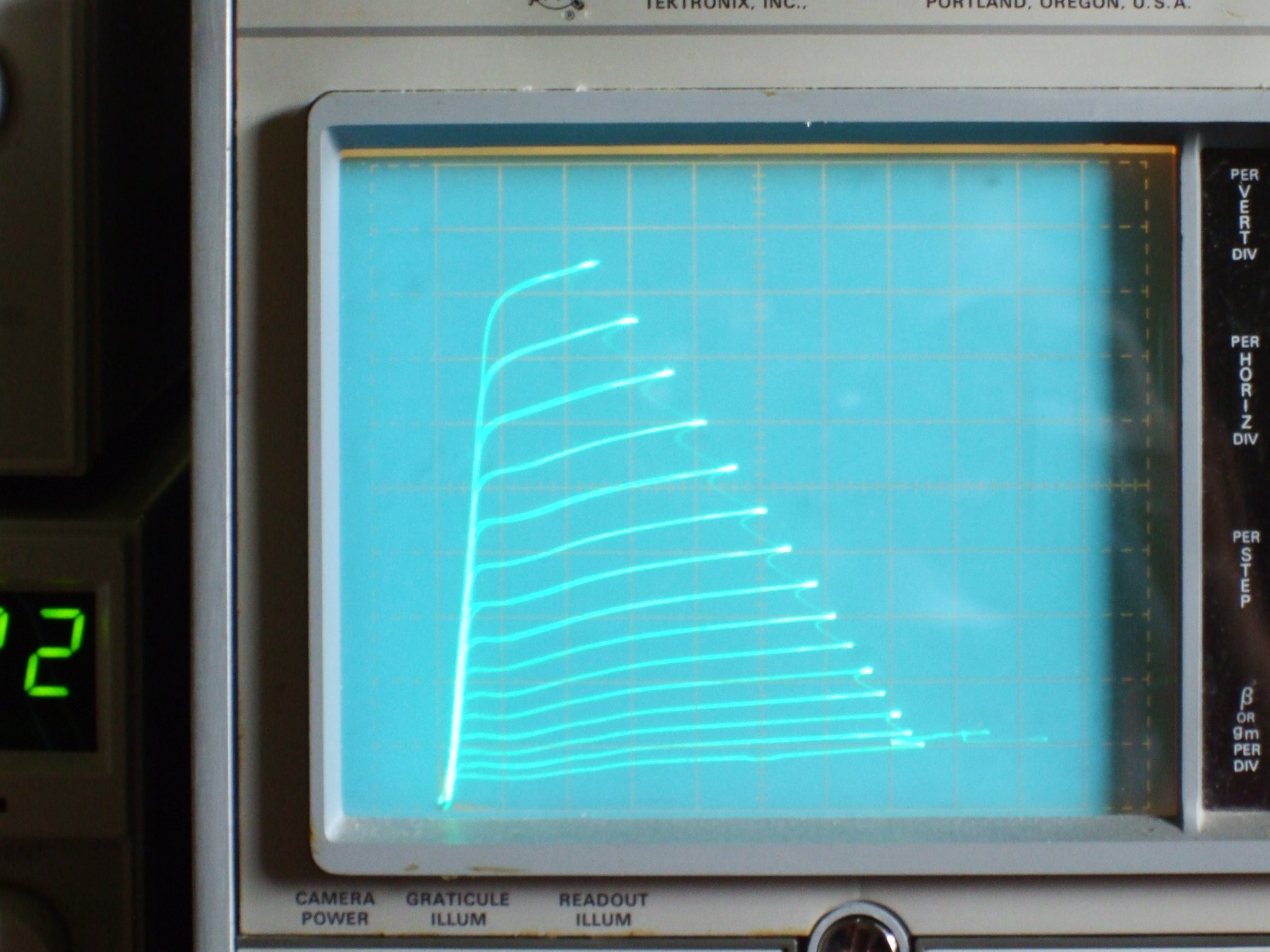

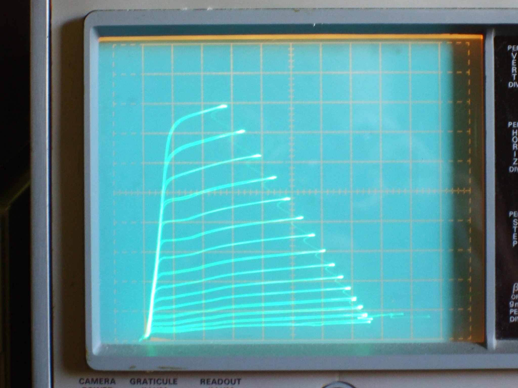

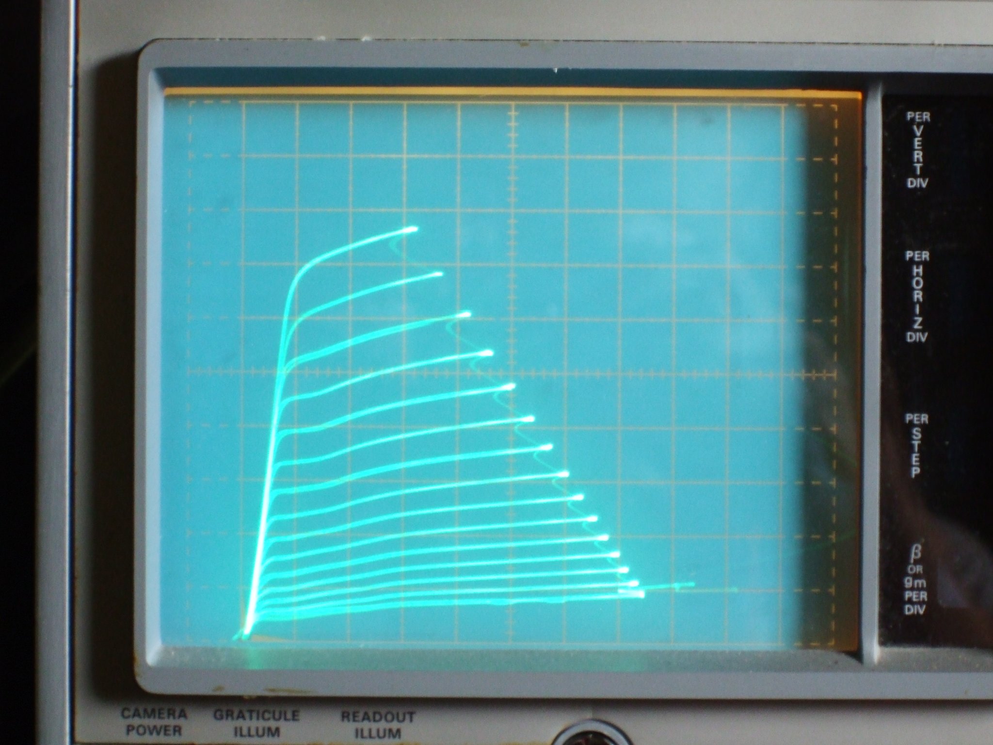

While the curve tracer is behaving itself this morning I got some pics of GE 6GF5 tube curves and a 12GE5.
These are all with 150V on g2, -2V steps on g1 going down from 0V, 50 mA/div Vertical, and 50V/div Horizontal
pic 1 is a GE 6GF5 (this one is exceeding the 12GE5 emission a little at 150Vg2, but has higher knee voltages)
pic 2 is the GE 6GF5 I was looking at last night (surprisingly it now matches the 12GE5 emission at 150Vg2, was slightly lower than the 12GE5 at 80Vg2)
pic 3 is the 12GE5 I was looking at last night
The 6GF5 looks darn close to 12GE5, just the usual tube to tube variation I think. One thing I noticed on these is the 12GE5 has a small cooler fin on the top grid1 supports. I don't see any on the 6GF5s. This is not always consistent across large tube numbers or manu. types. Would have to do some more checking.
Oh, I looked at the cathode width on these tubes and now I don't see any difference. The 6GF5 cathodes are crimped a little differently than the 12GE5s at the mica supports, which may have contributed to some apparent difference before. If there is any difference, it will require busting some tubes to get a caliper in there.
I'll get some 12/6BQ6 curves later. I found a few more in my junkbox.
And I'll trace a Sylvania 6GF5 too.

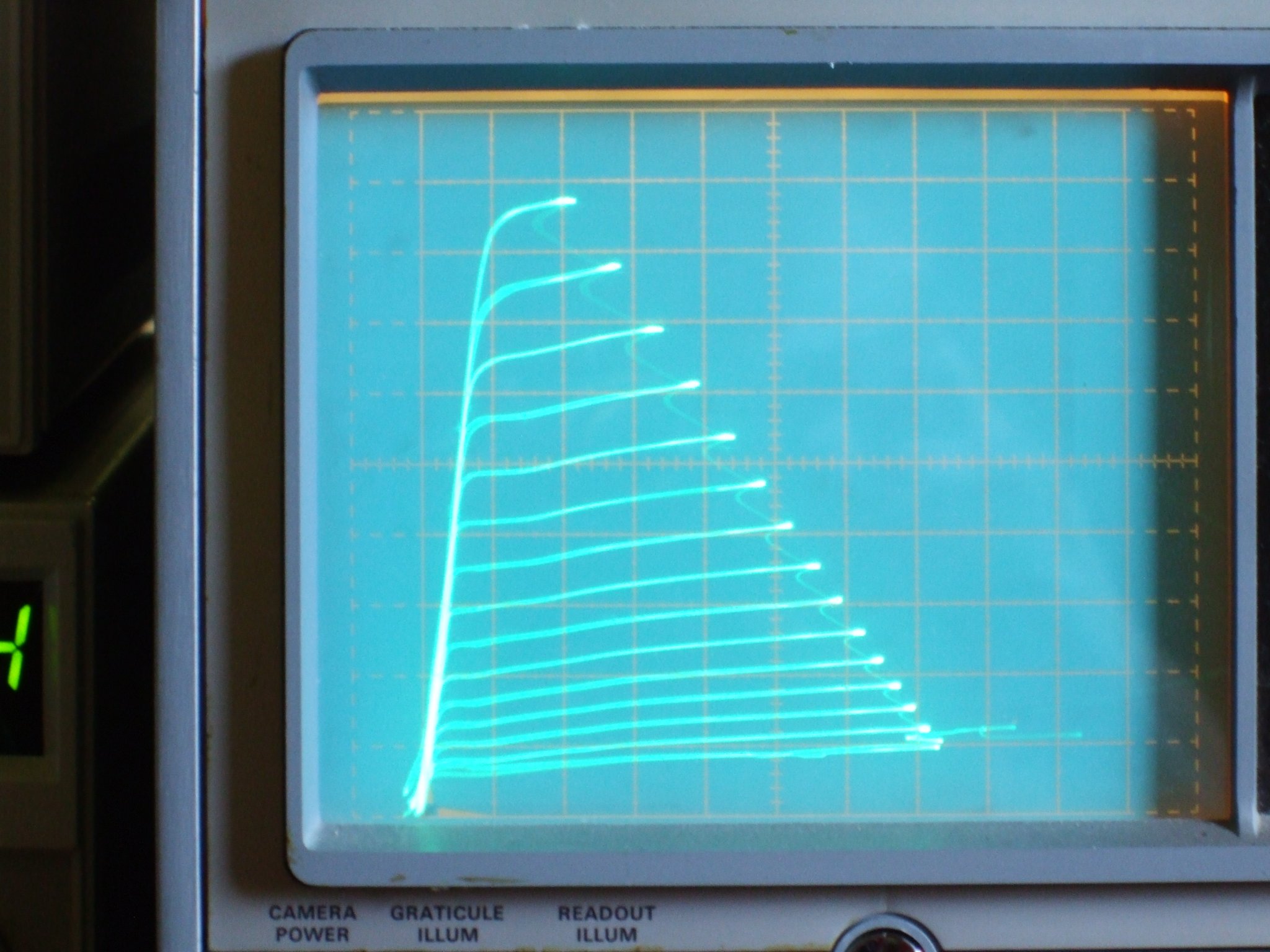

Here is my Motly crew of 12/6BQ6 tubes curves.
All at 150V on g2, 2V steps on g1 (down from 0V), 50V/div Horiz., and 50 mA/div Vert. Like before.
1) Amperex 12BQ6GA this tube has a smaller plate with square corners and small cooler fin on g1
2) Raytheon 12BQ6GA bigger, black plate, cooler fins on g1 and g2
3) Raytheon 6BQ6GA Japan small cooler fin on g1, big square plate hardly fits in the bottle, someone wrote UL=60 on lower mica!
4) GE 6BQ6GA small cooler fin on g1, plate looks just like GE 12GE5
5) Sylvania 6BQ6/6CU6 square corner gray plate similar to Raytheon
Other than the smallish plate Amperex, these curves all look similar to the 6GF5 and 12GE5

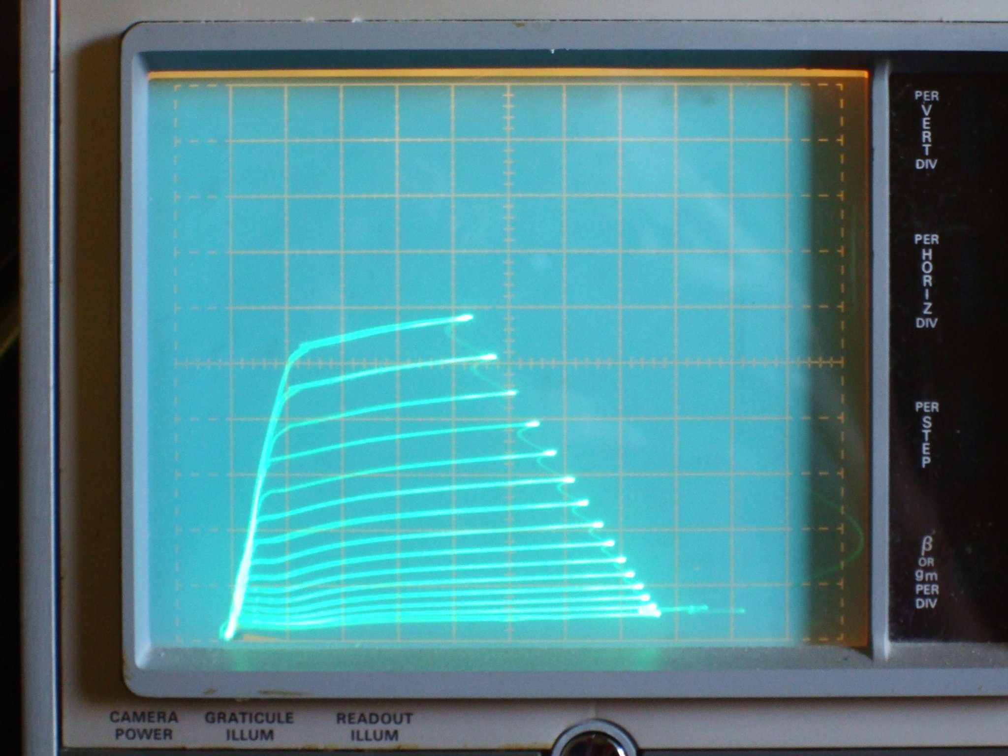

Here are some more 12GE5 tube curves.
Same settings: 150V on g2, -2V steps on g1 going down from 0V, 50 mA/div Vertical, and 50V/div Horizontal
1) another GE 12GE5
2) Sylvania square plate
3) Sylvania GE style plate
I looked at some RCA, Raytheon, Dumont, ITT, and PHILCO 12GE5s and they all had plates just like the GE ones, probably made in the same factory. So I didn't bother tracing them.

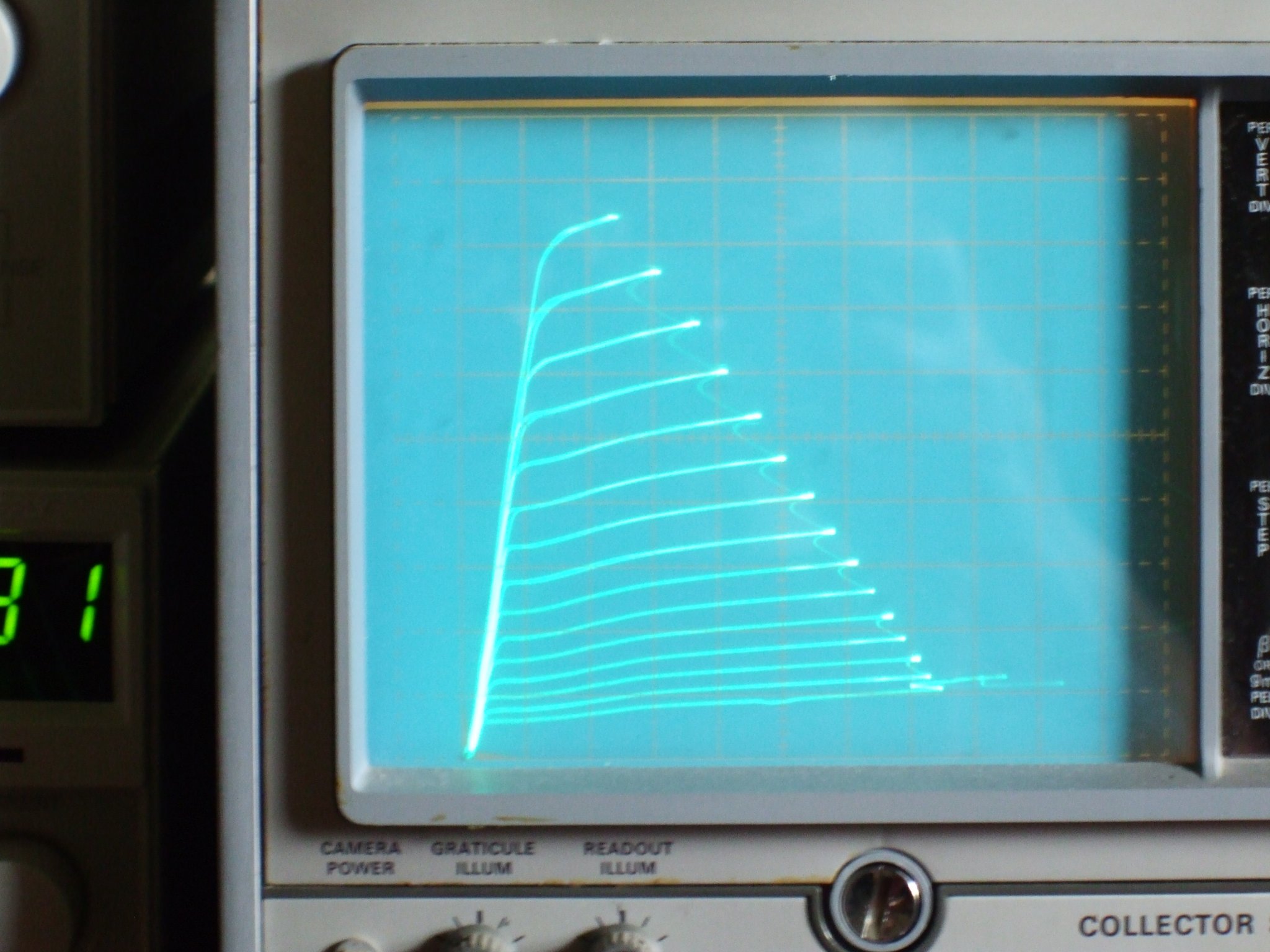

17KV6A curves: 120Vg2, 2V grid 1 steps, down from 0V, 50 mA/div Vertical, 50V/div Horizontal

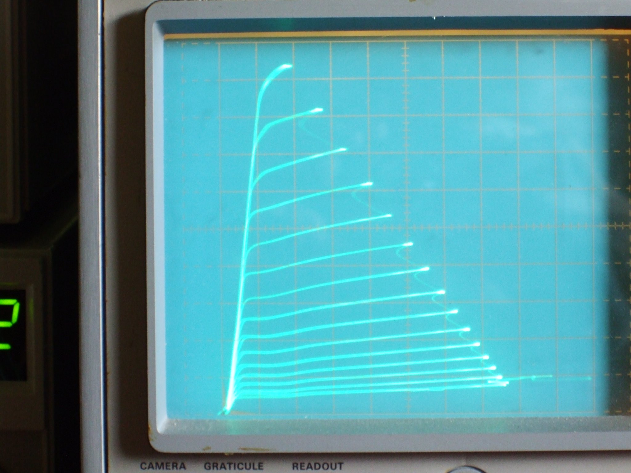

Getting back to the Beam Triodes, I rigged up an IXYS IXTU01N100 Mosfet (1000V) to drive the grid1 of the beam triodes as a follower, with the grid current returned to the plate via the drain connection. This looks to have improved the triode curves for a flat plate 6JH5 some. Lower Volt knees. But I see a non-linearity (shrunk spacing) in the plate curve spacing now, around the - to + grid transition. This may just be due to my using a wimpy 100K pull-down resistor to cathode for the Mosfet Source (and grid 1) point.
I tried a 6JK5 boxlet/cavity plate tube with the Mosfet too, but the results are not so good , 4th pic below.
The curve tracer is going up to 750V here for these curves, but for a real Amp. more than 2x B+ rating would be needed for the Mosfet driver (with it's Drain connected to the plate for grid current combining). So a small Sweep tube like the 6GF5 (curves above) would be a good fit. I'll get some curves for that setup soon, but I would expect that to be very similar to the Mosfet case.
The Mosfet driver did not even get slightly warm, since it carries most current when the plate V is low.
Since the grid current combining benefit is no big deal, it may be more practical to just use a low voltage Mosfet with it's drain connected to like +15V. A resistor in the drain circuit to limit grid current. (ie., Power Drive)
pics below: same scale as before for the beam triodes: 20 mA/div Vertical, 100V/div Horizontal, more like +0.6V grid steps here (to fit full screen) except +0.5V steps for the 3rd pic (old pic)
1) 6JH5 (flat plate) normal +grid drive (like the previous Beam Triode curves using +grid drive)
2) 6JH5 (flat plate) Mosfet enhanced +grid drive (grid current added to plate current) notice the knees are now closer to the left axis
3) 6JK5 (boxlet/cavity plate) normal +grid drive (previous 6JK5 pic again)
4) 6JK5 (boxlet/cavity plate) Mosfet enhanced +grid drive (grid current added to plate current)
Disappointing that the boxlet plate type is still performing poorly with the Mosfet fix, since these are a far more common beam triode tube.

Yep, I changed the Source/grid pull-down resistor to 1K Ohms and the curve spacing anomaly disappeared. Pull-down to -2.5V from cathode actually.

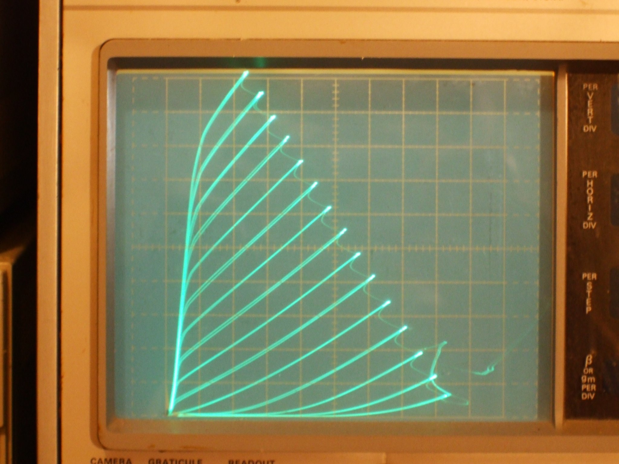

New 6JH5 flat plate with HV Mosfet assist pic #1 below. Nice even curves now. Pic #2 is the normal +grid drive only again for comparison.
Still probably not worth the extra effort for the HV driver to combine grid current with plate current for the modestlly lower knee voltages. (looks like maybe 40V lower knee at 180 mA) But it's an option, especially if one is going to use a lower plate voltage than +750V. The 6GF5 driver should be able to do it easily. Otherwise a LV Mosfet Power Drive will do. (one less tube)

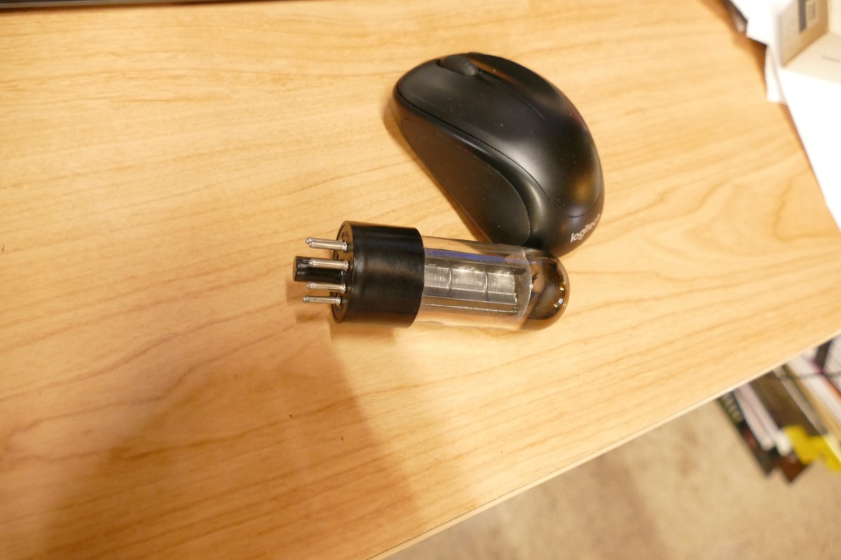

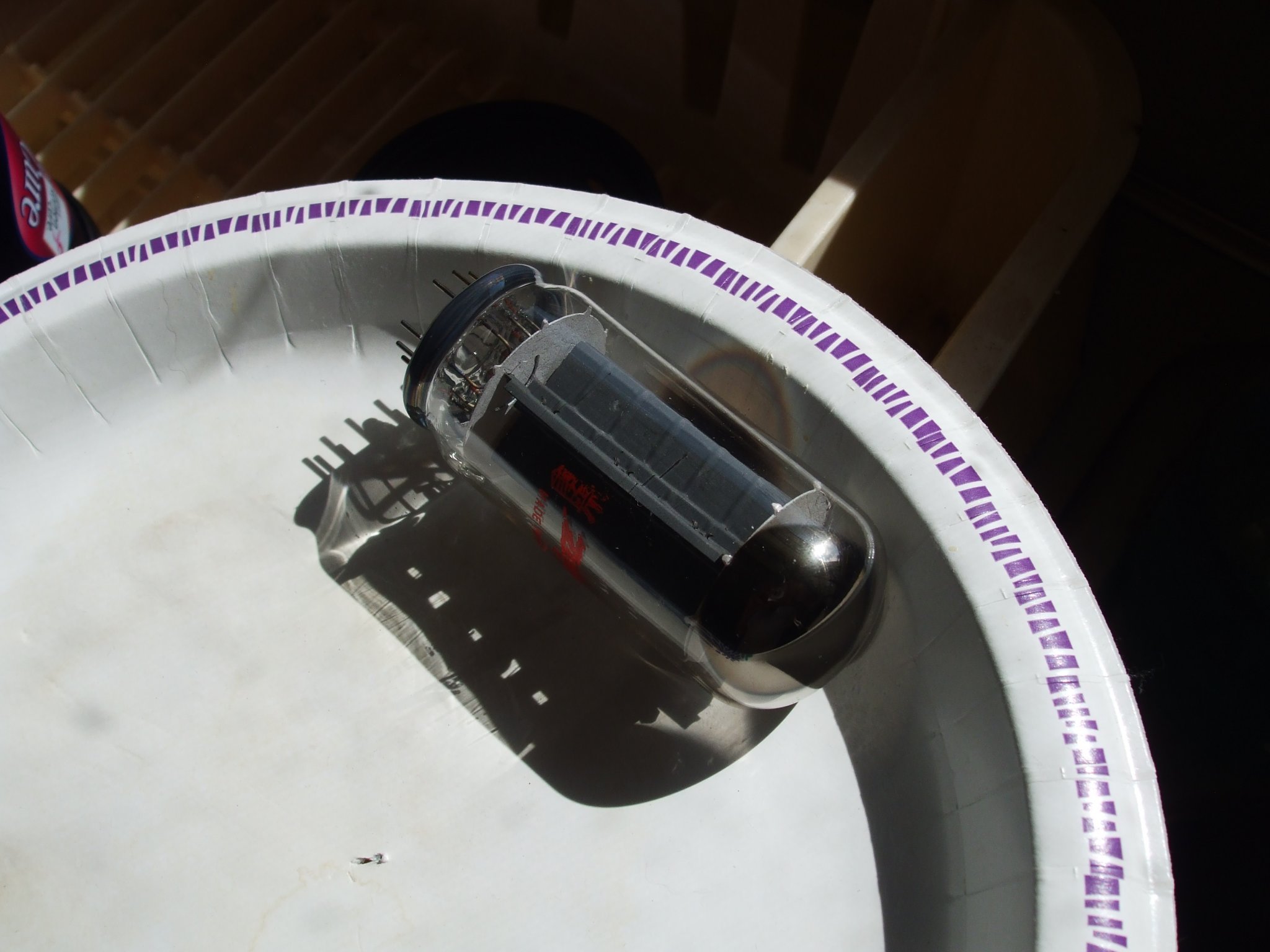

I've found an odd-ball Zenith 6JD5 Beam Triode in my junk box. It has a boxlet/cavity plate, but the bulge is only half the width I've seen on others. Likely made for a single Barkhausen fin rather than the two fins usually used. I've looked inside it with a magnifying glass and light and I don't see any fin.
So I curve traced it and it's -near- to a flat plate tube. This gives some hope that some of those boxlet types out there may be like this. Tough to tell from many Ebay pics though. Also confirms to me at least that these boxlet deals are the source of the problems.
1) 6JD5 Zenith half boxlet normal +grid scan
2) 6JD5 Zenith half boxlet Mosfet assisted +grid scan
3) pic of the 6JD5 tube plate
4) 6HZ5 flat plate normal +grid scan for comparison
