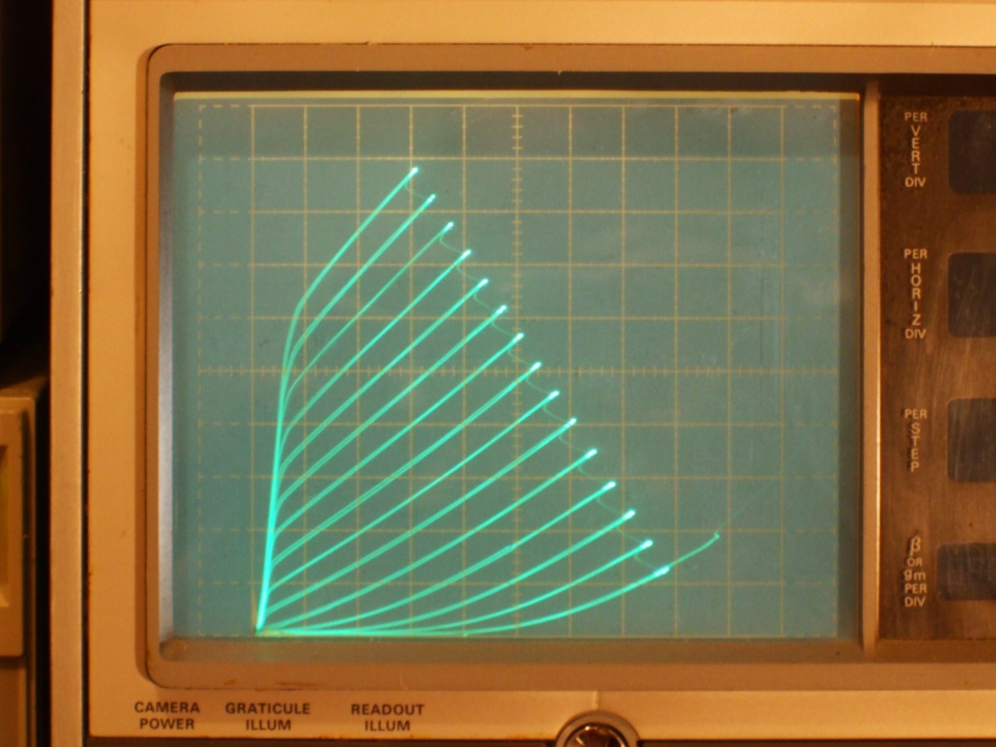

Here is the 6HZ5 again, for comparing.
For practical LV use, you're looking at 7500 Ohm Rp with these. Good luck finding a 23000 Ohm OT for triode loading use. I guess some N FDBK could help, but then its just like using a regular Beam Power tube. Or triple them up. At least they look nice without the plate caps and are cheap for a 35 Watt TV tube. $30 for 6 tubes gets you a 300 Watt amplifier if you can find a suitable OT.

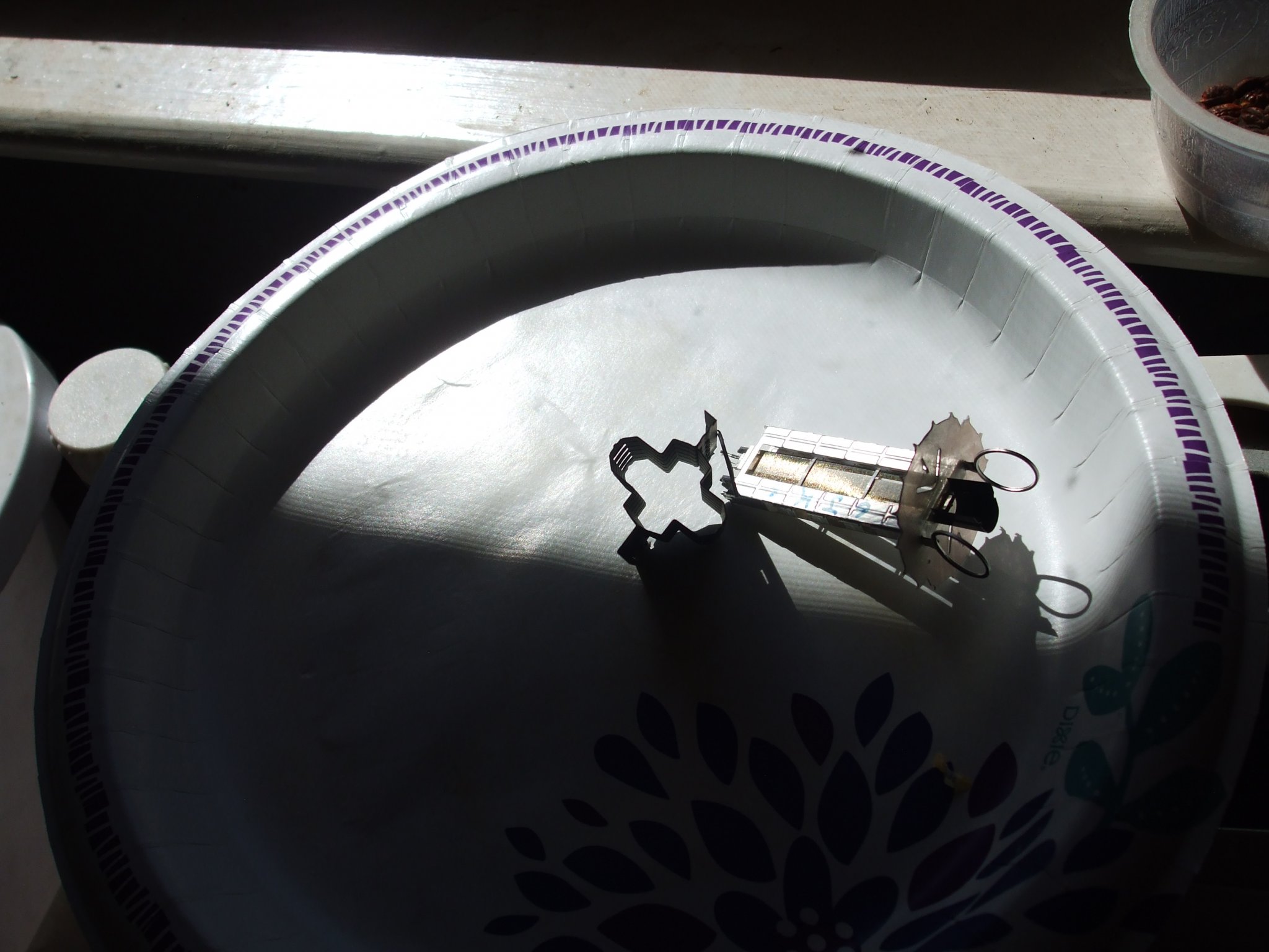

Since the 6JK5 did not have very good curves for the medium high plate voltage (and + grid1) test, I dissected it. Appears to be the same as the other 6HZ5/6JD5 and 6JH5 tubes EXCEPT for 1 thing. It has the boxlet mods to the plate (extended inside box section attached to the crimped plate supports, just outside the beam forming sheet slot) , without the Barkhausen fins usually inside them. While the other tubes have conventional flat plates with no Barkhausen fins. Without the Barkhausen fins inside the boxlets, the plate is effectively more than twice as far away from the grid 1. No wonder they don't work well at reduced plate V. To make matters worse, I see International brand 6HZ5/6JD5 WITH the boxlets. So beware of those.
Some time down the line, I'm really going to need to sit down with a small pile of 6HV5as and plot the plate curves at ~700V plate voltage and positive grid bias via a mosfet follower. Since I don't have SA's nifty-doodle curve tracer, I'll have to do things the old, tedious way and plot the results in Excel, just like I did with the screen-driven 6CD6. I'll include a small sense resistor between the follwer and 6HV5A grid so I can also keep track of the grid current as a function of drive. I need to cruise back to Vinylsavors's site and look at his dissection of a 6HV5A to see if I can find any Barkhausen stubs on the beam forming plates.

Here is a pic of the 6JK5 Beam Triode plate with the "boxlets" (or cavities) but missing the Barkhausen fins normally inside them. (had poor reduced V curves)

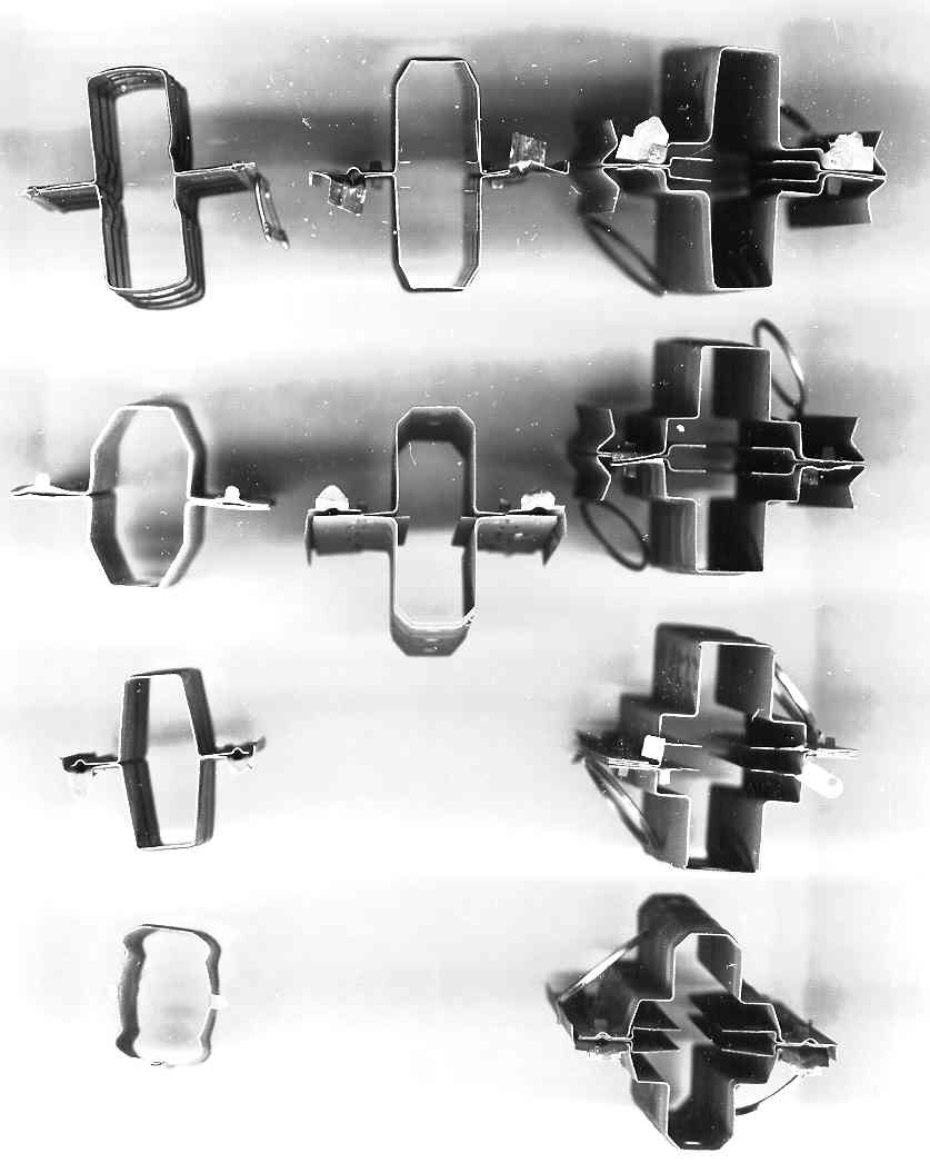

Then a pic of some TV Sweep tube plates, with common "boxlets" and typical Barkhausen fins inside in the right side column. Bottom right plate what would normally be expected here.
Top left plate is similar to the plain 6HZ5/6JD5, 6JH5 Beam Triode plates. (which had good reduced V curves)
So looks to me that one has to be quite selective to get Beam Triodes that work well at reduced B+ and positive grid 1 excursion. Most of the Beam Triodes I see on Ebay have the dumb "boxlets".

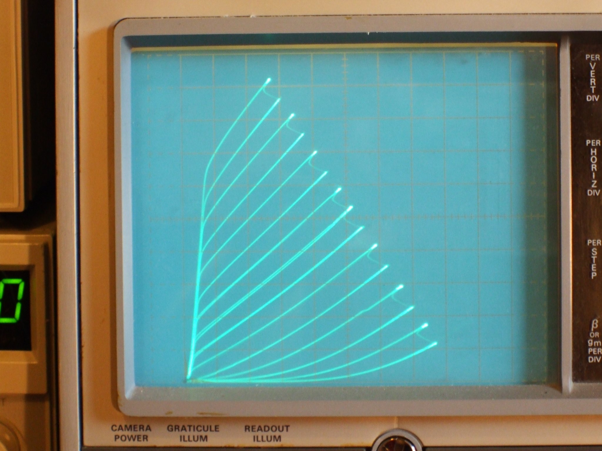

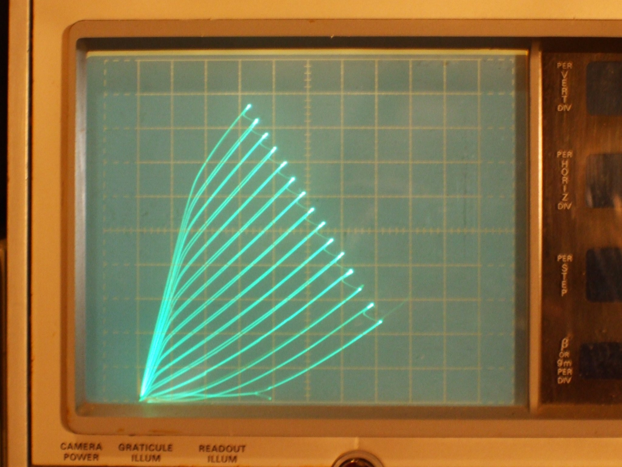

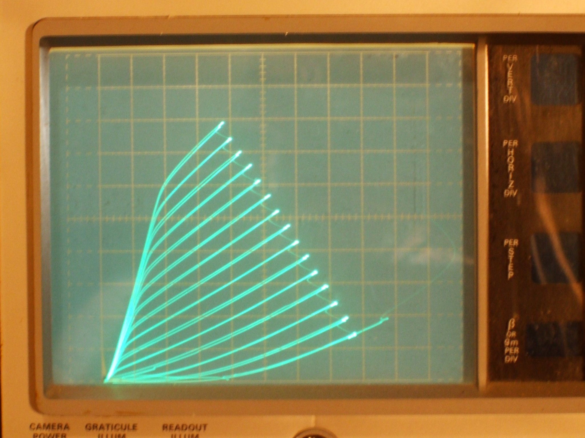

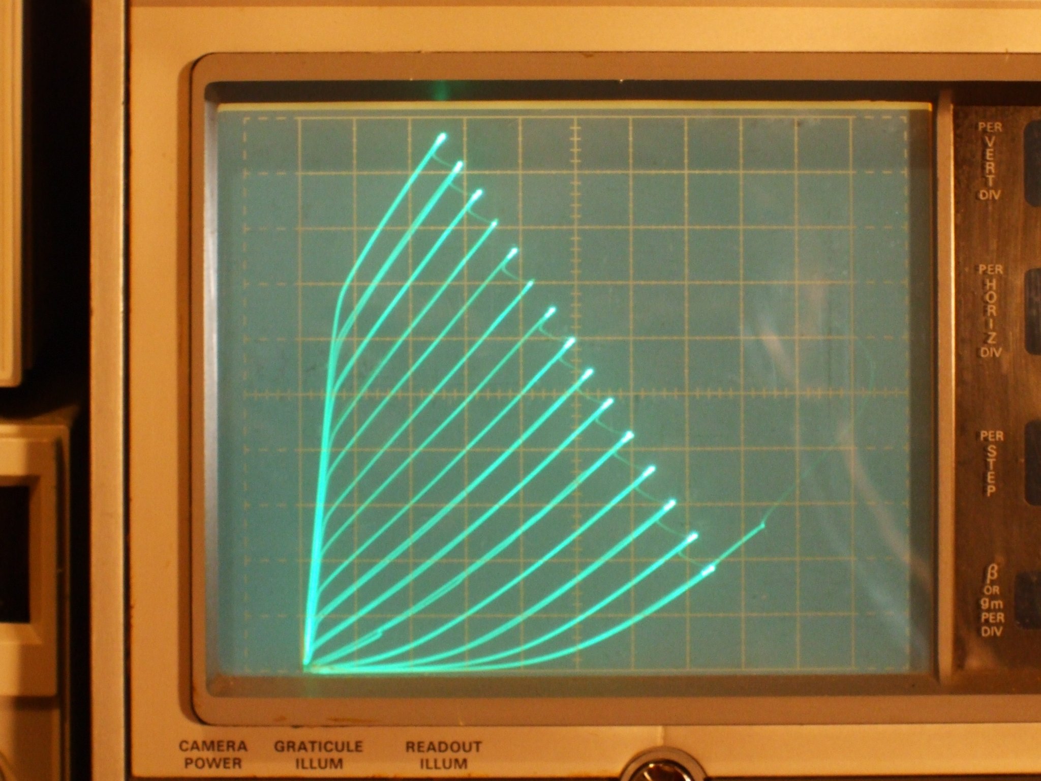

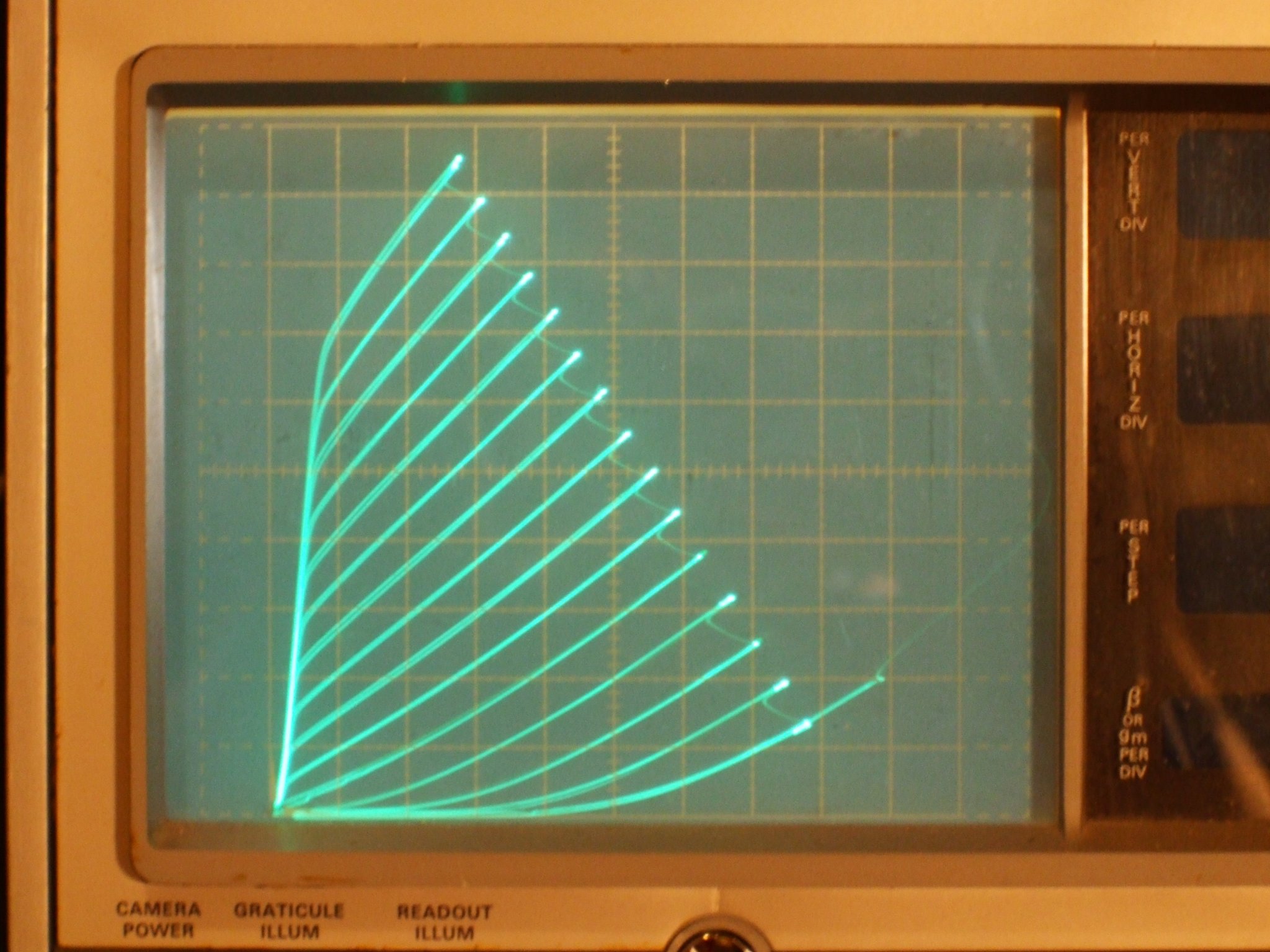

I've traced the 6HZ5 (flat plate) and 6JK5 (boxlet/cavity plate) Beam Triodes again ( I have a 2nd 6JK5 after busting open the other one) with the Beam plate connected to the plate this time for each, instead of to the cathode. This makes for some small improvement in curves for the 6JK5, and a smaller improvement for the 6HZ5. The non boxlet 6HZ5 still has the best curves, but the boxlet 6JK5 is looking a little better than before.
I then measured the current drawn by the beam plate for each tube type when beam plate is connected to the plate, and was surprised to find rather lower than expected beam plate current draw for both tubes. So the scheme looks quite practical (beam plate will not be getting red hot). Pics and beam plate current data below:
Pics (4th curve up is 0V on grid 1) 0.5V grid steps, Vertical 20mA/div., Horiz 100V/div
a) 6JK5 normal connection to cath.
b) 6JK5 beam plate to plate conn.
c) 6HZ5 normal connection to cath.
d) 6HZ5 beam plate to plate conn.
Beam plate to plate conn. seems to increase plate current for all curves and moves the "knees" slightly left.
The 6HZ5/6JD5/6JH5 curves look good enough to make an amplifier, so I've ordered an 8K OT from Edcor to try these out. (2+2 tubes for class AB P-P with around 750V B+

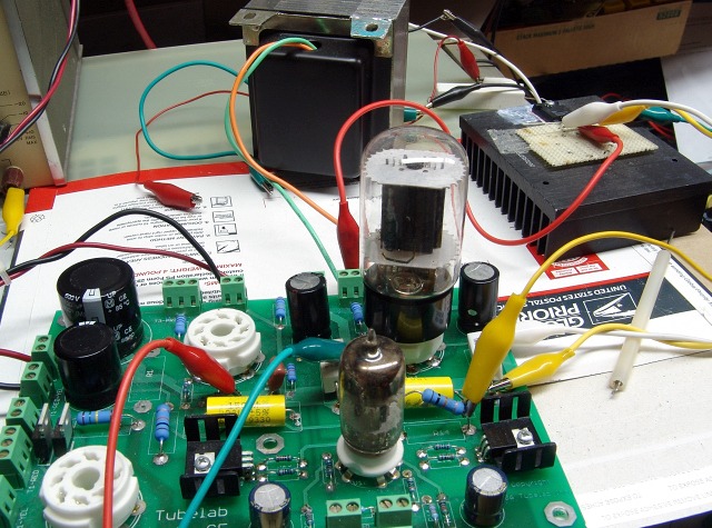

I have a few each of several flavors of these beam triodes. When I get a chance I'll stick some into the unset board and see what happens. It should be possible to tweak the feedback resistors to trade off some Mu for Rp.
