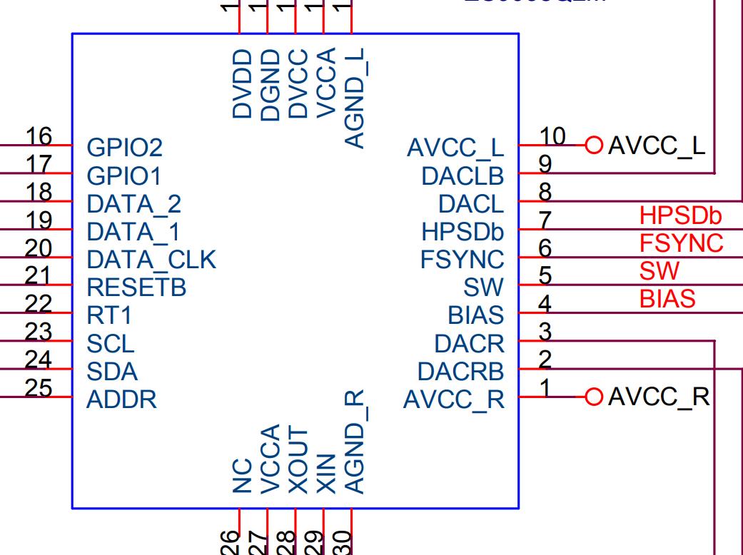

Here are the schematics for the ES9822PRO ADC. It is dual mono, however the data sheet is unclear on how to set up multiplexing left/righ data on the same output. I had to make some assumptions and added switching bridges (resistors) to allow several possible combinations. Trial and error will follow...
The input stage use the OPA1612 opamp, not much to comment about.

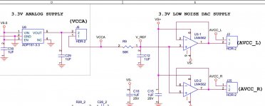

The power supply, I decided to use the ES9311 LDO regulators for the Reference voltages. The ES9822PRO data sheet is also unclear about the performance required in the AVCC power supplies, so I decided to assume the worse and throw in a pair of extra LT3045 (probably an overkill). Power sequencing is per the ES9822PRO data sheet.
Also attached is the clock generator for the integration with the XMOS chip (software is in development). Pretty much the XMOS audio reference board implementation, with a few tweaks (added clock buffers and series resistors for clock distribution, used a decent clock chip instead of a simple crystal, modified the power distribution).

Some parts may still have incorrect values, due to the heavy copy/paste when drawing, sorry about. Comments are welcomed, I am in particular interested in ideas for loop testing, before integrating with the XMOS controller and USB bridge.

Regarding the "super regulator" I used recommended by ESS way, please take a look ESS 9038Q2M demoboard.pdf

Well then, which values/types do you use?ESS uses no caps, see attached. I do because my 2 layers PCB impedance isn't so low 😉

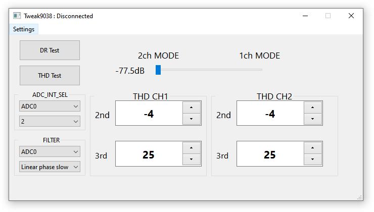

Tweak9822.exe app for Windows in progress. Also working on Cosmos_FFT.exe, which will be pretty plain 2ch FFT app(WASAPI) but with correct THD, THD+N and SNR calculating + a few "new" ideas one is "photoshop" used APx555 to mix before+after notch FFTs to single one. Maybe with generator but I not sure if we need that, rather Tweak9822.exe will be a part of FFT.exe.

Why U3 is powered also with VS-?
I used similar power supply in many devices, but w/o the negative rail. This decrease OP heating, especially when it power something voracious, like 9038Pro or 4499.
