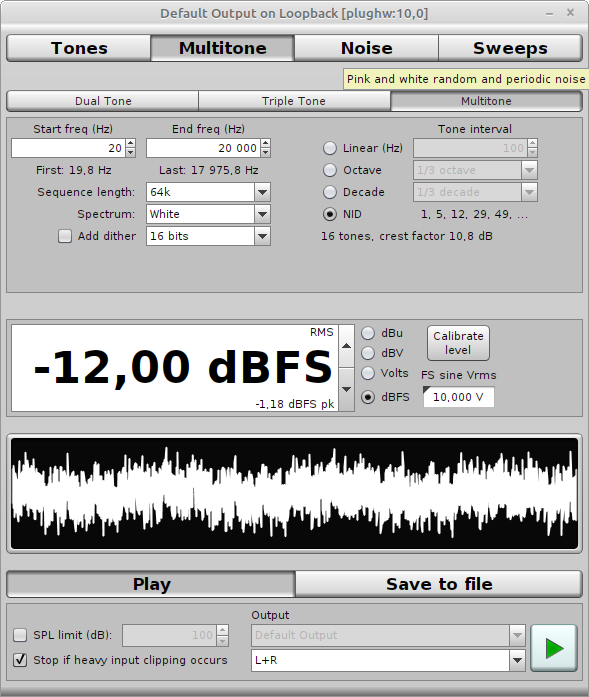

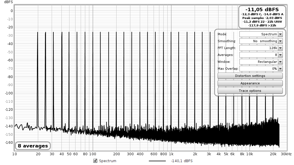

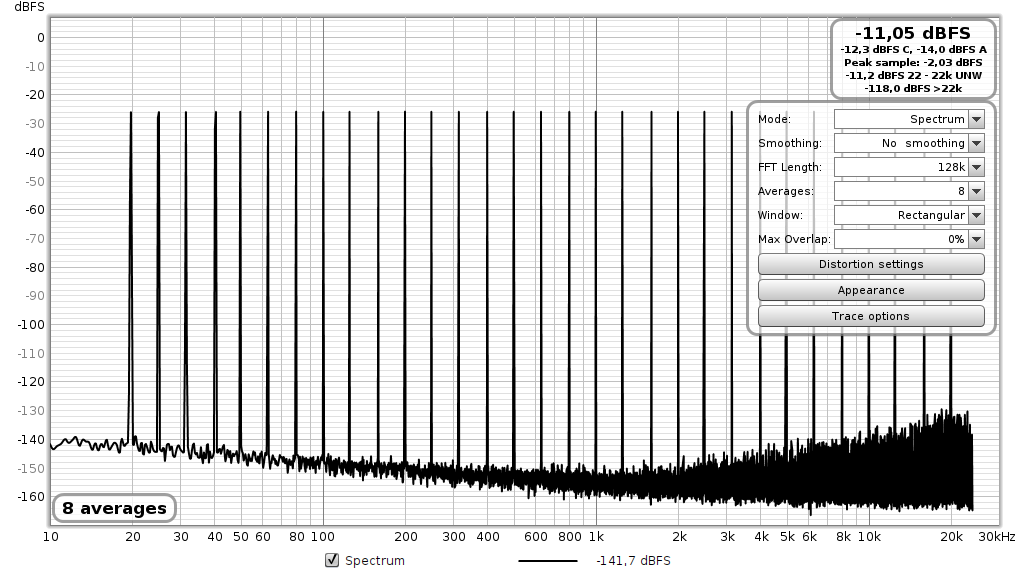

Those are good results. One problem with the REW multitone test is theat the harmonics land on source tones. There are specific sets of tones that do not have this issue.
From AES E-Library » A New Class of In-Band Multitone Test Signals
Phi 6 Spectral: 100, 261.8, 685.4, 1794.4, 4697.9, 12299 Hz. Individual level of each tone is at-15.6 dB. Phi 12 Revised Spectral: 100, 122.0, 261.8, 348.2, 685.4, 987.0, 1794.0, 2870.4, 4697.9, 6765.0,12299, and 16358 Hz. Individual level of each tone is at -21.6 dB. Phi Low-High Split Band Spectral: 100, 116.18, 134.98, 156.80, 182.19 and 4697.9, 5927.8,7479.7, 9437.9, 11909 Hz. Individual level of each tone is at -20 dB. Phi Low-Mid Split Band Spectral: 100, 116.18, 134.98, 156.80, 182.19 and 986.99, 1245.4, 1571.4,1982.8, 2502.0 Hz. Individual level of each tone is at -20 dB. Phi Tri-Band Spectral: 100, 116.18, 134.98, 156.80, and 986.99, 1245.4, 1571.4, 1982.8, and6764.9, 7618.5, 8579.8, 9662.5 Hz. Individual level of each tone is at -21.6 dB.

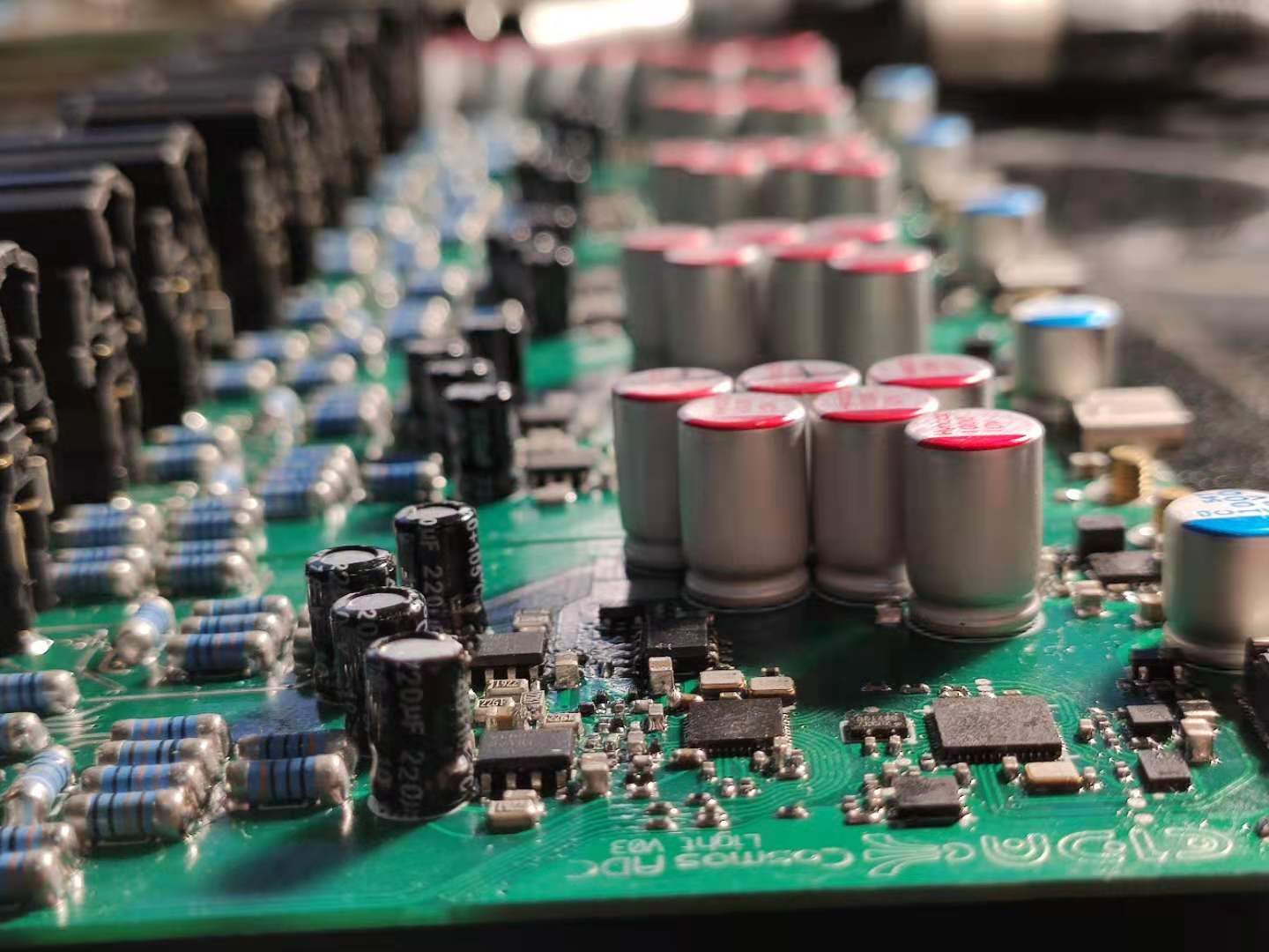

5 samples of Cosmos ADC were soldered by my hands and will be sent for tests.
Regarding compensation technics, no doubt does exist the way to get 9822 THD even better but who really needs that if a simple 90x50mm board being powered from USB, provides a few db better THD+N performance than AP SYS2***?
Yes, my test used 1/3 octave spacing (IMO the same as Amir uses in his ASR tests) which is suboptimal here. REW offers a no-interharmonic-distortion sequence Signal Generator :
The tones can be spaced linearly, logarithmically at a selected fractional octave or fractional decade interval or in a sequence that places the tones such that they do not correspond to the low order harmonic or intermodulation products of other tones ('No Interharmonic Distortion' or NID). Octave fraction spacing uses frequencies from the preferred list. In all cases the tones are placed at the bin centres of an FFT of the selected sequence length, so that the behaviour of a system fed by the tones can be observed on an FFT with at least that length using a rectangular window.
