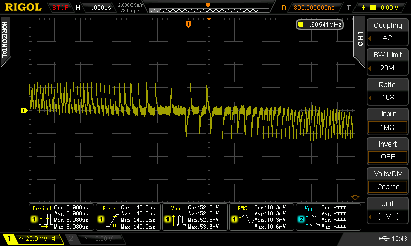

In ES9018 there's the 6-bit DAC itself, that makes 1LSB = 3.3/64 = 51mV steps which appears divided by 2 on below screenshot because 50R termination is on in the scope:
You can check at which frequency it runs by playing a low amplitude sine and looking for the max pulse frequency which occurs between two LSB levels. Since it is clocked by MCLK I doubt it runs at a multiple of Fs, most likely an integer division of MCLK.
I have a hunch that the hump may be due to the transition from multibit to 1 bit, which is why I suggested adding a 1/2 LSB digital offset to move this transition to another output level and see if that moves the hump. I can't test it because that board has been a victim of science 😀

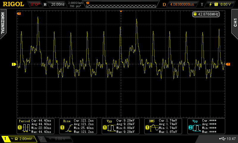

If this runs at MCLK that would explain why the output contains analog pulses at MCLK:
I'm not talking about the clock feedthrough spikes, I'm talking about the ~4mV pulse that repeats twice.
I have to admit now I'm confused 🙂
The second screen seems to show that the DAC outputs a bit every ~22ns or with a frequency of ~45MHz. What was your MCLK? Does this mean that the DAC changes values on all 64 resistors with a frequency of 45MHz? That would mean that the 6bit modulator is running at 45MHz which seems extremely fast IMO.
Or does it only switch voltage to one of the 64 resistors every 22ns?
Yes 45.1584M
No because the height of the pulse is much smaller than one LSB which would be 1/64 of AVCC. Due to 50R scope termination it is double than what it says on the V/div, but that's still much lower than 1/64 AVCC.
I suspect the DEM/scrambling so the pulse would be mismatch between two output cells showing up. Or maybe it is leakage.
So let's assume the 6bit modulator runs at MCLK/64 - your theory would be that the DEM runs at MCLK and permutates the bits that are on with this frequency?
One more thing - to make the shown value on the oscilloscope amplitude half it's actual value the DAC's output impedance would have to be 50Ohm also - which DAC chip did you use? If it's the ES9018S that would mean all 8 outputs in parallel?!

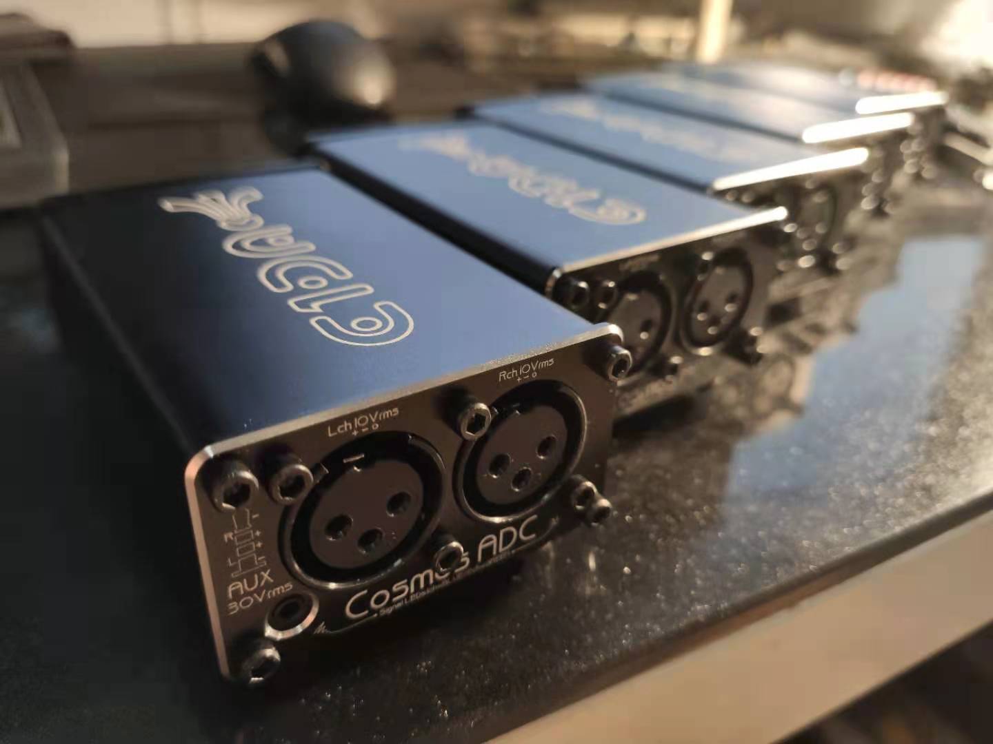

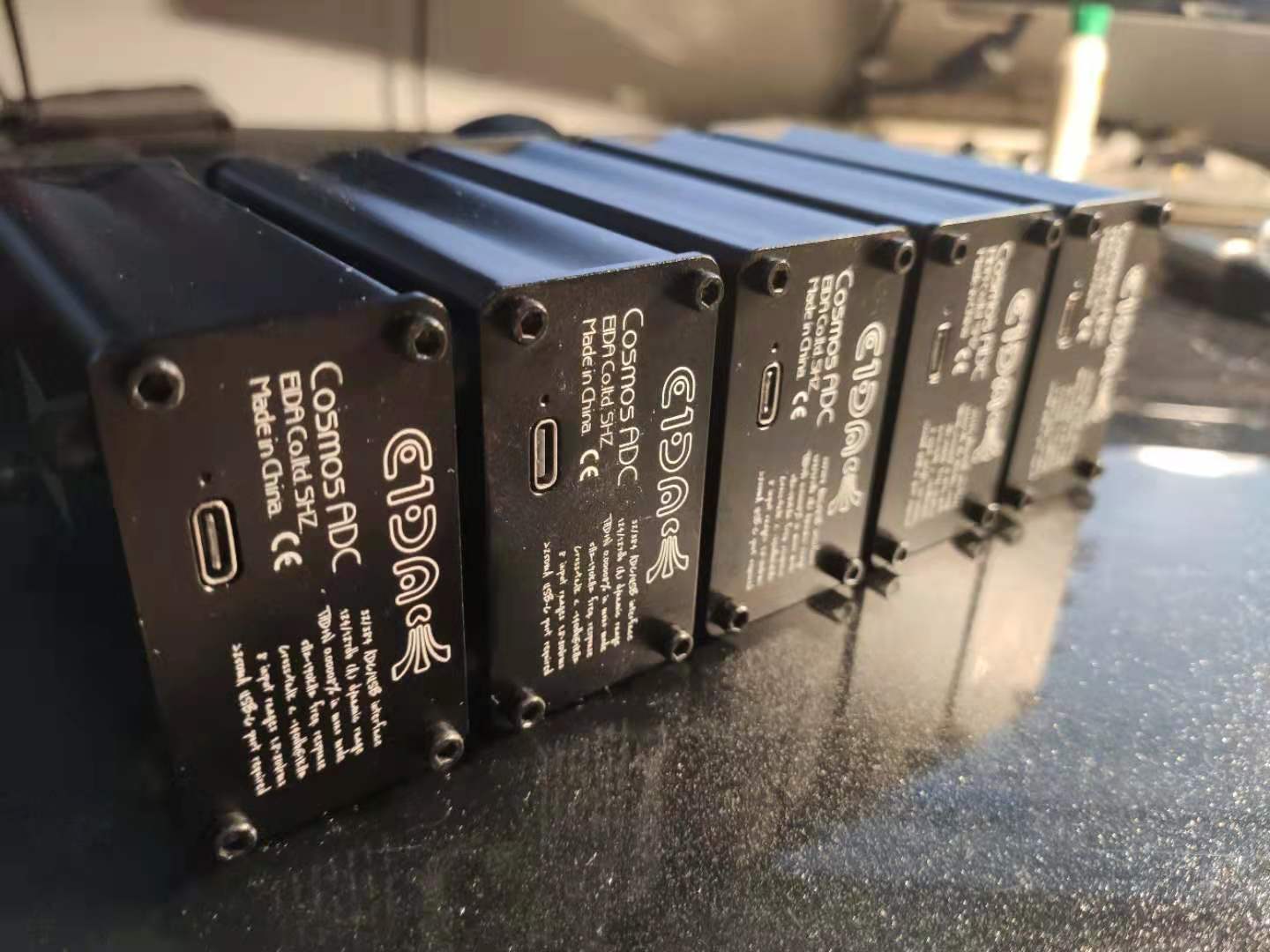

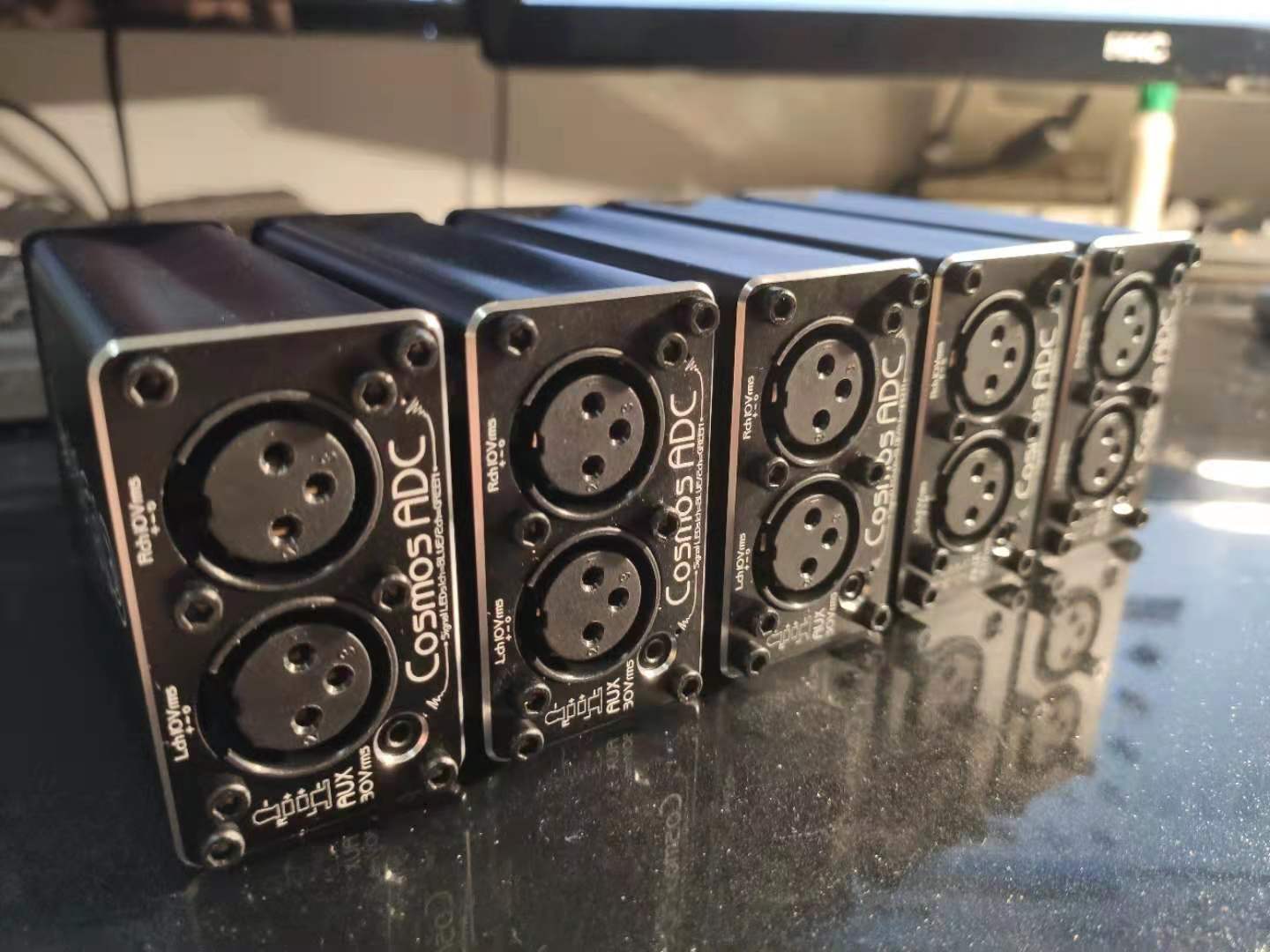

5 samples of Cosmos ADC were soldered by my hands and will be sent for tests.

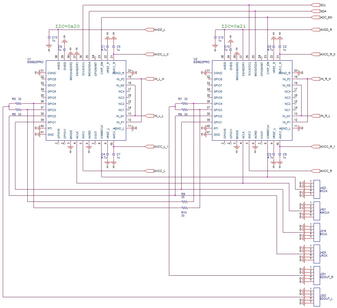

Here are the schematics for the ES9822PRO ADC. It is dual mono, however the data sheet is unclear on how to set up multiplexing left/righ data on the same output. I had to make some assumptions and added switching bridges (resistors) to allow several possible combinations. Trial and error will follow...

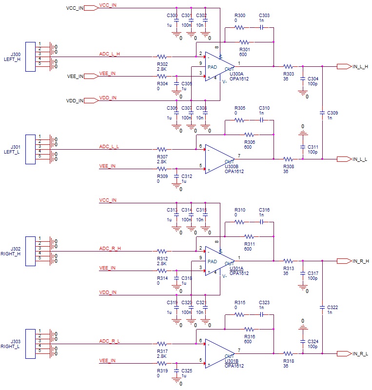

The input stage use the OPA1612 opamp, not much to comment about.

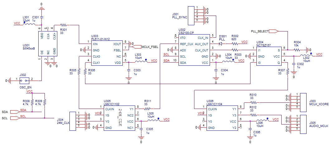

Also attached is the clock generator for the integration with the XMOS chip (software is in development). Pretty much the XMOS audio reference board implementation, with a few tweaks (added clock buffers and series resistors for clock distribution, used a decent clock chip instead of a simple crystal, modified the power distribution).

Some parts may still have incorrect values, due to the heavy copy/paste when drawing, sorry about. Comments are welcomed, I am in particular interested in ideas for loop testing, before integrating with the XMOS controller and USB bridge.

handmade samples for reviewers 😉
May I review one? 🙂
And yes - either show the schemas or go -> commercial section...
