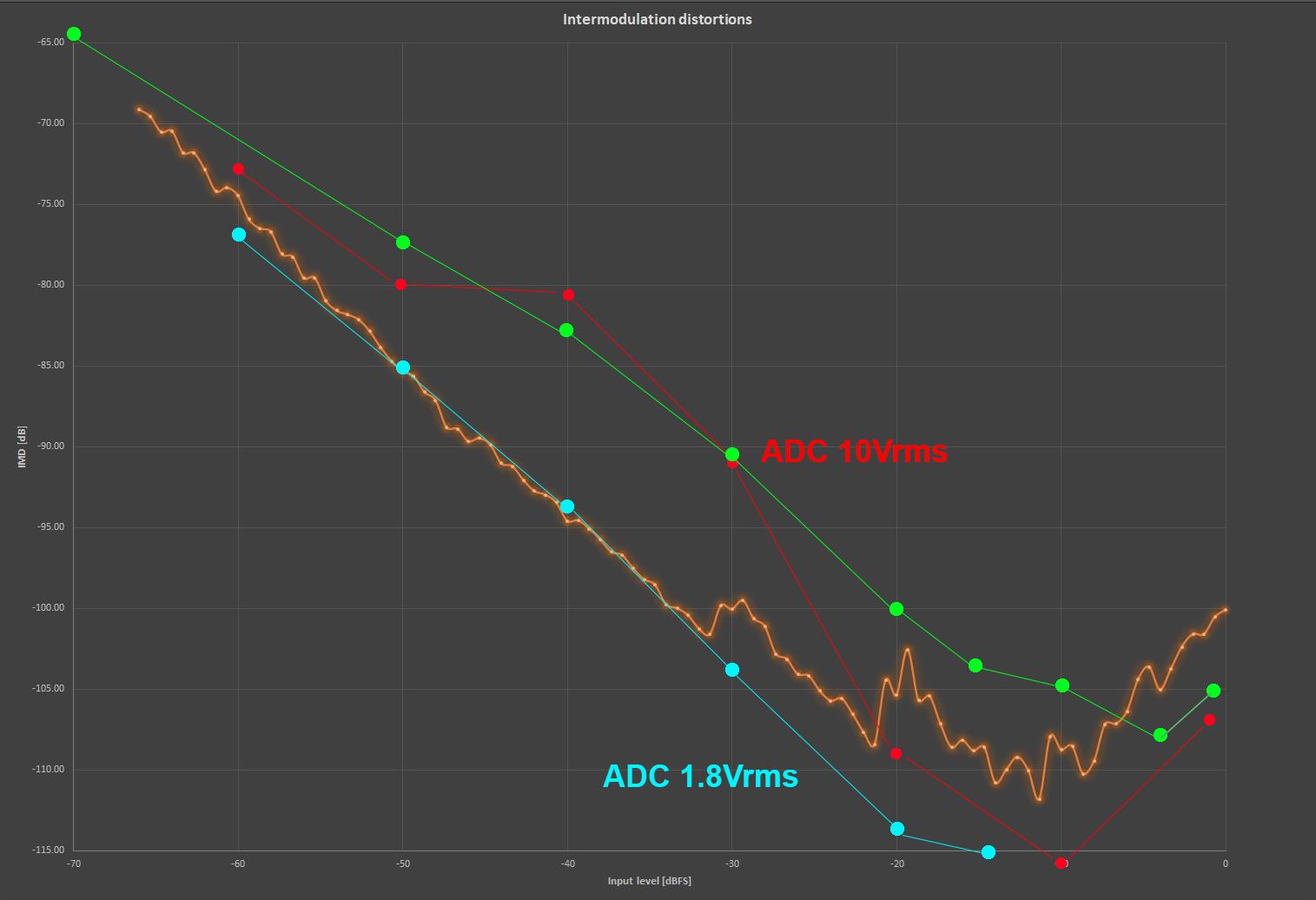

Cosmos DAC has dual-mono 9038Q2M, and I am not limited by the PCB 45x20mm and 86mA idle current there. My needs are easy to see, my goal as for everyone else on this forum - good inexpensive replacement for the archaic AP dower chest. I have no predict good money on that ADC project, not too many people want to measure their audio equipment, unlike USB dongle DACs like 9038D with DR 125db(A) and THD+N -118db for the same $100.

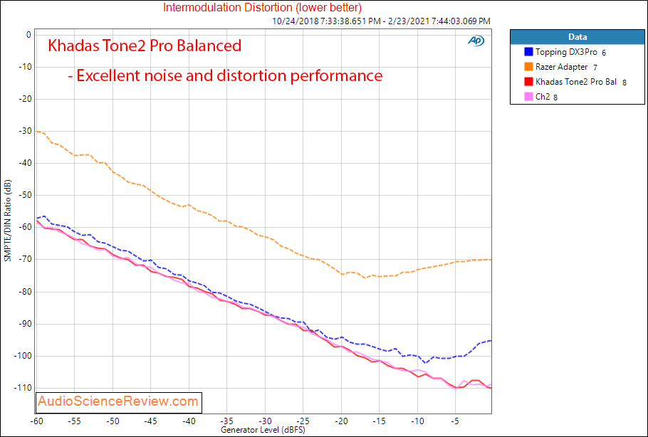

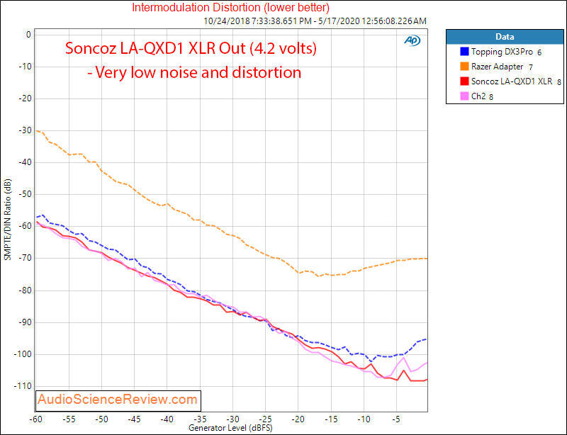

BTW, this one is another 9038Q2M(single) based DAC, IMD -110db, however, DR is about 3db worse vs 9038D, and THD+N of course a bit higher. Better implementation for sure will improve IMD more. And one more example with even worse THD+N but IMD still close to -110db.
I did remeasure IMD as mentioned with AP digital analyzer, the dest reading I've seen was -107.5db SMPTE 4:1 80/2000 at -4dbfs. Seems ARTA as many other FFT apps aren't worth trusting. I like the approach of REW developer(John as I remember) yet after I said him that REW calculating THD+N was wrong he did find the solution the same day and fixed that. Actually, I hate REW doesn't support WASAPI only ASIO or ASIO4ALL, after using that my ADC volume slider stopping to work. I have to reinstall the Comtrue driver to get the slider to work again! Seems ASIO4ALL occupating the volume control and Windows can not change the volume until the ADC is completely deleted with its driver.
I can try to realize how big is the contribution of ADC to the total IMD if I'll use 80Hz from the left channel, and 2000Hz from the right channel and mix it on the ADC input impedance. I guess the DAC has IMD better for 3-6db i.e. -110-115db, obviously with no hump.

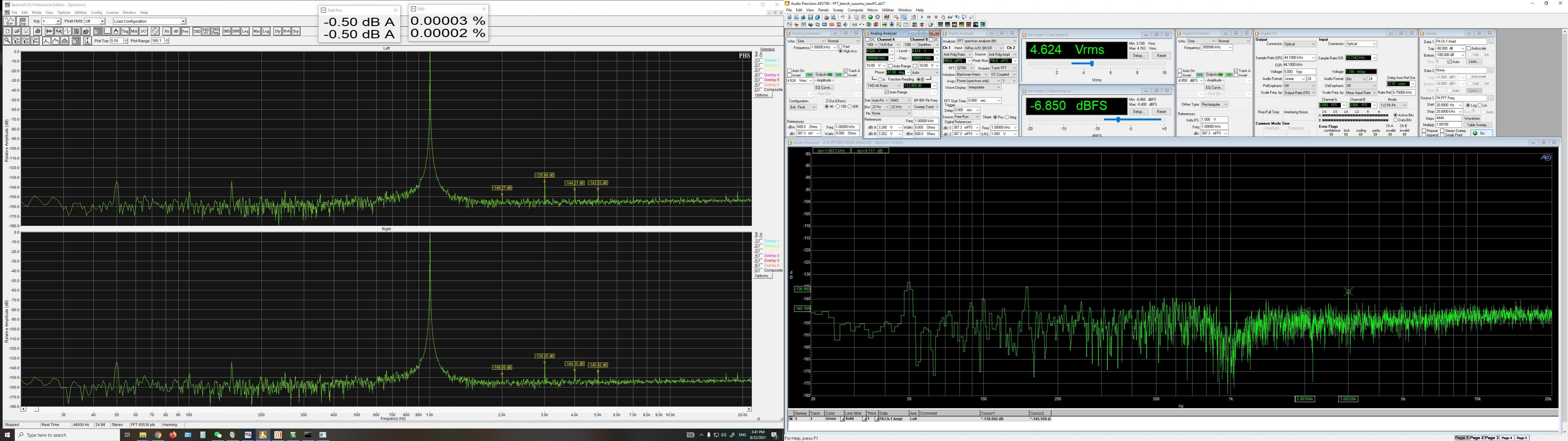

That's great!Some of Cosmos ADC samples shows THD-N 0.00002%@1kHz and THD+N 0.00007%
Very good numbers indeed!
What is the spread between the units?
I used my AP SYS2522 generator in that test which is not precise enough to find out unit2unit variations, anyhow, all 6 individually calibrated units show me at least .00003% at -.5dbfs level. ES9822 has LUT to correct its linearity, when I saying "individually calibrated" I mean LUTs coefficients adjustment(only 2nd, 3rd, and sometimes 5th harmonics I trying to compensate). Not calibrated ES9822 has up to 3 times worse THD.
