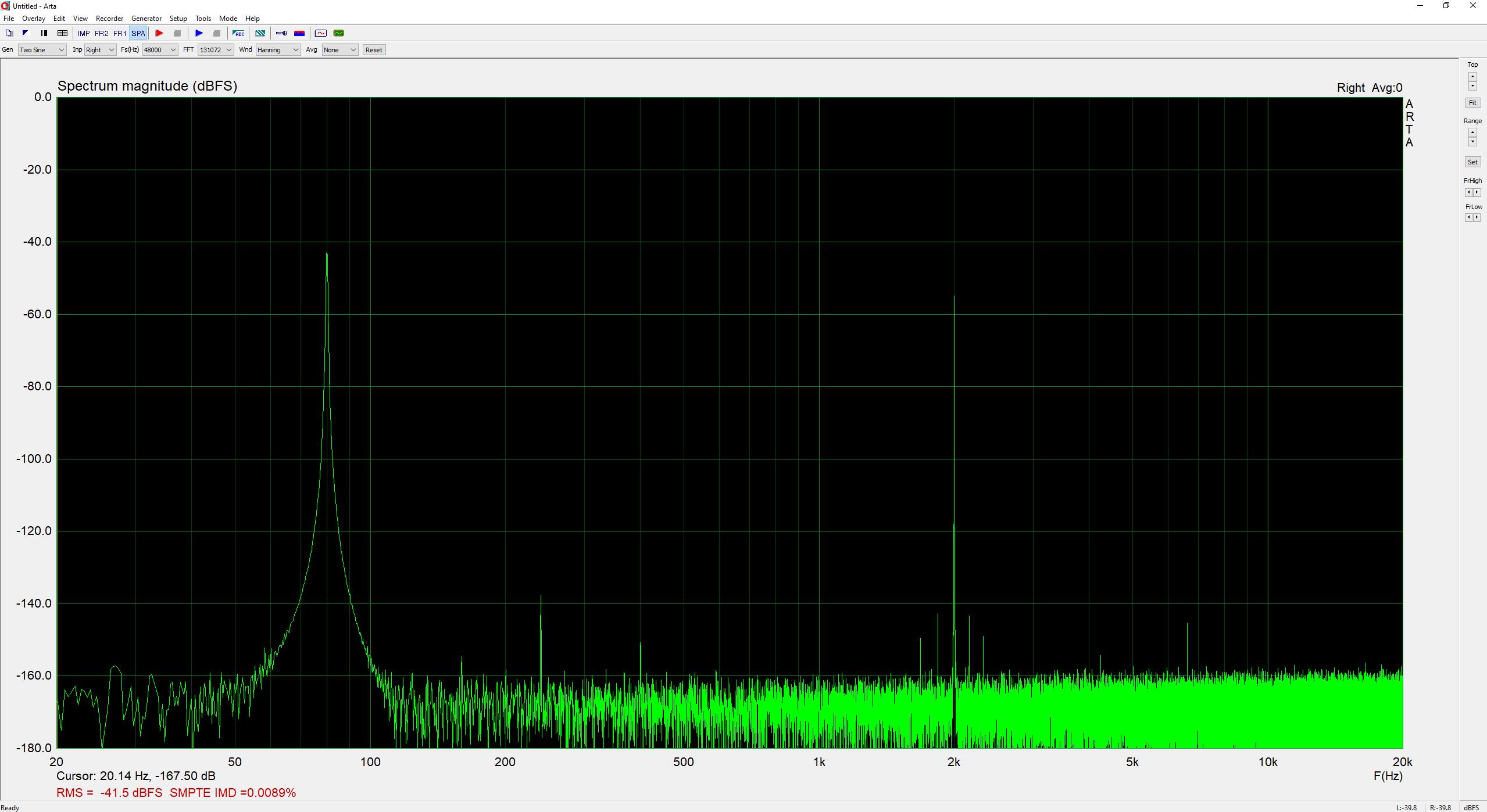

5th element, Cosmos ADC reads my Cosmos DAC proto (with actual THD+N -123-124db) as THD+N -121db in mono mode, and -118-119db in stereo. Cosmos ADC reading THD+N -123db in mono mode if Cosmos DAC has turned On its 1kHz LPF(actual THD+N -130db). The actual THD+N is obtained with Cosmos APU notch filter. All measurements were performed at 10Vrms 1kHz, the unit of Cosmos ADC has DR 125/128db(A-weighted, but the THD+N measurements are not weighted).
Are you using a large gain in the I/V stages, how did you get 10Vrms out of the DAC (that's 14Vpp differential/balanced)? Usually the output level is set to some 4Vrms.
You must get a lot of IMD ESS hump from the 9038 DAC at those insane levels, the hump is never completely removed, all we can do is to keep it buried in noise, that's why countermeasures (like lowering the I/V stage gain) come with some SNR penalty.

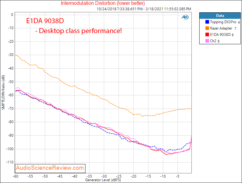

altor, no any kinda HUMP there at all but the IMD figures aren't the same spectacular as the THD+N indeed. IMD pretty much the same as my 9038D:

Hehe, my ES9038PRO in mono mode is so much better 😀. I know, yours is only a $100 9038QM thumb drive.
My AP SYS2522 has no analog IMD option so I used AP's digital analyzer with -100db residual IMD, this way Cosmos DAC IMD is near to -100db as well.

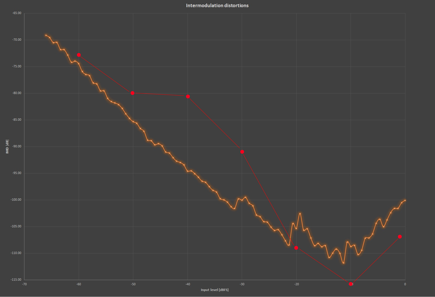

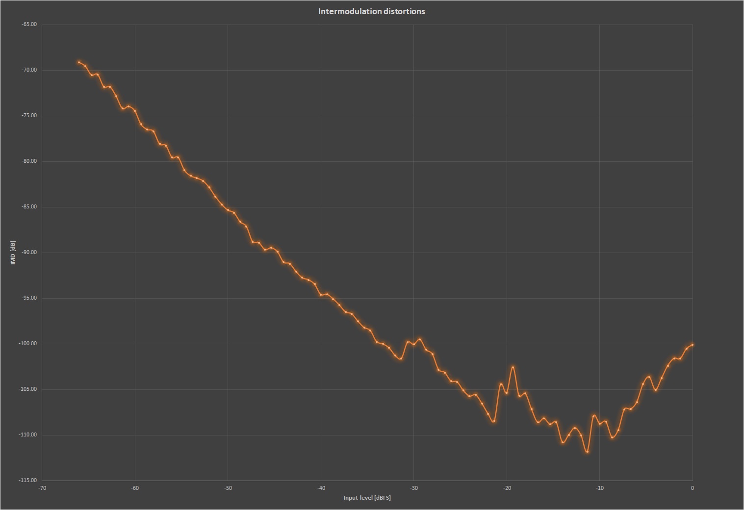

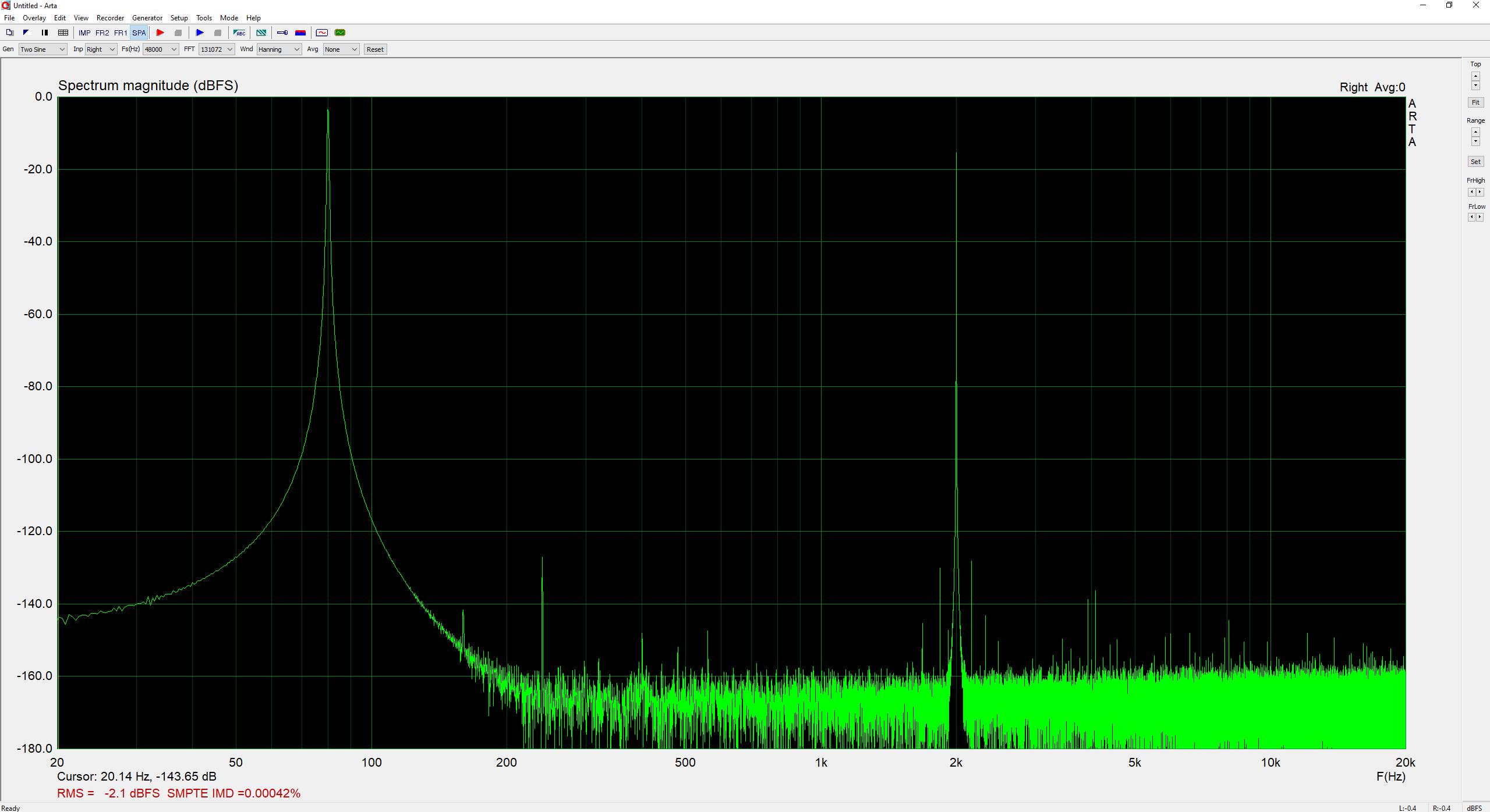

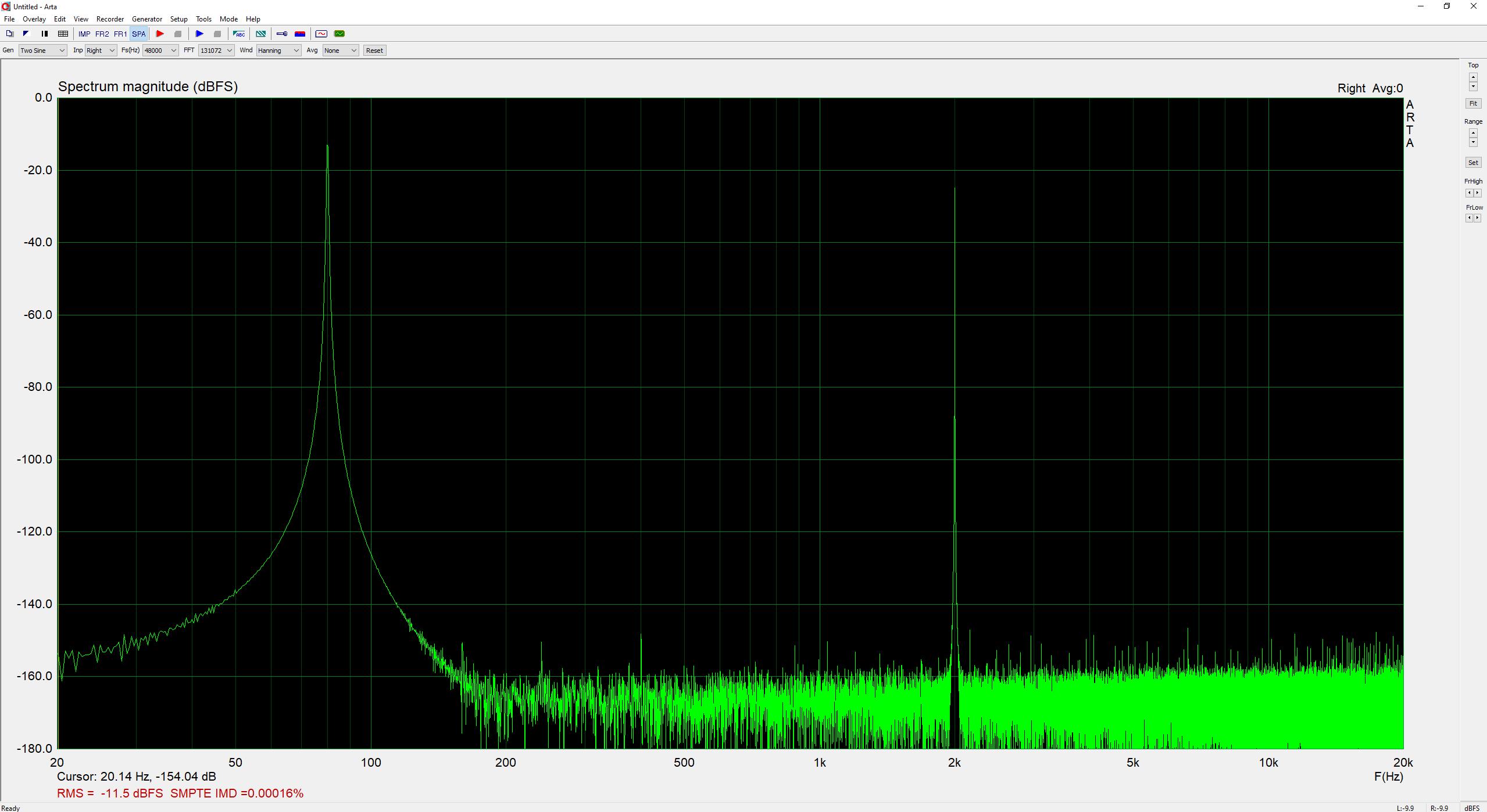

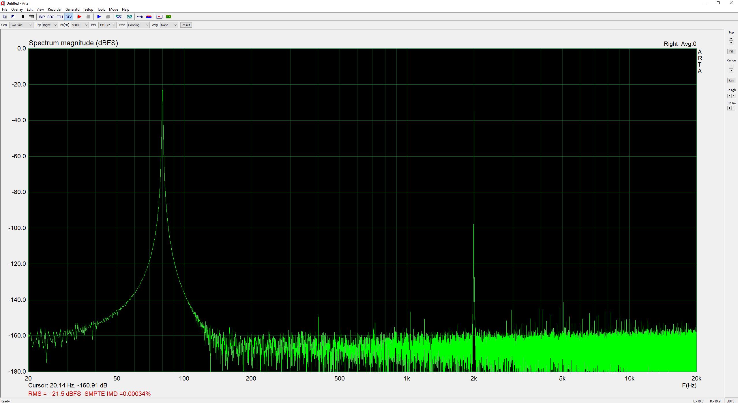

I did try to use Cosmos DAC - > Cosmos ADC - >ARTA(ARTA is one of 2 FFT apps I know calculating THD+ and noise correctly, I hope IMD as well), and I see -116db at -10dbfs, -107db at -.5dbfs SMPTE 4:1 i.e. 2 times less than your figure, however, I see the hump now. I'm not sure if the hump is the result of DA or AD conversion.
