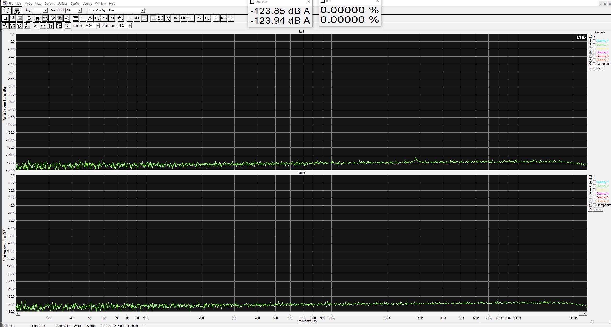

My baseline from an analog loop (digital in/digital out) with two ES9038PRO in mono mode and two ADS127L01 is:
THD @1KHz and @48KHz sampling: -122dB
THD+N @1KHz and @48KHz sampling: -113dB
As others have noted, the ADS127L01 is a little noisy for instrumentation, target is, for the ES9822PRO in mono mode, to bring the THD+N of the analog loop to under -120dB. That's where optimization starts, final target is hopefully under -126dB for both THD and THD+N.
BTW, from my experience with the TI ADS127L01 ADCs these chips also have some inconsistency in the distortion performance. By swapping a few ICs on the same PCB, I got a THD anywhere between -117dB and -123dB. 6dB dispersion is quite a lot, could be related to the effect of process variations on the sigma-delta modulator, but I am speculating...

Warmer mask the noise spurs? I'm at a loss of a noise process that gets *better* with heat. Certainly something like popcorn noise will be more apparent when the rest of the background is lower.
From what I gathered from IVX post was that the performance improved with a slight increase in operating temperature. And the noise he's speaking of is not broadband its small spikes in the FFT. Certainly the good old AK5394A had significant performance changes when hot vs cold.

noise-floor getting lower with a hotter chip(didn't try >60C I guess, 40-50C is optimal), and spurs also move over 20kHz.

I found the reason for the noise burst, it is PCB related issue. My earlier PCB has no such problem with any particular 9822 chips. I'll check where exactly I made the difference and modify a critical PCB area back.
