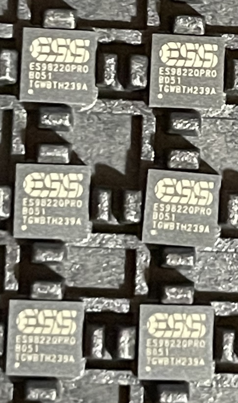

Finally; the datasheet is indeed as bad and incomplete as one could expect from ESS. I suspect there are a few levels of information disclosure and I got to the basic one.
Now let's see what these fresh out the foundry chips can do, and how they compare with the industrial grade ADCs. I'll keep this thread updated.
I got 1005pcs + 3 samples before, and already see a noticeable inconsistency of some chips. I remember, seems 5th element told me in PM that he got some FFT spikes on the noise floor of his ES9822. I had no problem with the first 3 samples but now I've got some noise-like burst up to -150db as well. I checked all stuff around but it is for sure ADC chip's artifact because it floats across the frequency vs ES9822 temperature. Interesting, that I have such spikes only with very good ES9822 i.e. 125/128db(A) SNR, 124/127db(A) or a bit worse have no such spikes at all. The noise itself is also better when the chip is warmer than 45C, I had the idea to apply the thermal pad under the PCB to keep it colder but now decide to forget about that - hotter is better.
If they are inconsistent, yet can send perfect samples, not a vendor I would trust. Plus there are the issues with data sheets I have been hearing about.
Sounds like you have to do 100% incoming QC with these people. Then there are the conditions for acceptance and return policy to worry about. I wouldn't deal with them. From what you are saying, I would expect failures in quality down the road once the chips are installed and in service for some time. So something that passed your inspection before delivery to your customer may degrade in performance and cost your reputation through no fault of your own. Is that worth it?
Sounds like the ADC version of the ESS hump.
Yes, if there are no other options on the market. With or without spurious it is still the best ADC available today, and nothing better seems to be on the white board (I hope I am wrong).
