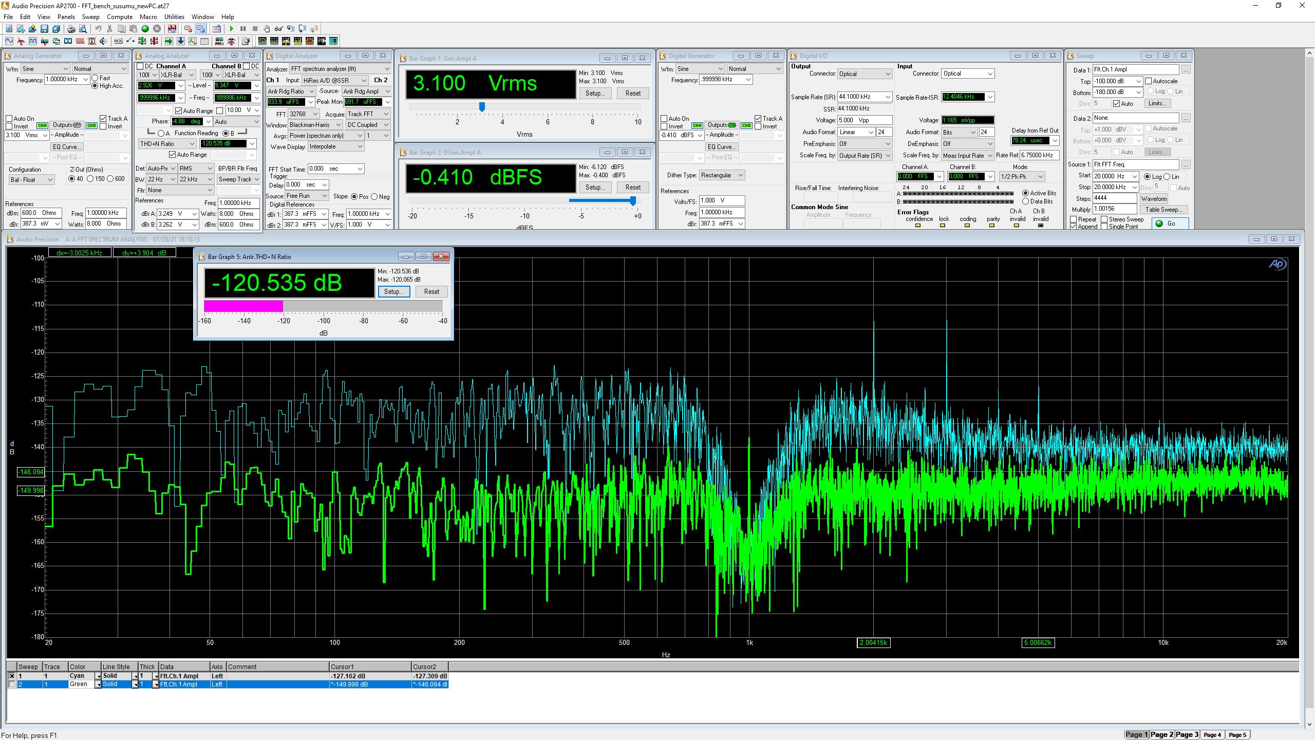

Guys, I wanna bragging again! The new iteration of Cosmos DAC with 1k_LPF option is On(i.e. DAC's output filtered) with Cosmos APU(notch filter 1/10k -30db ratio[-100db Ach means -130db THD+N], and LNA) shows residual THD+N -130db level! The previous version had -128db. 2nd and 3rd harmonics at -143db, 5th -157db, others at the noise-floor -170db. AP SYS2*** reads that like -120.5db THD+N and this is the noise level of that analyzer.
What is this "Cosmos APU" notch and LNA? I suppose it's an analog notch filter, but I don't understand how you are specifying it.
And I would think you are showing the results for a balanced output, how are you balancing two notch filters to the required accuracy to suppress imbalance even distortions?
What are the color traces in the plot?

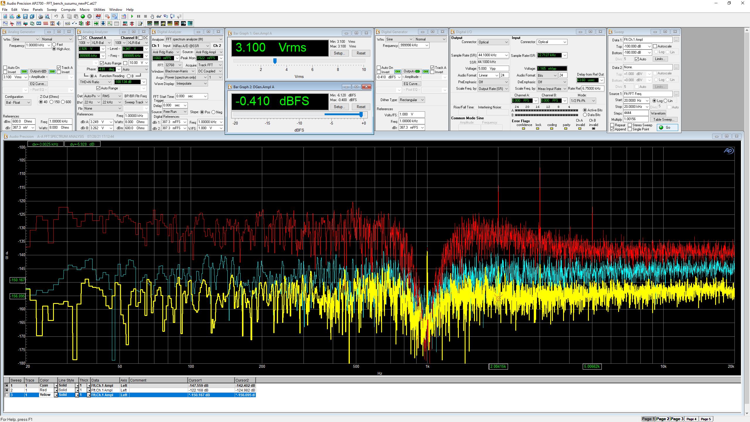

Correct, Cosmos Analog Processing Unit is a notch 1/10k -30db + LNA 40/60db gain(ssm2019). Kind of microscope for an ADC, actually, for anyone, including laptop/desktop built-in audio inputs. Of course, APU has balanced inputs but for economic reasons its outputs are unbalanced.
The first pic shows a mismatch of harmonics levels 7.7V sine after APU(Red) vs direct AP input forced 10V range(Yellow) and forced 20V range(Cyan).
---------2nd------3rd-----5th
AP10 -144.21 -143.37 -150.16
AP20 -140.27 -134.89 -148
APU -144.27 -137.7 -152.17
AP's analog analyzer reading THD+N -100db from the APU output with -30db notching, hence there is -130db.
Another one pic shows APU output harmonics at 9.5V vs AP direct input forced to 20V range. AP's analog analyzer shows THD+N -120.5db of the sine which has at least -130db as APU can see.

You had considered the reality that any analog notch filter has a finite Q, aren’t you? As such, the 2nd, 3rd, etc... harmonics are attenuated as well, and this has to be accounted for. You can’t simply subtract from the AP measurement the notch attenuation, this would be a gross optimistic evaluation of the overall distortions.

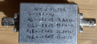

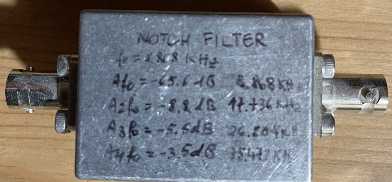

I've build my own twin T notch filters (attached), and after lots of component matching I was able to bring the notch down to -87dB while the H2 and H3 are close to the theoretical values for an ideal twin T, -9.2dB and -5.3dB, etc... But building another identical one (for a balanced notch filter) is almost impossible in practice, unless one would like to spend months in sorting components.
I was able to tune a second twin T notch filter for 8.86KHz down to -65.6dB, the H2, H3, ... attenuation are about the same as above, close to the theoretical values.

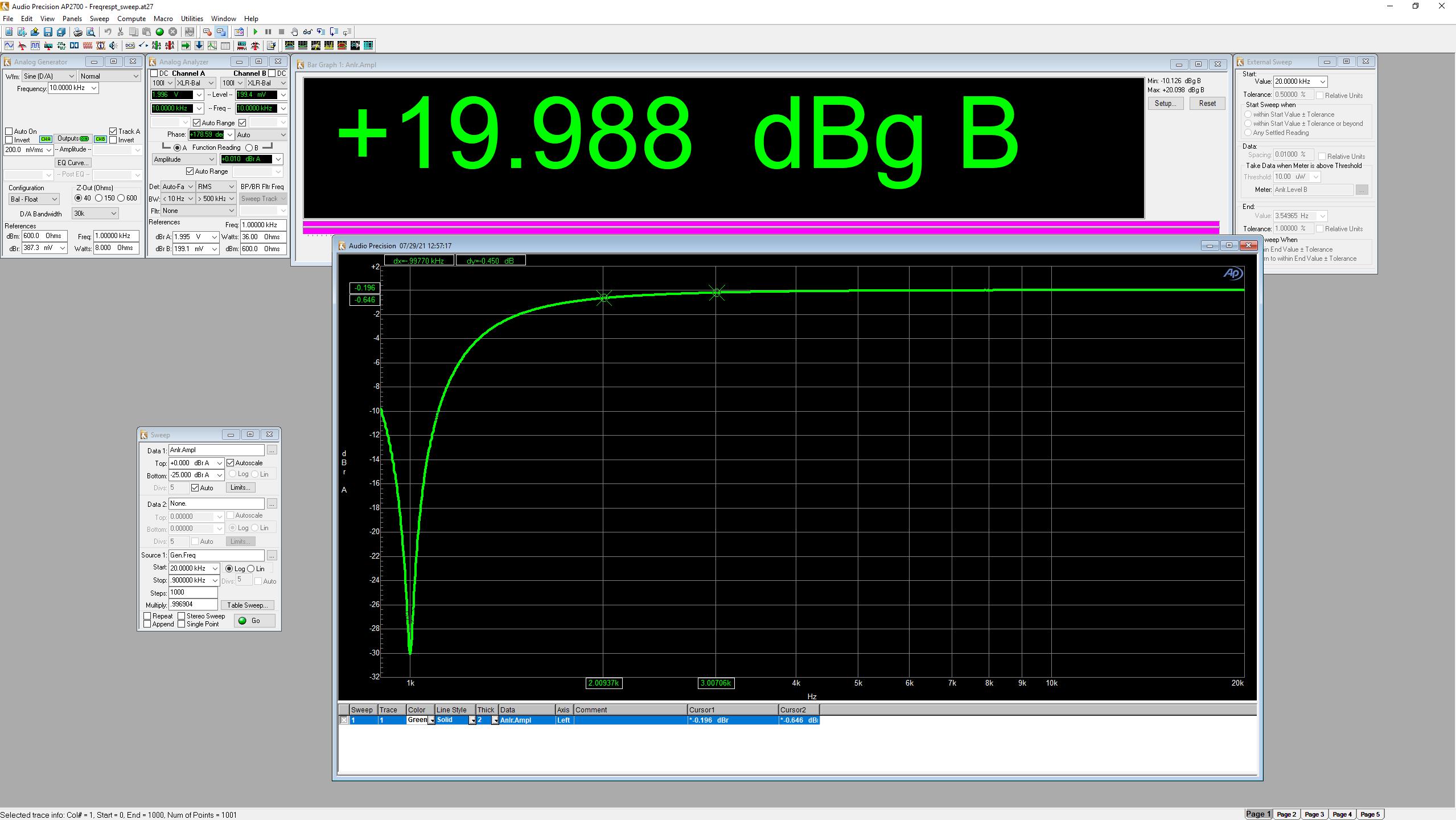

well, 2kHz attenuated for .6db, should I really care? Just a little part of a positive feedback makes such "magic" 😀You had considered the reality that any analog notch filter has a finite Q, aren’t you? As such, the 2nd, 3rd, etc... harmonics are attenuated as well, and this has to be accounted for. You can’t simply subtract from the AP measurement the notch attenuation, this would be a gross optimistic evaluation of the overall distortions.
I've build my own twin T notch filter (attached), and after lots of component matching I was able to bring the notch down to -87dB while the H2 and H3 are close to the theoretical values for an ideal twin T, -9.2dB and -5.3dB, etc... But building another identical one (for a balanced notch filter) is almost impossible in practice, unless one would like to spend months in sorting components.

Well, I see you are not willing to disclose anything serious about the “magic” of this balanced analog notch filter with not more than 0.6dB attenuation of the H2. Apparently it is not a passive filter, so then there’s the legitimate question how do you build an active filter at these distortion levels., in particular if positive feedback is used.
But no need to get into such pesky details, go ahead and enjoy your bragging rights, I understand you have no good reason to educate your possible competitors (not me, of course, I couldn’t care less). It would be nice though if you would do this on your own thread(s).
