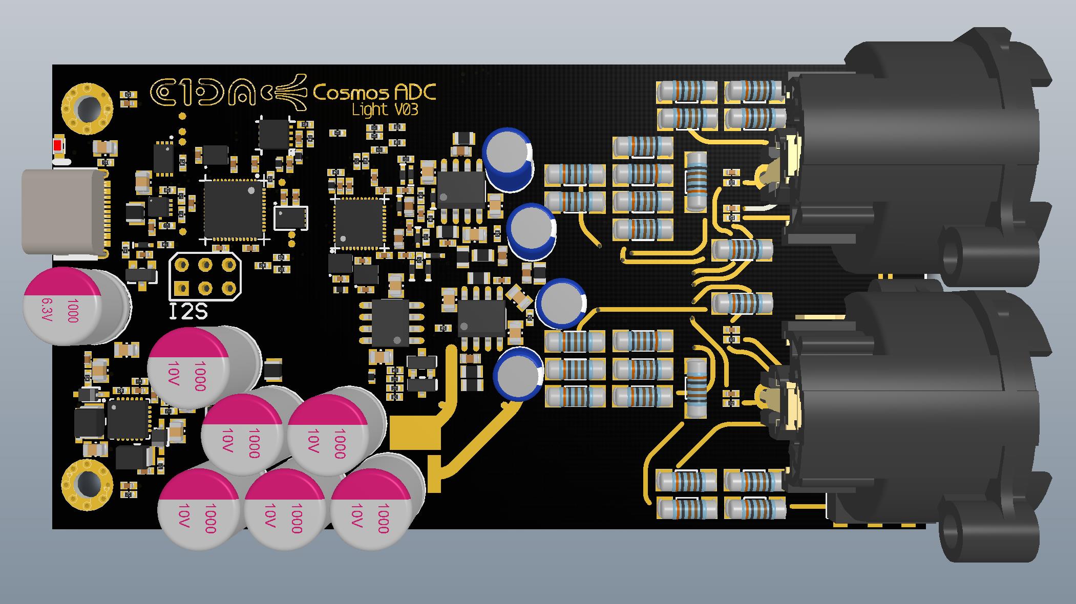

I just did add the I2S connector footprint that was asked by PM 5 min ago 😉
PS: frontend resistors are Susumu RR1220PD and CSR02027, opamps OPA1602, power Monolithic Power Systems and Ti, USB bridge CT7601CR as a slave, ES9822 as master. The USB power has a soft-start, hence, ADC can run even with a smartphone if needed.
Great. The cosmos ADC can now easily be used with DSP board like freeDSP Aurora or miniDSP miniSharc.

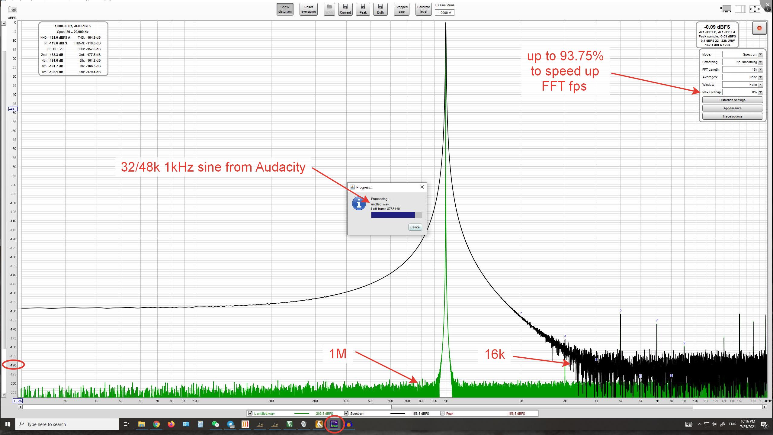

O'k, 64k FFT than.MagicianT I'm not sure if you asking me but my setup was:
AP analyzer generated digital sine 24/48k, next SPDIF to my PC, and play that sine with Cosmos DAC(that device includes switchable LPF 1k and 10k to produce ultra-clean 1k/10k sine). 10Vrms from Cosmos DAC goes to Cosmos ADC XLRs inputs, 32/48k ADC result goes to the PC back to make there FFT 64k-bins and to resend by SPDIF 24/48k ADC result to the AP.
1. Sampling with 48 kHz it takes 64 /48= 1.33 seconds to fill a data array. Using 50% overlap 0.67 seconds. All digital data shown on a video updated 10x faster. Is video played at 10x speed?
2. With 64k FFT noway to get -160dB noise flour. About -140 at the best.
So, the real world is fake anytime when we do not expect if something does possible? 😀O'k, 64k FFT than.
Check out DS: ADS127L01 SBAS607B – APRIL 2016 – REVISED SEPTEMBER 2016,
front page, and p.16-17.
Second law of thermodynamics says -160dB is impossible.
I did take a look at the ADS127L0, this is quite noisy ADC SNR 115db, if you'll check other ADCs(over 120db range) like PCM4222 or AK5578 you'll find much less than -140db noise-floor without Boltzmann constant trimming or elementary charge boosting in the flux-capacitor
