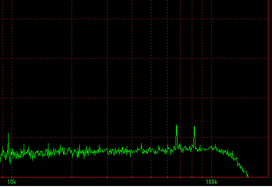

I want to see if the ES9822PRO has any audio band noise shaping. That would make it useless for instrumentation purposes, which is what I am looking for (and the reason why I used the ADS127L01). The only audio grade ADC I've seen, not having some form of noise shaping, was the AK5394, now defunct.

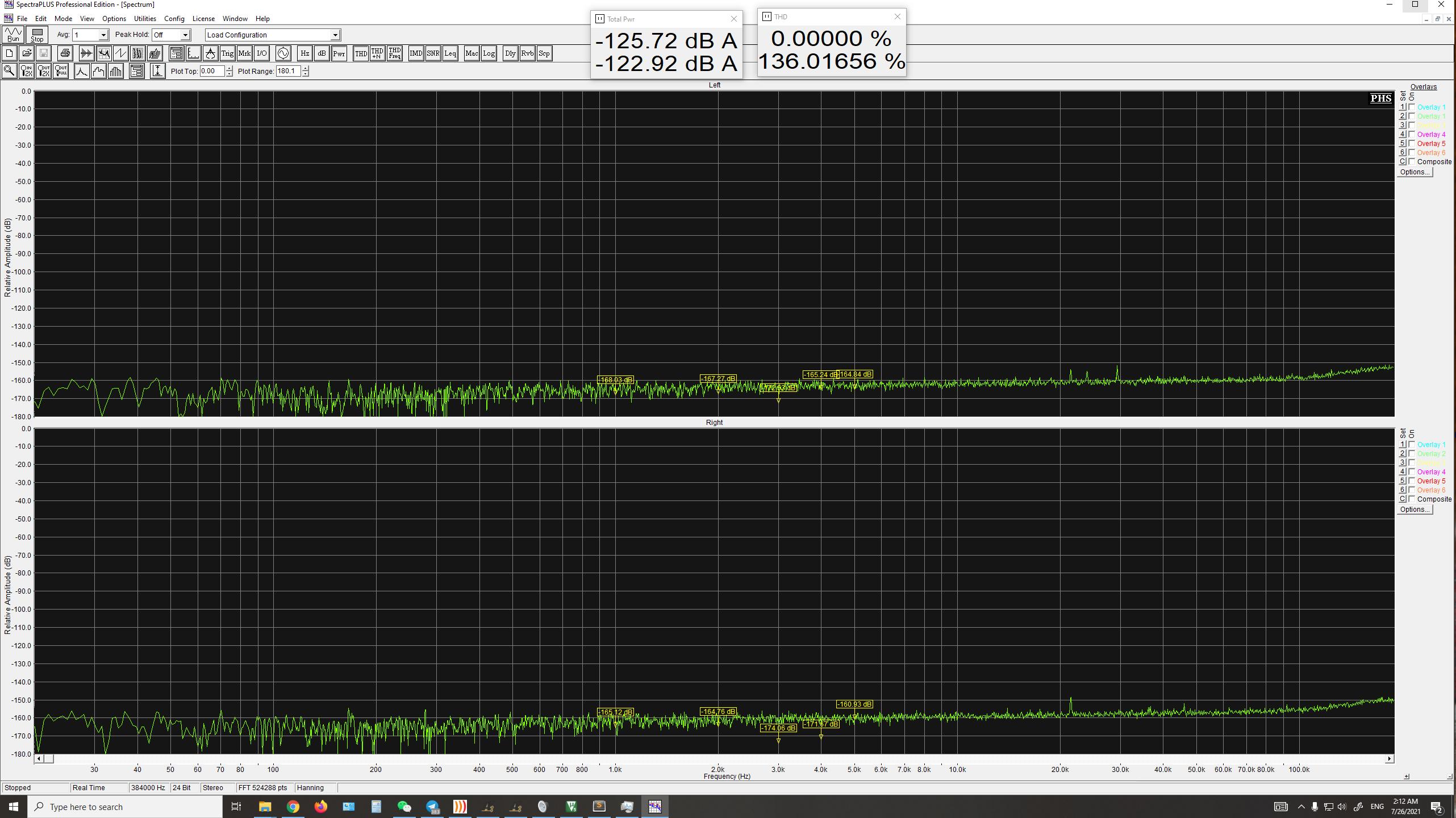

syn08, pls specify exactly what I need to test. Sorry, I've no time to deeply understand your worries because in China 12:32AM and I modifying the firmware of Cosmos ADC for HID control of THD compensation.
Ok, I'll make it simple for you, and no rush.
I would like to see a FFT plot of an 1KHz -0.5dB FS signal, at 192KHz sampling, from 10Hz to 90KHz on the X axis.
done F-sweep 32/192 Cosmos ADC - YouTube

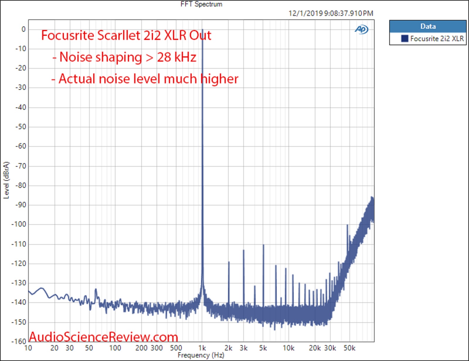

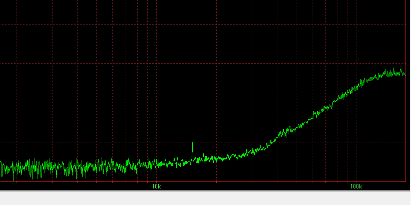

Thanks, no noise shaping, this is great. All other audio ADCs available today look more or less like in the attachment. This is for an otherwise very good audio ADC, from AKM. Perhaps the ES9822PRO has a programmable digital filter to implement (or not) noise shaping, hope to find out when I'll get the datasheet.

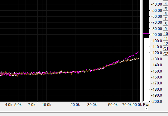

I did take a look at the ADS127L0, this is quite noisy ADC SNR 115db, if you'll check other ADCs(over 120db range) like PCM4222 or AK5578 you'll find much less than -140db noise-floor
...after noise shaping, which is, in my book, only a trick to get the audio band SNR datasheet bragging rights.
Check the PCM4222 noise floor over 50KHz @192KHz sampling rate. Then care to integrate the noise up to 90KHz and figure out which has actually the lower noise. Hint: the ADS127L01 is much better with its apparently poor 115dB SNR spec, the PCM4222 doesn't go over 110dB before noise shaping..

Here you go Cosmos ADC THD vs level sweep - YouTube
As you can see, ES9822 doesn't really need to keep input level <-6-10db because the ADC is quite linear up to 0dbfs(that's why you can measure THD+N as well!), so I recommend using it with that level, and I do a calibration(compensate 2nd, 3rd, and 5th harmonics) for the level -.5dbfs.

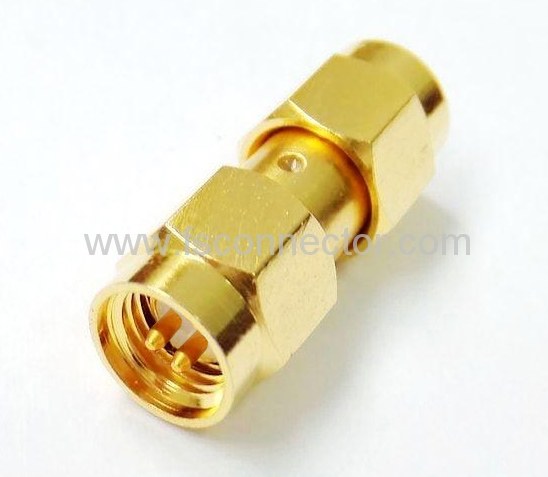

Someone on the ASR forum believes that the SMA connector is more suitable for a balanced low-distortion inputs of ADC, notch etc. I want to ask you guys, is anybody saw such custom SMA? I even prepared a picture of that, don't worry it is photoshop 😉
