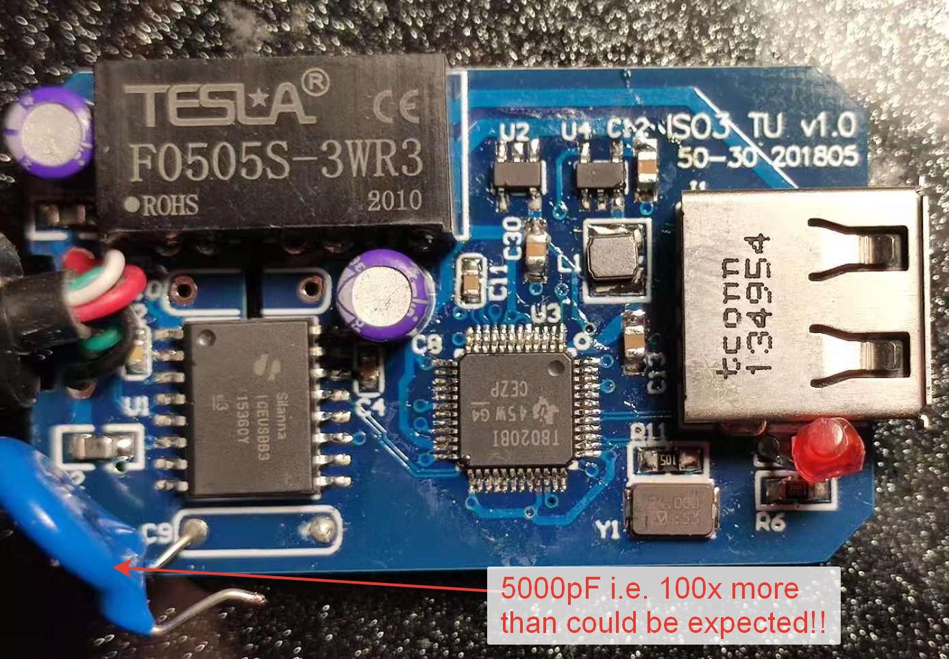

I using Hifi.me USB2 isolator $100 with AP USB interface because AP has no isolation or have but a bad one. At least Hif.me isolator with replaced 5000pF Y cap for the 50pF can work a few minutes and noticeably improves measurements related to my PC GND. There is some rare ISO SO16 chip Silana ICEUSB3 works with Ti USB HUB chip used like a buffer as I see. I asked Silana about that IC but they said it was discontinued forever and they never back with a replacement.. I hope they sold the design to somebody bigger where we'll be able to buy a similar ISO chip, probably reliable functional with 50pF.
Is this full speed or high speed? Looking at the board, I would say it's full speed only (meaning up to 96k audio), high speed isolators are using extra logic (like FPGAs) to help negotiating the speed and direction between the two halves and, as a result, are much more expensive.
For full speed there are plenty of solutions, probably the most common one is the ADUM4160 ADUM4160 - Advice re schematic - Q&A - Interface and Isolation - EngineerZone
If you want it done right you'll probably have to do it yourself after the USB. More work, but it can be done better. In torture testing we did on a medical device we found we could not use ADuM4160 in the design. It met all specs in terms of isolation but it made USB more prone to reset in case of ESD and EMI susceptibility testing at levels beyond the standards usually go. That's if you could accept the Full Speed limitation anyway.
Thanks, I guess it would be much more effective to isolate only the ADC and DAC using standard high speed isolators (like I suppose Jen did), and leave all the XMOS s*it on the USB side. Clock switching and jitter cleaning would also be on the ADC/DAC side The XMOS evaluation board does not consider any of these isolation issues, so it will be quite some re-design.
Virtins has a high speed USB isolator (available at DigiKey) but it is, of course, expensive https://www.virtins.com/VT-USB-ISO-480.pdf
