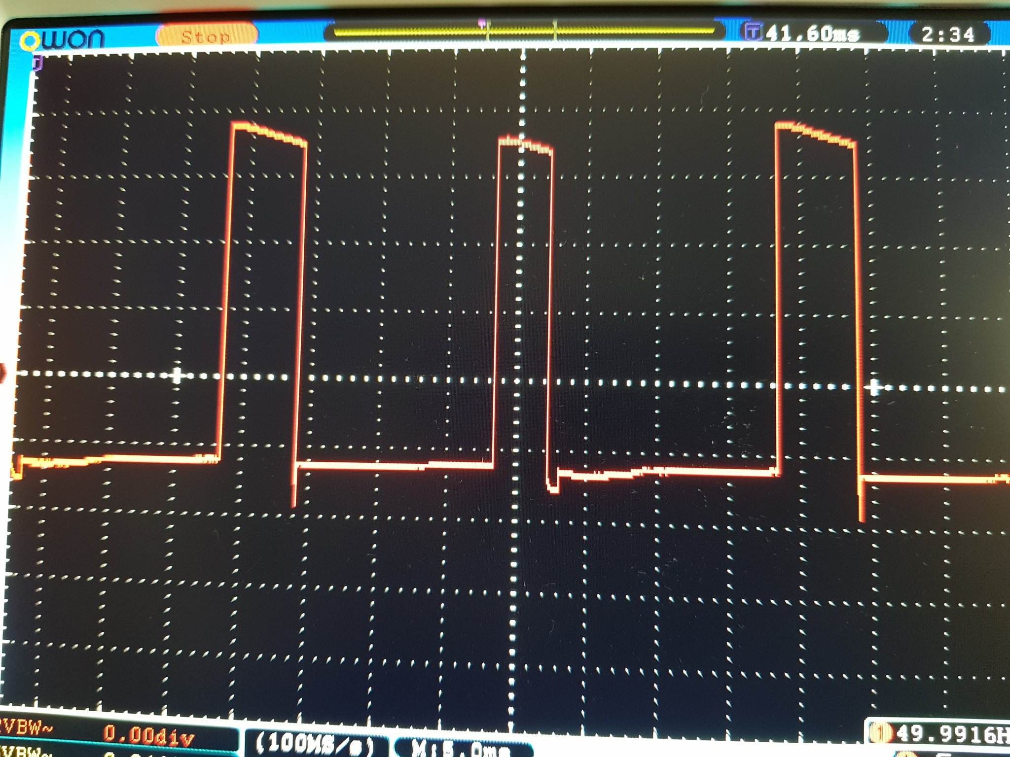

At the gate of a 1170 controlled half wave rectifier. Some clear staircase waveform makes every pulse.

Your 1170 controlled half wave rectifier is high voltage for tube gear?
Possibly PWM because of the high voltage?

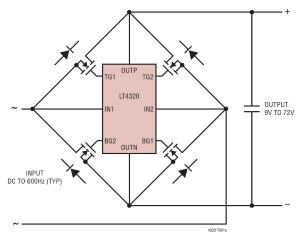

The one I use is LT4320 with 3.6mΩ RDS(on) MosFets
According to tvicol, who has investigated this a lot, there is no need for snubbers in this circuit.
AFAIK, the snubbing is there to prevent ringing between the trafos secondary winding and the rectifier.
So perhaps this is not an issue with this kind of active rectifier ?
If you want to get rid of diode switching noise, than Saligny can help you.

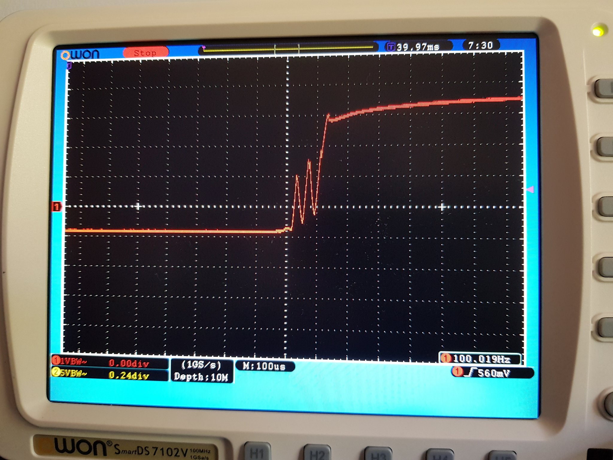

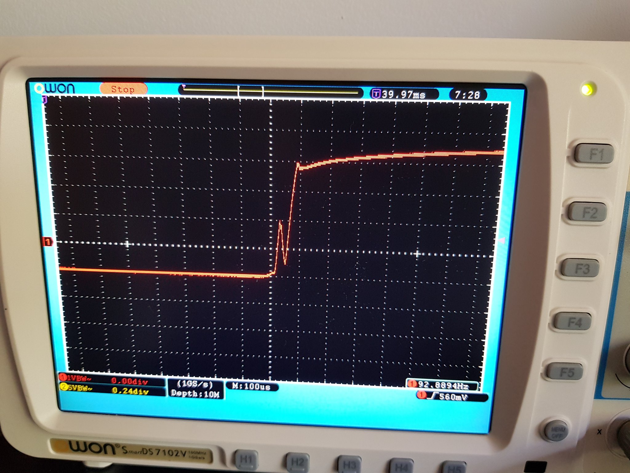

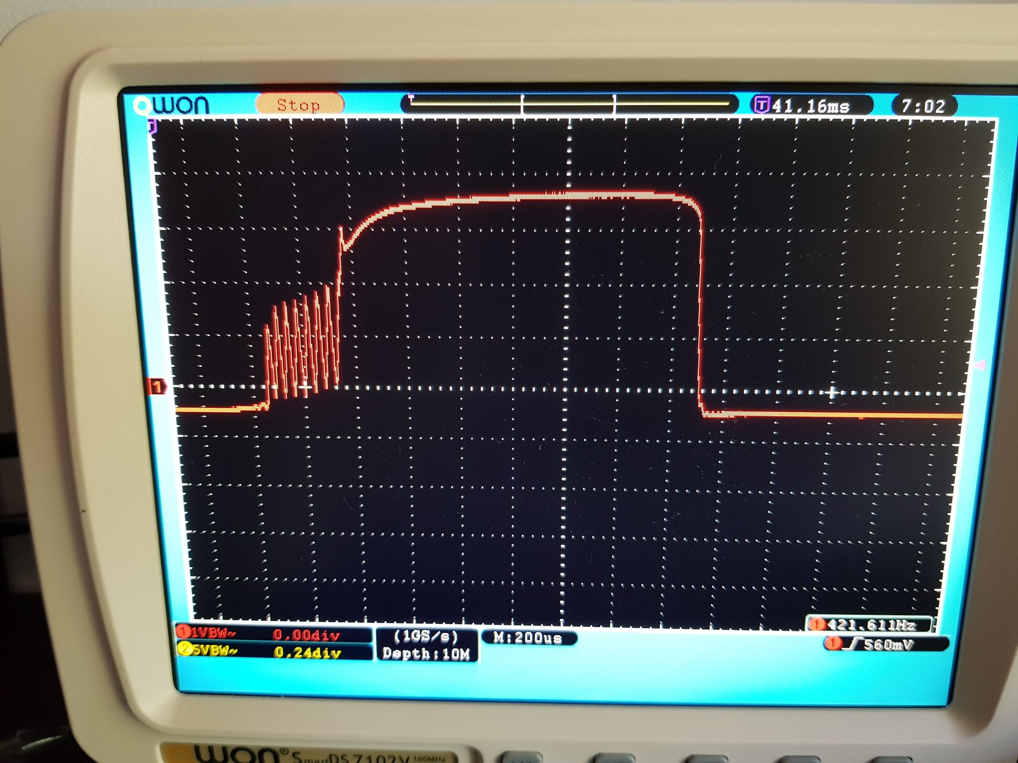

The 4320 is a different animal with its own little idiosyncrasies. As it provides no option to control the minimum on time it suffers false triggering. Especially bad at low load currents, below a 100mA. This is what the drive voltage at the gate of the topside transistor looks like. No idea how these pulses compare to the reverse recovery spike of normal diodes, but being close to 2.5v they are sufficient to turn the transistor on and off. Perhaps this will differ with various mosfet types. Tibi, who has done a lot of research could probably throw some light.
30mA, 100mA, 250mA

The 4320 is a different animal with its own little idiosyncrasies. 9As it provides no option to control the minimum on time it suffers false triggering. Especially bad at low load currents, below a 100mA. This is what the drive voltage at the gate of the topside transistor looks like. No idea how these pulses compare to the reverse recovery spike of normal diodes, but being close to 2.5v they are sufficient to turn the transistor on and off. Perhaps this will differ with various mosfet types. Tibi, who has done a lot of research could probably throw some light.
30mA, 100mA, 250mA

Is it possible that a rectifier based on the LT4320 stops very clean without entering the reverse area and therefore does not need snubbing?
30mA, 100mA, 250mA
I think most people here use LT4320 based rectifiers at over 1A. Perhaps yours would start cleanly at 1A?
What is the total gate charge, Qg of your MosFets?
This seems to be an important part of the MosFet spec to get them working properly.
Tibi suggests it should be lower than 50nC.
You seem to have looked into this a fair bit, so I'm just curious.
