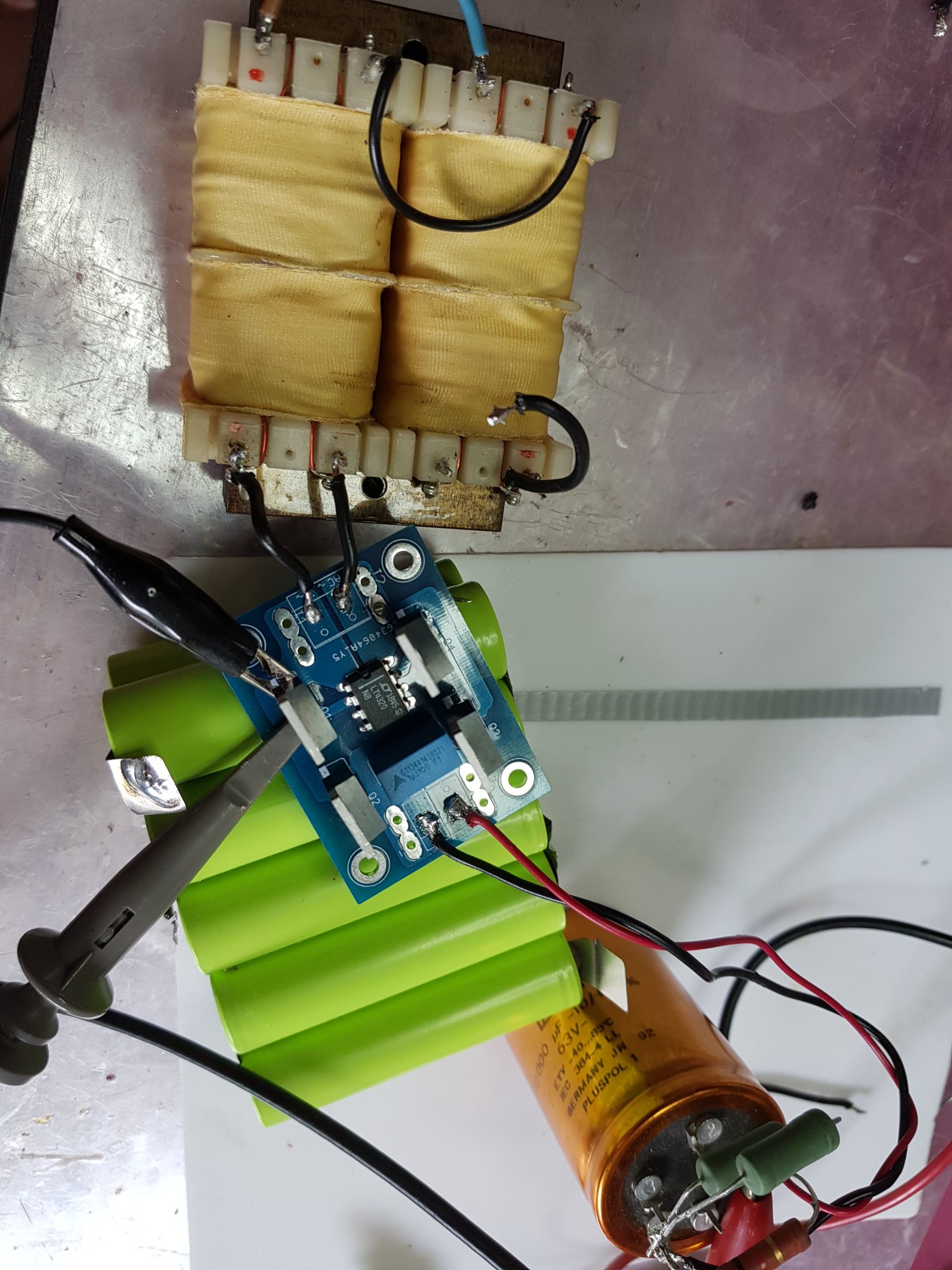

In your test setup, it looks like you're using a dual secondary in series.
For the sake of testing, what if you try using one secondary (or as is) and tightly twist the wires to your 4320 board with no snubber. Also tightly twist the wires to the 10uF.
Would it still ring?
There is no 10uF cap. The external cap is 10mF.
Tried half secondary. Lots more ringing, perhaps due to the half dcr. Cut down the input wires to almost nothing. No change.
Could it be due to higher regulation of using one half.
I have a theory;
I don't know what trafo you have there, but it looks like a split bobin, but with primary and secondary on each side?
Could it be that your trafo has a very high regulation compared to, for example, a toroid?
So, when the 4320 turns on, the secondary drops enough to turn it off, then turn it on again, drop, turn off, turn on, drop (ringing).... until it stabilizes?
I don't think so. Without a snubber there is problem only at low currents, exactly where the transformer regulation is not important. There are no issues with the 4320 as long as you add a snubber and in many cases even without a snubber.

The MOT adjustment is geared towards the frequency range this device is normally used at, max MOT is 3.6uS so it makes little if any difference at 50Hz. And the gate drive looks perfect. My layout is generally close to the app note but the mosfet is through hole. Not sure if this is critical, as i have no plans for 500kHz operation.
Looks like this has turned into a Quasimodo clone 🙂 High voltage, high dcr transformers are naturally immune but what i don't understand is the current dependence. Nothing much changes at the gate drive, yet the ringing disappears.
Gate drive looks perfect, that's good to know.
