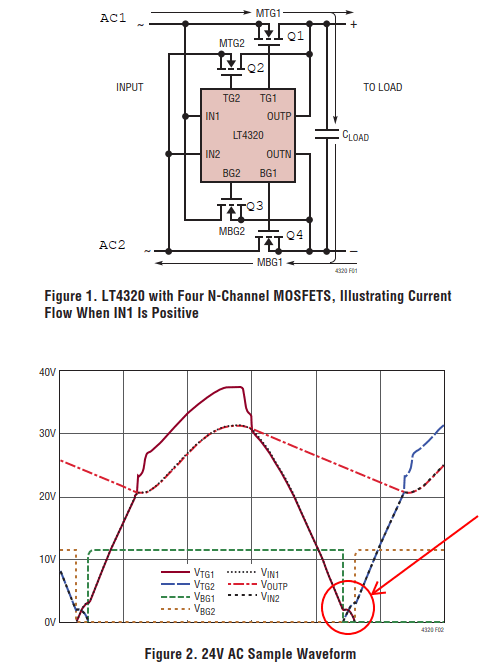

I have not had a lot of audio time for some time, but I have looked into the behavior of LT4320-1 which is the one I am using on Prasi THT boards.
LT4320 seems to have a well controlled turn on and turn off by having one mosfet turn on/off controlled by a square wave, while the other follows the sine wave of the AC from the trafo secondary.
There is a gap between the crossover of the positive and negative sine wave, so that any turn on/off artifacts of these are eliminated.
Q1 and Q4 is open when AC current flow is positive.
When Q4 is turned off by the square wave, the trafo secondary is disconnected from the circuit
and ist is irrelevant if Q1 has some turn on/off artifacts.

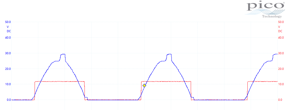

Here is a scope shot of the bases of Q1 and Q4 at 1A load
It basically does what it says on the box.

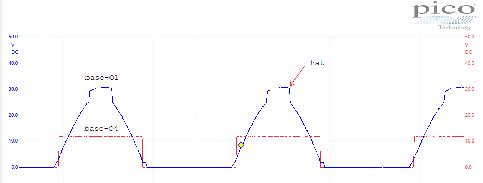

and here is a scope shot of the same at 30mA.
The only thing that changes is the width of the "hat" at the top of the sine wave; higher current, wider hat.
