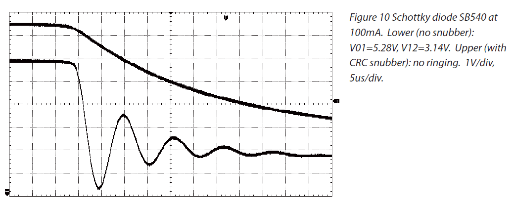

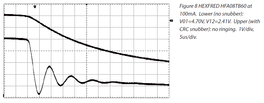

In case anyone might be interested, here are a couple of figures from an (article) I wrote, published in 2015.
They show two different rectifier diodes in action: a HEXFRED, and a Schottky. Both of these diodes provoked transformer ringing, and in both cases, ringing could be critically damped & completely eliminated by adding a transformer snubber.

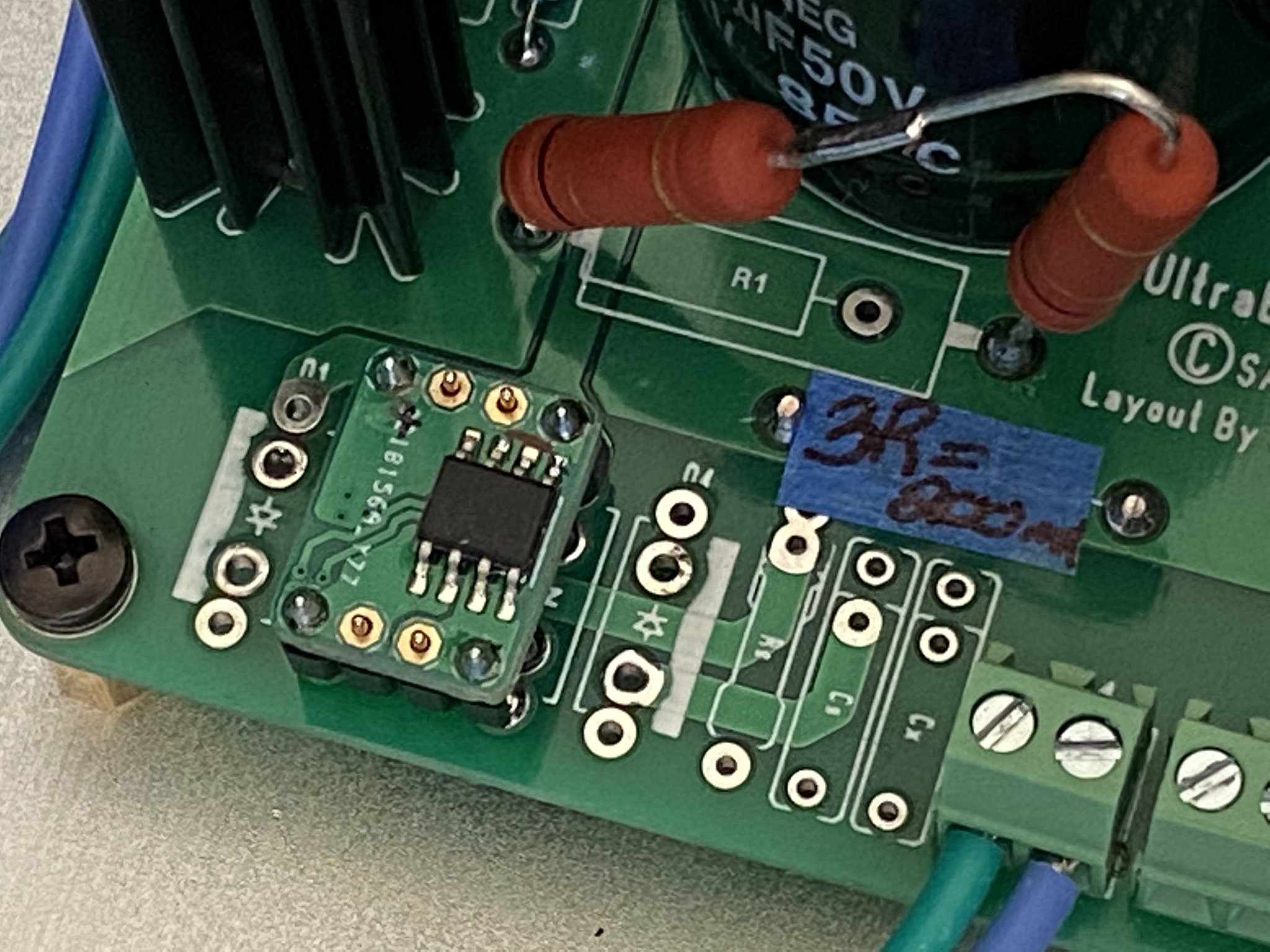

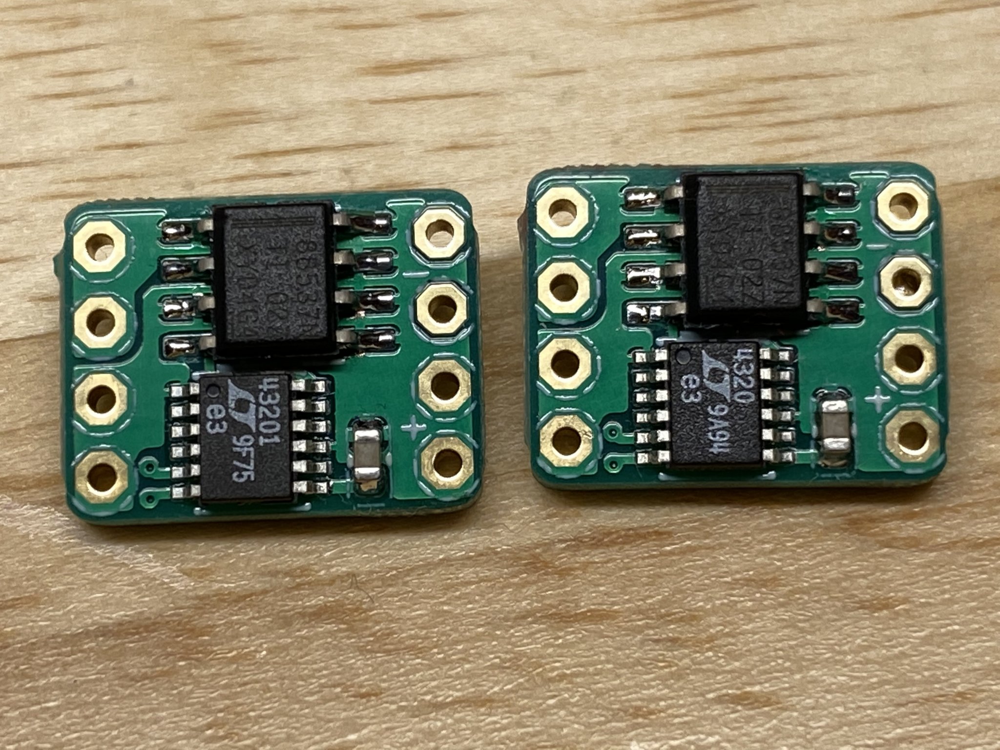

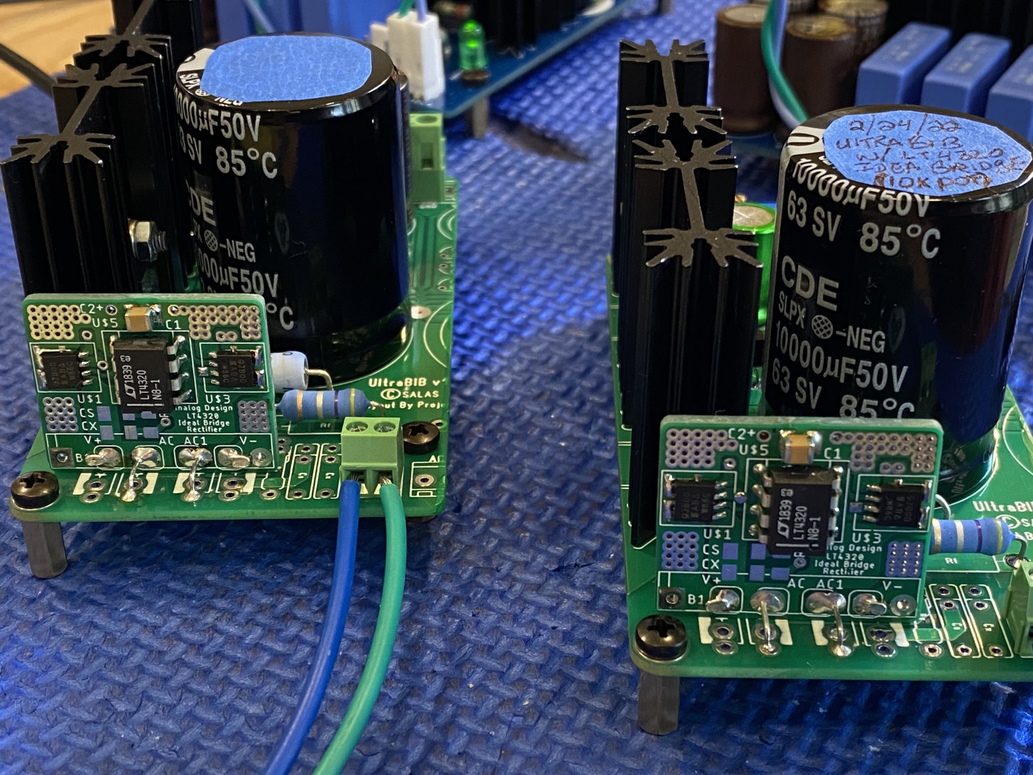

Two examples of “added complexity” as rectification for Ultrabib type psu’s:rofl:
