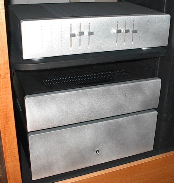

Here's a less than perfect picture of the three units together. On the bottom: the power supply, the middle: he subwoofer amp and on top: the empty multichannel active amp.

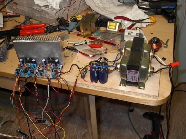

Worked yesterday on a new lowpass board (the one built earlier is too jumbled up with used components and changes). Everything went smoothly, got all the components in the right place, op-amps in the sockets the correct direction. Hooked it up to my temporary (becoming permanent) sower supply. 15v +/- cut down from the 35V with resistors and zeners.
With power on, there's a crackling, popping sound - like static on an old AM radio. I jiggle a few wires - no difference.
This sound continues and stops and starts again, completely random. I turn on the CD player to see if it's working at all and I get sound, but the noise continues. I try a bunch of different things with no result. I think maybe the 15V supply is no good, use a different one, no improvement. I gave up.
An hour later I go back. Turn it on, crackles are there and then stop. Dead silence. I touch the signal side of the input - it hums. Turn on the music - it plays clean.
I leave it going while I start to put together a midpass board. The static doesn't return.
Today, I try it again and the static is back, but doesn't last long. I'd really like to know what the problem is.
I've tried almost everything. There is no sign of oscillation, DC offset at maximum output (pot all the way up) is 20mV. Put extra bypass caps, changed op-amps, etc.
Any ideas?
I would write it off, but the midand board is doing the same thing.

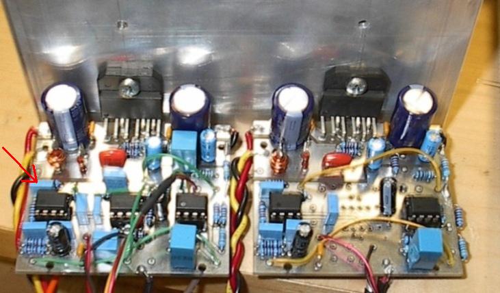

After my last post, I went back for another try. I re-check everything and re-heat each joint with my iron. I must have performed some magic because there's no static now.
Leave the lowpass connected and connect the midpass. Power on, bass but no midrange. Turn the pot all the way up - I can just hear it. Poke and prod and the crackling starts. There's one 3.3nF cap that seems to be the problem. I re-solder it and presto! I have midrange. I leave both running for 30 minutes or so with music. No static, no problems.
Hopefully tomorrow when I try them they will still be "fixed".
I'll begin a highpass now, maybe with more luck (more careful soldering).
In the picture the red arrow at the left points to the offending cap on the midband board.

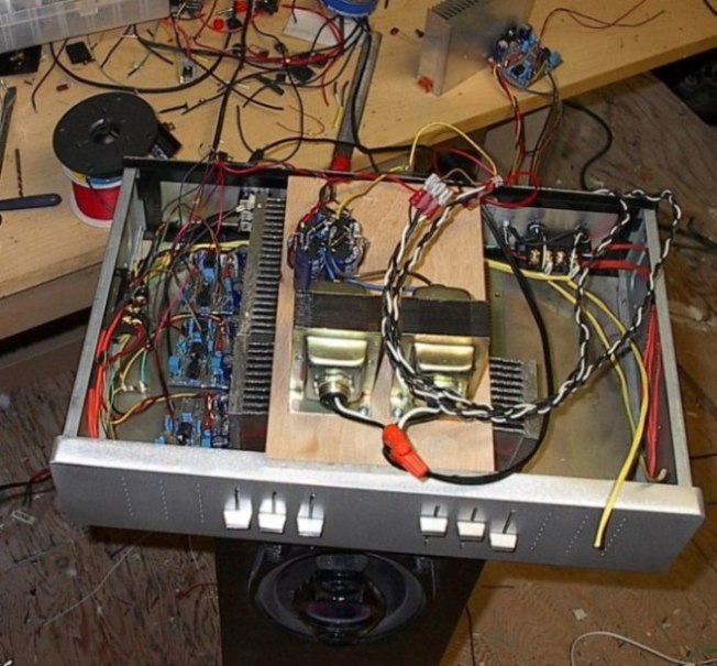

I have started to install the boards in the chassis. Wiring to the front panel mounted pot and the three power supplies makes it a bit tedious.
Here's a pic of the lowpass and midpass being tested. No noise or hum, even with the rats nest of wires in my neat and tidy work space:
I still don't have any idea what is causing this to happen and I really didn't do anything it. Any help here would be appreciated.
I have completed a full channel, low, mid and high. Each does it's job of separating the frequency bands very well. These are ULTRA quiet, no hum, no hiss. This is the most silent implementation i have ever done - it's even quieter than my Yamaha HTR.

MJL21193 said:This crackling, static problem seems to cure itself.
John, did you happen to note what time of day the problem was occuring at? How about where the problem occured - did it occur only in one room and when you moved it to the basement/garage it went away? While I can't say for certain, I think some other appliance or a certain section of your house wiring is to blame.
I'm thinking a bad batch of one of the components. Have you got some freezer spray to try cooling components down once they have warmed up to see if that causes the noise to reappear?

Your cracking might be from tiny cracks in the thru-hole plating.
Check all components to make sure the solder has wicked all of the way through the hole and has a nice fillet on both sides of the board. you might need to slightly lift some of those blue caps so you can see underneath.
If you are using any thru-plated holes to get from one side of the board to the other without a component in the hole then put a lead offcut through the hole and solder it in.

you need a very tiny gap for arcing at 30 volts.
Are your boards etched or machined?
There may be metal slivers about, it might even be from the tinning process.
get one of the untouched boards and check very closely with a magnifier.
Buff all of the etched/machined areas with a pencil eraser.
Are you iusing a new brand of solder?
When doung bulk assembly sometimes I push the solder into the joint too fast, I end up with an extruded curl of unmelted solder sticking out the back of the board with larger holes.
