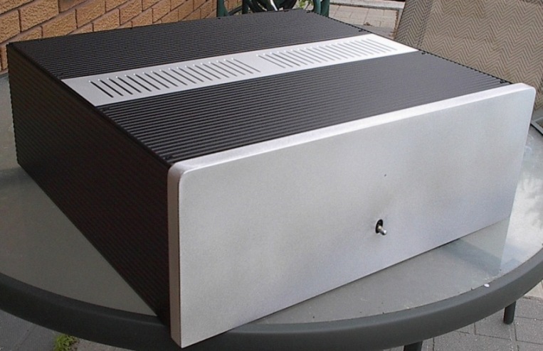

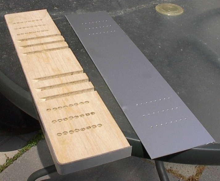

gbyleveldt said:Aha! I was wondering how much fun you would have putting all those leds and sliders on an alu frontplate, but I see you used wood. Neat idea!😀
Thanks. Actually would have preferred a solid aluminum face, but in the interest of saving money (and trying to find 3/4" ALU plate), I faked it.
Works just as good.

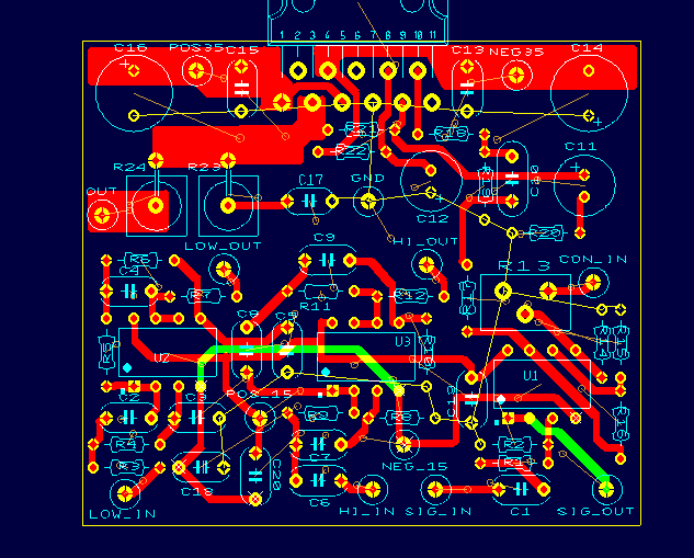

Here's the revised board layout, still based on the previously posted schematics.
I took Brian's advice, and made the layout more compact. Also optimized the filter stages and made them alike, and increased the ground area.
Still single sided with one jumper. I have the board size down to 2.5" x 2".
Anyway, like before I need an experienced eye or two to look it over for bug/problems. Also general comments are welcome.

Hi John,
I've had a quick look at your layout and noticed that the ground connection to C14 gets squeezed quite tight by R17. C14 will draw large pulse currents which could raise the ground voltage in the tight area by a few millivolts. This is the usual cause of hum coming from a speaker. I suggest rotating C10 clockwise to allow the ground fill to connect under the cap.
A better connection could be achieved if the order of C10 and R17 was swapped on the schematic then rotate R17 clockwise. This would improve the ground further because the pin spacing of the resister is wider than the cap allowing more copper area.
The output track might also benefit from a little thickening-up.
Finally, shouldn't R24 have a inductor wired in parallel?

Thanks David. That's what I'm looking for - an experienced eye to pick out the things I can't see.
I have made the changes you recommended - re-routing C10 and R17. Also I thinkened the output traces.
Although not shown, I will wind 10 turns of inductor wire around R24 attached to the leads (as recommended in Rod Elliot's design).
Any thoughts on power supply filtering? I have used large (8000 - 10000 uF) values for this chip before, but have seen others using as little as 1500uF on the rails - the idea being that large filter caps kill the midrange/treble. I have not tried this, so I don't have an opinion yet.
Perhaps, since the power supplies will be seperate - one for bass and one for mid/highs I could use different approaches for each - large caps on the bass for transients, small caps on the mid/high.
Best of both worlds?
Thoughts? Opinions?

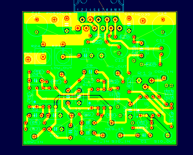

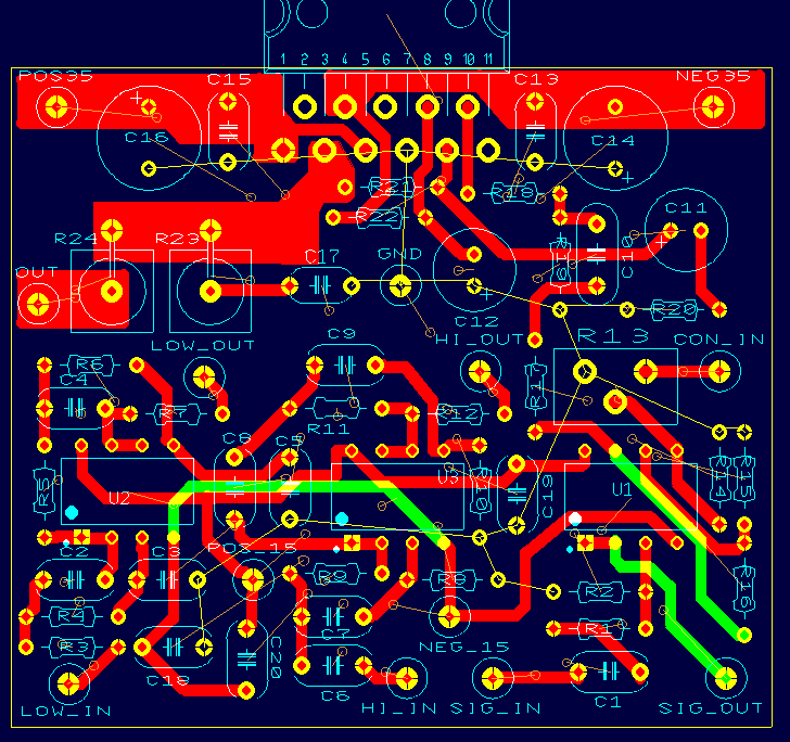

Reworked board layout:

That ground connection looks much better. I've learned to my cost what happens if grounding of reservoir caps is not done correctly!
One comment I forgot to mention last time was that it might be an idea to move C13 and C15 closer to the chip, or to tack a couple of extra decouplers on the rear of the PCB directly on the power pins. Also, one side of R14 needs to be connected and the -15v rail seems to be missing a decoupling cap.
As for power supply filtering, I'm an electronic engineer by trade so always follow solid engineering principles i.e. I dump as many caps as possible across the rails! I built an 8-channel gainclone last year with 48,000uF per rail on the main PSU board and 1000uF per rail per device locally. It sounds great to me...

I will move C13, C15 closer (between the chip and C14, C16). Also will fix R14, which came undone with the last adjustments.
Decoupling on neither 15V rail (oops 😱 ). Will add these and one rail to rail.

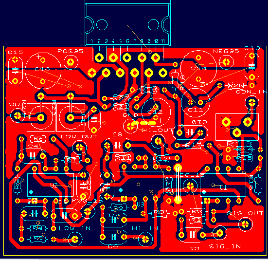

Ok, I bow to the pressure and have changed to a two sider.
This will be the final layout. Every time I make changes on the schematic level, it take 3-4 hours to re-layout, so hopefully, barring a few component moves here or there it's done. 🙂
I have added bypass caps for the 15 volt (C18, C19, C20) and have made the top side of the board the ground plane.
Here's the bottom:

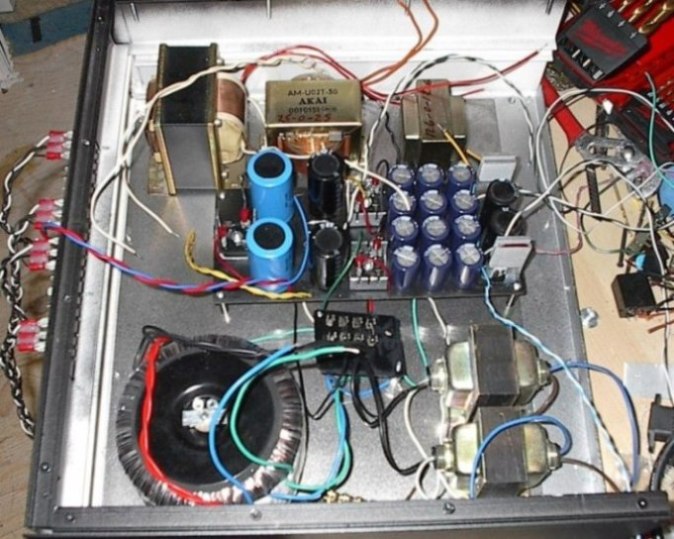

Worked on power supply and power supply case all day (holiday here). For the most part the case is done, just needs a few odds and ends such as feet, a screw or two.
Need to get some fuses, a heavy power cord and start work on the soft start. For this, I'll be relying on Rod Elliot again (project 39). If anyone out there has a better circuit, let me know.
The power supply case:

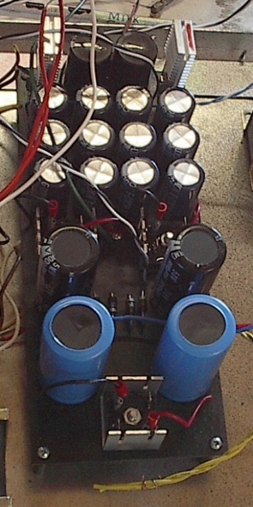

The power supplies used up almost every capacitor I had:
2 - 40 volt/6800 uF for the regulated +/-15v.
12 - 50 volt/4700 uF for the 2 +/-35v.
2 - 50 volt/8000 uF for the +/- 42v.
2 - 80 volt/10000 uF for the +/- 70v
Plus a bunch of 100nF bypass caps.
Wired point to point with 18 gauge wire, on a recycled circuit board that I painted black.

MJL21193 said:Ok, I bow to the pressure and have changed to a two sider. This will be the final layout.
So that means I can't persuade you to change the components to surface mount? 😉 😀
Looking good John! I would move the large caps closer to the chip. Swap the position of C16 and POS_35 and do the same for C14 and NEG_35. You may also want to add some through hole connections to ground for your inputs and for speaker ground (unless you plan on connecting that to the supply ground off board). The last thing I would do is change the output trace so the resistor through holes are more in the center of the trace.

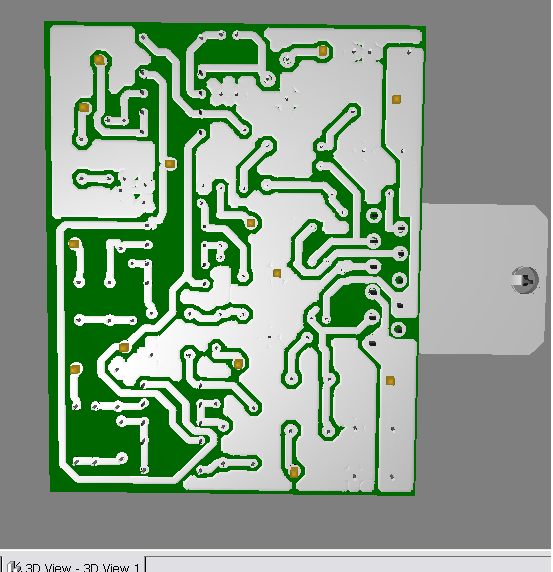

Finally, I have completed the layout, ready for production.
I will email the gerbers to Futurlec tonight.
Here are the final complete layouts.
Bottom copper:
- Chip Amps
- Active filter plus LM3886 - one board
