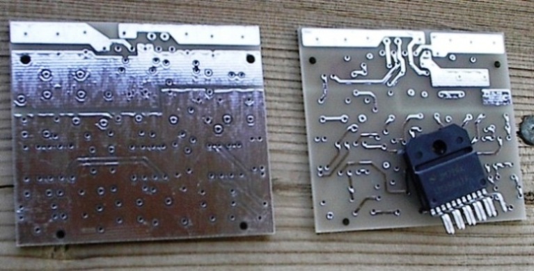

Ok, today I received the boards. They look good.
I am in the process of checking them against the final layout for mistakes. So far, so good.
Having read bad things about Futurlec, I must say that I am pleased with the service. I also ordered a few components with this, that would have cost double from Digikey.
I can safely recommend them, good to deal with.
Here's a shot of two of the boards, showing top and bottom. There's a LM3886 in front for perspective.
On my shopping list is a new camera, this one is a real pain to use for any detail. As grainy as they appear in the picture, the boards are very clean and well made.

One by one I'll have to assemble and test each unit, so it could take a while. Though the boards are small, they have a good number of components on them and barring any more of the mistakes that I made last night (installed 3-2.2k resistors instead of 22k!...thanks to Brian (BWRX) for convincing me to use a double sided board, they were easy to change witout trace damage.).
impsick said:
wait you purchased those boards? they look like home etched. how much did you pay?
Yes, from Futurlec. The photo is not of great quality, so you really can't see how good these boards are. Through plated holes, very clean etch.
There is no silkscreen or soldermask.
They worked out to $3.10 each - I had 12 made.

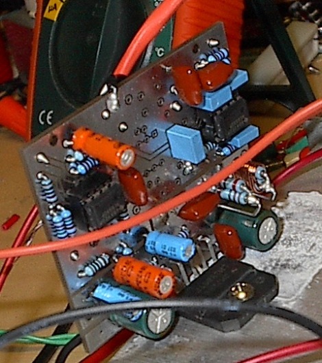

Ok, less than a day.
Sometimes, I'll put something off if I have a feeling it might not work, to avoid disappointment. This being my first time having a board made for a project, I was especially anxious.
Just had it running on a single, unregulated +/- 18 volt supply - filter and amp...
It works, nothing but bass coming out of the speaker. 😀
I will probably have enough done (get it installed in the chassis, wires routed) by tomorrow night for a full power test from the proper power supplies.

Update: I am slowly getting to the point where I can do a full power test on the first low pass unit.
I have added 6 RCA input jacks and the power cables to the chassis (temporary, need a better way to get removable power from the power supply chassis to the active amp chassis. Maybe Jones plugs)
I have the power supply chassis finished and it's in use powering my subwoofer amp, I'll need to get the active amp done enough to bring up here and plug into it.
Maybe a day or two.
Full power test did not go well. In my haste to get it done, I must have formed a solder bridge, or there was a speck of solder on the board somewhere that shorted something.
Burned both NE5532's.
Disconnect, bring it back down to my lab, where I do what I should have done in the first place - build a temporary +/-35 volt power supply.
Examine the board over and over again. Disconnect wires, take out the op-amps. Check for shorts.
Put a new op-amp in the lowpass filter section. Re-route wires to just go through it, and not the buffer/volume control.
It's working again, very clear solid bass to my test speaker. Stops! Oops, forgot the heat sink. Thermal shutdown really works.
With the second op-amp in, I try again. Works! Louder - the volume control buffer has a gain of two. The slide pot gives very linear, smooth volume control.
DC offset at the speaker output is ~22 millivolts. Given the fact that some of the components for this first board were salvaged from old circuit boards, it's not bad.
