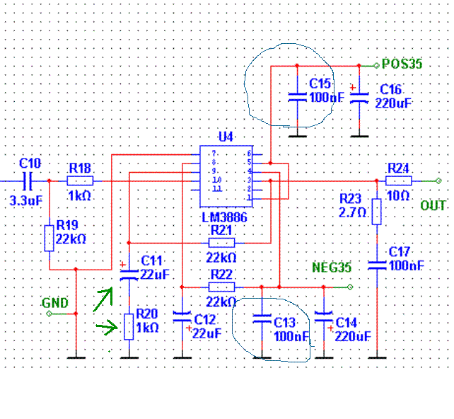

AndrewT said:Bypass caps? are you referring to c20 & c21?
Hi Andrew,
Those (C20, C21) would be in the filter/buffer stage on the 15V supply. The bypass caps I'm referring to are in the amp stage (as pictured below), specifically C13, C15. I left the 220uF electros C14, C16 off altogether.
In the picture, arrows point to C11 and R20. Should these be reversed?
you should not need to reverse the positions of C11 & R21. They will work either way.
Omitting the electrolytics from the local decoupling could give rise to an oscillation problem.
Where does c17 terminate? could this contaminate a clean ground?
Similarly, C14 & C15 should terminate together and on the power ground using very short routes on both the power side and on the ground side.
What is PIN7? Is it allowed to terminate on the signal/clean ground?
This was for testing only. I'm trying to back the problem into a corner, by using as few components as possible.
C17 grounds on the main power ground, as do C13 to C16 (very short leads)
Pin 7 is also attached to the main power ground. I re-routed this on my test board to the signal ground and it made no difference. Likewise, the boards that first exhibited the crackling sound, pin 7 goes to main power ground on these too. These have not shown any bad behavior since the crackling has stopped.

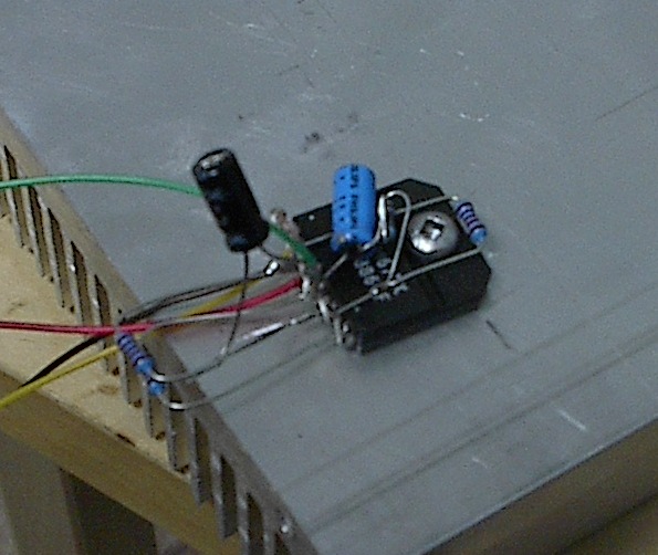

Here's what I just did: I re-built the power supply with a new bridge rectifier and new 6800uF caps. This made no difference.
I am beginning to think that there is some problem with the circuit board itself. Really, it's the only thing left. I have built other LM3886 amps without boards and didn't have this problem.
To test this I will go ahead and build on on the heatsink, wired point to point.
Ok, it's the boards. I did a rough point to point without any decoupling caps, connect the power - silence. No crackling, no hum.
Is there a possibility that the board substrate (fiberglass?) has impurities that are causing this problem?
I noticed arcing in a couple of the other boards before, but assumed it was some solder specks or other conductive debris, although cleaning didn't immediately fix the problem, it did eventually go away.
This means that each of the boards that I finished has some fault within the board itself. It cannot be a layout problem or the noise would persist.
Here's a photo of my quick test. Rough enough?
MJL21193 said:Ok, it's the boards. I...
??Doesn't sound like you have really ruled out the board layout.
I looked more carefully at your board layout and it is not "optimal". I don't know whether it is the board layout that is actually causing your problem, but the layout could certainly be improved. You should at least use two separate ground lines for the LM3886 circuitry, connected together at one point. If you follow the following 5 rules the LM3886 will not oscillate--guaranteed.
Look at the circuit board layout for the LM4780 to see how they followed these rules:
LM4870 app note
1. Use a separate power supply and signal ground for the LM3886
2. Connect the speaker return to the power supply ground, not the signal ground. The power supply ground between the main filter capacitors is the ideal connection point for the speaker return
3. Return the snubber circuit to the power supply ground, not the signal ground
4. Connect the power supply decoupling caps to the power supply ground, not the signal ground
5. Connect the signal ground and power supply ground with a small resistor to ensure that heavy current doesn't flow in the signal ground. 1 to 5 ohms will work. However, if you have a perfect layout this resistor isn't necessary.
Again, this is general advice and it may or may not account for the problem you are seeing. However, the fact that removing the decoupling caps on the supply changes your symtoms makes me wonder whether your grounding scheme is the problem. If that is in fact your problem, then welcome to the club--I have done this many times, as have many others.
Good luck.
PS: get rid of R24
