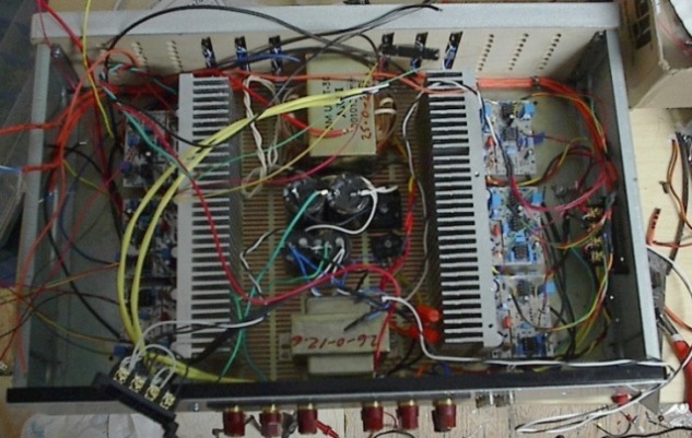

A shot of "it" following installation of the right channel amps. Too many wires.🙁
My question is since you have band specific filters on each amp board is the incoming signal paralleled to all three boards?
troystg said:My question is since you have band specific filters on each amp board is the incoming signal paralleled to all three boards?
Yes, signal is paralleled to each board. Separate shielded lead for each board from the RCA jack.
Here's a list of the wires coming from each board:
1. +15 volt
2. -15 volt.
3. +35 volt
4. -35 volt
5. ground
6. speaker out
7. level pot ground
8. level pot wiper
9. level pot signal
10. signal in
11. signal ground
Like I said, too many wires! Most troublesome when one breaks at the board. I will do a better job of organizing them when I build the permanent case.

Listening to a variety of pieces I'm intimately familiar with and it's remarkable how details I'd not noticed before jump out at me. Hands down beats the a ss off the passive crossover / Yamaha receiver combo.
Amazing there is no noise (hum,hiss) from the speakers. The wires are shoe-horned in the case all over the place. Like a snakes nest.

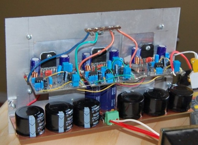

Looking at the snakes nest of wires in the chassis, I decided to start again and take each "side" (bass, midrange, treble) and build two plate amps that will be mounted in the speaker boxes.
New power supply boards with 3-4700uF caps/rail and regulated +/-15V dropped from the main supply. I have two 25-0-25 transformers from junk receivers that I'll use.
Here's how it looks. I'm using the same heatsinks as before, but I've mounted them on a piece of aluminum plate.

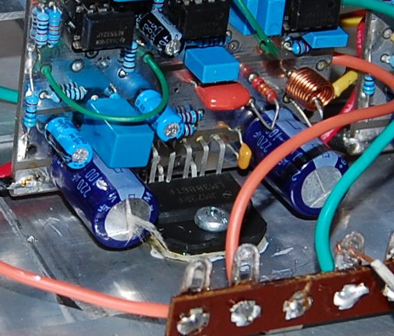

Encouraged, I started on the second amp set. I had everything finished and did a test. No output from the midrange amp. Nothing. Try this, try that nothing works. Stumped, I figure I'll not waste anymore time on that, but just build a new one (I still have 3 or 4 boards left). New components, including the LM3886.
All done, install it in the "plate" amp chassis. Plug in the transformer. After about 3 seconds, sizzling sound, smoke (a lot!) and a loud POP! Unplug the power, clear the smoke and see the top burst open on a decoupling cap. It's then I notice (after careful inspection before testing) that the polarity is backwards.
Photographic evidence of my carelessness:

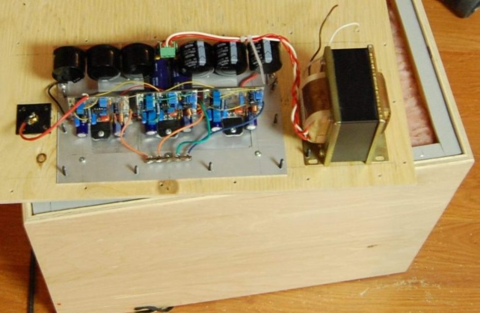

I got that fixed. Try it out and everything works.
Next is to mount it to the back panel of the speaker, connect to the drivers and try again.
All systems are go!
Successful recycle of fledgling DIY project. My skills have improved since I designed and built these active amps. There are things I'd do differently, but fundamentally there was nothing wrong with their performance. That's what counts.
Anyhow, they have found a new home and I think they will be there for quite some time.
Here's the amp mounted on the back panel of the speaker. You can see some of the speaker in the photo.

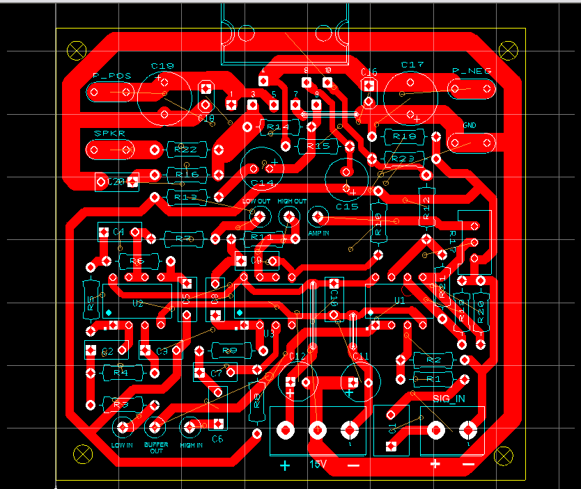

One problem-
I found that I couldn't manipulate the layout from the Gerbers, so I'm doing a new layout. 😱
Less cluttered, single sided. I have a use for a few more of these so I may as well spruce it up.
Half done:

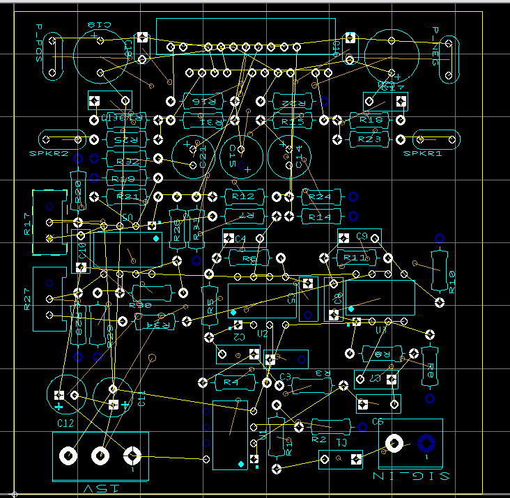

What I have here is a spin off of the original idea. I have gone back to the drawing board and substituted an LM4780 for the LM3886 giving 2 channels on the one board. High pass filter for one and low pass for the other so this would be ideally suited to a compact 2-way (like my centre speaker and surrounds). Compact solution on one board for a complete active 2-way.
Yes, I'm a sucker for punishment. 🙂
In it's early stages yet - a bit more time to optimize the layout before I prototype it to test.
Here's the rough layout:
