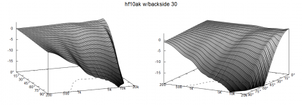

Alright played with the backside some.

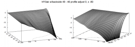

If someone wants to make such waveguide that has enclosing backside to eliminate diffraction altogether, then I suggest to optimize the R-OSSE definition by using tmax > 1 first. Then, if the backside did not end up practical to build use the new bezier backside definition or Profile coordinates file to shape the backside further to make it more practical.

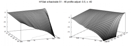

Here is profile I came up with for my project, backside is done by tmax so no tricks. Graphs show no diffraction, about target DI.
Not sure if its coincidence or not but a bezier curve seems to match almost perfectly tmax backside with the R-OSSE definition here. I used Desmos as reference to match the bezier to R-OSSE tmax and then script to make these sims. Custom script is output here and seems to be working as results match above.
Following are some manipulations of the backside, making it longer and rounder and so on compared to backside made with just tmax. As you see the waves on the fall plot are due to sound going all the way around the waveguide and can be minimized by manipulating shape of the backside. I think these are getting almost as good as it gets because we cannot stop sound propagating around freestanding object so some of the wavyness will stay no matter what
Rounder back, same depth, kind of apple shape
Rounder and elongated back
This is just elongated back
Little bit less elongation
More pointy back

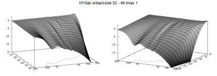

edit. for completeness sake here the same R-OSSE profile without backside, tmax=1 so edge diffraction effects are visible.
More pointy back

Here is the R-OSSE definition in desmos https://www.desmos.com/calculator/kzpt3tyi9f also showing my simple bezier backside matching R-OSSE curve. These parameters (R-OSSE alone with tmax > 1) ought to yield results above labeled number 45.

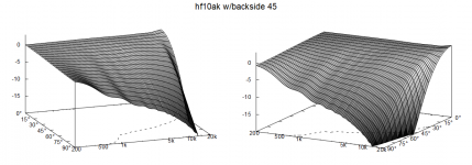

Drinking coffee and spotted few observations from the set.

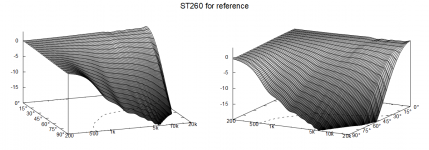

Here is standard ST260 for comparison with same sim and plot settings, pretty good 😀
Following graphs are from the earlier post, my profile with and without backside. The one without backside is generated by ATH and the one with backside is done through Profile coordinates generated from R-OSSE formula and custom backside curve with my custom script.
Comparing impedance graphs and top octave its clear there is some difference on resolution, amount of nodes in nodes.txt is same but I'm just cranking coordinates out with t/nodes steps, perhaps nodes should be closer together at throat area for better accuracy? Also radius seems to go all the way up to 136mm on my script while it should stop at 130mm so there must be some error somewhere. Well, they are pretty close, and its real simulation no matter what generated the curve so 😀 Still some work to do.
Another thing, comparing DI it seems edge diffraction on the device without backside extends DI roughly half an octave lower. Estimating by eye both ST260 and my profile without backside have roughly 6db DI around ~700Hz while the one without has it perhaps around ~1000Hz.
As mabat said such device is usable for lower DI systems without too much of a size penalty.
edit. increased radius from 130mm to 185mm, so bigger 50% in diameter, to reach DI of about 6db around 700Hz. Perhaps some optimization size could come down some. Definitely bigger device than ST260 for sure, good work diffraction, good work mabat 🙂
