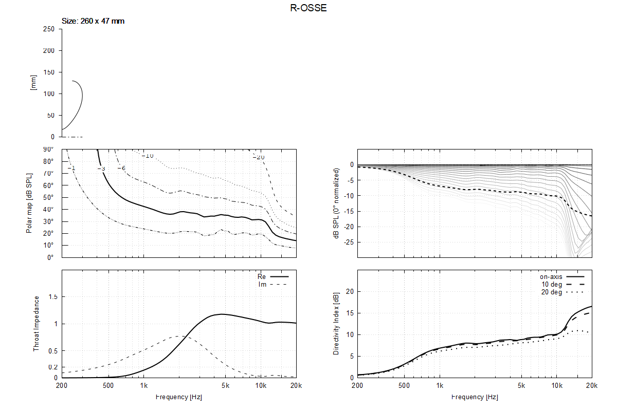

Hello,
I have been reading this thread for a while. I actually read most of it and but that took a whole and so I already forgot most of it again.😛
But it was extremely informative. Thanks to you all and in particular to mabat, great work!
As the discussion has turned to crossovers I might add my 2ct.
I have been struggling with the acoustic side of combining two drivers. ST260 is a great WG and there is not much left to be done to have a superb tweeter. Just adapt to the exit angle and size of the preferred CD and there you go. But I wanted to have a bit lower DI to get a small increase in DI between cardioid LF and HF produced by WG. ST260 has DI≈12dB at 10kHz and I wanted to get to ≈10dB.
That took some work and after doing about 100 iterations by hand 🥴 I learned ATH a bit and arrived at the following parameter set.
WG_260_ND3N
This is not perfect in the top octave but 15 kHz is the limit for me anyway and I want to cross as low as possible, preferably 700 Hz or below.
The crossover would have to take care of the DI in the crossover region.

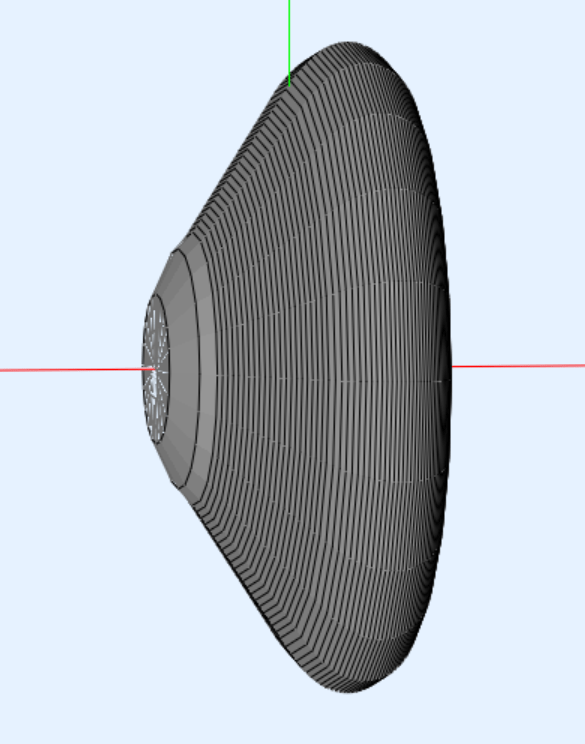

So I edited the nodes.txt file for some time and finally got this design that would fit around the ND3N which you can see in the middle of back.
From tmuikku we know the effect of the backside for FR/DI and so there is little surprise.
It is smoother and DI below 1.2 kHz is a bit lower than before. I like the result. It is "shorter" than most of the designs of tmuikku.
WG_260_ND3N
R-OSSE = {
R = 130
a = 46
r0 = 17.7 // 1.4 inch CD ND3N by 18sounds
a0 = 4.5 // I assume this to be the exit angle of ND3N
b = 0.6
k = 0.8
m = 0.8
q = 4
r = 0.3
Source.Shape = -1 // to account for the (idealised) wavefront at the exit

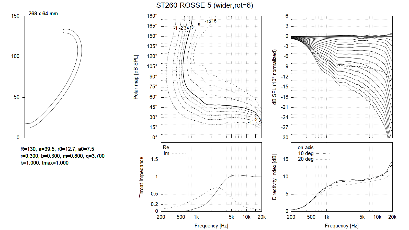

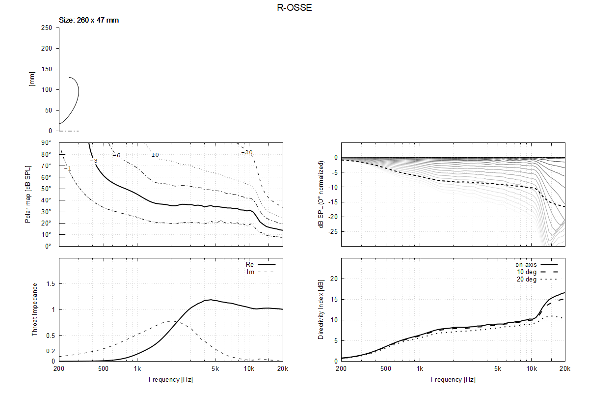

Hi olieb,
it seems you had a lot of fun with the tool. What you show in green is just too much for me 🙂

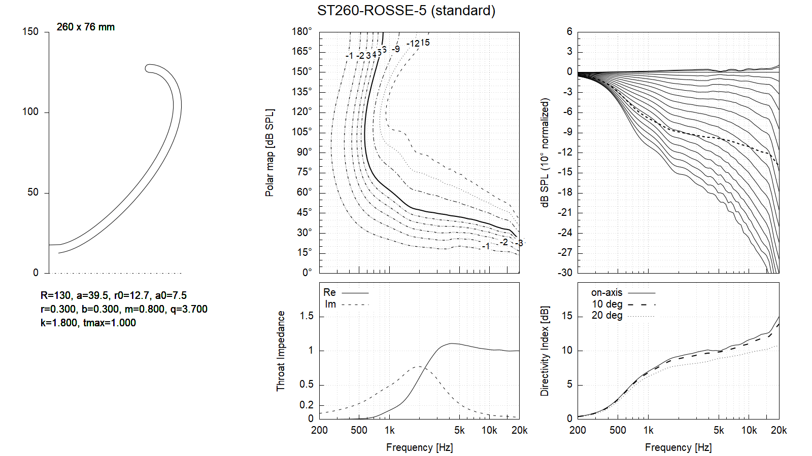

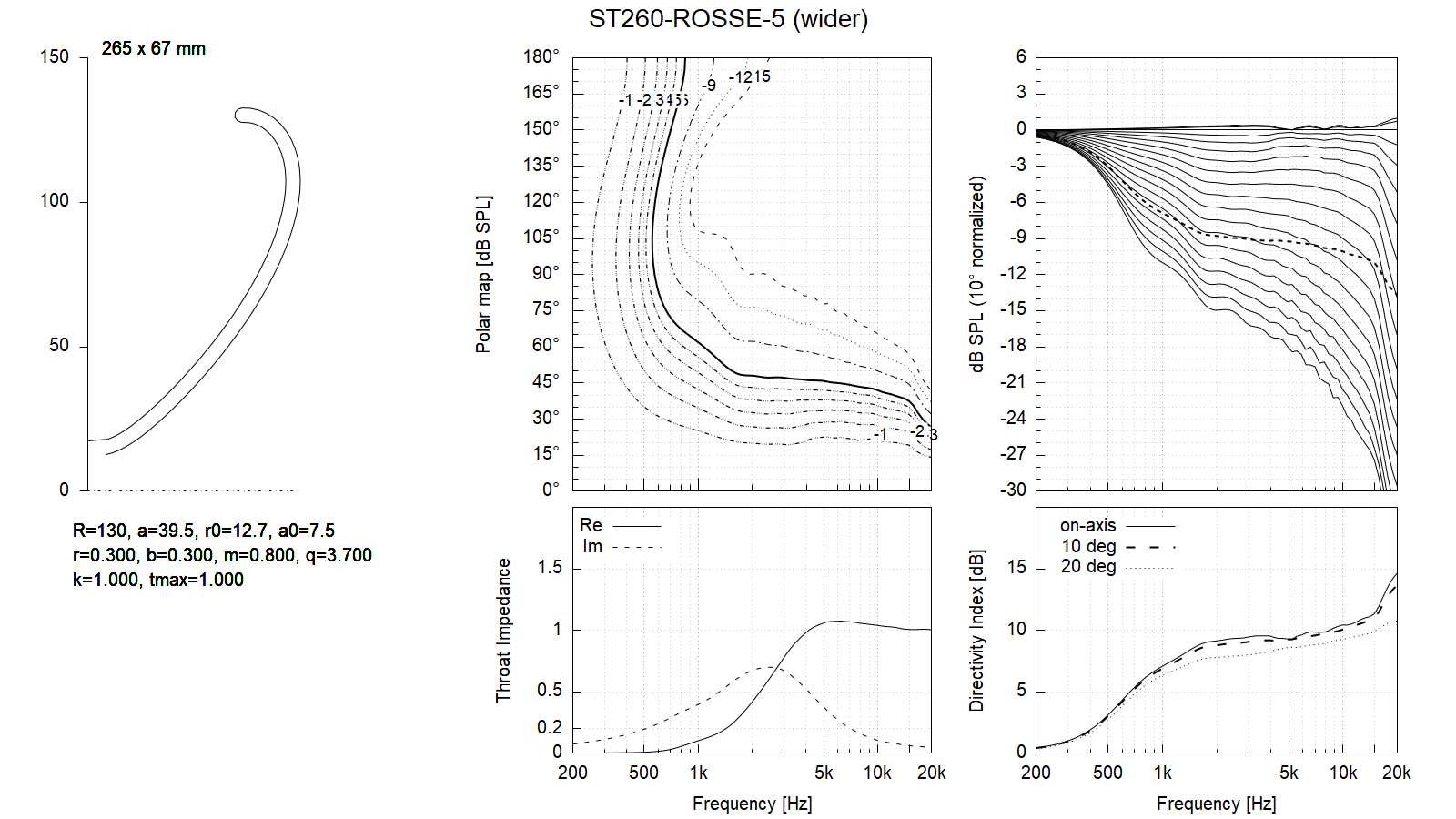

- If you want to make the ST260 a bit wider towards HF, this is how to do it. Set Rot = 3 and k = 1:
The standard ST260:
Rot = 6, pretty flat:
The standard ST260:

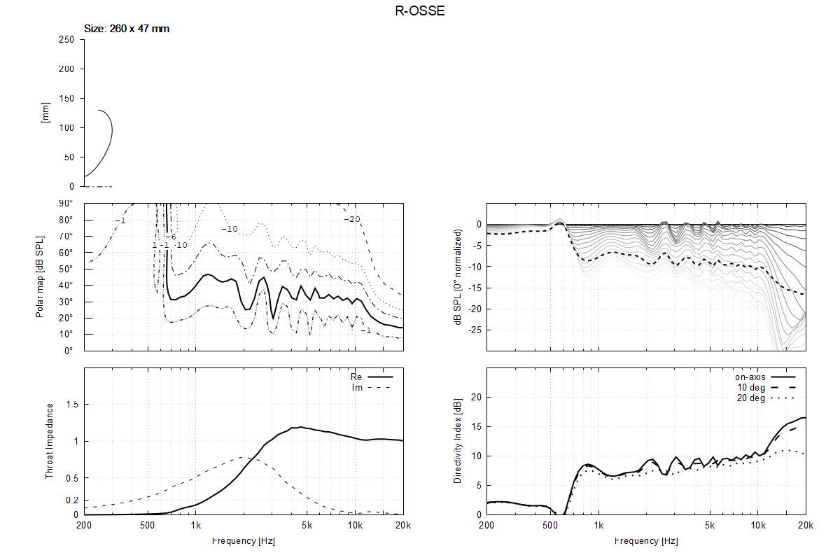

-1 will set a flat wavefront. Maybe you wanted 1, which accounts for the throat angle. But then again, nobody knows what are the actual wavefronts with real drivers. So far that's always a surprise.Source.Shape = -1 // to account for the (idealised) wavefront at the exit
I'm somewhat surprised how bad that turned out. Did you try also the regular (open-back) version of the WG?But now what happens if one puts this in front of the woofer box? I am by far not good enough with ABEC to simulate this so I approximated it with ATH in axisymmetric mode (with a tiny rod that connects the 2 parts). ATH is really great!
But the result is not so great. Easy hunting for "diffraction".😀

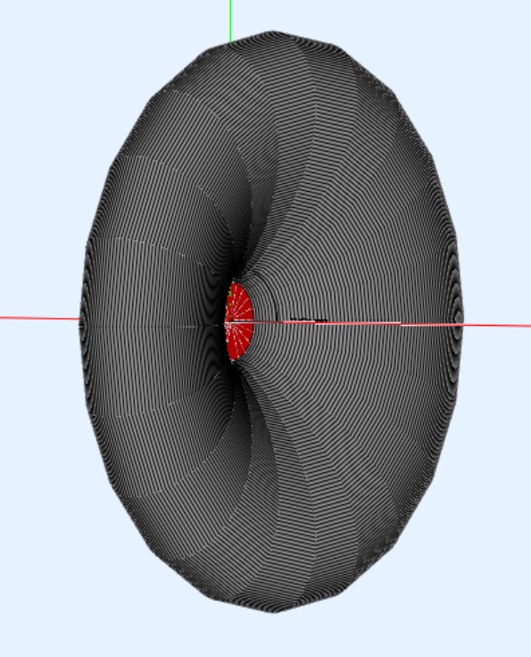

BTW, you don't have to place any "tiny rods" to connect the parts - it's perfectly fine to have disconnected parts in the model.

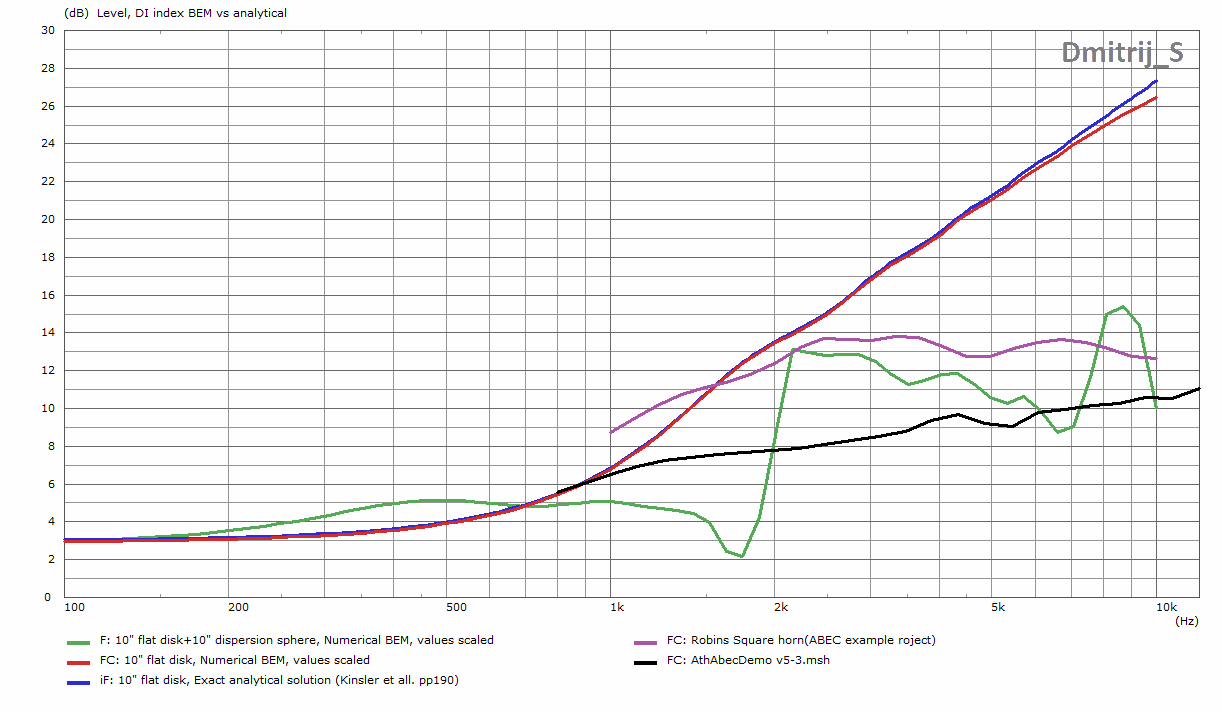

I think you will have difficulty with woofers firing directly into the back of the waveguide. Having them exit through a slot or grill on the top of the waveguide edge seems to cause less trouble. Some combination of the idea I showed in the link below together with the extended termination should work quite well and is very similar to an idea @aragorus showed in the same thread.
https://www.diyaudio.com/community/...aker-build-abec-modelling.357792/post-6551783
Also don't get too upset at the sort of diffractions that ABEC will show, whilst they are no good or desirable, they will in all likelihood be reduced or swamped out by other sources that are not directly modelled. Adding wall impedance to different surfaces is a good way of seeing what might happen if the surface isn't considered to be completely reflective.
I think this will depend a lot on the crossover frequency. At 700 Hz the wavelength is already 0.5 m - it doesn't have to be a big problem. But of course it's of concern.I think you will have difficulty with woofers firing directly into the back of the waveguide.
It's what having the space and cavity for the woofers does to the waveguide response that causes the trouble.I think this will depend a lot on the crossover frequency. At 700 Hz the wavelength is already 0.5 m - it doesn't have to be a big problem. But of course it's of concern.

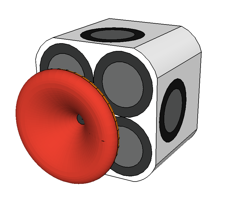

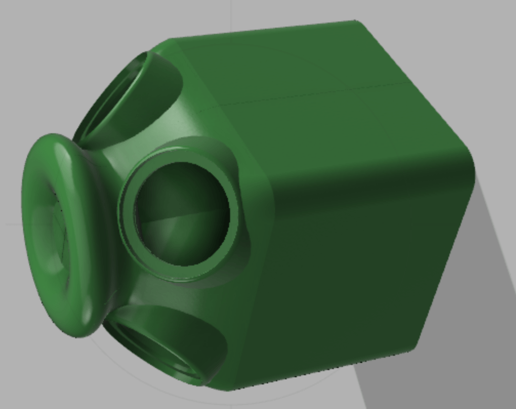

Hi, lots of work there 🙂 Have you considered multiple entry horn? If you start thinking your concept where woofers are behind a waveguide there is going to be some interference for at least the other, if not for both. Because them both need to reproduce sound around crossover frequency and both have different physical construct as their acoustic environment. This means that unless waveguide is very small the woofers sound will reflect and diffract from back of the waveguide around crossover frequency. If the waveguide is too small for the tweeter the tweeters sound reflects and diffracts from the woofer structure around crossover frequency.Hello,
WG_260_ND3N
R-OSSE = { R = 130 a = 46 r0 = 17.7 // 1.4 inch CD ND3N by 18sounds a0 = 4.5 // I assume this to be the exit angle of ND3N b = 0.6 k = 0.8 m = 0.8 q = 4 r = 0.3 } Source.Shape = -1 // to account for the (idealised) wavefront at the exit

I do not think this will work well with a ST260-style WG with open back. A graph from Dmitrij_S in Post #2,558 gave me the idea to put the WG with a closed back (well rounded) in front of the woofers. Something like this.

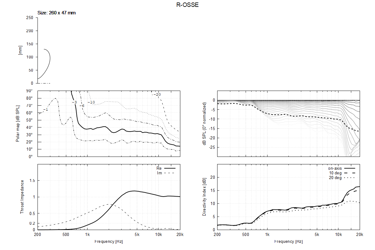

View attachment 1129819View attachment 1129820

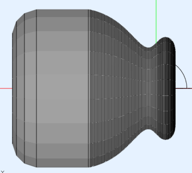

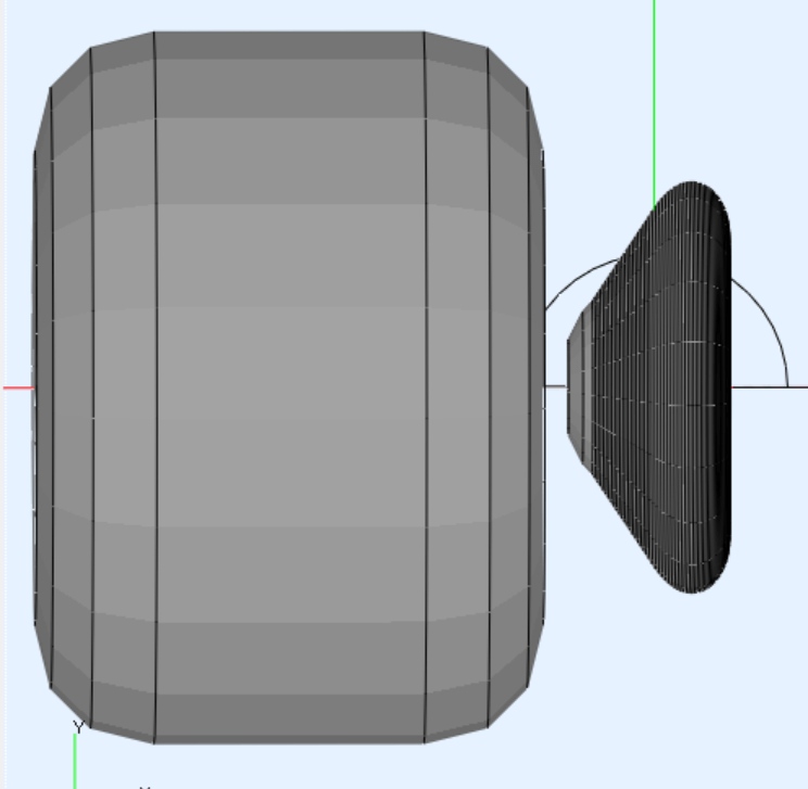

View attachment 1129841 View attachment 1129844
This is the very same WG as before! Of course this is the worst case because of the symmetry but this is really ugly (and I rounded the edges somewhat to account for the disadvantages of cylindrical form). The strongest effects are right in the middle of the range where the ear is most sensitive.
Obviously it is of limited success to optimise the WG all on its own. One has to take the surroundings into account as anything around the WG produces (very early) reflections and diffractions.

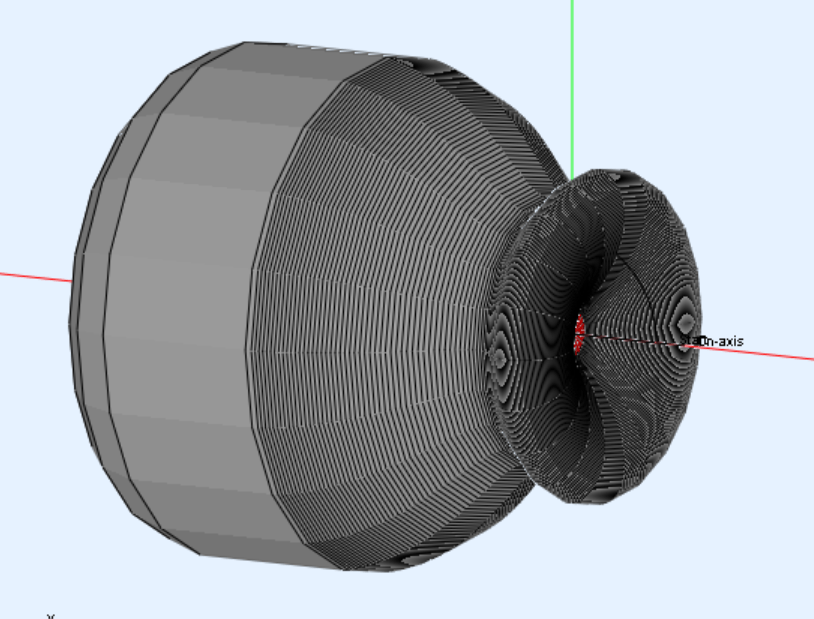

I tried to improve this and found out that the volume "behind" the WG is the culprit and should be minimized. Another problem is the flat surface that produces these nasty reflections.
After some more experiments I found a shape that delivers on the need of a box with volume and space for the woofers (these have to be as close as possible together to avoid artefacts in the cardioid behaviour) and still has acceptable radiation properties.
View attachment 1129852View attachment 1129853View attachment 1129854
This is neither perfect nor the "real deal" as the box is supposed to be rectangular. But with the newest prerelease it will be much easier to build designs like this and experiment further. But I am not sure I will be able to master the simulation in ABEC of something like the following any time soon. Still a lot to do.
But my point here is that for crossing over it seems necessary to simulate the frequency response and radiation pattern of the WG together with the surroundings i.e. the woofer and box. Otherwise a lot of VER (very early reflections) will destroy the nice balance of the optimized diffraction pattern of the "standalone" WG.

The slots might work but the system will get really complicated with cavities, channels and slots. Not my league, to me 4 drivers in a symmetric arrangement are much simpler, haha. But you cannot imagine how impressed I am with your simulations in ABEC/AKABAK, awesome.I think you will have difficulty with woofers firing directly into the back of the waveguide. Having them exit through a slot or grill on the top of the waveguide edge seems to cause less trouble.
The coaxial arrangement was inspired by a graph from Dmitij_S with a woofer firing behind a sphere simulated earlier in the thread #2,558 .
The green line shows a 10" woofer firing behind a 10" sphere. Looks promising to me for crossover below 1000 Hz. In the end the sphere (or the closed back of the WG) is just a rather smooth dispersion body about half a wavelength in size (path length differences are way smaller).
And a 10" piston will probably be affected more by the sphere than a "ring" of four 5"-pistons.
But I would very much like to be able to simulate my idea. I am not there yet, biting more than I can chew. ;-)

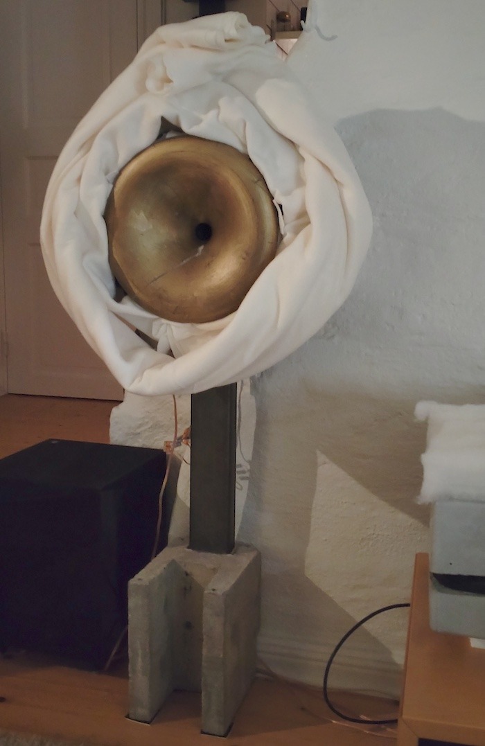

It seems like chasing diffraction and back-wave energy is paying off. I made this after getting two fleece blankets form IKEA - 4€ each.
The sound source jumping when moving my head has decreased significantly and clarity but also "calmness" has improved.
Remains how to apply it without looking to corny... as that would be possible to begin with 🙂

One of my design goals was to get a small increase of DI from 150 Hz to 10 kHz by using cardioid radiation pattern in LF.
How would you do that with MEH? I do not see how this would work.
So I did not consider it. Another reason is the complexity in acoustics and simulation.
This is what I wanted to try. Might also solve the reflections of the woofer enclosure.It seems like chasing diffraction and back-wave energy is paying off. I made this after getting two fleece blankets form IKEA - 4€ each.
