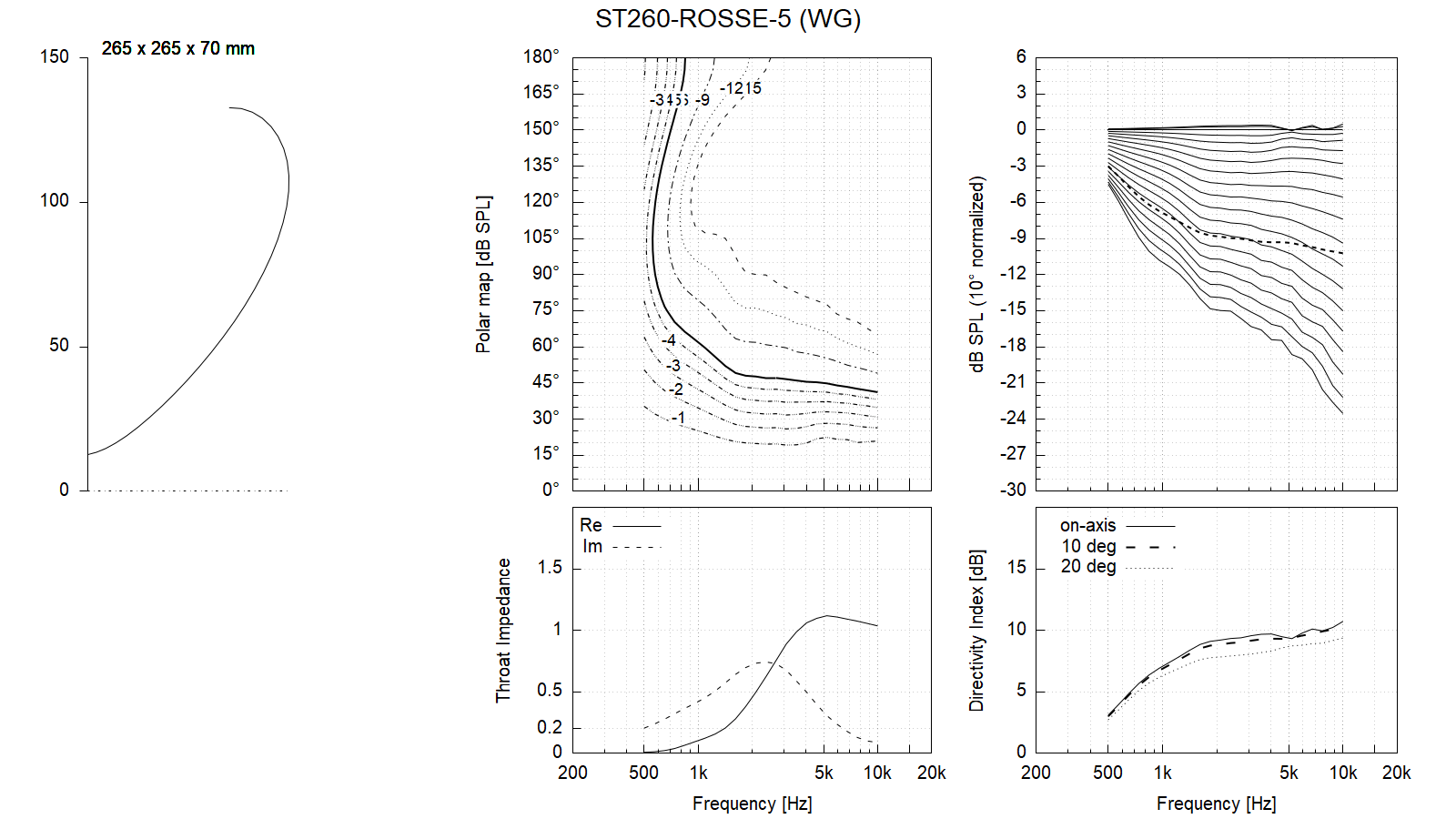

So the options I am considering include building 1) an ATH WG (OSSE) into a soffit wall, 2) An R-OSSE WG protruding through an absorptive wall (rearward termination of the WG against the wall, and 3) free standing with a rear absorptive wall.
Based on all the knowledge y'all have accumulated re. the pros and cons of these waveguides, does one approach stand out as the best or clearly bad?

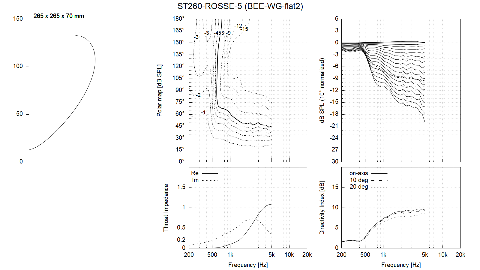

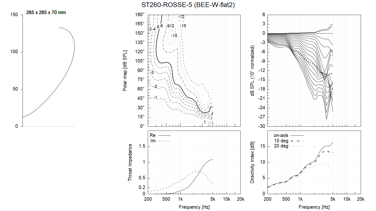

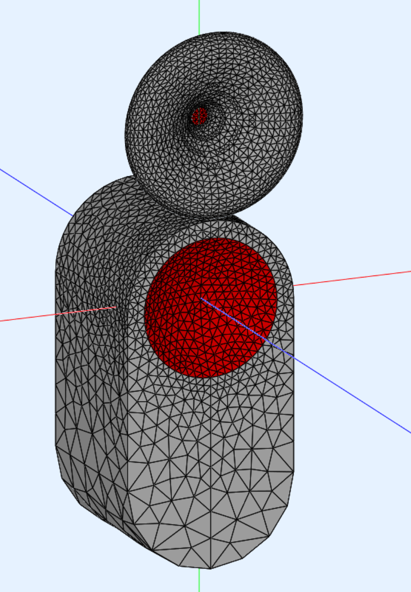

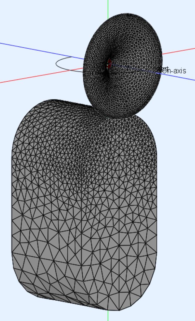

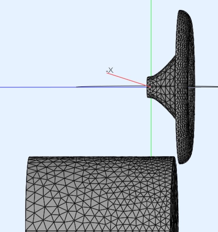

Anything that is not explicitly accounted for in the simulation, the phase plug, junctions between devices, woofer chassis etc. including anything nearby the speaker, yes. The point is that some simulation methods can make some diffractive effects appear worse than they are in reality. My own simulation of a synergy port suffered the same issues. Everything being treated as a fully reflective surface, when in reality they are not. Circsym with high mesh resolution is going to highlight things even more.What do you mean by "other sources"? Walls, furniture? Or effects of the speaker surfaces that do not fulfil model assumptions (rigid wall)?
So far the measurements shown in the thread seem to match the simulation results pretty well.
Including a woofer enclosure.

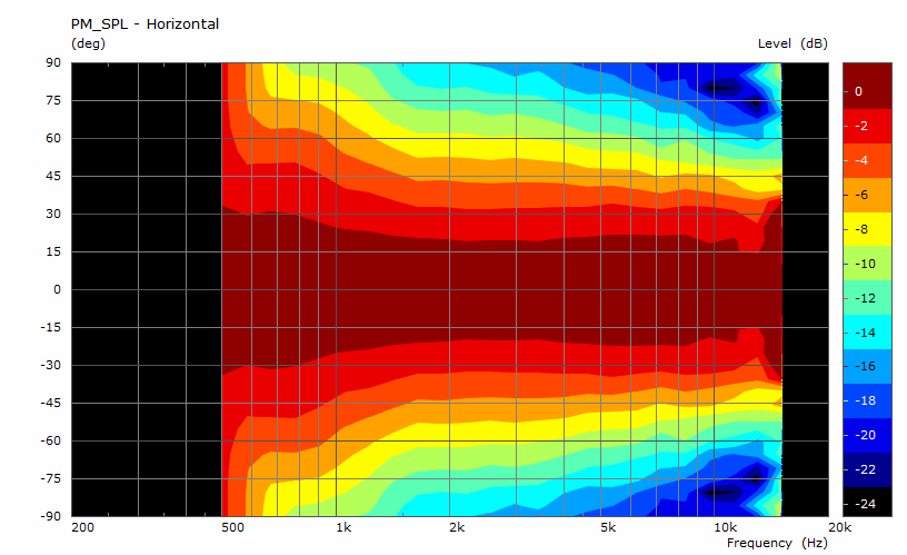

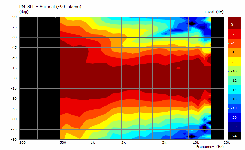

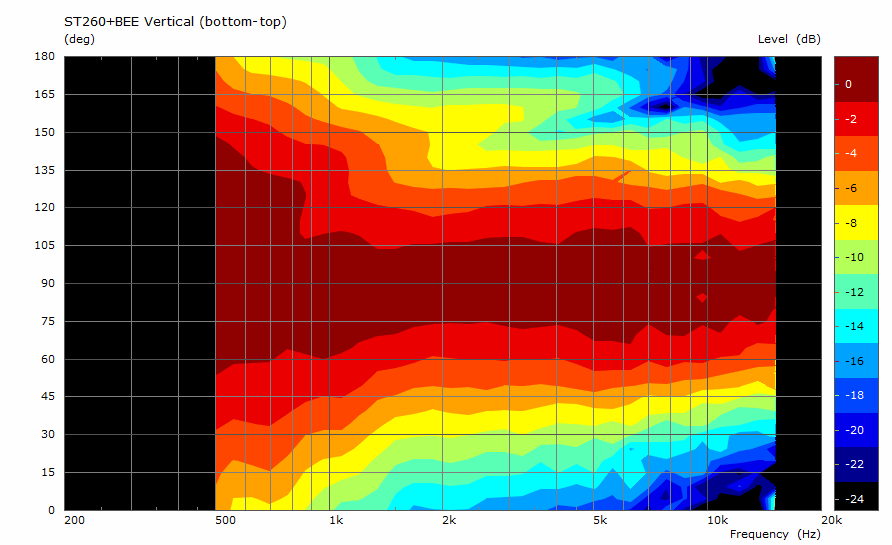

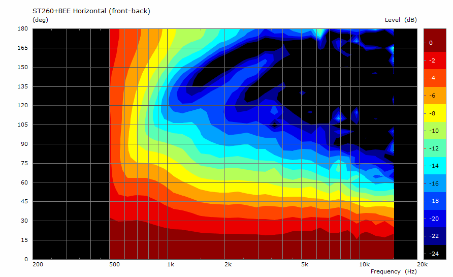

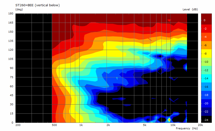

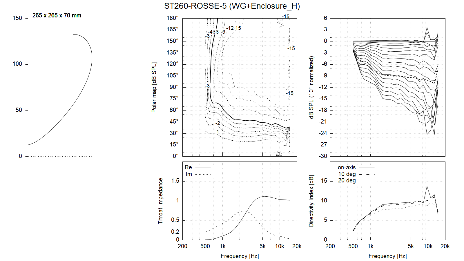

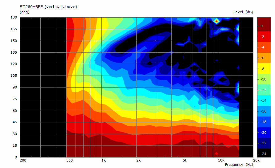

WG response - horizontal, vertical:
A direct comparison of the WG alone and with the enclosure (horizontal polars):
(There are obviously some numerical defects on HF - a higher-resolution mesh would surely help.)
Here's the code and the updated exe.
https://at-horns.eu/ext/ath-4.9.0-pre-230115.zip
Feel free to increase the mesh resolution. I just wanted to keep the number of elements under 4000.

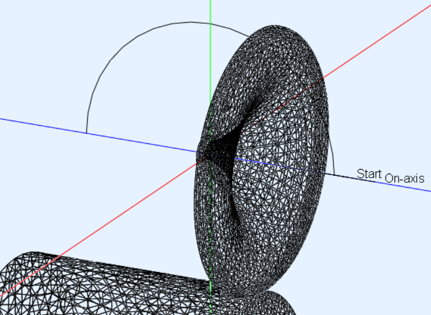

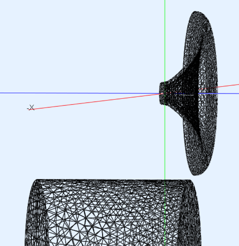

I could not agree more. I was rather happy with my result of a CD in WG with rounded back all on its own.Indeed looking at the waveguide alone without considering the whole system is not the best idea, but often it is easier and quicker to look at things in isolation first.
But then I found out that combining two isolated parts might not work at all the way one would expect it.
I expected some interference especially in this arrangement where every disturbance would sum up on axis because of the symmetry, but I did not expect what I got.
The results for a woofer box beneath a freestanding WG look much more benign, but interference is still obvious and much stronger than most of the differences between different ways of termination or lip form that are frequently discussed here.
I just wanted to point that out: Keep an eye on the full system!

I think we are all pretty aware of that. The above system (#11,449) is the current culmination of my work in this area (i.e. reasonably sized high-quality speakers), and also what I would still opt for, aware of all its limitations.I just wanted to point that out: Keep an eye on the full system!
- A bit more higher-resolution data:
Thank you so much for this. Great work again. This looks very nice indeed.I think we are all pretty aware of that. The above system (#11,449) is probably the current culmination of my work in this area, and also what I would opt for, aware of all its limitations.
About the awareness, I wrote my post after there where some posts about inspecting 0.25 dB ripple in the FR/DI curves to optimise further when on the other hand hardly any results for complete systems were shown. At least it was my impression.
It may be as important (or more so) to optimise the top of the woofer enclosure as you did with making it cylindrical than to adjust tmax by some percent.
The higher resolution graphs are for the identical system? It looks like the WG is placed a bit higher, or is it only the perspective?
