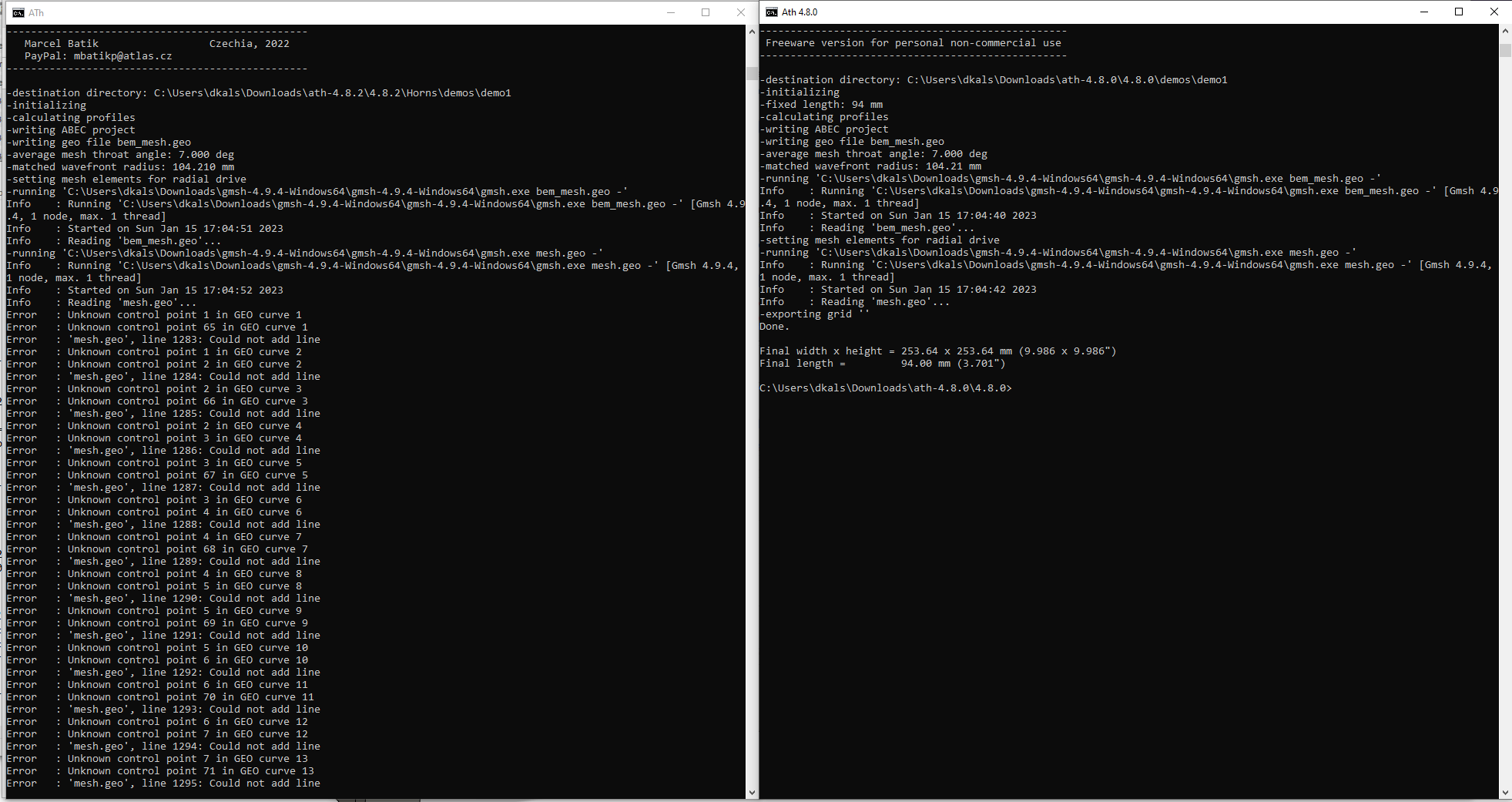

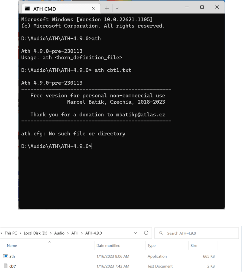

I've downloaded the latest (non-beta) version and had previously downloaded version 4.8.0 (though I never did anything with it back then). I'm currently getting the following error in Version 4.8.2, but 4.8.0 works - running the exact same demo1.cfg file.
Any thoughts on what I may be doing wrong?

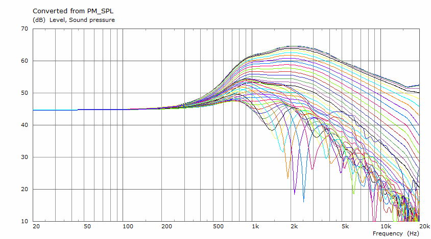

... About the awareness, I wrote my post after there where some posts about inspecting 0.25 dB ripple in the FR/DI curves to optimise further when on the other hand hardly any results for complete systems were shown. At least it was my impression...
You guys might consider it funny but I had some serious fun with it 🙂Yes, that was somewhat funny intermezzo 🙂 (but why not)
There is great power with ath (and BEM), anyone can inspect stuff that would be really hard otherwise, roll out small studies like this to get more knowledge, what affects what in the graphs.
Size and shape are connected to complete system design, of course. Results of the sims are visual graphs though, and not sound in the room as part of complete system. I see only fun time ahead, come up with few interesting variations for given system and listen if there is meaningful audible difference to really get some knowledge.
The thing is one can come up with any particular waveguide design and then get it 3D printed with roughly equal amount of work and cost no matter what the shape and response is (as long as size is comparable) so why not try and make it as good as possible? What ever the metric is. Tailor fit to system is best one can do and we are all able to do it with ath. Even for looks! 🙂 I agree diffraction ripple so small is probably not audible and perhaps silly metric to optimize on, but if its a free feature for a system then why not.

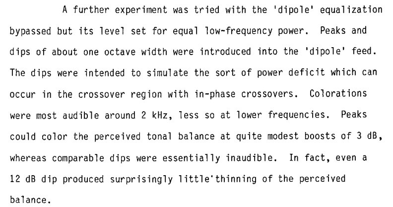

And these nulls are always connected with a DI peak and I am not convinced that those are a good feature either ;-)
You might also want to consider the work of Lipshitz and Vanderkooy who conducted an experiment into the audibility of introduced nulls. Peaks were quite easily heard but nulls could be very deep and not very audible.
I also wanted to point this out but couldn't recall the study. Thanks.... Peaks were quite easily heard but nulls could be very deep and not very audible.

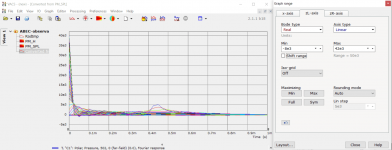

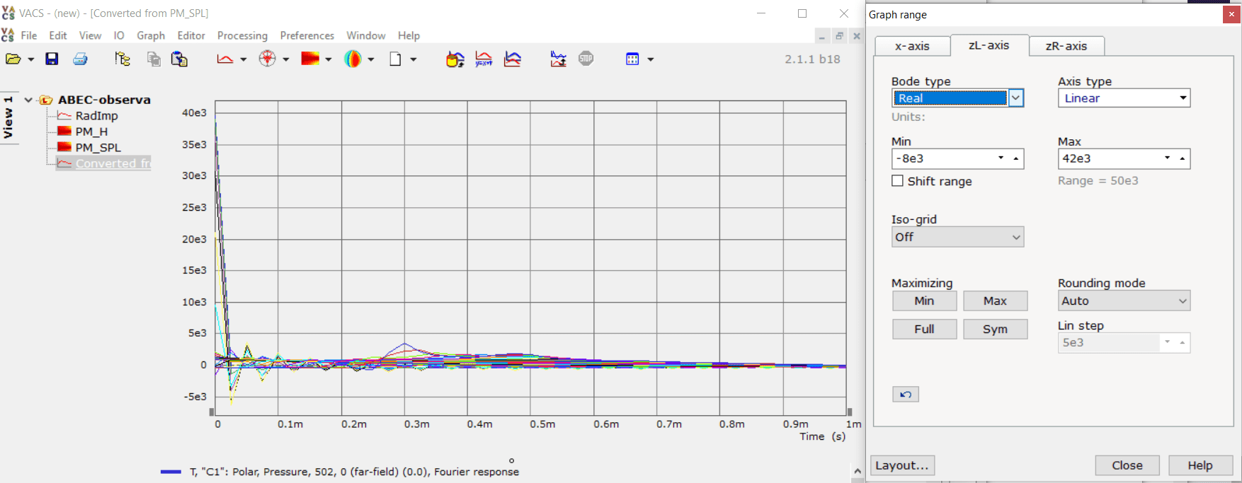

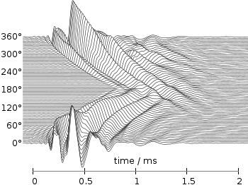

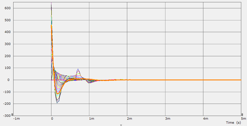

Hi, did you investigate this graph further? I found VACS can export impulse responses but gnuplot goes over my head. To export IR from VACS, first Graph > Convert curves to contour, and then Processing > Fourier response, then right click on the graph and export data.- I just came across this graph, haven't seen this before. It's basically a polar map in the time domain - impulse responses at various angles.
Could it help to visualize something not readily seen in a level map?
http://www.gnuplotting.org/tag/iteration/
I'm not sure if this kind of graph provides valuable info in the end. It would be very interesting to take a look though.

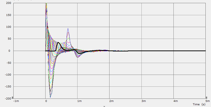

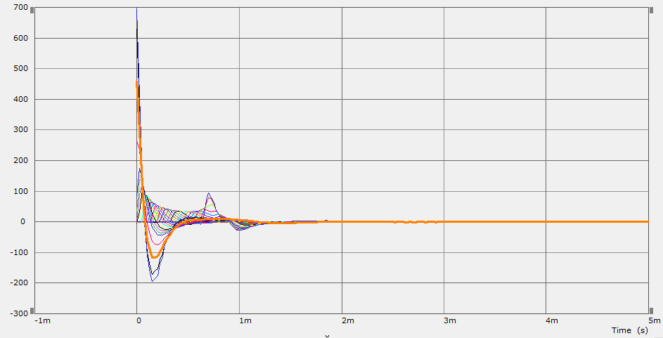

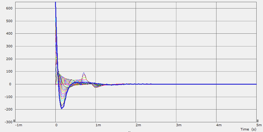

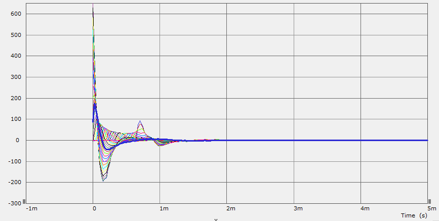

edit. screenshots from VACS showing difference in impulse responses for two waveguides, ST260 and the other is some other profile with backside. Differences show up in the polar maps already but perhaps there is opportunity to compare impulse responses toward listening window or something like that.
Not yet and I find the IRs in VACS strange, as they are being shown. I'm not sure how VACS calculates that, maybe a linear frequency step is needed (we typically use log - that can be changed with ABEC.Abscissa=2) - for a regular FFT you need a linear step, maybe VACS re-calculates automatically. And I guess that at least 200 frequencies would have to be solved to get a reasonably long IR, certainly not less than 100. Fortunately, that's still feasible, at least in the CircSym mode. Also, the data must be extended to 0 Hz somehow first, etc. All of it VACS probably does somehow but it's really not that simple.
Perhaps some different transform than the FFT would be even better but I'm not going to dig into that.
That seems to be the sound traveling around the waveguide. There are two impulses finally meeting at the very back at the same time, that's the peak you see.
Maybe I'll try to implement the IR polar map after all.
Yeah and toward off-axis ~90~180deg there is two like in 135deg, one around each side of the device.

It complains that it can't find the file 'ath.cfg'. Try to copy that from the previous version, obviously it's missing.I can't get ATH 9 prerelease from post 11450 to run like earlier
- With these little updates, I release only the executable file (ath.exe) to be replaced. You still need all the rest from the "baseline installation".
weird, I assumed that it was looking for a config file named ath so I changed the name of my config file to ath, copied it into the directory, and it worked and produced really excellent results using ST260-ROSSE.cfg
