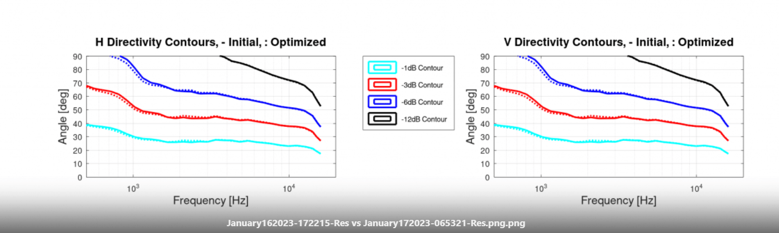

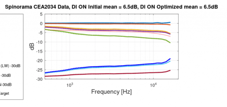

On the comparison graph the curves are color coded to the profile (bottom right corner) blue = initial red = optimized as indicated in the unnormalized networks of responses (top left and center graphs).DI is higher on the dotted line below ~2kHz so which ever that is has narrower coverage and the smooth line has wider coverage. I thought "initial" is with the profile with kink, dotted line, and "optimized" is profile without kink, smooth line. Well, easy to mix up as there don't seem to be explicit reference which is which. Anyway, coffee break over 🙂
View attachment 1131067View attachment 1131068
The dotted lines are for the optimized version in the contours and CEA graph i.e. optimized.
Btw both are results of optimization…
I probably need a better naming convention when I share the graph, sorry for the confusion.
Correct I saw the LF difference and reported it but edited the post because of the difference in diameter…No, the smoother one is wider. At least that is what the individual reports show and I believe it's swapped in the comparison graph.

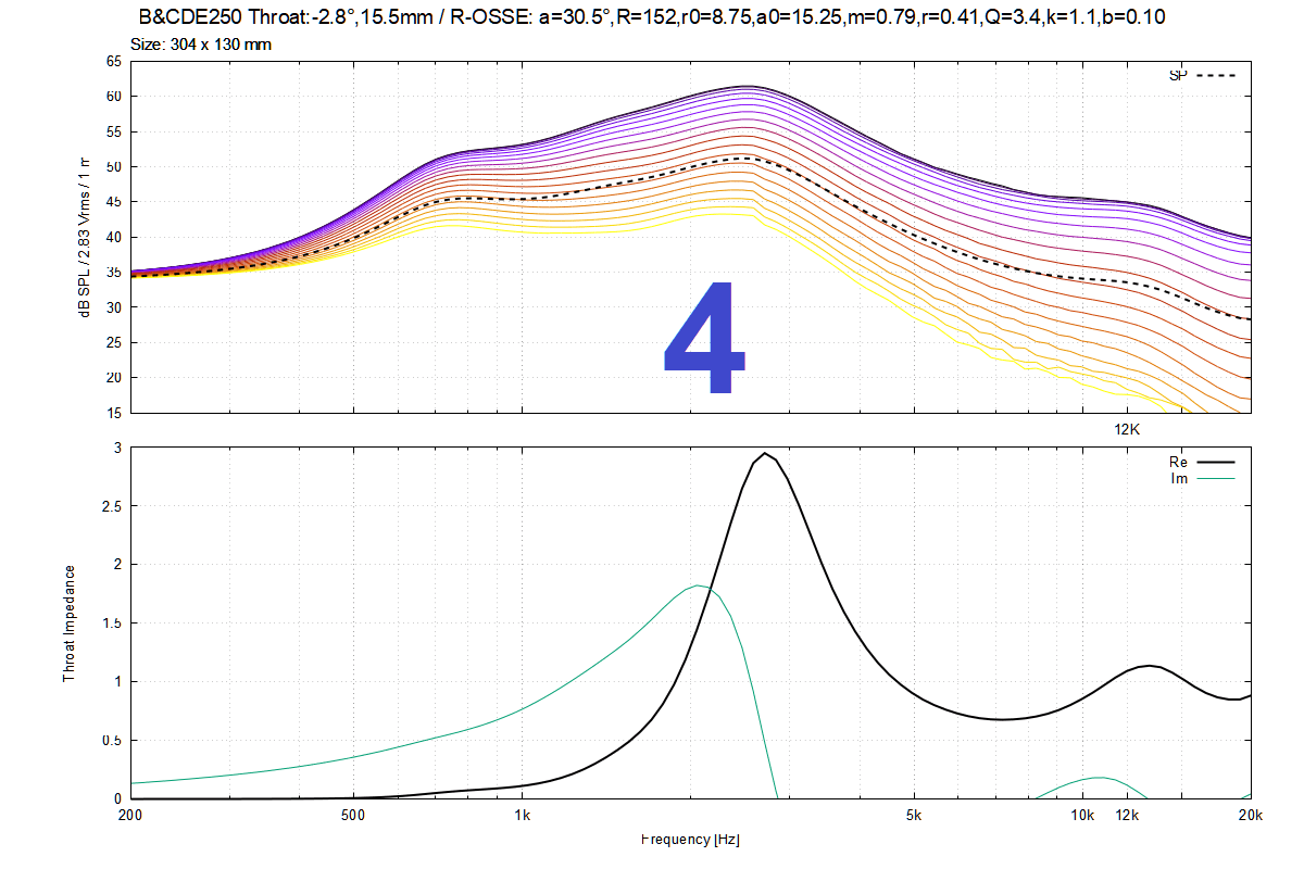

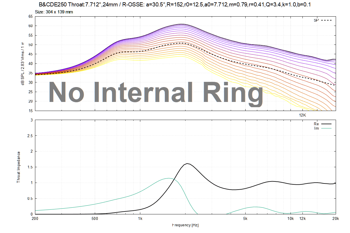

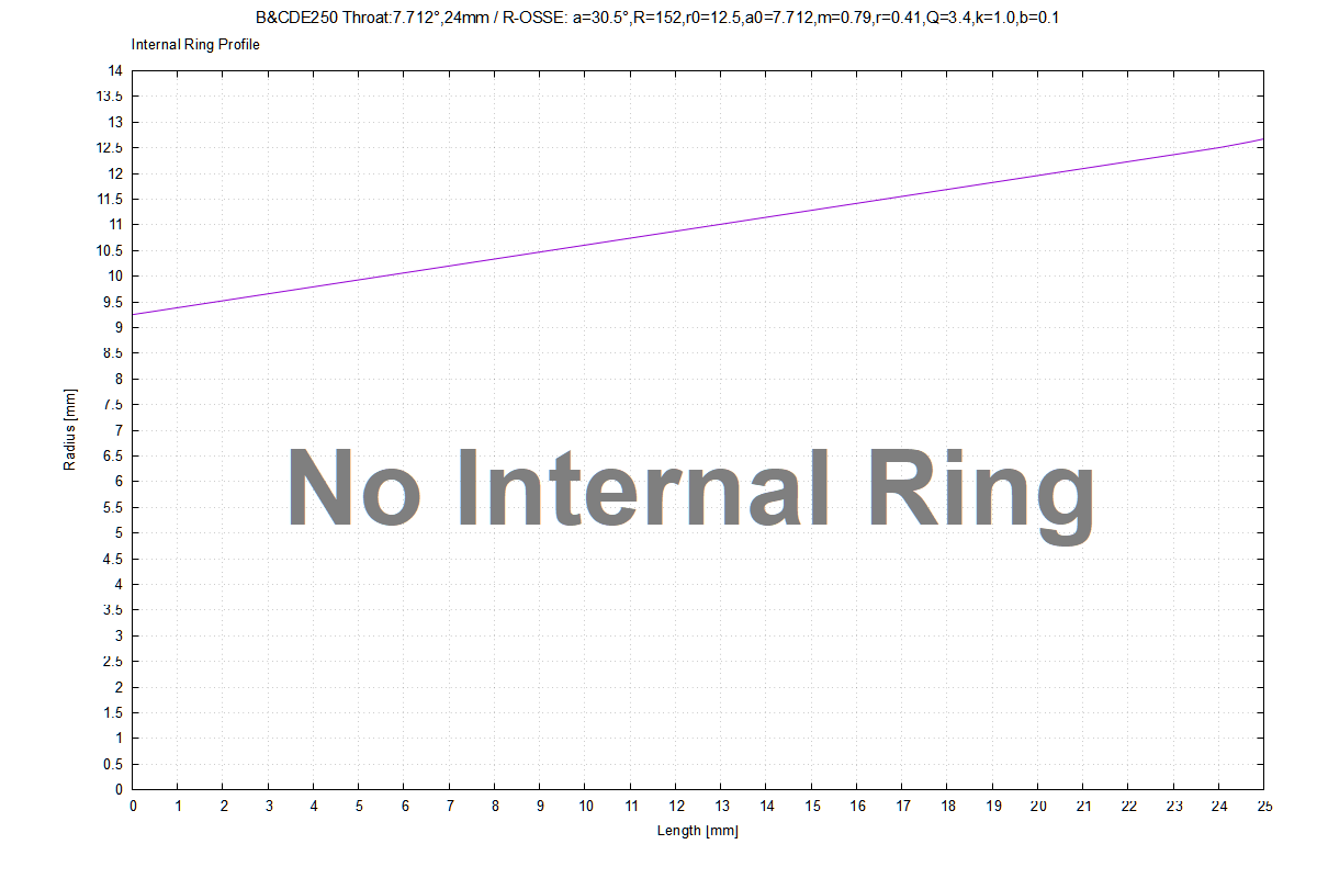

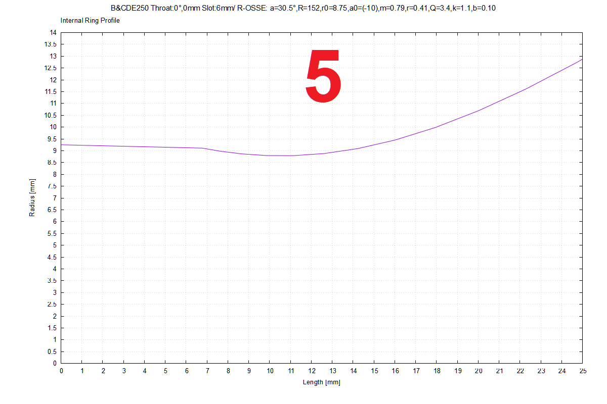

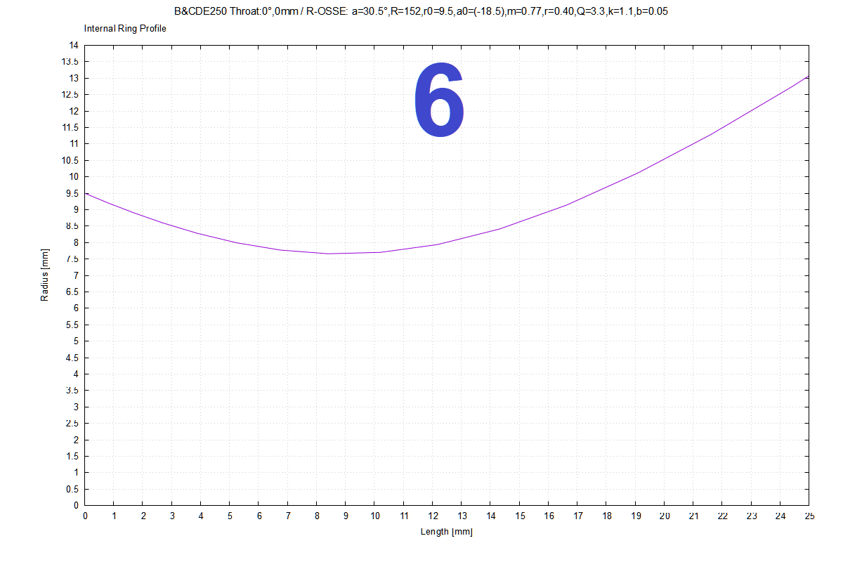

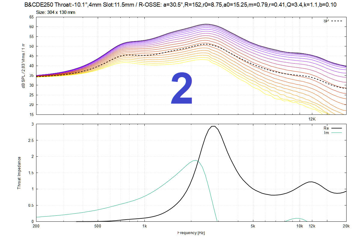

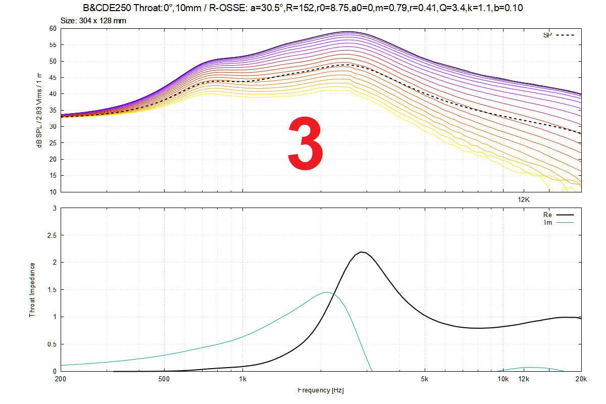

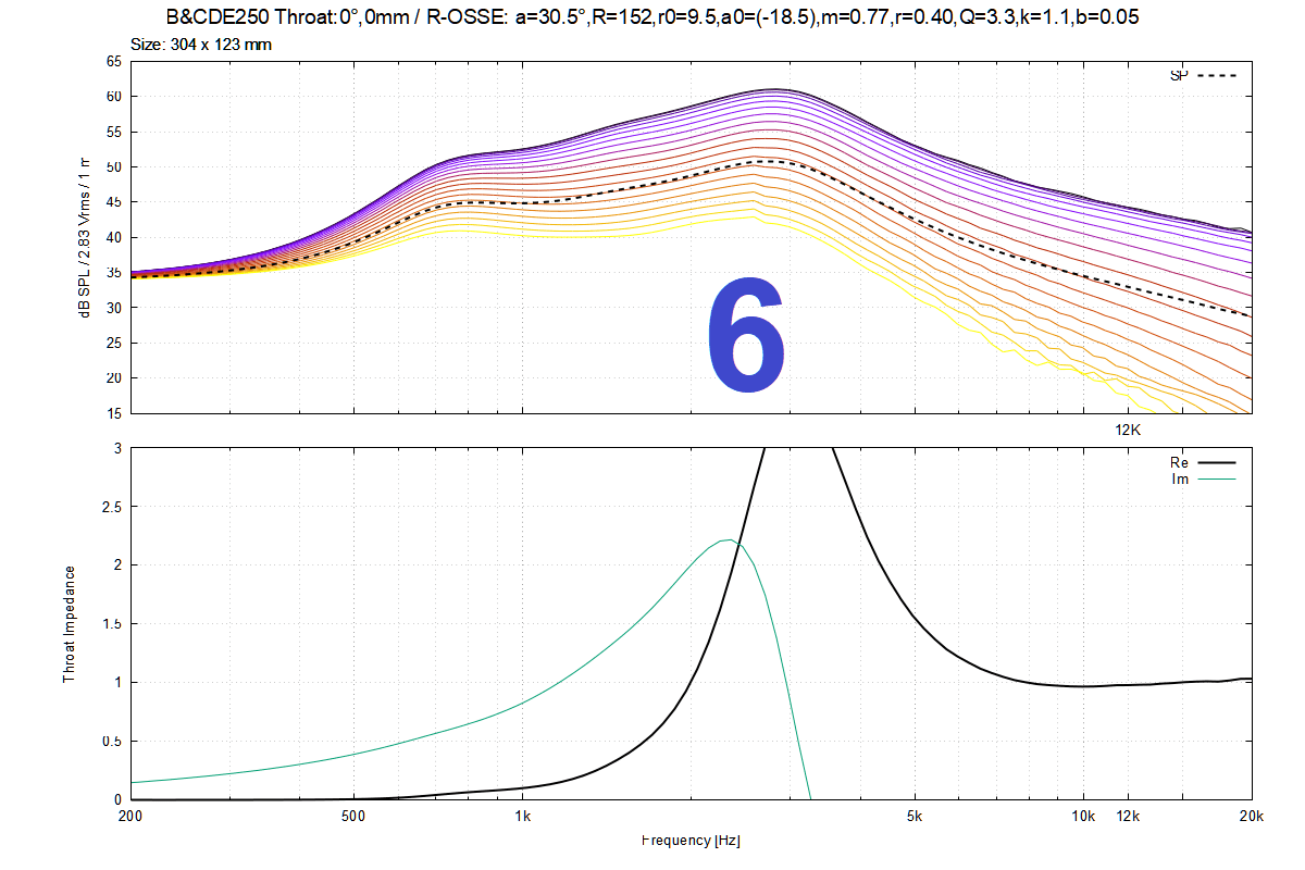

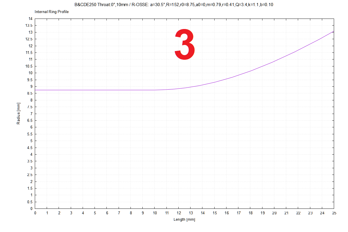

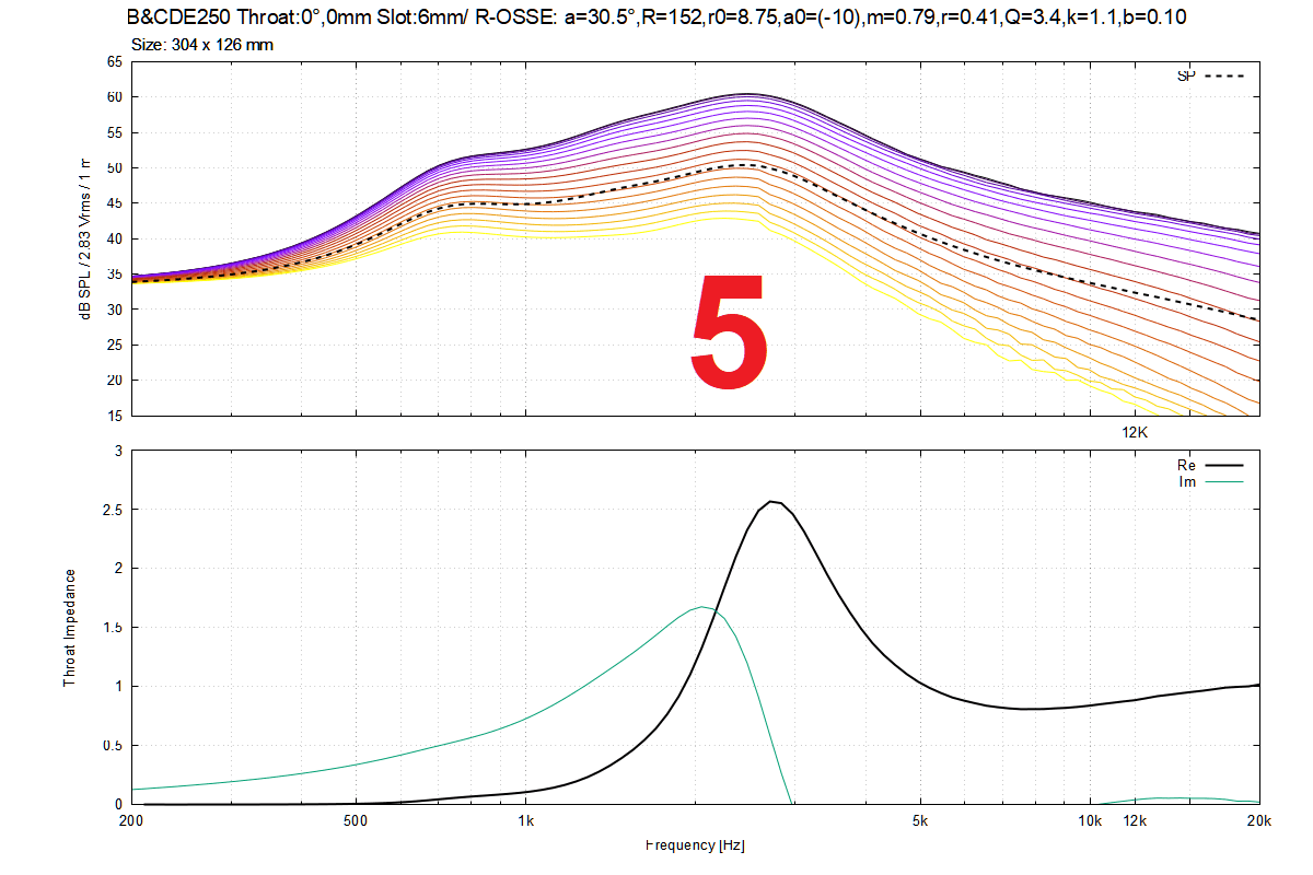

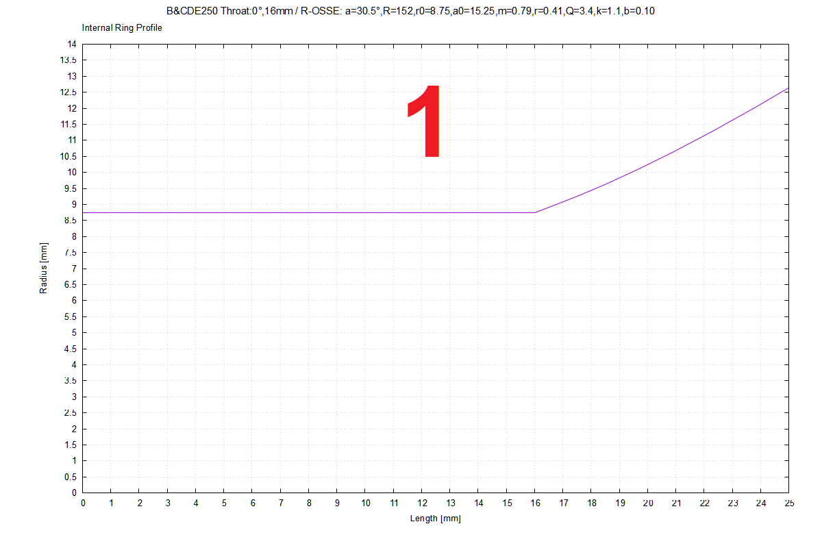

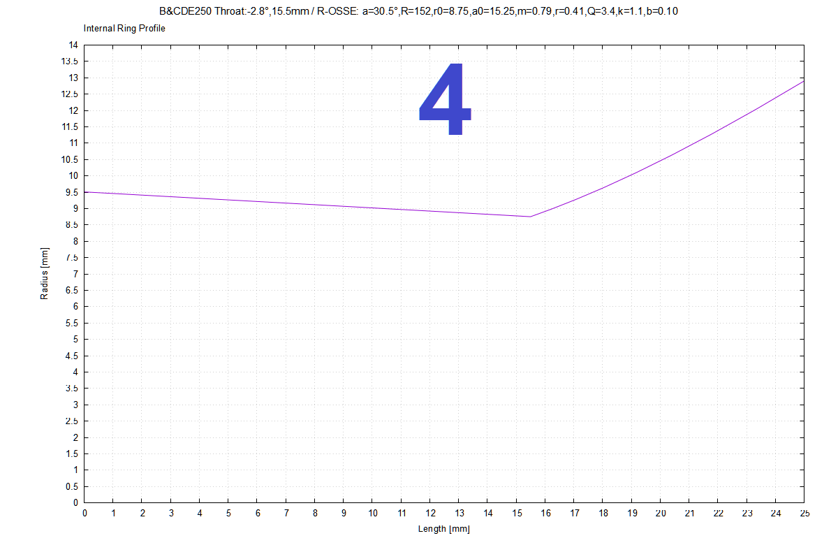

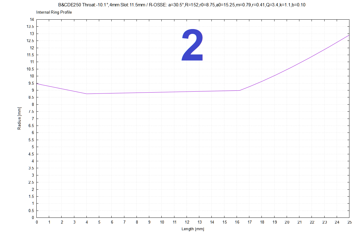

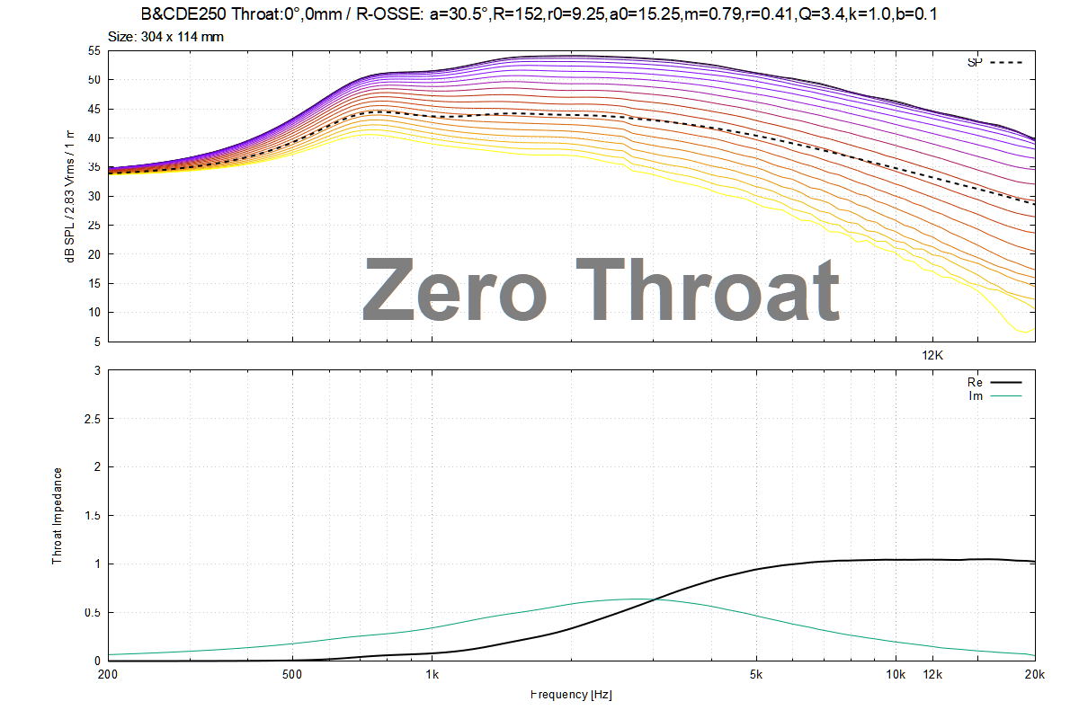

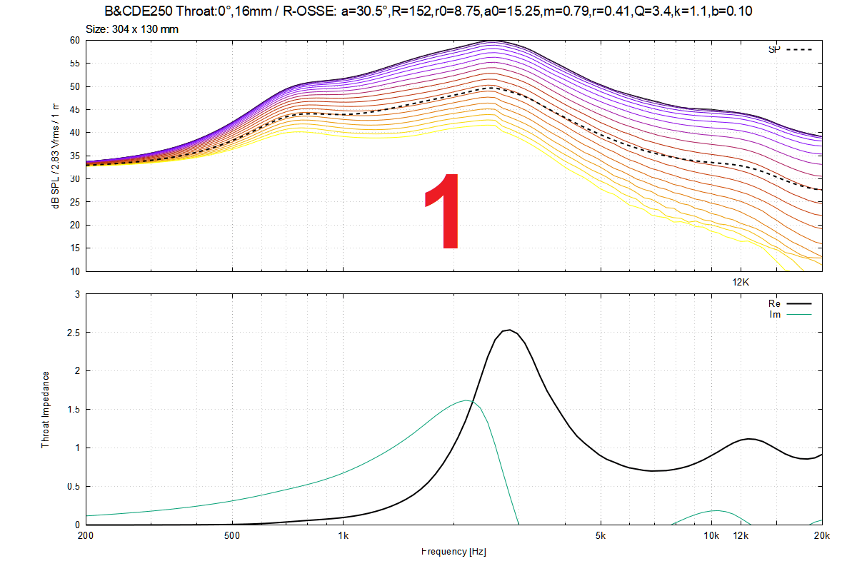

I attempted to simulate custom Internal Rings for the B&C DE250 compression driver for a 30.5 degree horn (a0=15.25). With my crude tools I measured the DE250 conical throat section as 18.5mm diameter entrance with a 25mm diameter exit with a length of 24mm, resulting in a 15.424 degree exit (or 7.712 half angle). That could be wrong because my tools are crude. I simulated for slightly different entrance diameters because I wasn't sure if my measurements were correct and ~6 degree exit angles were given for the DE250 in DIYAudio forum posts. So those could/will be wrong in reality.
1)
Throat.Ext.Angle = 0
Throat.Ext.Length = 16
a0=15.25
2)
Throat.Ext.Angle = -10.1
Throat.Ext.Length = 4
Slot.Length = 11.5
a0=15.25
3)
Throat.Ext.Length = 10
a0=0
4)
Throat.Ext.Angle = -2.8
Throat.Ext.Length = 15.5
a0=15.25
5)
Slot.Length = 6
a0=-10 ; (negative 10 angle)
6)
r0 = 11
a0 = -18.5 ; (negative 18.5 angle)
1)
a0=15.25
2)
Slot.Length = 11.5
a0=15.25
3)
a0=0
4)
a0=15.25
5)
Slot.Length = 6
6)
r0 = 11
For post https://www.diyaudio.com/community/...-design-the-easy-way-ath4.338806/post-7238240
Here is the impedance report script.
And here is the Internal Ring report script.
load 'static.txt'
load 'param.txt'
set terminal pngcairo color size R_W,R_H font "Arial,10"
set output R_FILE.'_RingInternal.png'
set multiplot layout 1,1 \
margins 0.1,0.96,0.1,0.92 \
title R_TITLE font "Arial,11" noenhanced
set grid xtics mxtics ytics
set label 'Internal Ring Profile' at screen 0.1,0.95 font "Arial,10"
set yrange [0:14]
set ytics 0.5
set ylabel "Radius [mm]"
set xrange [0:25]
set xtics 1
set xlabel "Length [mm]"
plot 'coords.txt' u 1:2 w l lw 1 not, 0 lt 4 not
unset multiplot
Yes, that is how it works. The best is if you don't have to use 'Throat.Ext.Length' at all - that of course depends on the driver used (the more open and shorter the exit section, the better).

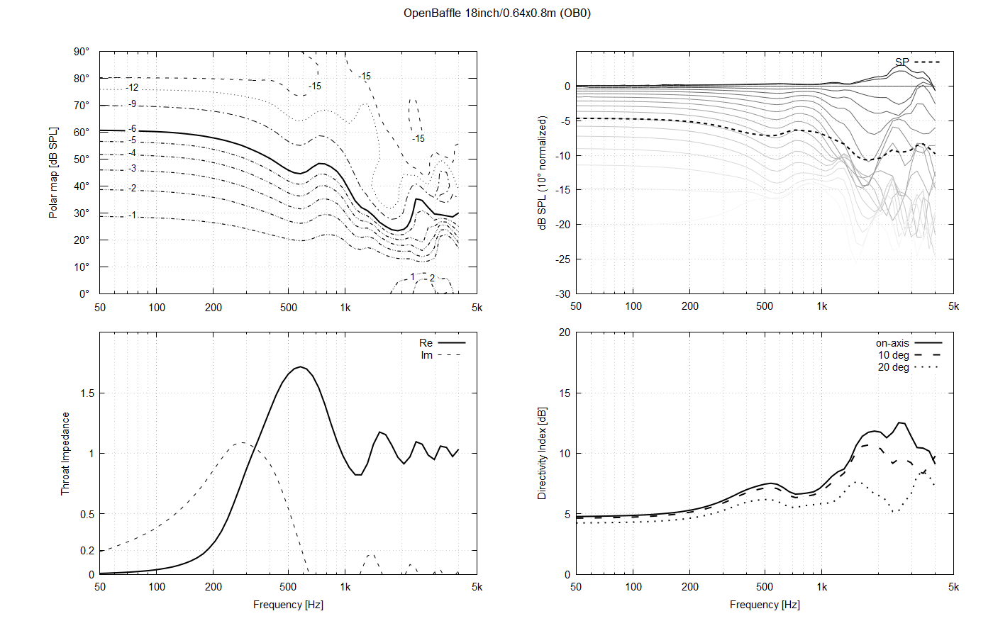

This is an 18" driver in a simple open baffle (free air, without a floor).
Seems perfect for 500 Hz crossover to a large horn.

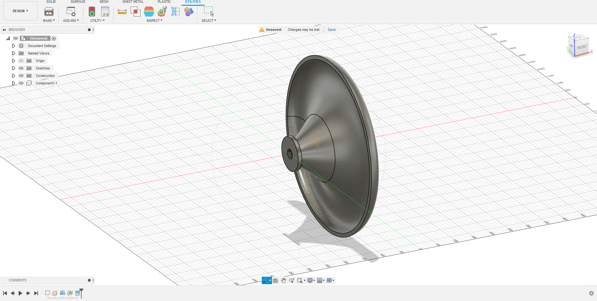

I've had a hard time learning Fusion 360 and still find it difficult to translate what I want in something that Fusion understands.
So I tried scripting Fusion 360 using its python API. So far the examples in the documentation have helped a lot. I extended AthProfileImport and hope to end up with a simple method to get a 3d printable throat + petals + 'glue helpers' model.
Here is what I have thus far:
If anyone wants to join in I can put it on github.
Code:
# Author-Autodesk Inc
# Description-Import Ath4 curves from file
import adsk.core, adsk.fusion, math, traceback
def run(context):
ui = None
try:
app = adsk.core.Application.get()
ui = app.userInterface
design: adsk.fusion.Design = app.activeProduct
if not design:
ui.messageBox('No active Fusion design', 'Ath Profile Import')
return
rootComp = design.rootComponent
dlg = ui.createFileDialog()
dlg.title = 'Open Ath Profile'
dlg.filter = 'Ath Profile Definition (*.afp);;All Files (*.*)'
if dlg.showOpen() != adsk.core.DialogResults.DialogOK:
return
f = open(dlg.filename, 'r')
sketch: adsk.fusion.Sketch = rootComp.sketches.add(rootComp.xYConstructionPlane)
lines = sketch.sketchCurves.sketchLines
points = {}
line = f.readline().rstrip()
while line:
if len(line) < 3 or line[0] == '#':
continue
items = line.split(' ')
if line[0] == 'P' and len(items) >= 4:
points[items[1]] = adsk.core.Point3D.create(
0.1*float(items[2]), 0.1*float(items[3]), 0.0
elif line[0] == 'L' and len(items) >= 3:
lines.addByTwoPoints(points[items[1]], points[items[2]])
elif line[0] == 'S' and len(items) >= 3:
splinePoints = adsk.core.ObjectCollection.create()
for k in range(int(items[1]), int(items[2]) + 1):
splinePoints.add(points[str(k)])
sketch.sketchCurves.sketchFittedSplines.add(splinePoints)
elif line[0] == 'U':
for k in items[1:]:
splinePoints.add(points[k])
f.close()
# Draw a line to use as the axis of revolution.
lines2 = sketch.sketchCurves.sketchLines
axisLine = lines2.addByTwoPoints(adsk.core.Point3D.create(0, 0, 0), adsk.core.Point3D.create(1, 0, 0)) # X axis
# Get the profile defined by the ath waveguide profile.
prof = sketch.profiles.item(0)
# Create an revolution input to be able to define the input needed for a revolution
# while specifying the profile and that a new component is to be created
revolves = rootComp.features.revolveFeatures
revInput = revolves.createInput(prof, axisLine, adsk.fusion.FeatureOperations.NewComponentFeatureOperation)
# Define that the extent is an angle of pi to get half of a torus.
angle = adsk.core.ValueInput.createByReal(2*math.pi)
revInput.setAngleExtent(False, angle)
# Create the extrusion.
ext = revolves.add(revInput)
# Get the body created by the extrusion
body = ext.bodies.item(0)
# Create a construction plane by offsetting the end face
planes = rootComp.constructionPlanes
planeInput = planes.createInput()
offsetVal = adsk.core.ValueInput.createByString('8 cm')
planeInput.setByOffset(rootComp.yZConstructionPlane, offsetVal)
offsetPlane = planes.add(planeInput)
# Create SplitBodyFeatureInput
splitBodyFeats = rootComp.features.splitBodyFeatures
splitBodyInput = splitBodyFeats.createInput(body, offsetPlane, True)
# Create split body feature
splitBodyFeats.add(splitBodyInput)
except:
if ui:
ui.messageBox('Failed:\n{}'.format(traceback.format_exc()))
Here is a simulation for zero throat length with 18.5mm diameter throat entrance vs the original factory 24mm long throat (B&C DE250 as close as I can measure with my tools). However, I don't understand what impact impedance has beyond equalization. Do large impedance changes/swings create problems that don't show up in the ABEC simulations, e.g.: high order modes described by Earl Geddes; group delay problems; or something else?
Now that I have a little experience manipulating impedance I don't know what I should be targeting if the compression driver won't allow a zero throat length for my chosen coverage angle.
I think that the impedance that you are talking about is the acoustic impedance seen ay the throat. That's not a problem and isn't a strong parameter anyways. What does matter is how the impedance changes along x - the direction of propagation. Large changes and/or discontinuities will cause diffraction and the creation of higher order modes.Do large impedance changes/swings create problems that don't show up in the ABEC simulations, e.g.: high order modes described by Earl Geddes; group delay problems; or something else?
